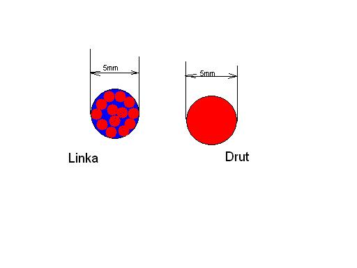

  • #7 3424540
    SITO79
    Posts: 833
    Help: 113
    Rate: 102
    and you do not get the wrong calculations by accident because you are counting the cross-section for the wire? after all, there is a weave of thin wires with tiny gaps between them. so a diameter of, for example, 5mm will give different mm? for a wire and different (smaller) ones for a line.
    for the line, you would have to count each wire and feed it, so the same diameter gives actually smaller mm? for the line
    • How to calculate the cross-section of a cable having a diameter? linka drut.JPG (9.73 KB) You must be logged in to download this attachment.
  • #8 3425089
    łowieca
    Level 30  
    Posts: 1207
    Help: 127
    Rate: 39
    Well, in fact, I did not think about it - my mistake :|
    It should be obvious, but somehow it did not fall into my headache :( .
    Thanks for explanation :)
    #9 3425128
    elmer2
    Level 28  
    Posts: 1561
    Help: 41
    Rate: 84
    Well, let's assume that the cross-section of the line in relation to the wire is reduced by 20% for "air losses" (let's call it that), then of these 16mm2 there will be about 12.8mm2 ...

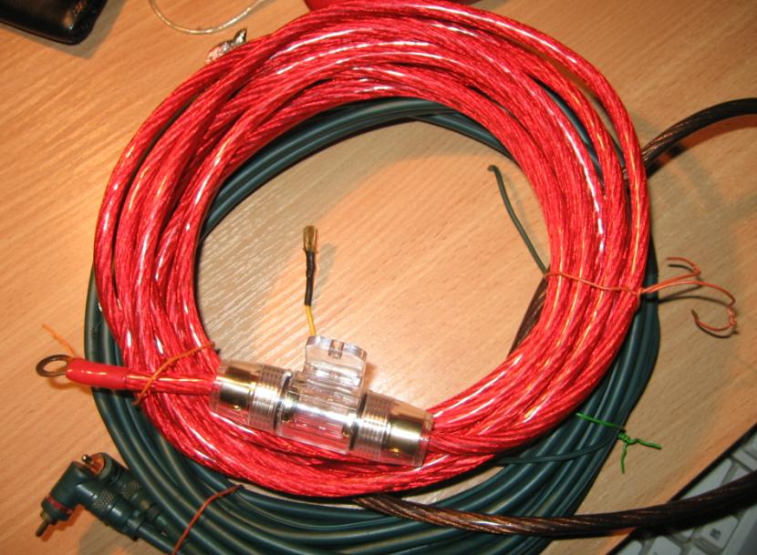

  • #12 3425980
    wow
    Posts: 1440
    Help: 57
    Rate: 182
    wit007 I asked if a cable with 7 mm in insulation will contact the hpb 602, they said that it is easy now, out of curiosity, I ask how much he has :D
    Added after 9 [minutes]:
    This is what it looks like :D
    • How to calculate the cross-section of a cable having a diameter? kable.JPG (88.36 KB) You must be logged in to download this attachment.
    #13 3426983
    wit007
    Posts: 594
    Help: 41
    Rate: 26
    It looks like 10 mm sq. At 16, not too much
