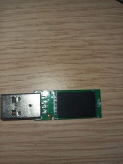

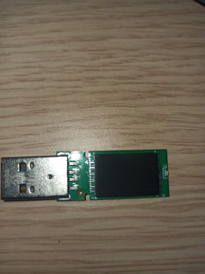

    doggyfreestart1 wrote:
    If you can open the drive, then you can read the chip.
    I opened the key, here is the chip
    The image shows a disassembled USB key with visible internal circuits on a wooden surface.
    Close-up of a printed circuit board inside an opened USB flash drive.
    Added after 40 [seconds]:
    kaleron wrote:
    And what do you want to do with it? Do you want to repair it or recover its contents?
    I want to repair the key

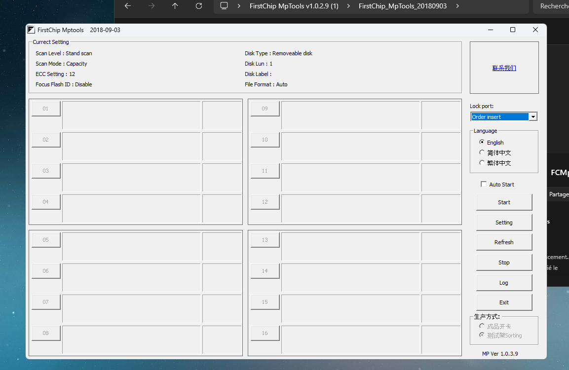

    firstChip and other software don't detect my key Screenshot of FirstChip MpTools software with an open dialog window.

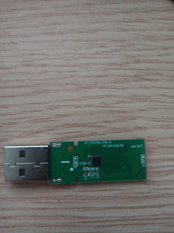

    Sorry I can't read from the photo what is written on the controller (small chip)
    Can you share this information?

    khdh05283 wrote:
    is this important information?
    - yes. most important. You may want to lightly grease the chip with thermal paste - this will improve the contrast. Try reading using a magnifying glass in good light.

    doggyfreestart wrote:
    Sorry I can't read from the photo what is written on the controller (small chip) Can you share this information?
    it's written very small, I can't see exactly, is it essential information?

    >>21108333
    pidar wrote:
    Please test the soft from my attachment -> https://www.elektroda.pl/rtvforum/topic3956610.html#20439913
    I downloaded it, it's the first one to find the key, what do I do afterwards with the software?
    Added after 24 [minutes]:
    >>21108333Many thanks, my key is working again, even though I lost 10giga out of my 128giga in the battle.

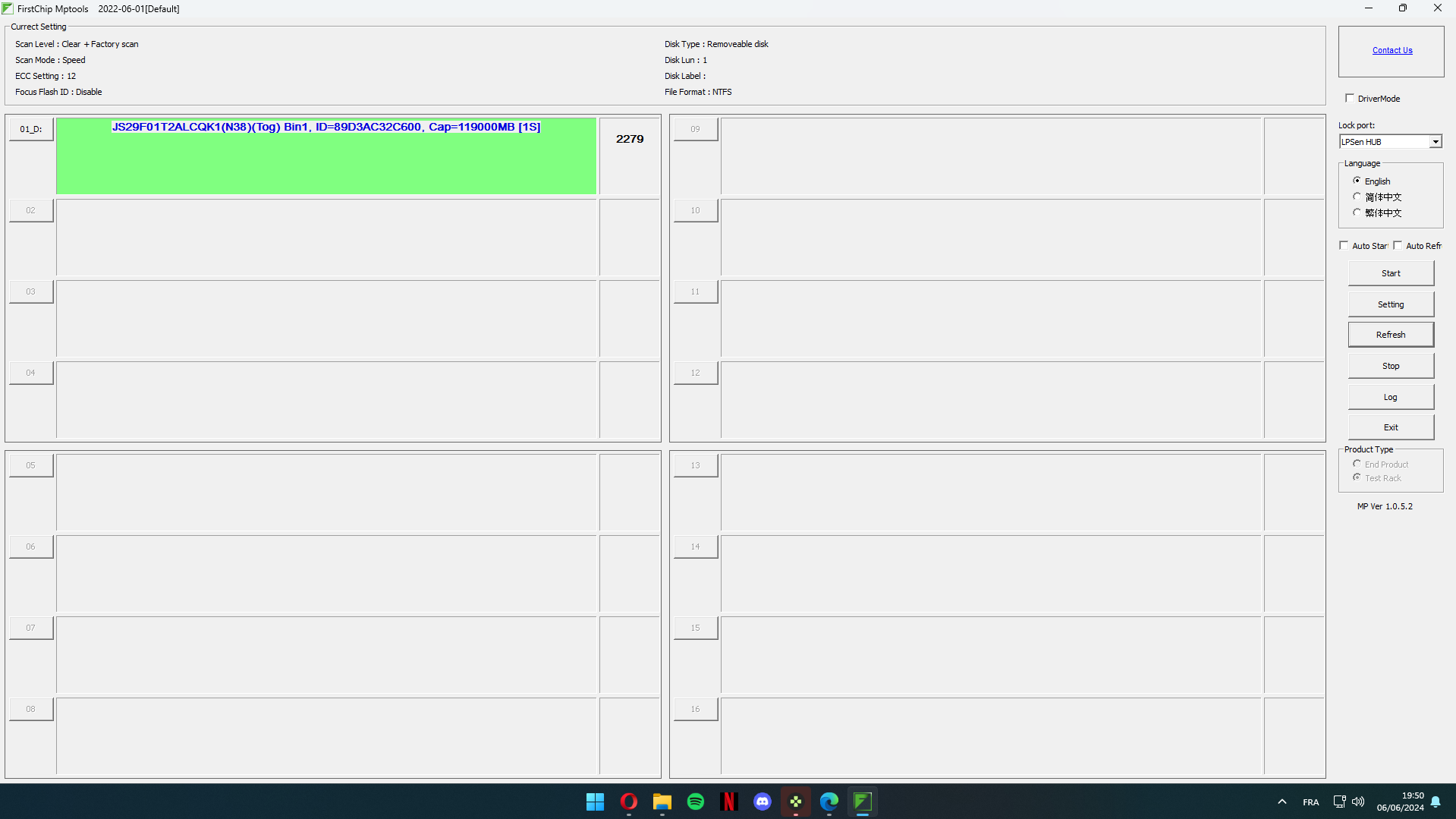

    Finally, can we see the current screen after "Refresh" with -> FirstChip_MpTools_20220601 .
  • #13 21109914
    khdh05283
    Rate: 9
    yes of course Screenshot of FirstChip MPtools software used for flash memory management.
