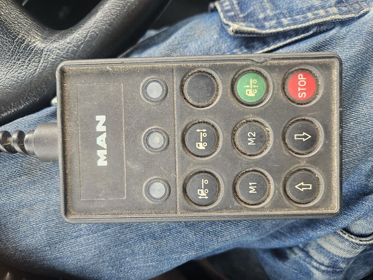

    Hi. I have a MAN TGM where the air suspension has stopped working. No fault codes. Just a red light on the dashboard. The remote control does not light up. Any ideas?

    Check the remote control for a damaged cable

    Or lack of calibration.

    Check the fuses?

    The question is what was done before the fault? Coincidentally not fired from a start-up?

    hubert04 wrote:
    Question what was done before the fault? Coincidentally not fired up from a startup?
    This is the key question - if so then probably ECAS controller fried.
