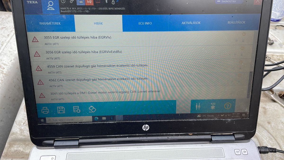

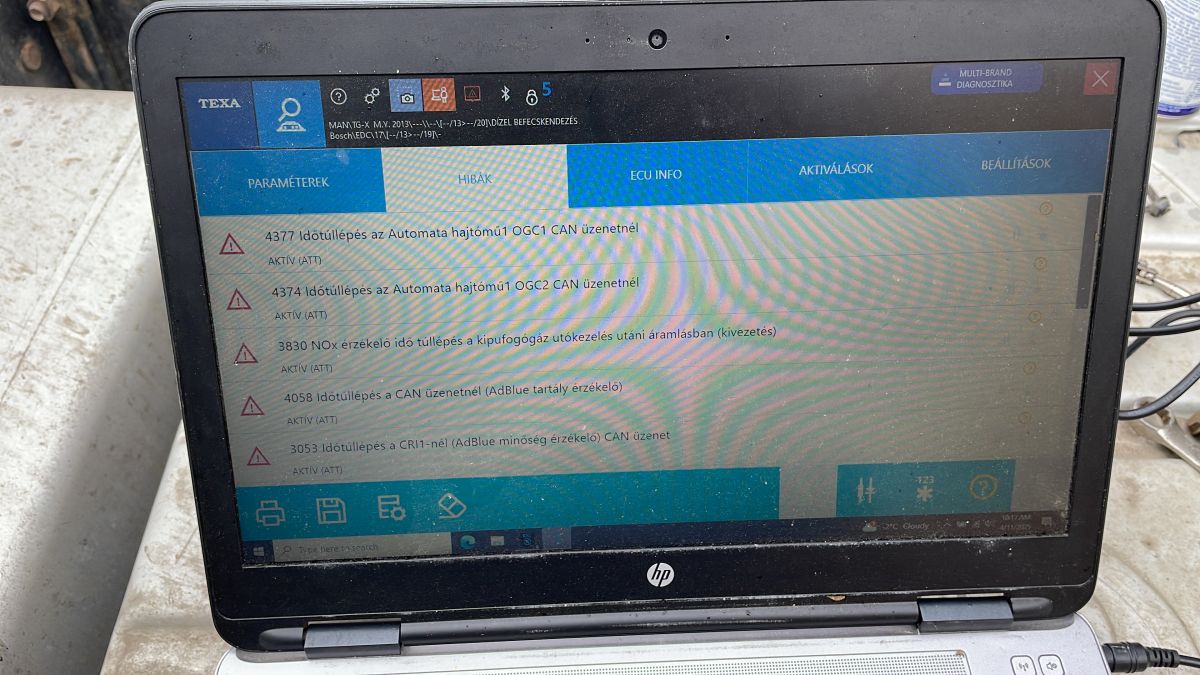

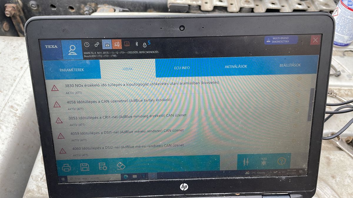

    Hello everybody I have encountered the following errors on a MAN TGX engine code D2676 LF46.
    What could be the cause of these many problems?
    List of error codes:
    3055
    3056
    4559
    4562
    3041
    3830
    4058
    3053
    4059
    4060
    4377
    4374
    3830
    4058
    3053
    Also the gearbox is also acting up it has a real hard time changing gears. could they be related?

    I have checked on the right side of the chassis under the adblue pump the wiring it was full of water and one cable was broken fixed it still the same error codes pop up. I checked the line between the oil pan and the intercooler it was dry and everything was in order. I measured after repairs everything and the problem seems to be coming from the combined adblue sensors in the tank.

    The issue with the truck was a faulty Egr valve.
  • #8 21539470
    bagolykiralyxd
    The issue with the truck was a faulty EGR valve. As it was short circuiting and communication didn't went thru to the other components
