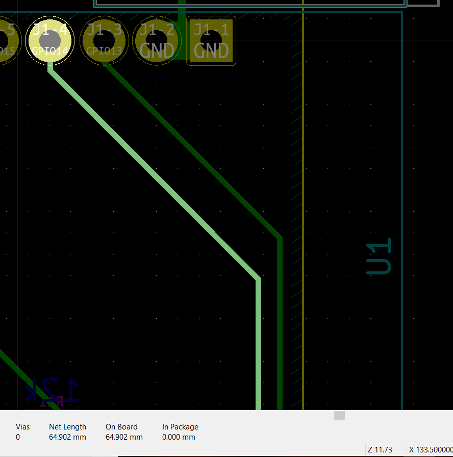

How do I interpret the "Length of Parallel Routes" (L) input in the microstrip crosstalk calculator for my PCB traces?
In that calculator, L is the length of track that runs in parallel with another track at the same spacing, not the trace width and not necessarily the total net length [#21683188][#21683194] S is the distance between the two tracks [#21683188][#21683194] If the spacing changes along the route, split the trace into separate sections and calculate each section separately because each section has a different crosstalk value [#21683192][#21683195] For each section, use the length where that particular spacing stays the same, and take the worst-case value [#21683192][#21683194] If the spacing is the same for the entire route, then L can be the total net length [#21683194]

  • Parallel length is the relevant crosstalk parameter

  • Crosstalk depends on spacing along each parallel segment

  • Parallel length L and spacing S clarified
