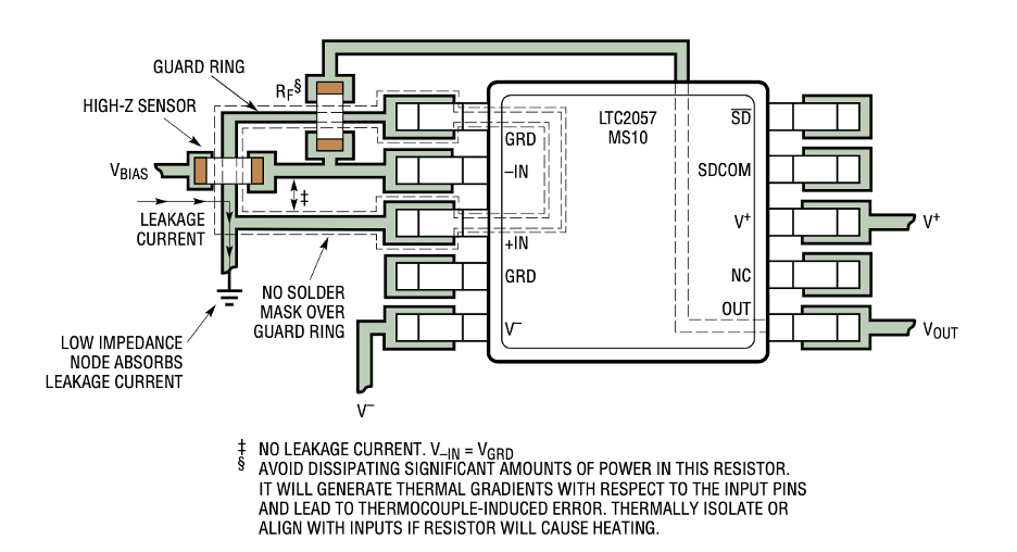

LTC2057HV Op Amp Guard Ring: Should Both Ground Pins Connect to Power Supply Ground?
483 2
  • Question about grounding LTC2057HV guard ring pins
