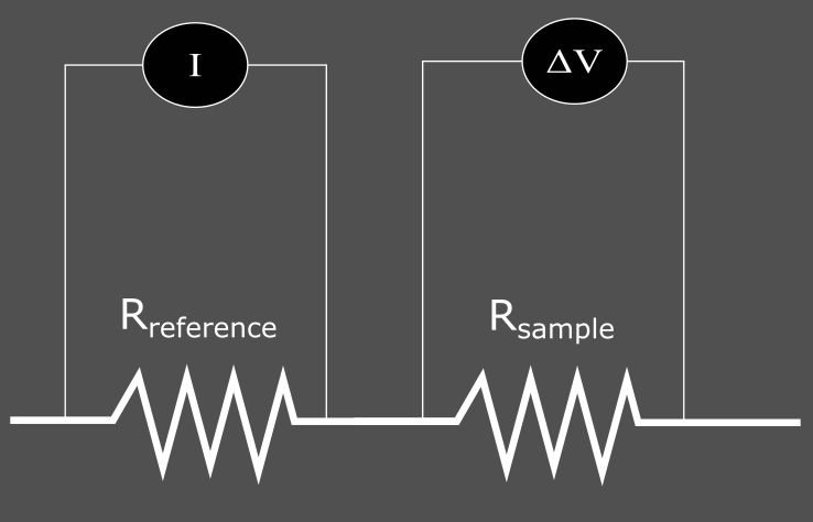

Measuring Phase Lag & Magnitude of Voltage Across Rock Sample 0.01–1000 Hz Signal Processing
372 3
  • Suggesting oscilloscope or DAQ setup for phase measurements
    #1 21685967
    CodyKessler
  • Use oscilloscope or lock-in measurement methods
    #2 21685968
    Richard Gabric
  • Recommend Labview for low-frequency data processing
    #3 21685969
    David Ashton
  • Planning oscilloscope measurements with water calibration
    #4 21685970
    CodyKessler
