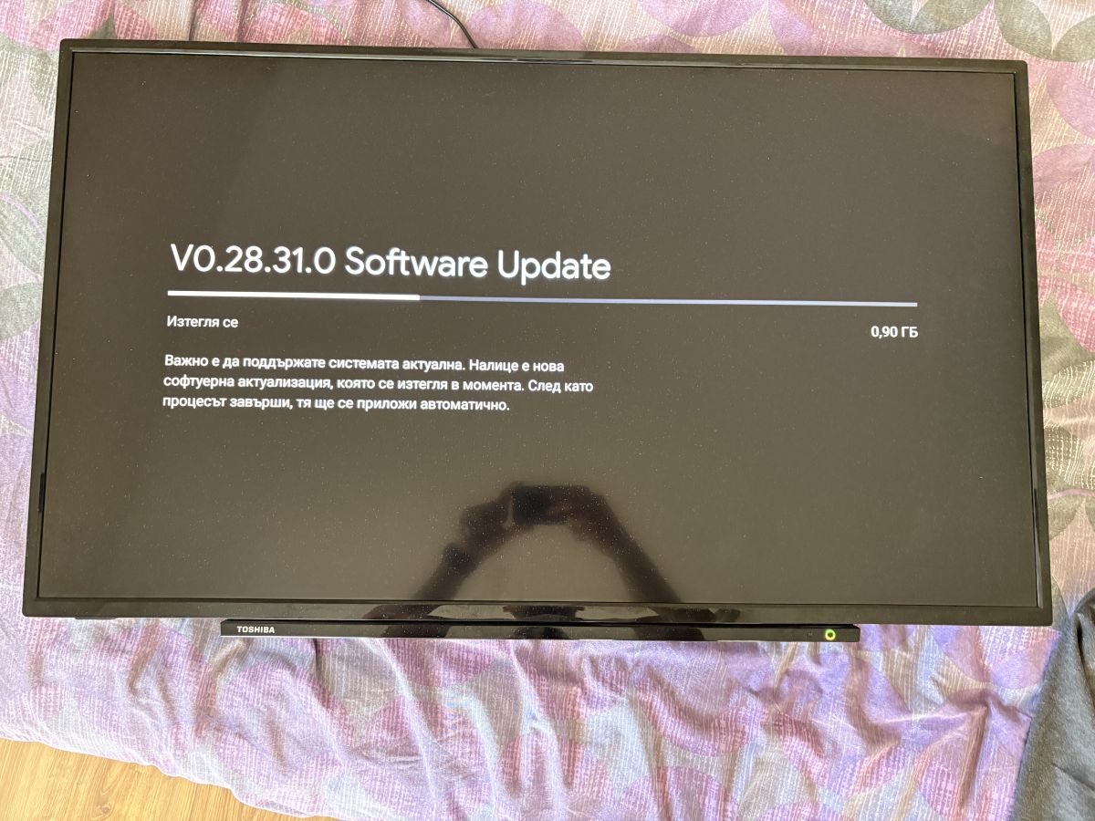

  • #5 21695240
    ilomcheto
    Is there a way to stop checking for updates because it is constantly looking for an update and installing the same update. Take a picture
    TV screen showing software update V0.28.31.0 in progress, 0.90 GB downloaded

  • #7 21695331
    ilomcheto
    What I show in the picture is after I installed the software you sent me, there is no longer a double image, but immediately after connecting to the Wi-Fi network it finds an update and starts installing it. My thought is how to stop this with the updates, if I manage to stop it the TV will work perfectly.
  • #8 21695372
    yokoono51
    Posts: 815
    Help: 172
    Rate: 316
    Look in the menu. There you will find the setting to stop updating via the internet.
