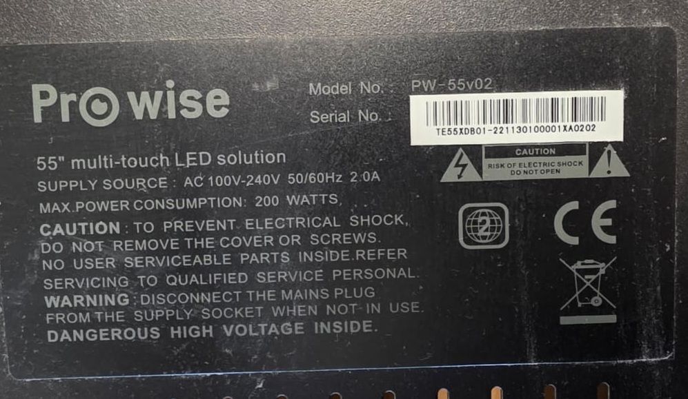

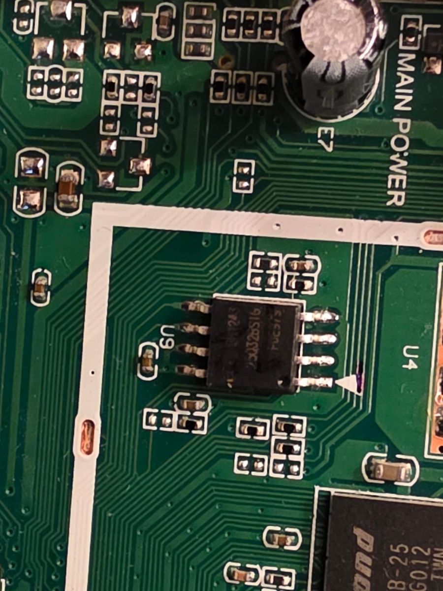

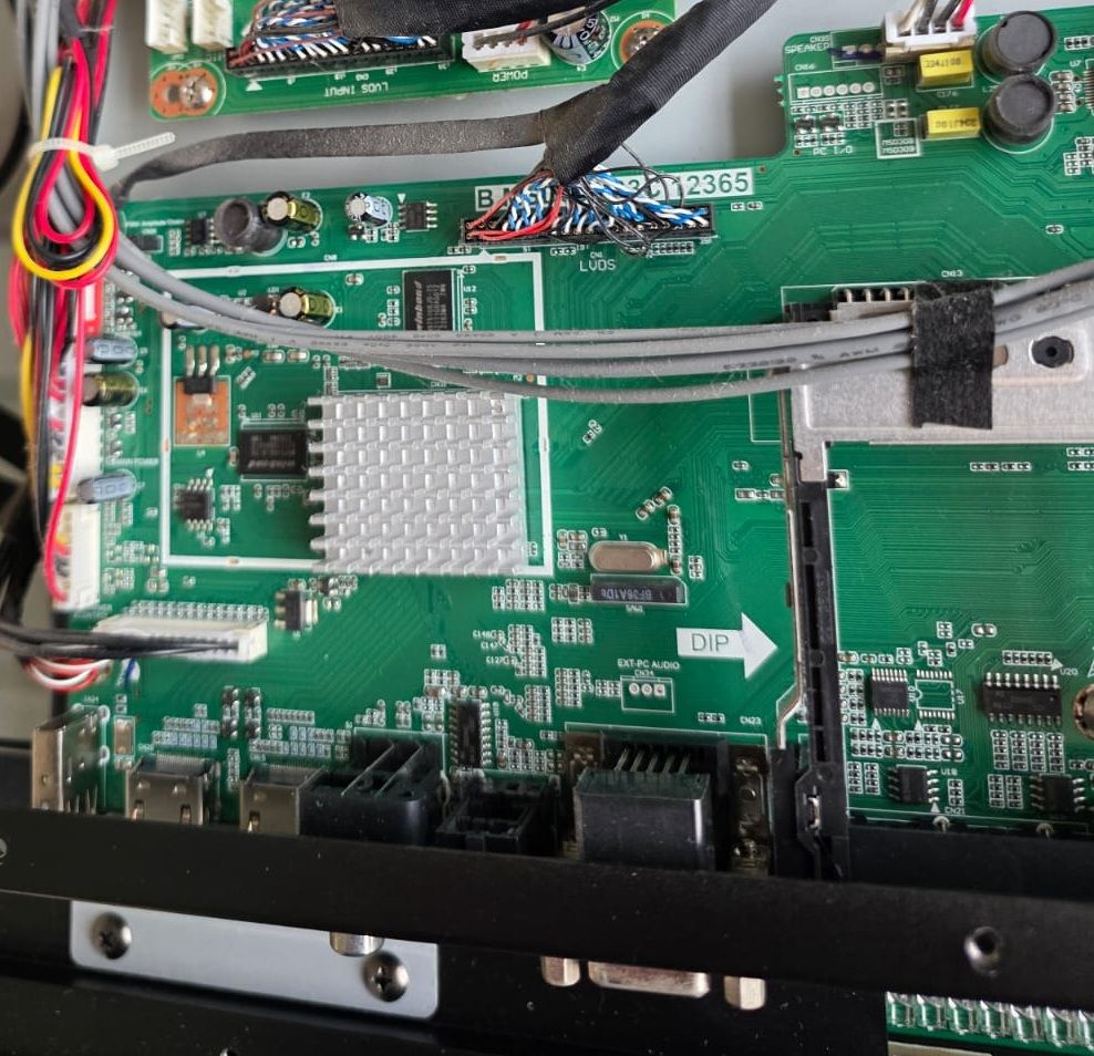

    I have a defective Prowise PW-55v02, it is stuck in standby.
    The main control board is a B.MSD309.33C 12365.
    (Similar boards/chipsets are used in Blaupunkt TVs, I've found that the firmware could be the culprit)
    So I'm looking for a firmware dump of U9 25Q32BS (SPI Flash).
    I took a dump of the existing flash but some bits flip from time to time.
    The panel is a T420HVN01.1
    Does anybody has a working dump/firmware file
    Close-up of U9 integrated circuit on green PCB with visible traces and components.
    Information label on back of Prowise PW-55v02 monitor with electrical warnings
    Motherboard with multiple connectors, wires, and an aluminum heatsink
  • Wrong firmware boots with inverted blurry colors
    #2 21720384
    debnie
    So a little update, I've found online a dump of a "Seewo" TV with the same motherboard (attached).
    I programmed it in a new flash chip (winbond GD25Q32ESIG) and the Prowise boots but the colors are wrong, the image is upside down (and a little blurry).
    So probably the panels are not compatible. (The prowise has a LVDS frame rate conversion board PL.MS6M30.1B-1 11375)
    So still looking for the right firmware...

  • #4 21720912
    debnie
    Thanks for taking an interest, attached is the corrupt dump.
    I noticed between dumps, bit flips at the address 0x06ef1b.
    How can you check the corrupt dump?

    #5 21721961
    badael
    Posts: 553
    Help: 137
    Rate: 215
    Fixed original dump, cleaned NVM, good luck.
    • Prowise PW-55v02 B.MSD309.33C 12365 Firmware Dump Request for 25Q32BS SPI Flash - Stuck in standby addr·[0x309998] size·[0x009480].jpg (37.13 KB) You must be logged in to download this attachment.
    • DIGIB_V3_OK.rar (3.27 MB) You must be logged in to download this attachment.

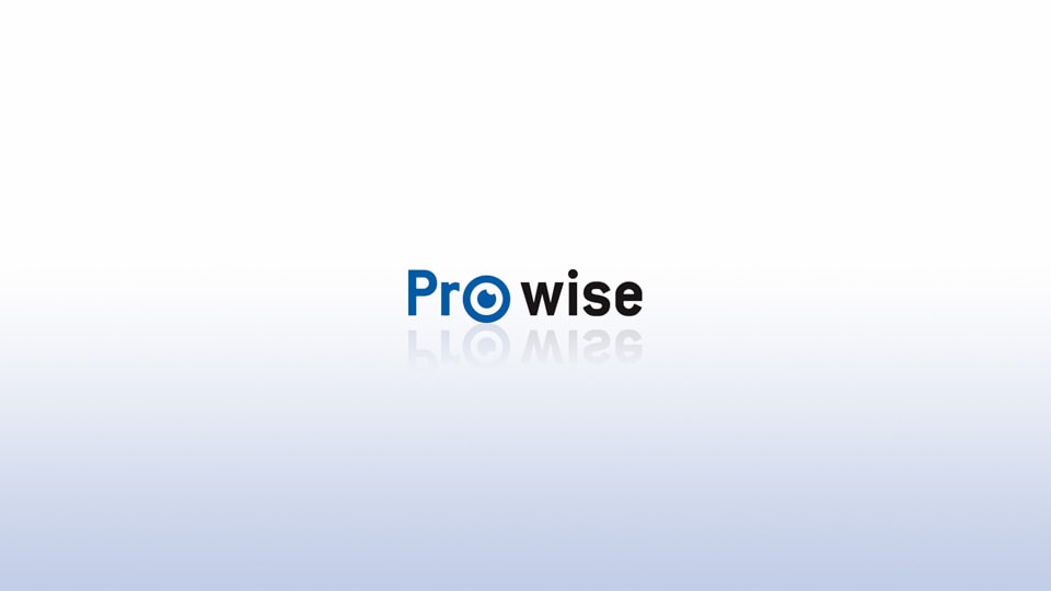

  • #6 21722480
    debnie
    I programmed the fixed original dump and tested it, the panel works again!
    Thanks for the effort!
    Screen displaying the Prowise logo on a light background
