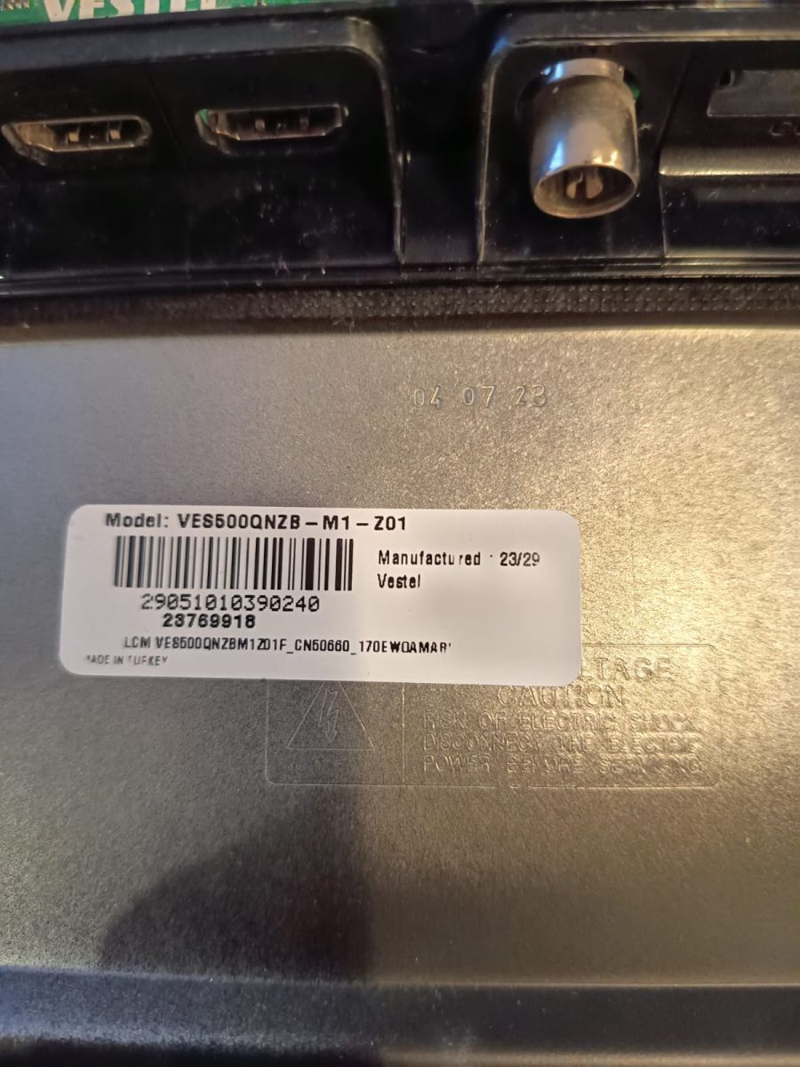

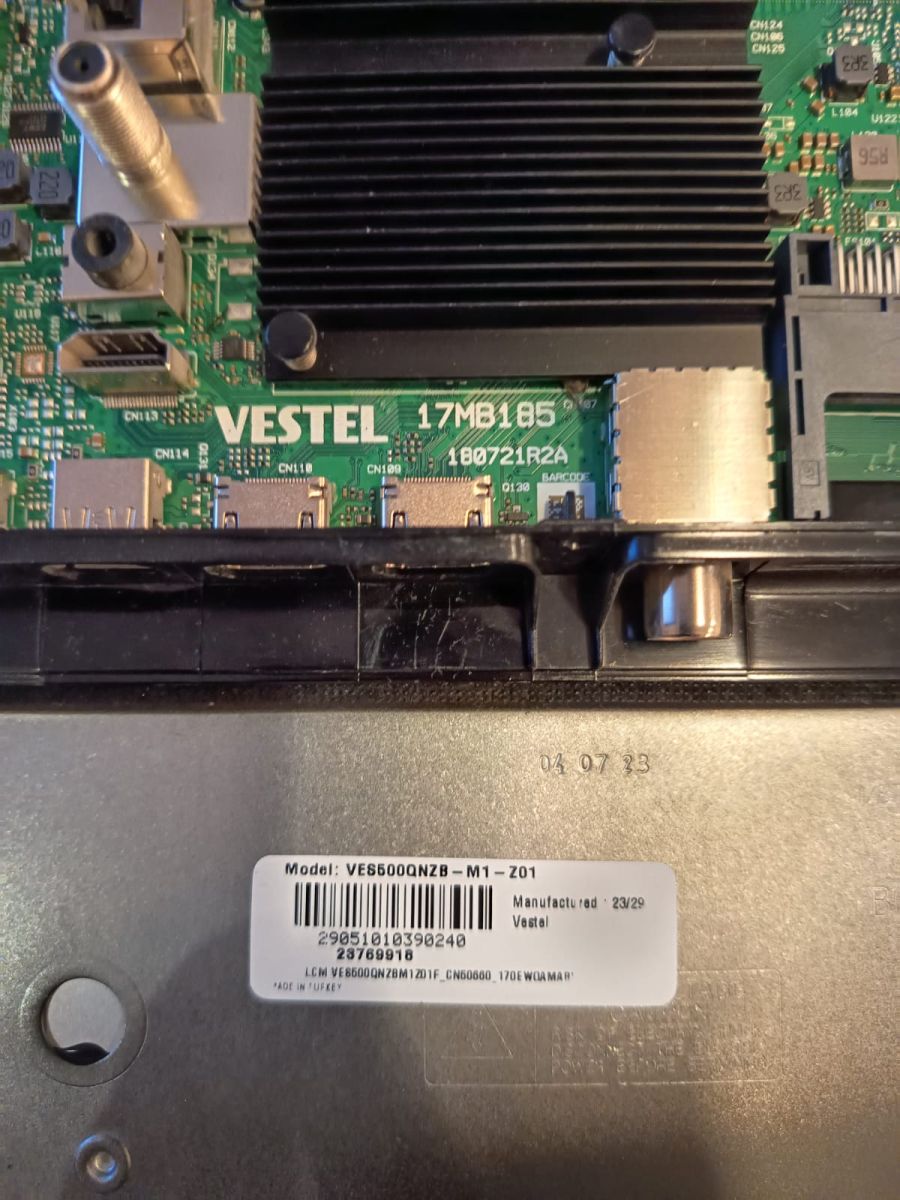

    TV in boot loop, after internet provider made some connection switching on and off, during the time, TV was connected via LAN cable.
    Now screen flashes from black to white with JVC logo, in approx. 7 s intervals.
    I need help.
    Do you have some advice or firmware fix file?
    Vestel 17MB185 mainboard and model label VE500QNZB-M1-Z01 inside JVC TV

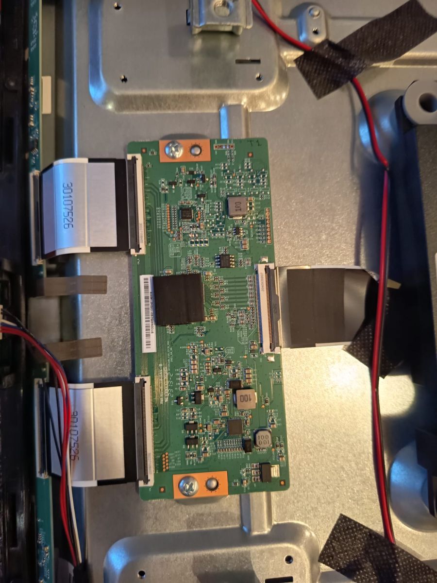

    Close-up of T-con board inside JVC TV with visible ribbon cables

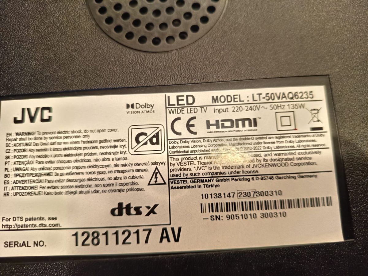

    Label on the back of JVC LT-50VAQ6235 TV with technical data and safety warnings

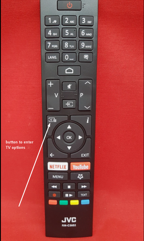

  • #3 21774219
    rinedel
    Posts: 46
    Rate: 23
    The way to enter SM is as follows:
    On the remote, press TV Options.
    After entering that menu, select Advanced Options. When that menu opens, type the standard 4725 and you have entered SM.
