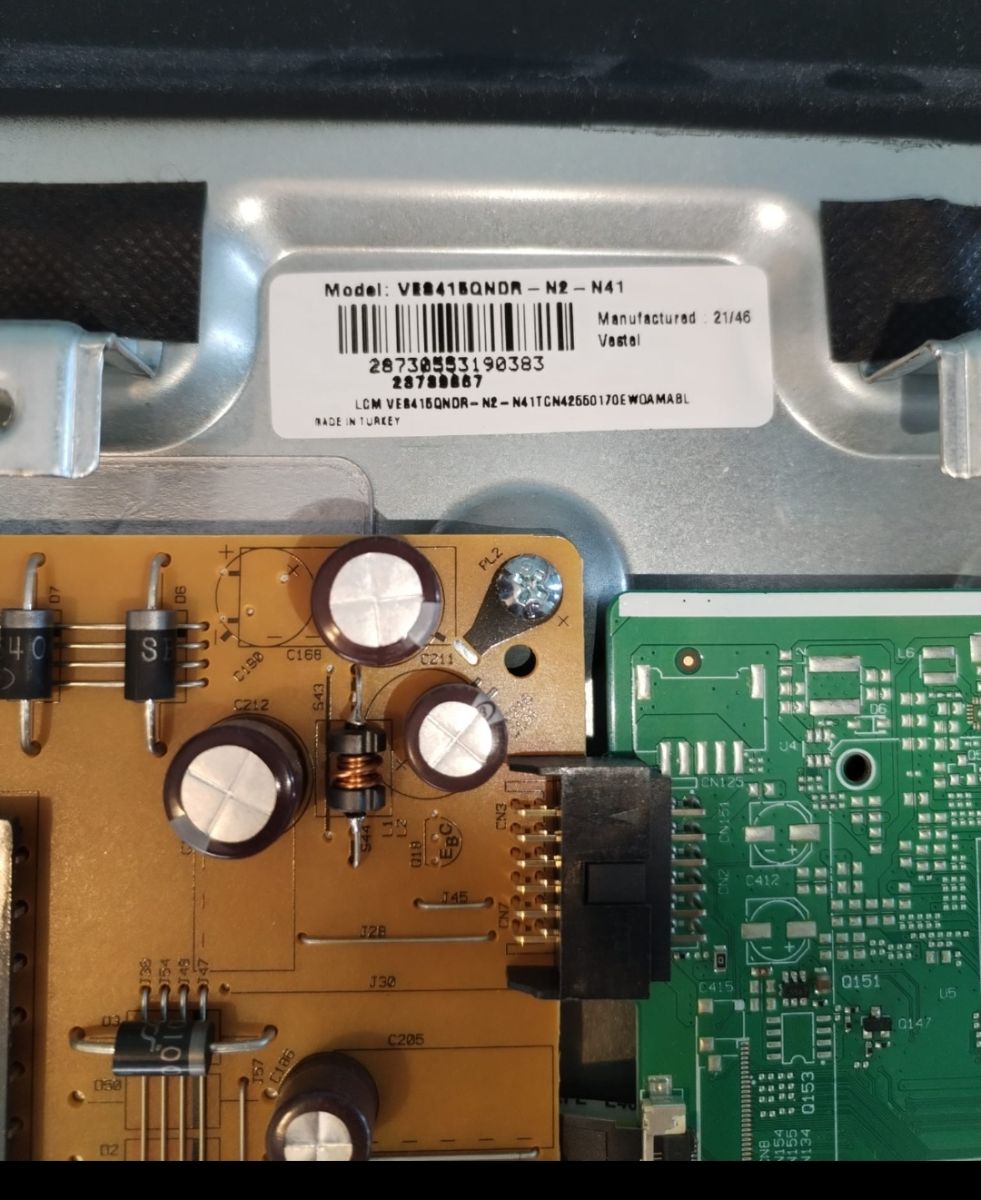

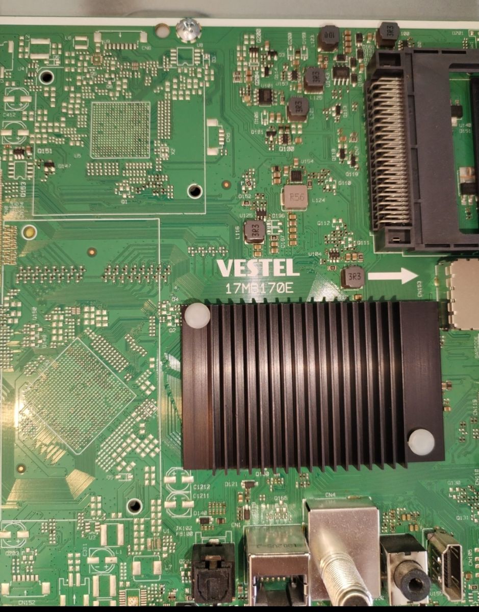

    Hi everyone,
    I need the firmware for an HITACHI TV. Mainboard code: VESTEL 17MB170E
    Panel code: VES415QNDR-N2-N41
    I attach here a couple of pictures:
    Thanks :)
    Close-up of circuit board with capacitors and a model label on the metal housing
    VESTEL 17MB170E mainboard with electronic components and black heatsink
    AI: Could you please provide the exact model number of your HITACHI TV (usually found on the back label)?
    V21K03402
    AI: Can you tell us why you need the firmware—are you experiencing a specific issue or error with the TV?
    Memory full loop: reset not useful

    Initial assessment of available information
    - Your photos show: mainboard Vestel 17MB170E and panel label VES415QNDR‑N2‑N41 (manufactured week 46/2021).
    - The earlier posts in this topic mention a “memory full” loop and requests for generic firmware and even 17MB186>>17MB70 “soft.” Those are different chassis families and are not cross‑compatible with 17MB170E.
    Direct answer to the question
    - There is no single public “download link” I can safely post for 17MB170E. Vestel packages are product‑ and panel‑matched. Flashing a mismatched file can brick the TV or give no image.
    - If you provide the identifiers below, I will point you to the exact package (or confirm whether it exists in the forum’s download area). Where forum rules restrict posting proprietary files openly, I can detail the file names and checks you must look for and guide the procedure.
    What I need from you (to locate the exact, safe package)
    Please read the stickers and reply with:
    - Full TV model from the back label (e.g., 43/50/55HK…; not only the internal code).
    - Product/Type code (usually 10xxxxxx or similar on the back label).
    - Mainboard barcode string from the white sticker on 17MB170E (format like 23xxxxx… or 231/232… series).
    - Confirmed panel code (looks correct as VES415QNDR‑N2‑N41 from your photo).
    - Region (EU/UK/etc.).
    - Exact symptom: “Memory full” dialog → reboots, or pure bootloop with logo, or LED only.

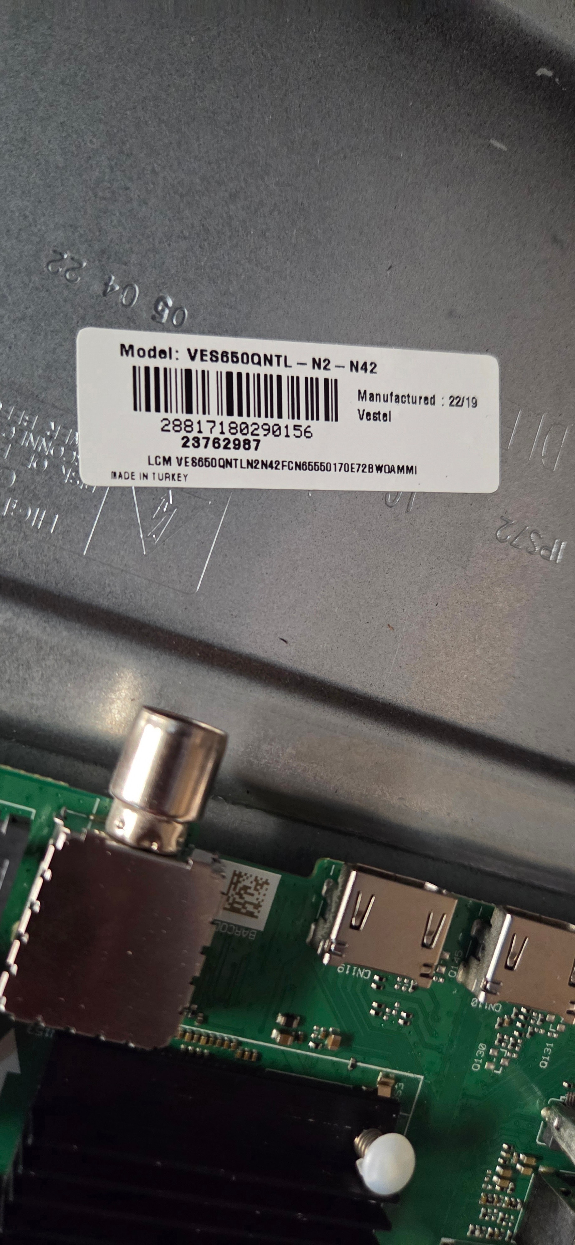

    Hi,
    Thank you very much for the explanations.
    Here is the information:
    Brand: Hitachi
    Main board: Vestel 17MB170E
    Model: VES650QNTL-N2-N42
    Manufactured: 22/19
    Tomorrow, I will try to send pictures as well.

    Initial assessment
    - Thank you for the details. What you called “Model: VES650QNTL‑N2‑N42” is the LCD panel code, not the commercial TV model. That panel is 65" and is used on Vestel sets with mainboard 17MB170E.
    - “Manufactured: 22/19” most likely means year 2022, week 19. Please confirm on the rear label.
    Direct answer
    - I can’t post a generic download link yet. On 17MB170E the rescue/USB firmware must match: brand profile + product/type code + panel code. A near‑match (even same size but N41 vs N42, QNTB vs QNTL, N2 vs 2D) can leave you with no picture or a brick.
    - Once you provide the product/type code from the back label, I will point you to the exact package and the safe flashing procedure.
    What I still need (to identify the exact package)
    Please send clear photos of:
    - Rear sticker: commercial model name (e.g., 65HAK53xx/65HL…), and especially the Product/Type code (typically 10xxxxxx).
    - Mainboard white barcode sticker on 17MB170E (long 23… number).
    - Panel label (to re‑confirm VES650QNTL‑N2‑N42).
    - Region of use (EU/UK/other).
    - Symptom detail: “Memory full” dialog then reboot, or pure boot loop at logo.

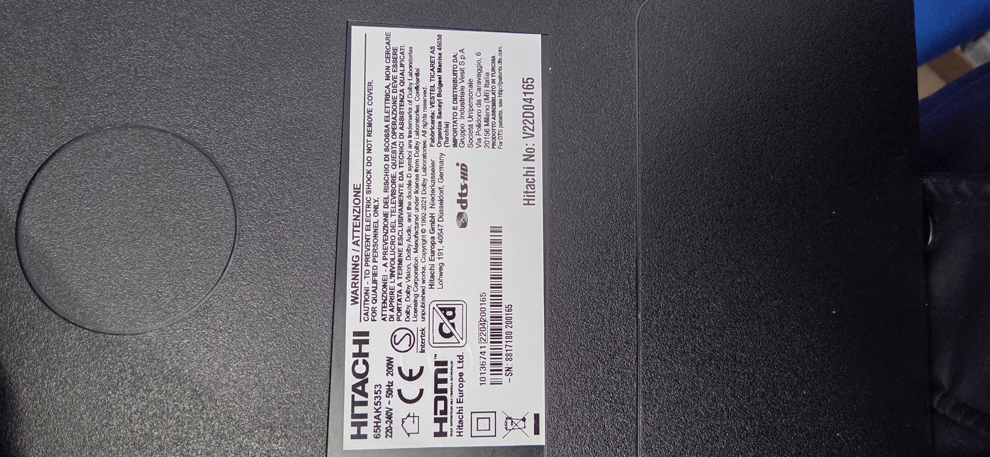

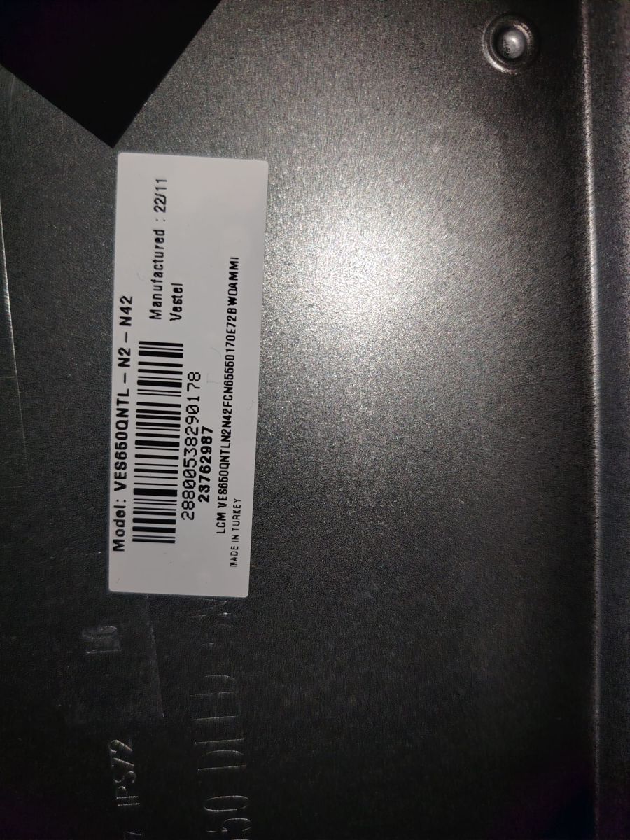

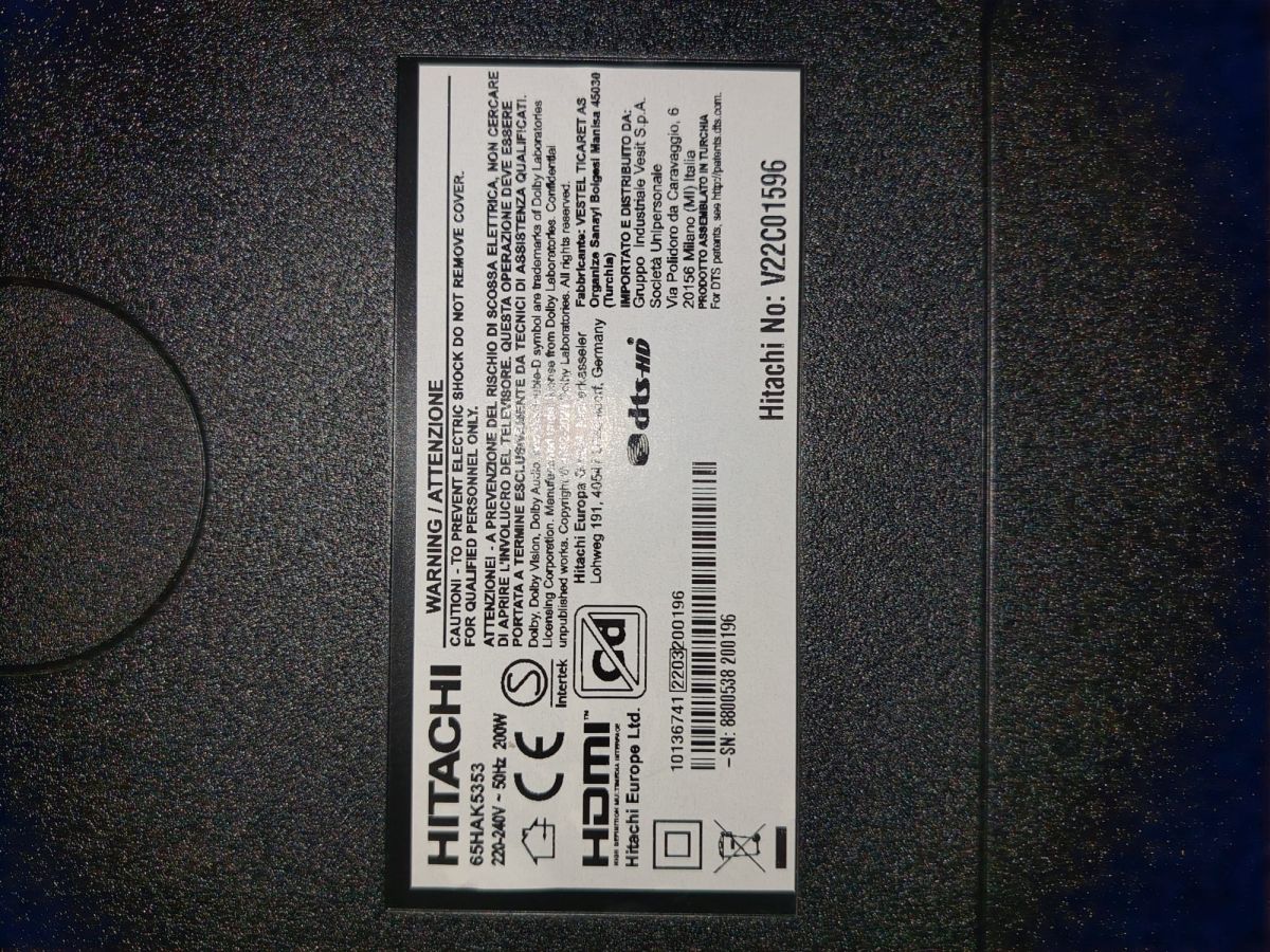

    Luigi_
    Level 4  
    Posts: 7
    >>21846185
    I hope you can find the required information in the attached file.
    If not, I will look for the correct details and send them to you.
    • HITACHI TV Firmware Request for VESTEL 17MB170E Mainboard, VES415QNDR-N2-N41 Panel 20260222_195702 (2).jpg (1.88 MB) You must be logged in to download this attachment.

    Initial assessment of your attachment
    - The photos are clear and very helpful. They show:
    - Mainboard: Vestel 17MB170E (confirmed).
    - Panel label: VES415QNDR‑N2‑N41.
    - Panel manufacture date: week 46 of 2021 (printed “21/46”).
    - Important discrepancy: VES415… is a 41.5" panel used in 43" TVs. That does not match the earlier “65-inch / VES650QNTL‑N2‑N42” you mentioned. Please do not use any 65" firmware—it's incompatible.
    Direct answer to your request
    - I cannot give a safe download link yet. For 17MB170E, the rescue USB must match the exact product/type code and panel. Your photos prove the panel is VES415QNDR‑N2‑N41, so we’re looking for a Hitachi + 17MB170E + VES415QNDR‑N2‑N41 package.
    - With the rear‑label Product/Type code I can point you to the exact package name/checksum and the correct update procedure.
    What is still needed (one clear rear‑label photo will do)
    Please post a sharp photo of the TV’s rear sticker showing:
    - Commercial model name (e.g., 43HAK… / 43HL…).
    - Product/Type code (typically 10xxxxxx).
    - Region (EU/UK marking).
    Also, if possible, a photo of the white barcode sticker on the 17MB170E board (long number starting with 23…).

    - From your photos the correct target is: Hitachi + 17MB170E + VES415QNDR‑N2‑N41 (manufactured week 46/2021).
    - Please post the rear‑label Product/Type code and region. I’ll then match the precise rescue package and give step‑by‑step flashing instructions.
    Questions for you
    - Can you confirm the TV’s actual size (likely 43") and post the rear‑label model and Product/Type code?
    - Region (EU/UK)?
    - Exact behavior: “memory full” message then reboot, or hard boot loop at logo?

    From the attached labels I can identify:
    - Brand: Hitachi
    - Model on rear label: looks like 65HAK5353
    - You previously wrote 65HAK5350. Please check this carefully, because the photo appears to show 65HAK5353.
    - Panel: VES650QNTL-N2-N42
    - Panel manufacture date: 22/11
    - Region: EU
    - Hitachi No.: V2201596
    - Likely Product/Type code: 10136741
    - This appears on the barcode line of the rear label. Please confirm it from the sticker if possible.
    - Additional number visible: 22032600196 — this is probably production/serial/batch information, not the main product code.
    So the correct identification should be approximately:
    > Hitachi 65HAK5353 / 65HAK5350 family, Vestel 17MB170E, panel VES650QNTL-N2-N42, EU, Product code likely 10136741
    Important correction
    In one of the later posts someone wrote:
    > VES650QNTL-N2-N2
    But your panel label clearly shows:
    > VES650QNTL-N2-N42
    That final suffix is important. For Vestel firmware, N2-N2, N2-N41, N2-N42, N2-Z01, etc. must not be treated as the same panel.
