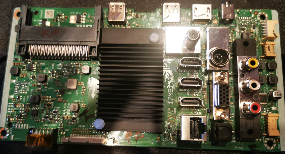

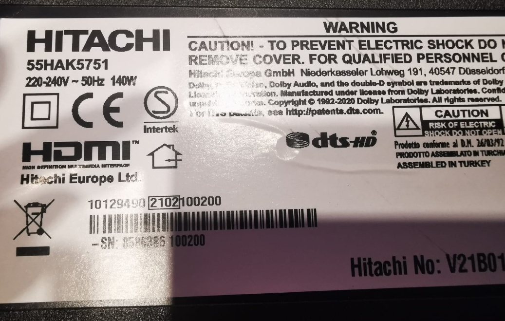

    Hello to all, I need help to solve a problem with a TV from a friend. The main board Vestel 17MB170 10129490 TV HITACHI 55HAK5751 it breaks down and he bought a second-hand one that has sound but no image; this mainboard is for a TV of 50" instead of 55". All steps indicate that we can update the correct code (firmware) to this mainboard and the TV will work.
    Can anyone help me to get this firmware? I attach the pictures of the mainboard and TV model.
    Hitachi device label showing model 55HAK5751, power specs, certification marks, and warning text.
    Device mainboard with heatsink and HDMI, USB, VGA, Ethernet ports plus RCA audio/video jacks

    Can you write the full sticker/label details from the LCD panel and from both mainboards (original and second hand), not only 17MB170 / 10129490?
    Original mainboard TV: HITACHI 55HAK5751. Código Vestel: 10129490. Mainboard: 17MB170. Chassis Vestel Android TV. Panel 55T32-C0L.
    Second-hand mainboard TV: HITACHI 50Hxxxxxx. Mainboard: 17MB170.

    the file I sent you is properly for that tcon module
    if it doesn't work, maybe the 50 inch mainboard can't fit the 55 inch one
    check if there are any component differences in this area
