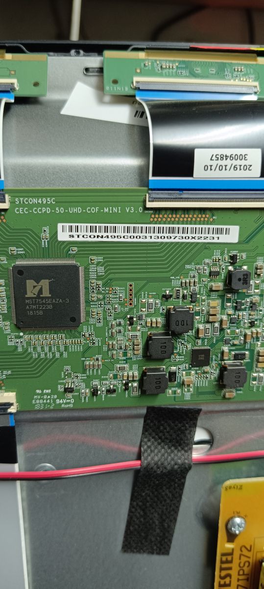

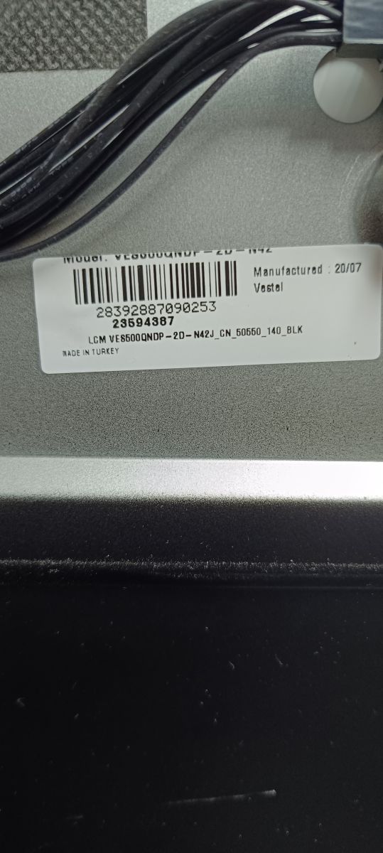

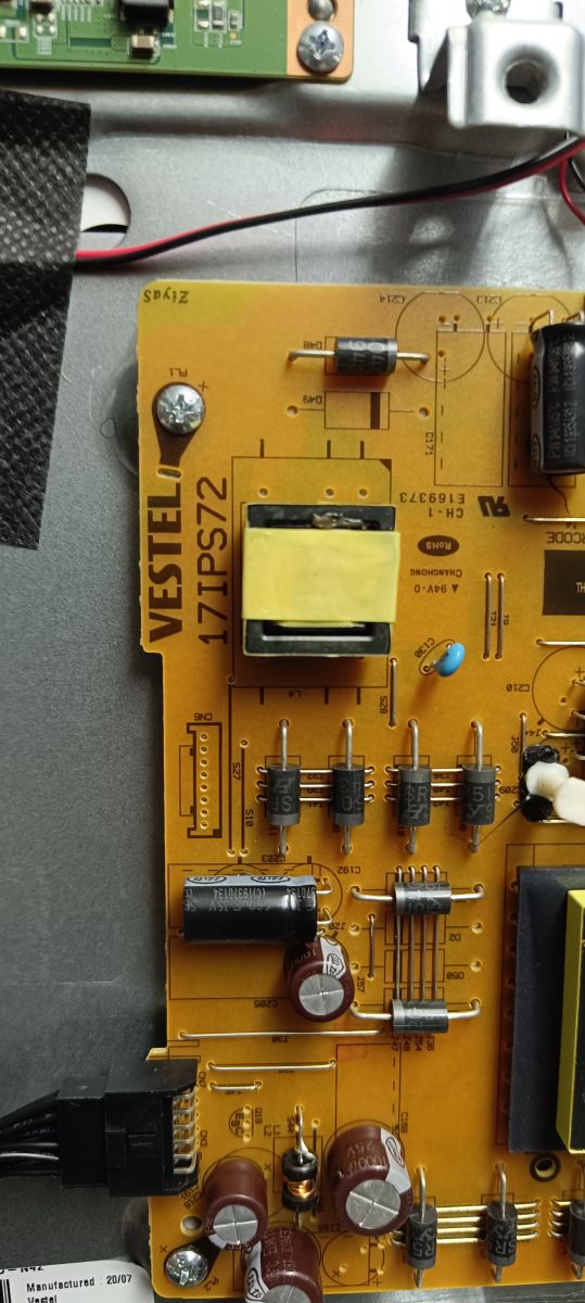

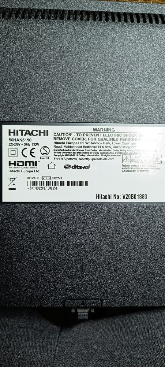

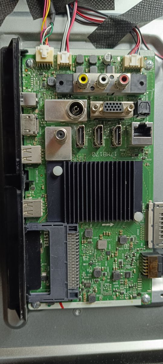

    Firmware needed for Hitachi 50HAK6150
    Vestel 17MB170 (130519R4) mainboard
    VES500QNDP-2D-N42J_CN_50550_140_BLK
    17IPS72 Power
    STCON495C
    I need firmware (USB update package or eMMC dump with connect pins on board) for this TV.
    TV stuck on loops storage space running out.
    Thanks for help.
    T-CON board STCON495C with MST7545EAZA-3 chip and connected signal cables

    usb full software link
    for main 17MB170 panel VES500QNDP-2D-N42 tcon CC495PU1L
    copy the file upgrade_no_tvcertificate.pkg on an empty usb stick
    insert the usb stick in the tv
    then plug the power cord: the recovery will start sutomatically
  • #3 21694203
    tijanatijana
    Thanks for your help.
    The TV is working again.
