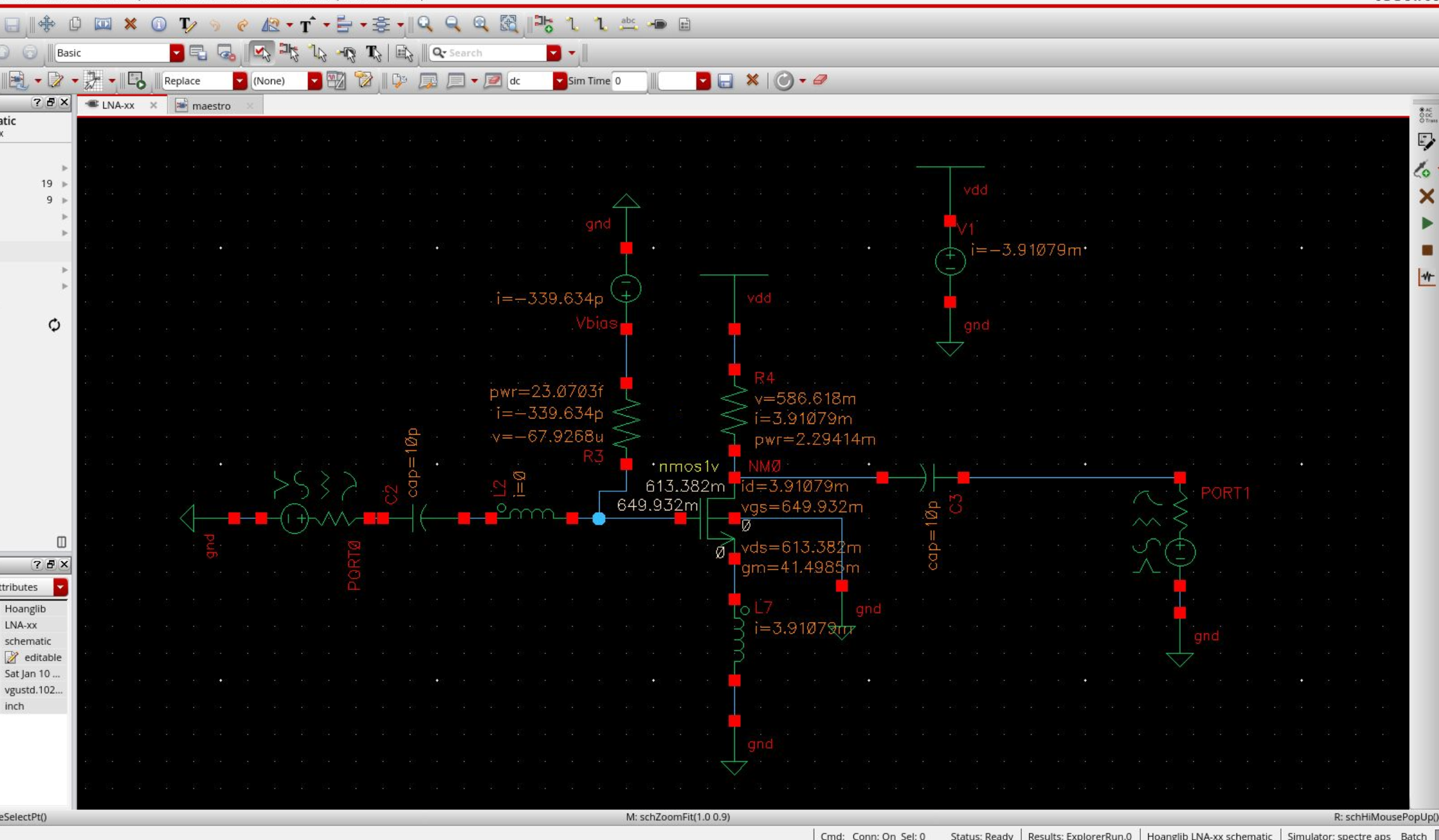

    Low-noise amplifier (LNA) schematic with NMOS transistor and passive components
    @ElektrodaBot I barely design this LNA but it doesn't work. I have problem with the output. The test result is always in the negative range.
    AI: Can you share the schematic or main details of your LNA circuit in gdpk45?
    aim at the output is 2.4 GHz
    AI: How are you testing the output—what input signal, power supply, and measurement setup are you using?
    I use one NMOS. The drain of the NMOS is connected to VDD 1.2 V and a 150 Ω resistor and a capacitance with 10 pF which connects to Port1 50 Ω (the output) that leads to ground. The source on the NMOS is connected to an inductor with 100 pH that connects to ground. The NMOS gate connects to 2 lines, the first line is Vbias at 650 mV wired with 200 kΩ resistor which is a parallel path used to supply DC bias voltage to the gate and the second line is the signal path with Port0 50 Ω (the input) which connects in series with a 10 pF capacitor and a 80 nH inductor.

    Initial assessment of available information
    You built a single‑NMOS common‑source LNA in gpdk45 for 2.4 GHz with:
    - Gate: RF from Port0 (50 Ω) → 10 pF series C → 80 nH series L → gate. Gate DC bias via 200 kΩ to 0.65 V.
    - Source: 100 pH inductor to ground.
    - Drain: to VDD = 1.2 V through 150 Ω; AC‑coupled to Port1 (50 Ω) via 10 pF.
    - Observation: “output is always in the negative range.”
    At 2.4 GHz this network is not a matched RF LNA; component values force severe signal blocking at the input and provide a lossy, non‑resonant output load. The “negative” result most likely means either S21 < 0 dB (attenuation), or simply the expected 180° phase inversion of a common‑source stage in time domain.
    Direct answer to the question
    Your LNA does not work at 2.4 GHz because:
    - The 80 nH series gate inductor presents ≈ j1200 Ω at 2.4 GHz and effectively blocks the RF from reaching the gate.
    - The 100 pH source inductor is ≈ j1.5 Ω at 2.4 GHz and provides essentially no inductive degeneration for 50 Ω input matching.
    - The 150 Ω drain resistor is a poor RF load at 2.4 GHz, wastes headroom, and with a simple 10 pF coupling capacitor gives no output resonance or matching to 50 Ω.
    Replace the gate and source inductors with realistic nH‑range values and use an inductive/tuned load at the drain. Then design proper input and output matches.

    1) Input path (Port0 → C_series 10 pF → Lg 80 nH → gate)
    - Reactances at 2.4 GHz:
    - X_L(80 nH) ≈ +j1206 Ω
    - X_C(10 pF) ≈ −j6.6 Ω
    - Consequence: the 80 nH dominates; the source sees ~1.2 kΩ in series. Almost all incident power is reflected (S11 ≈ 0 dB), so S21 appears “negative”.
    2) Source degeneration (Ls = 100 pH)
    - X_L(100 pH) ≈ +j1.5 Ω at 2.4 GHz.
    - In an inductively degenerated CS LNA the source inductance sets the real part of Zin and helps the 50 Ω match. 1.5 Ω is far too small; typical Ls is in the few‑hundred‑pH to low‑nH range, depending on gm and Cgs.
    3) Drain/output network (Rd = 150 Ω, C_cpl = 10 pF to Port1 = 50 Ω)
    - X_C(10 pF) ≈ −j6.6 Ω, so the output is just AC‑coupled into a 50 Ω load with no impedance transformation.
    - With a 150 Ω resistive load to VDD, small‑signal gain magnitude is roughly |Av| ≈ gm·(Rd || 50 Ω || ro). That is limited, and the lack of a resonant Ld–Cd tank at 2.4 GHz removes the gain “boost” you expect from an RF LNA.
    - Headroom: with a few mA drain current, the 150 Ω drop eats 0.3…0.8 V from 1.2 V supply, pushing VDS close to the edge and reducing gain and linearity.

    - Gate path design: Choose Lg to resonate the net input capacitance (≈ Cgs + Cpad + part of Cgd) at 2.4 GHz, after accounting for Ls. The condition Imag{Zin} ≈ 0 near f0 gives Lg ≈ 1/(ω0^2·Cgs_eff) − Ls. That places Lg in low‑nH for realistic Cgs_eff (hundreds of fF to a couple pF).
    - Real part for 50 Ω: Increase Ls until Re{Zin} ≈ 50 Ω at f0. In practice you sweep Ls and watch S11; gm and Cgs at the chosen bias determine the exact Ls needed.
    - Output load: Use an Ld from drain to VDD as an RF choke and to form a parallel resonance with the drain capacitance (Cgd/Cdb/Cwire). Pick Ld ~ 1–5 nH, then compute Cd so f0 = 1/(2π√(Ld·Cd)) ≈ 2.4 GHz. Follow with a simple L‑match or just set the coupling capacitor and a shunt C/L to transform the tank impedance to 50 Ω.
    - Biasing: Keep the drain near mid‑supply for swing and saturation. An inductive load preserves DC headroom (no DC drop). Your 200 kΩ gate bias is fine for RF isolation; ensure the bias node is well decoupled to ground at RF.
    Practical guidelines
    Start with a minimal, working RF topology:
    - Input
    - Ls: 0.3–1.0 nH (initial guess).
    - Lg: 1–5 nH (tuned so Imag{Zin} ≈ 0 at 2.4 GHz).
    - Keep the 10 pF series cap only if you need DC block; at 2.4 GHz 10 pF is large. 200–1000 fF is often sufficient and occupies far less area on silicon.
    - Transistor
    - Use minimum L; choose W and bias for gm in the 20–60 mS range at your power budget. Multi‑finger layout is essential to keep gate resistance low.
    - Drain/output
    - Replace 150 Ω with Ld ≈ 2–4 nH to VDD.
    - Tune Cd so Ld//Cd resonates at 2.4 GHz (Cd is the sum of explicit cap plus parasitics).
    - AC‑couple to Port1 with a modest C (e.g., 300–800 fF) and add a shunt C or series L as needed to achieve S22 < −10 dB.
