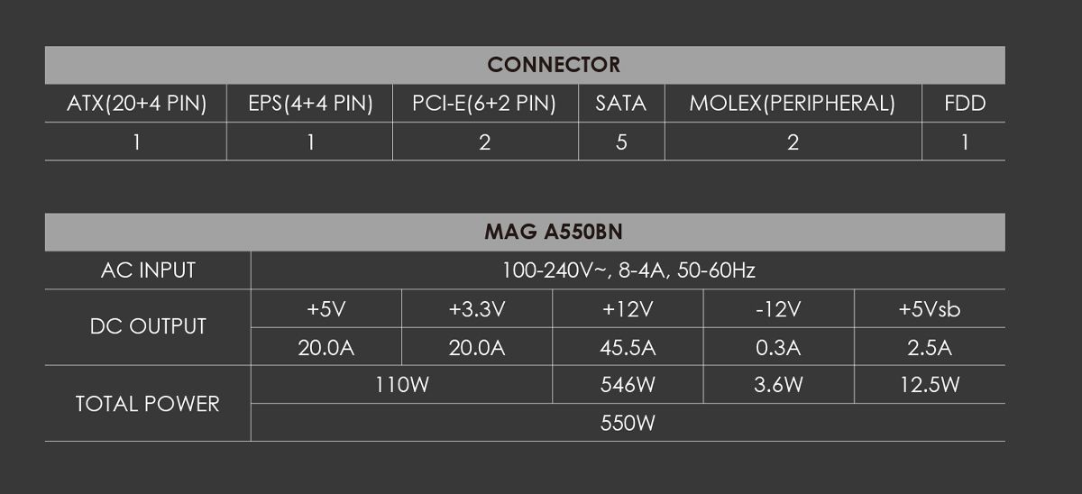

    ancanar wrote:
    Should I pay attention to that third item? There it is 100W as you recommended, but after multiplying the V*A of these figures separate for line 5 and 3.3 it comes out below 100W on both.
    In fact, verify it. With new PSUs the 3.3V and 5V lines can be very weak (as they are increasingly irrelevant in new computers), with old hardware it makes sense to have a combined output of around 100 W on them, this is enough for most old configurations you would want to make and use a relatively new PSU for them.
    In the spread you cite, everything is correct.
    There is 5V/16A = 80W.
    3.3V/17A = 56W
    The total load cannot exceed 100W on these.
    In the same way, it's common to see something like this on a split 12V line - some amps on one, some on the other, but in total less than the summation of the load capacities of the two lines.
    ancanar wrote:
    Well, that's what gets lost a bit already. Wouldn't you like to give some specific model so that it works reliably and without overpaying?
    https://www.morele.net/zasilacz-endorfy-vero-l5-bronze-500w-ey7a004-12907331/ - on promotion 159. Good for a new computer, the old one can be powered up too - it's a decent model overall.
    https://www.morele.net/zasilacz-msi-mag-a550b..._id=9968&promotion_name=Podbij+ranking%21 - also ok, also recommended, as for me it has slightly worse components than the Vero, but in tests it performs well. No label here, so searching on google:
    Specification table of MSI MAG A550BN 550W power supply
    https://www.morele.net/zasilac...omotion_name=Podbij+ranking%21 - also ok, also recommended, for me it has slightly inferior components to the Vero, but in tests it performs well. No label here, so searching on google:
    Only these just happen to have few Molexes (1 and 2). How is it with these adapters from sata possibly? Because if I use one for the card, I have one left and it should not be divided into 4? If I look at it like that, the ones with at least 4 molexes start from 300 PLN :/ I found only one more cheap chieftec with more molexes: https://www.komputronik.pl/product/698431/chieftec-tps-500s-bulk.html It has the same number of molexes as the previous chieftec, but it has 80 Plus Bronze (that one is only plus). From what I've read, SATA to Molex adapters should rather be avoided?
    And btw - the ones marked ATX 3.0 and ATX 3.1 are also suitable, right?

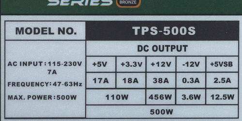

    I keep looking and I think I finally came across something good: https://pl.thermaltake.com/smart-bx1-550w-230v.html
    It's not some most expensive one, has 4 molexes and a max load on 3.3/5 of 105W. The question is, is it still a reputable manufacturer? (I see different opinions even in the "blacklist" topic itself)
  • Manufacturer name alone is not enough to judge PSU quality

    Buy two of these and it will probably be enough for you, and you won't have to look too hard for power supplies.

    Yes, just a shame to buy a power supply much more expensive than the rest of the hardware :)
    ancanar wrote:
    Just asking if it's still a reputable manufacturer?
    What I've said many times - you can't judge whether a power supply is good just by the manufacturer's name. It used to make sense when the manufacturer had one model of power supply and different wattages only. Now such a Chieftec or even Thermaltake has 20 different models with a full range of wattages from low to high - and these are power supplies from very weak and unworthy of buying, through reasonable to top power supplies. So a black list in such a format, distinguishing only by the manufacturer's name, makes little sense at present in my opinion.
    As far as Thermaltake is concerned, the BX1 is an entry-level model, I've never had it, it's hard for me to say anything about it.

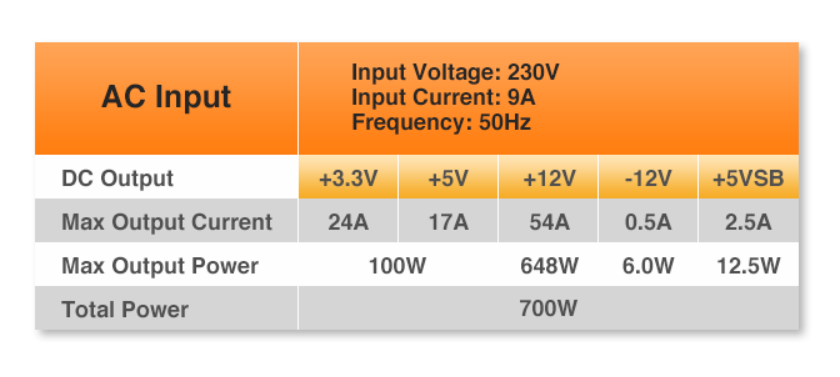

    Ew. from more expensive ones such Thermaltake: Smart BM1 700W https://www.alsen.pl/thermaltake-zasilacz-smart-bm1-700w-modular-80-bronze-single-rail is it a better series than this BX1? Interestingly, the TPS has a higher amperage than this chieftec at 3,3 and 5 and a total of fewer watts. Caution on the part of the manufacturer in their declaration?

    You can look for a grommet like this one:
    https://en.varia-store.com/product/delock-65606-368091-power-cable/
    As long as it costs 20-30 zl, not 100 or more.
    Alternatively, if you don't have anything to do with your newly bought power supply anyway, you can unplug and insulate the extra wires and cut off the redundant part of the plug.
    Both of these power supplies are budget power supplies, so they won't knock your socks off. You'll need to look in the specifications for ones that have the connector described as 20+4 pin (not 24 pin).
