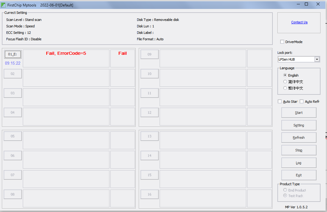

Hi, I need to flash my USB because it shows no media
This is the ChipGenius description:
Description: [E:]Dispositivo de almacenamiento USB(NAND USB2DISK)
Device Type: Mass Storage Device
Protocol Version: USB 2.00
Current Speed: High Speed
Max Current: 100 mA
USB Device ID: VID = FFFF, PID = 1201
Device Revision: 0000
Manufacturer: NAND
Product Model: USB2DISK
Product Revision: 0.00
Controller Vendor: FirstChip
Controller Part-Number: FC1178BC
Flash ID code: 453E9803766C - SanDisk - 1CE/Single Channel [TLC] -> Total Capacity = 64 GB
I tried to flash with many FirstChip MP-Tools versions, but the only one that showed the USB was the FirstChip 2022-06-04
After 9 hours of waiting, it shows the fail=error code 5
This is the copied error message: Device_1, FlashId: (null) ErrorCode(5), Descript: Verify data failed
What do I do
AI: when you plug the usb into your computer, does it show up in windows disk management or any other tool? if so, what does it look like there (unallocated, raw, or not detected at all)?
It shows no media
AI: in mp-tools, did you try any specific settings or firmware options, or just the default process? can you share exactly what steps you followed during the flashing attempt?
The default process, I may in part need to know what settings to use
