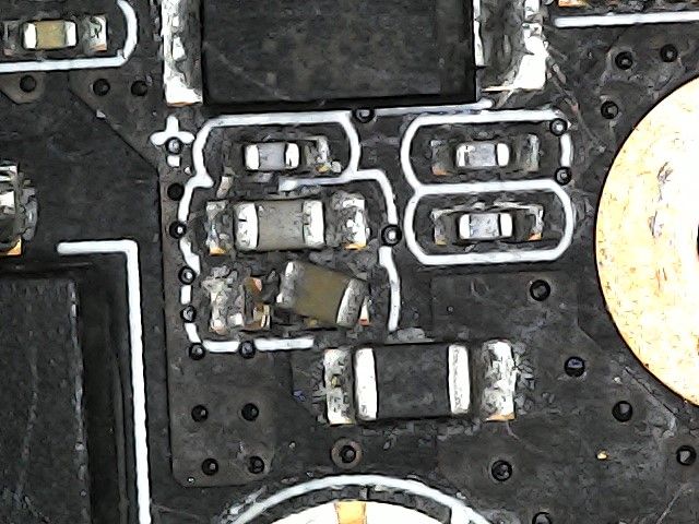

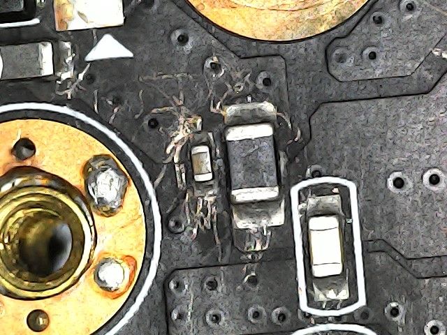

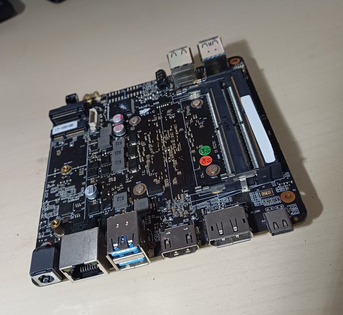

    I'm from Portugal and I'm an electronics enthusiast. Some time ago I acquired an Nvisen Y MU01 mini-PC.
    "https://minixpc.com/products/nvisen-y-mu01-mini-pc-intel-core-i7-8565u-i7-10510u-2-ddr4-256-512g-intel-hd-graphics-windows10-linux?variant=42011720515818".
    It worked very well, and one day it stopped working.
    I opened the PC and noticed capacitors on the 19 V input that were damaged, as well as near the power-on switch.
    I've searched many websites, but I can't find the motherboard schematic to know the value of the capacitors, because they are SMD (synthetic capacitors) and they are burned out.
    Would it be possible for someone provide me with the electronic schematic of this motherboard?
    If possible, I would greatly appreciate it because I love this PC and want to try to fix the problems it has.
    I sincerely apologize for the inconvenience. If no one can provide the schematic, could possibly indicate a website where I can view it?

    If you have a short circuit on the capacitors then you need to look further as it is virtually impossible that only a few capacitors have been damaged with no other damage.
    Probably if you have measured the resistance it refers to the whole circuit and not to one or a few capacitors.
    As for the schematic or boardview I doubt it exists.

    Give a photo of these capacitors and mark them.

    I cannot find schematic or boardview for this mainboard. Can you take a clese-up photo of this region, mark a place where the components used to be (if it is not obvious from the photo) and post it here? If these capacitors are connected directly in parallel to DC Jack, their value is not that critical and we can look for similar designs.

    Hi
    First image is near input 19v(top)
    Second is also near input 19v(down)
    Third the board
