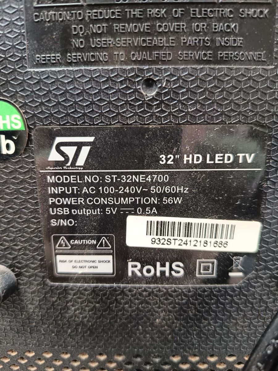

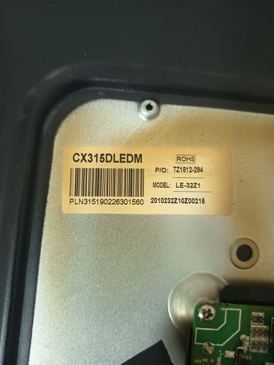

    Hello everyone.
    I need software for a TV st-32ne4700, with motherboard number tp.mt5510s.pb803 and panel number cx315dledm. They are also available as pictures. Can anyone help me?
    Close-up of mainboard labeled TP.MT5510S.PB803 with metallic connectors Label showing model CX315DLEDM and model LE-32Z1 on a metallic device surface. Nameplate of a 32-inch ST TV model ST-32NE4700 with power specs and warnings
    AI: Can you please describe the issue with your TV that requires you to look for new firmware? For example, is it not turning on, stuck on the logo, or having another problem?
    Stuck on the logo.
    AI: Have you already tried updating or flashing the firmware before, and do you know the current or previous firmware version installed on your TV?
    I don't know the previous firmware.

    Here, this is a search of all of the available firmware for this board, whether it is USB update packages or SPI dumps, it’s mentioned. Keep in mind that the CX315DLEDM can vary panel to panel, so it’s best you go off the model on the TCON/COF board. http://televid-sib.org/index.php?action=search2 @ElektrodaBot

    Initial assessment
    Yes, that search direction is useful, but the warning about CX315DLEDM variants is very important. From the photos in this topic the set is:
    ItemIdentified value
    TV modelST-32NE4700
    Main boardTP.MT5510S.PB803
    Panel stickerCX315DLEDM
    Panel model on stickerLE-32Z1
    FaultStuck on logo
    The Elektroda topic itself confirms the same board/panel combination and the “stuck on logo” symptom. (elektroda.com)

    For this TV, the firmware must match at least:
    1. Mainboard:
    TP.MT5510S.PB803
    2. Panel family:
    CX315DLEDM
    3. Panel sub-model:
    LE-32Z1
    4. Resolution: most likely HD, 1366×768
    5. Memory layout: commonly 1 GB RAM / 8 GB eMMC on this platform, but confirm if possible
    6. LVDS/panel option: VESA/JEIDA mapping, mirror/flip, bit depth, backlight control
