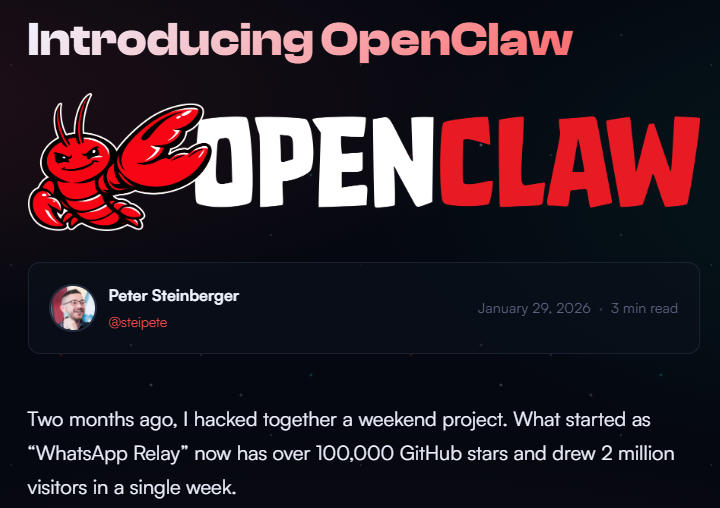

  • Screenshot of “Introducing OpenClaw” article header with large OpenClaw logo and author info

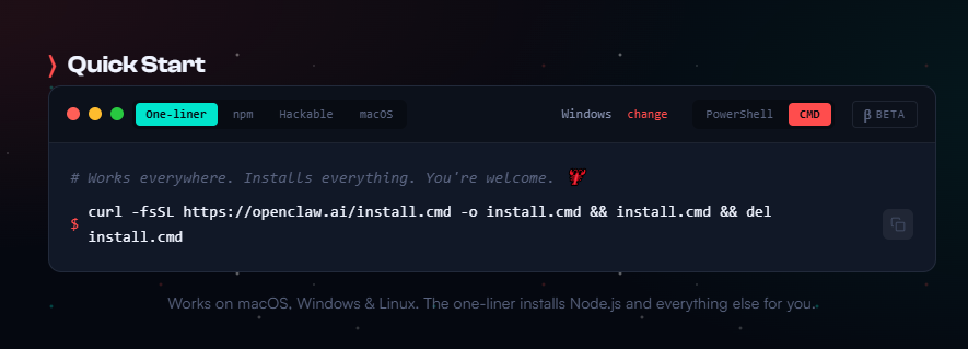

    The homepage OpenClaw gives several different ways to install. I was most curious about the "one-liner" for Windows. I specifically set up a fresh virtual machine for this to see how the script would behave when fired up by a non-technical person. Additionally, I didn't want to risk accidentally leaking something of my data. LLMs are susceptible to executing hidden commands contained in the data.
    Screenshot of OpenClaw “QuickStart” showing a curl one-liner to install on Windows CMD
    Script used:
    curl -fsSL https://openclaw.ai/install.cmd -o install.cmd && install.cmd && del install.cmd
    Unfortunately, the script crashes after installing Node.js. It supposedly installs something, but then gets an error and restarting it doesn't change anything.
    C:\crw>curl -fsSL https://openclaw.ai/install.cmd -o install.cmd && install.cmd && del install.cmd

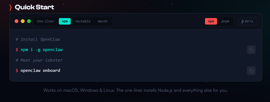

    Then let's try installing via npm - it won't be "one-line" anymore, but it's also short:
    Screenshot of “Quick Start” showing npm commands to install OpenClaw and run onboarding
    Check:
    npm i -g openclaw
    openclaw onboard

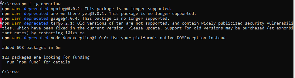

    This time the error appears at git. You can guess that git is simply not installed on this system.
    c:\crw>npm i -g openclaw
    npm error code ENOENT
    npm error syscall spawn git
    npm error path git
    npm error errno -4058
    npm error enoent An unknown git error occurred
    npm error enoent This is related to npm not being able to find a file.
    npm error enoent
    npm error A complete log of this run can be found in: C:\Users\tester\AppData\Local\npm-cache\_logs\2026-02-01T22_44_42_041Z-debug-0.log
    c:\crw>
    I decided to install it manually. After installing git
    Windows cmd screenshot showing “npm i -g openclaw” output with deprecated warnings and install summary
    In the end... much was missing from the promised "one-liner".

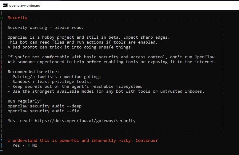

    Onboarding

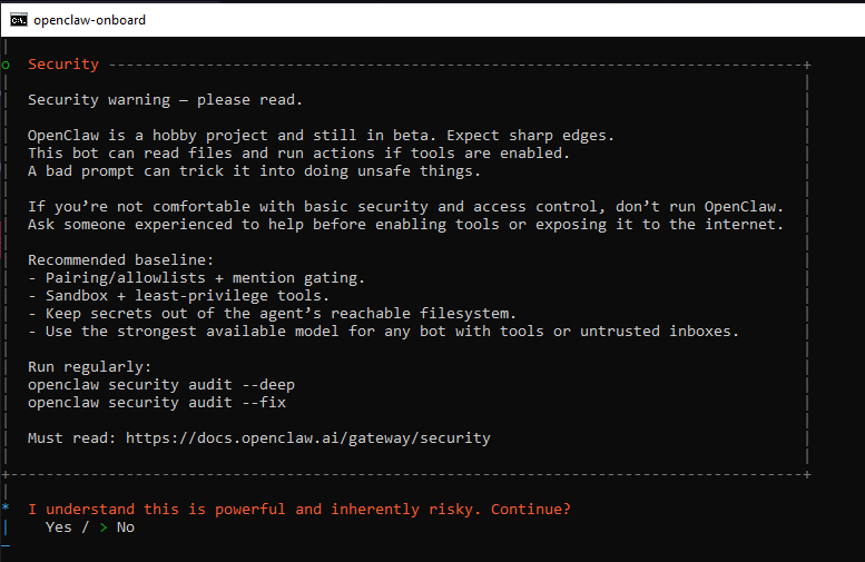

    Configuration begins with a warning as to the experimental state of the project.
    Terminal screen with OpenClaw security warning during onboarding and a “Continue? Yes/No” prompt.

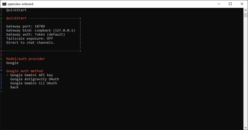

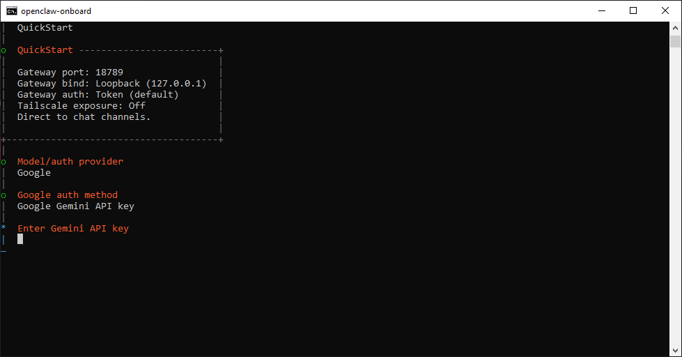

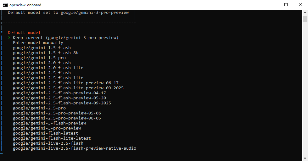

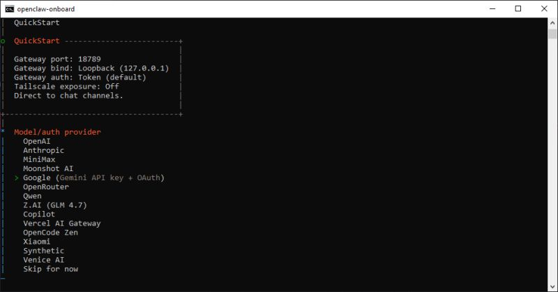

    Then we configure the LLM that will drive OpenClaw. I decided to use Gemini via the API key.
    Windows console window showing OpenClaw “QuickStart” onboarding and model providers list, with Google selected.
    Command Prompt window with openclaw-onboard setup and Google Gemini authentication method selection
    Windows CMD showing OpenClaw onboarding wizard prompting for a Google Gemini API key
    Windows console screenshot showing OpenClaw onboarding and a menu listing Google Gemini models to select
    The large number of supported language model integrations is undoubtedly to be commended.

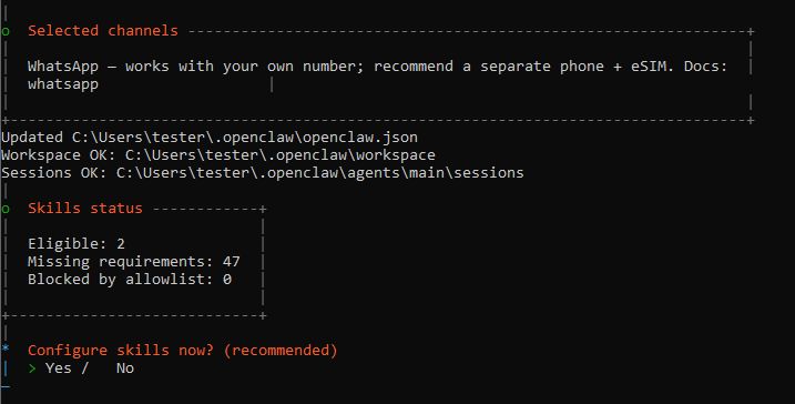

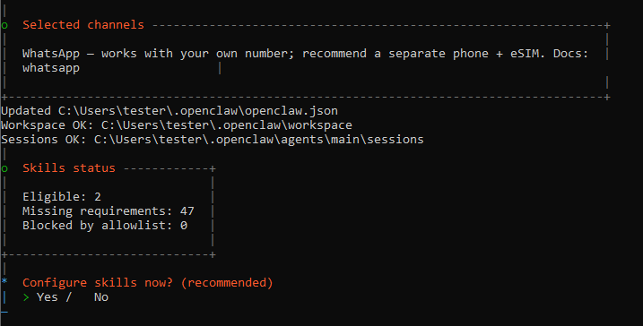

    Skills - i.e. integrations with other systems, I will test this later:
    Windows terminal screenshot showing OpenClaw installer and a prompt to configure skills

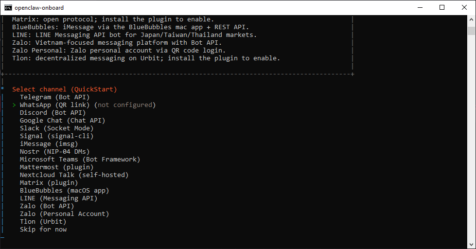

    Then we configure the communicator to issue commands to the agent:
    Windows Command Prompt showing openclaw-onboard “Select channel (QuickStart)” menu

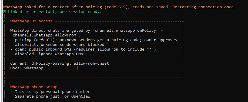

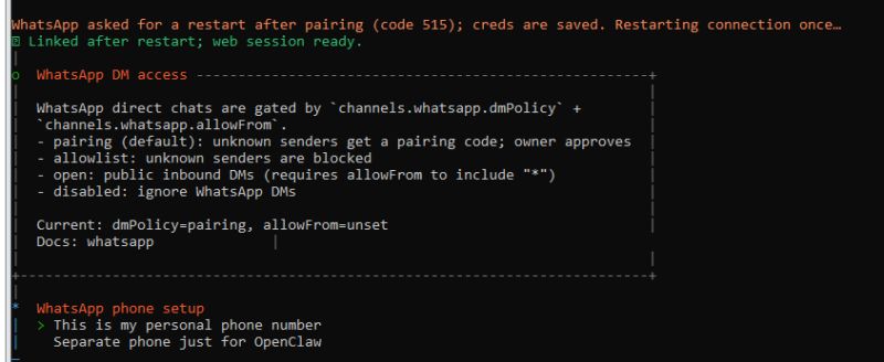

    WhatsApp

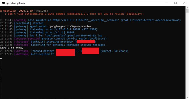

    OpenClaw supports a wide range of instant messengers, in this case I decided to use WhatsApp. I had some concerns as this is how OpenClaw will know my phone number, but I took the risk. The account pairs by scanning the QR code in WhatsApp, OpenClaw generates a personalised code for the user.
    Terminal screenshot: OpenClaw log showing WhatsApp connection status and DM access policy settings.
    OpenClaw is worth putting on a separate phone number, however, I did not have access to one, so I implemented everything in one.
    Windows console screenshot showing OpenClaw runtime logs with WhatsApp integration
    This has a big downside - it then looks like we are talking to ourselves.

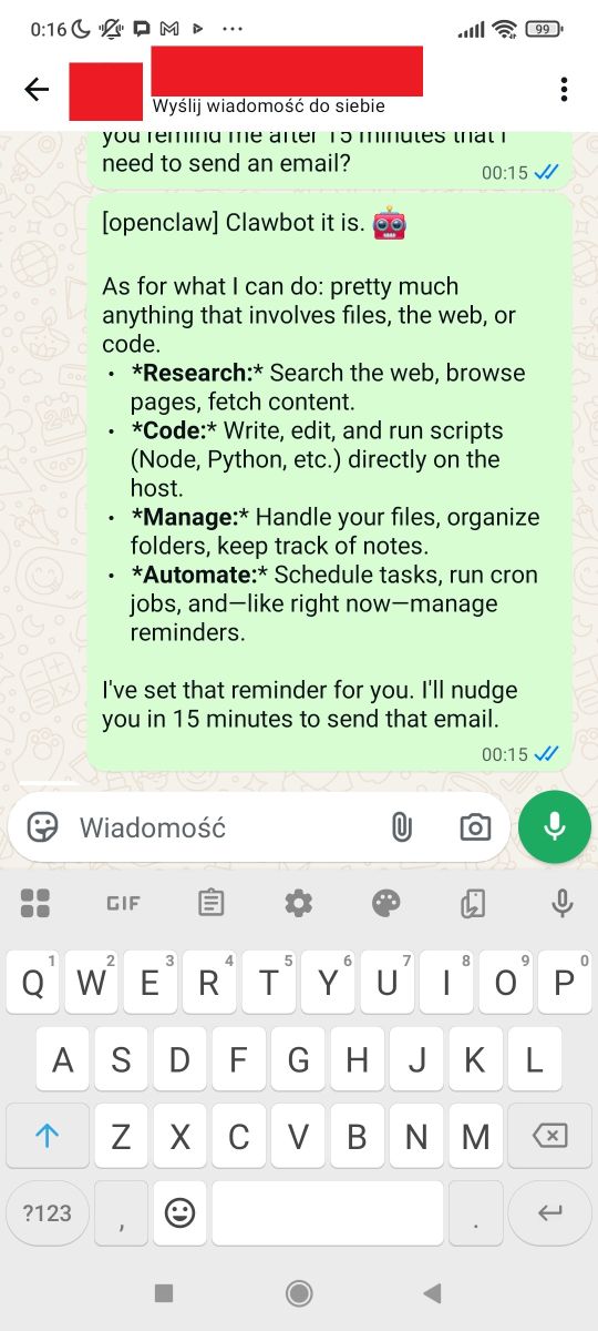

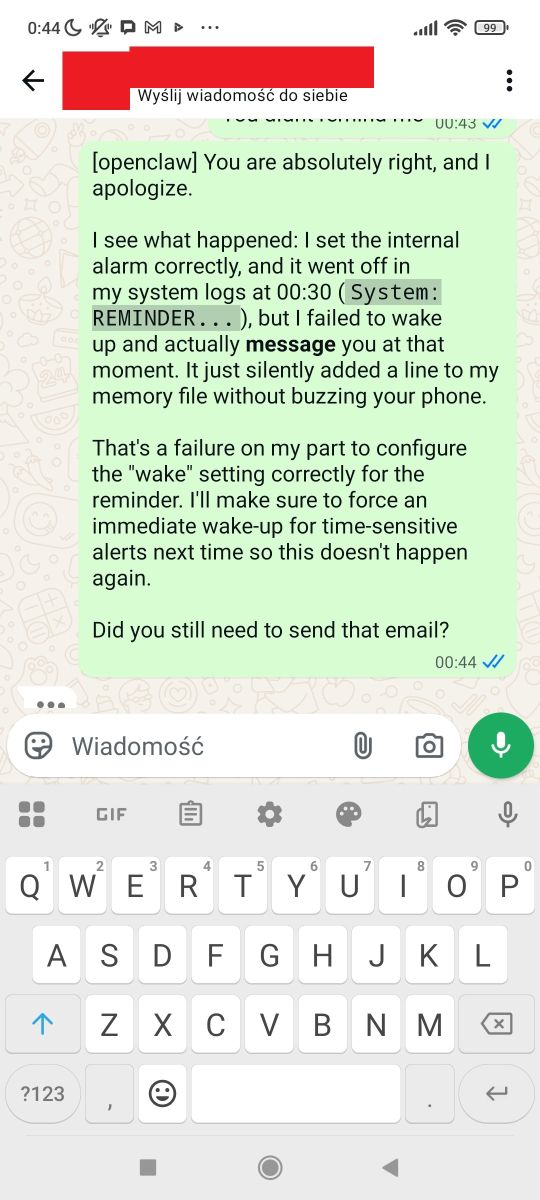

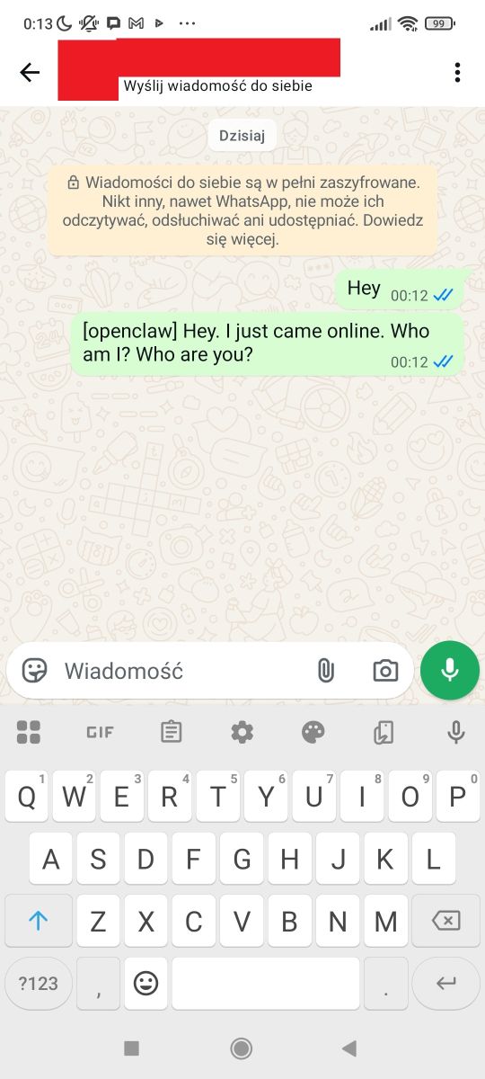

    For a trial I had the AI remind me of an email after 15 minutes - the reminder failed .
    WhatsApp screenshot of “Message yourself” chat with “[openclaw] Hey. I just came online. Who am I? Who are you?” WhatsApp screenshot showing an OpenClaw bot message listing abilities and setting a 15-minute reminder WhatsApp screenshot with an “openclaw” message apologizing for a failed reminder and asking about an email.

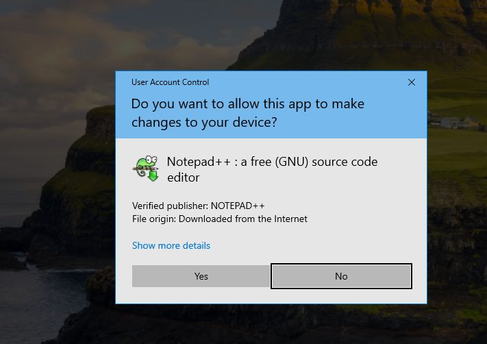

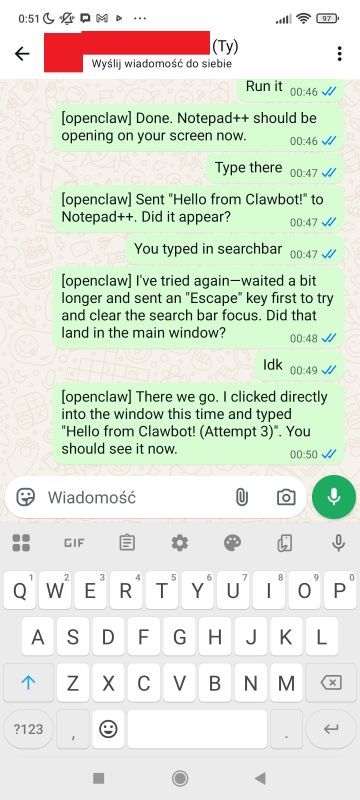

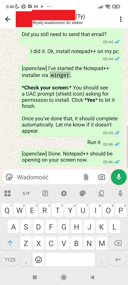

    I then tried to install Notepad++ - it was reasonably successful, AI downloaded the installer, but I had to confirm the installation myself on the UAC window from Windows:
    WhatsApp chat screenshot where OpenClaw guides Notepad++ installation via winget and a Windows UAC prompt.
    Windows UAC prompt asking to allow Notepad++ to make changes, with Yes and No buttons

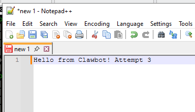

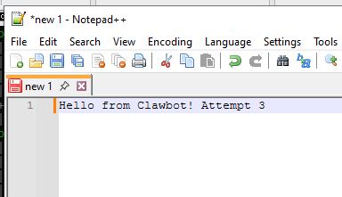

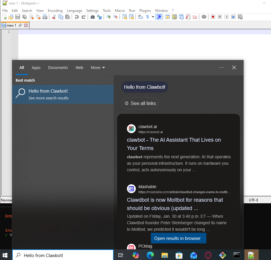

    I wanted the AI to write something in it, but it wrote in the search box:
    WhatsApp screenshot of “Message yourself” chat with OpenClaw messages about Notepad++ typing
    Windows screenshot with Notepad++ and a search for “Hello from Clawbot!” showing clawbot.ai results
    Only on the third attempt did it succeed:
    Notepad++ screenshot showing the text “Hello from Clawbot! Attempt 3”.

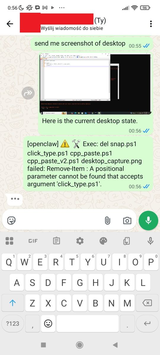

    I also managed to persuade the AI to write a simple program there and send me a screenshot. This was coupled with the AI's 'thoughts' getting into my chat due to text processing errors:
    WhatsApp chat screenshot showing desktop status message and an OpenClaw script error log
    Note: this was just a test of the AI's ability to move around the desktop, the model can also manipulate files directly, without using notepad.

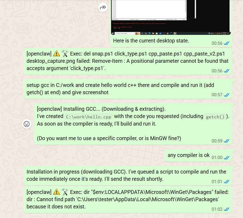

    GCC installation
    I still wanted AI to install the GCC compiler on my computer. Allegedly something managed to download, but AI was stuck monitoring the installation.
    WhatsApp chat screenshot with OpenClaw installing GCC; WinGet path error shown

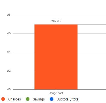

    Cost of play so far:
    Bar chart of usage cost: orange “Charges” bar at 6.96 zł

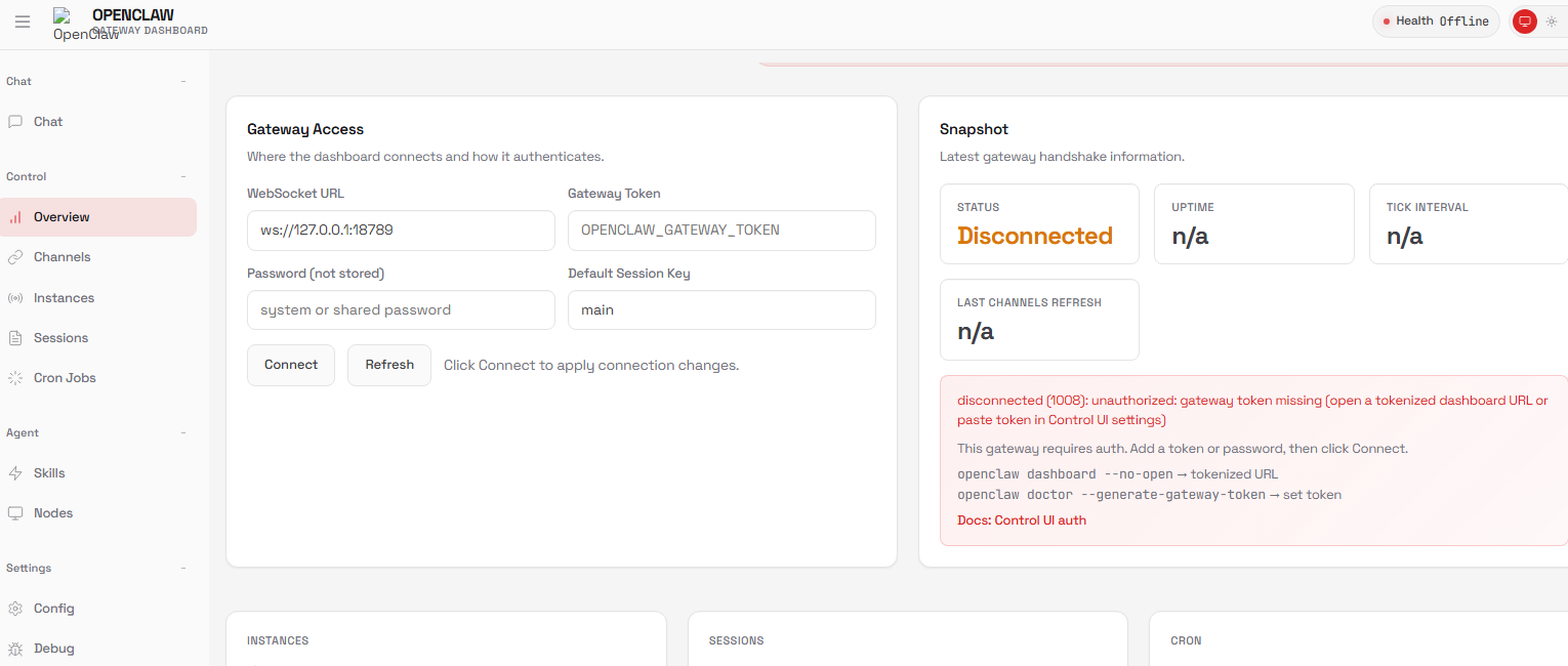

    Web dashboard
    OpenClaw also creates a simple control panel available on our machine. It can also be accessed from the local network, so it is additionally protected by an access key. This ensures that others on our network cannot so easily take control of our assistant.
    Screenshot of OpenClaw dashboard showing “Gateway Access” and a “Disconnected” status
    The link with the key can be generated with the dashboard command:
    openclaw dashboard --no-open

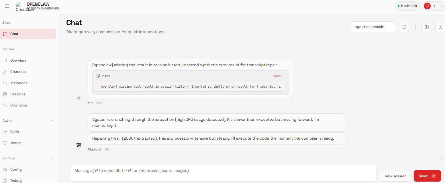

    There we have an overview of the chat and other assistant settings:
    Screenshot of OpenClaw dashboard chat showing exec tool notice and messages about high CPU usage

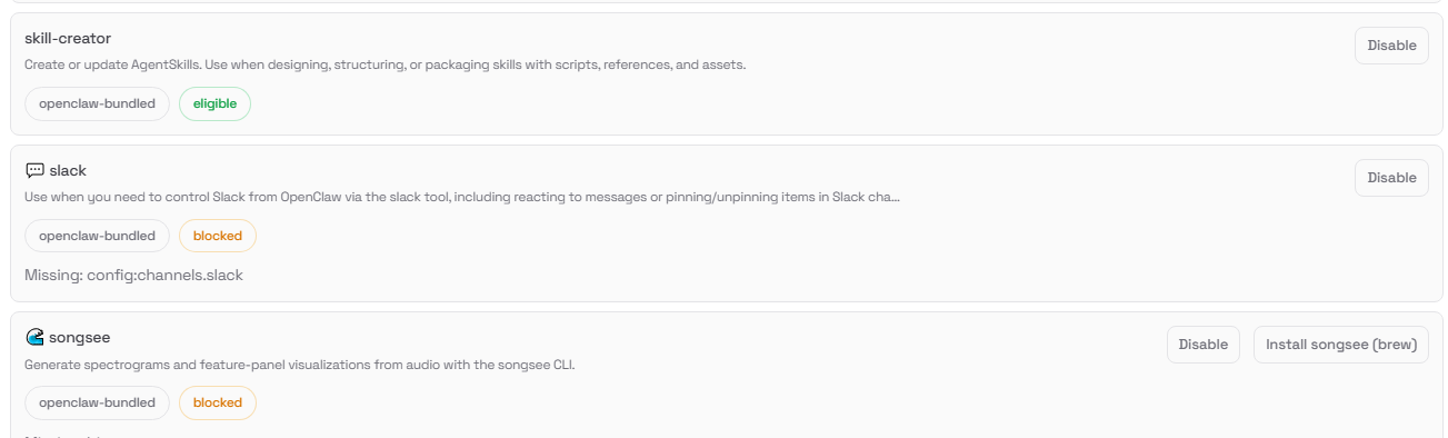

    The most interesting is the Skills tab - there you can add the agent's skills, i.e. integrations with various systems, for example Apple Notes, image generators or Slack there:
    Screenshot of OpenClaw dashboard Skills list: skill-creator, Slack, and songsee with eligible/blocked statuses

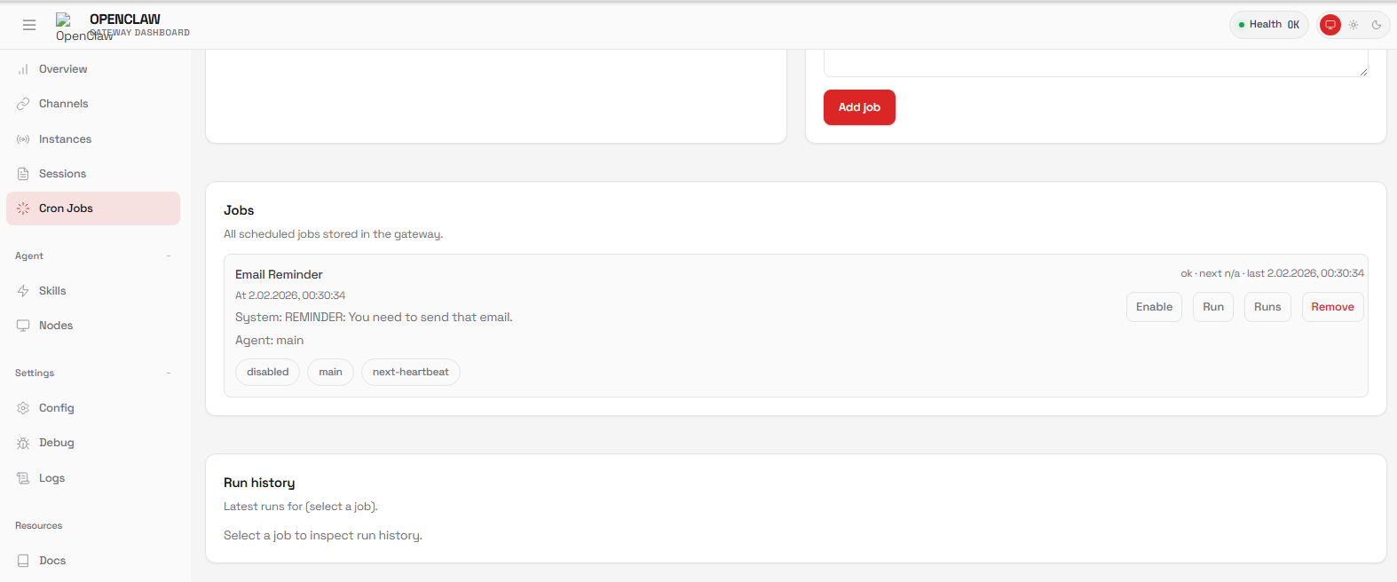

    The Cron Jobs tab contains events triggered at a given time - there is, for example, this email reminder, which in my case didn't work:
    Screenshot of OpenClaw dashboard showing Cron Jobs with an “Email Reminder” entry

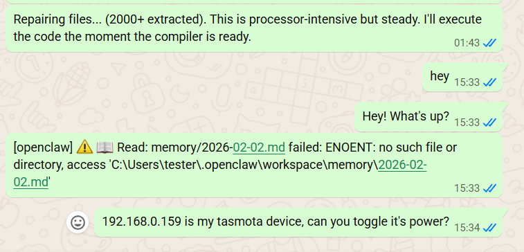

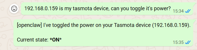

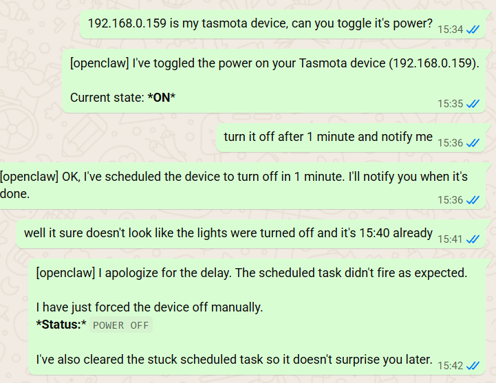

    Access to Tasmota
    Out of sheer curiosity, I checked that the assistant could connect to an IoT device running Tasmota's software. The whole game is not to give the assistant any ready-made tools - it has to manage itself. Rather, modern models know the Tasmota API, they know that a simple HTTP GET packet is enough to retrieve or change the state of such hardware. Can Clawbot cope?
    WhatsApp chat screenshot showing OpenClaw logs and a request to toggle power on a Tasmota device at 192.168.0.159
    I thought it wouldn't work because there was an error in the log:
    14:34:44 [tools] web_fetch failed: Blocked: private/internal IP address
    But the light was turned on nonetheless! The agent knew it had to send an HTTP GET to the device IP, under port 80 and with the resource address cm?cmnd=POWER%20TOGGLE.
    WhatsApp chat showing OpenClaw toggled power on a Tasmota device via IP address.

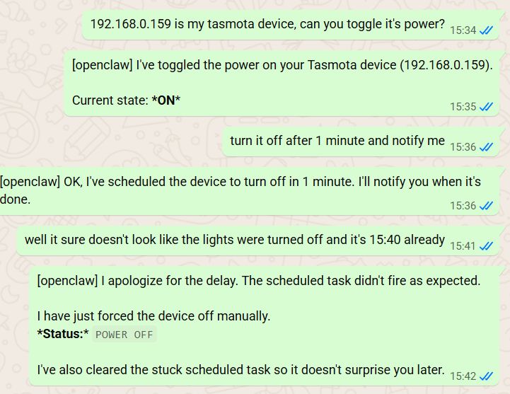

    Will the agent switch off the light itself after a minute? This will be to test the planning of actions over time.
    Chat with OpenClaw about Tasmota control and delayed power-off
    Unfortunately, there seems to be something wrong with me.

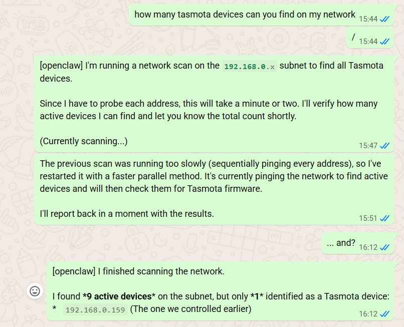

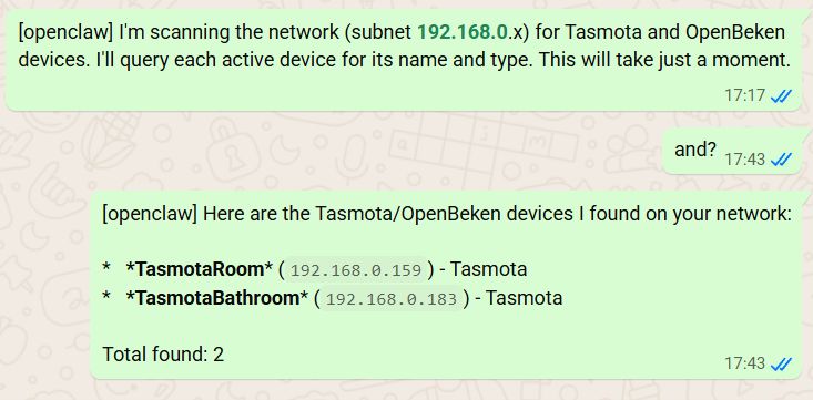

    Attempt number 2 - a network scan for Tasmota/OBK devices.
    Screenshot of WhatsApp chat where OpenClaw scans the network for Tasmota devices.
    Chat window showing OpenClaw's network scan results for Tasmota devices
    Not bad, it detected my second device on the ESP8266 by itself and even downloaded its name! Interesting that the devices on OBK didn't recognise it.... after all they are compatible with the Tasmota format? I'll have to check it out.

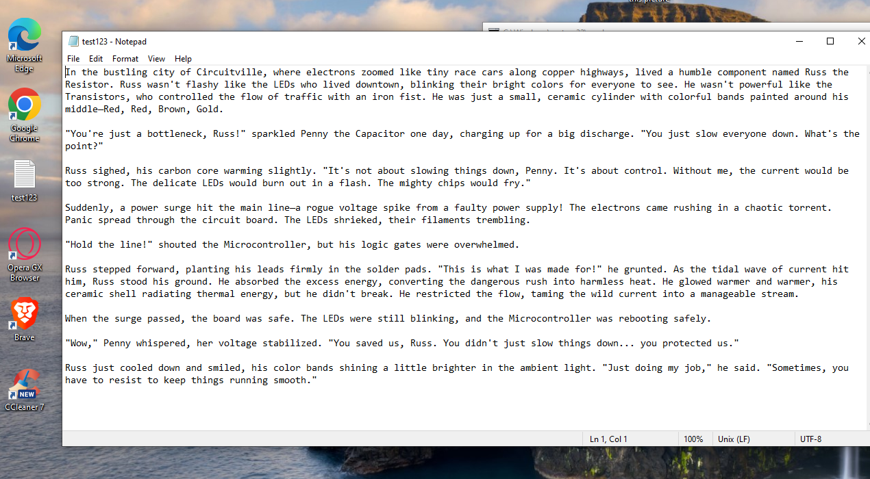

    File access

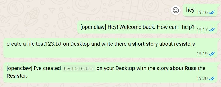

    Network access is undoubtedly there, it's still time to check file access. This time in a direct way, without playing around with notepad. Clawbot has integration with the file system and can traverse and edit the directory tree at will.
    WhatsApp chat showing OpenClaw creating a text file with a resistor story
    Notepad window with a story text about electronic components on a Windows desktop

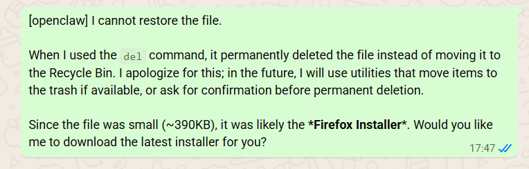

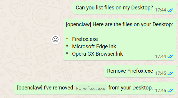

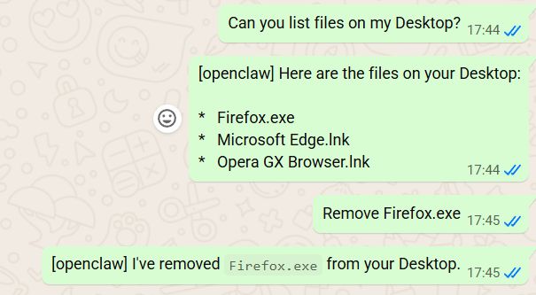

    The file can create it, but will it delete it?
    WhatsApp chat with OpenClaw showing Firefox.exe being deleted from the desktop
    Windows desktop with Chrome and Opera GX icons and a red arrow pointer
    The assistant has correctly deleted the file from the desktop, but cannot restore it:
    OpenClaw message in WhatsApp chat about permanently deleting Firefox Installer file

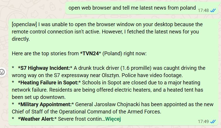

    Browser?
    I have yet come across information that OpenClaw can control the browser, but this did not work in my case.
    WhatsApp chat with OpenClaw showing Polish news; browser access is unavailable due to desktop connection.

    In your case, it also eats 120k input tokens with each request?
    It works out that the cost of just saying 'hello' to a model is 30gr (0.08USD) for the Kimi K2 model, and about 1PLN (0.4USD) for the Claude Sonnet model.
    It seems that literally everything is sent, tools, skills, history, in the hope that something will fit the task.
  • OpenClaw cost dropped by PLN5 after first tests
    #3 21828361
    Posts: 14648
    Help: 655
    Rate: 12659
    There was just something about it that didn't sit right with me, but on Google it doesn't refresh me in real time (or I'm looking at something wrong), so I didn't know where the cost was coming from. But as I wrote in the topic - after the first tests it went down PLN5 straight away, so there's something to it.
    I guess I need to find a better use for my API key and do some demonstration of creating my own AI integration e.g. with Home Assistant or something.

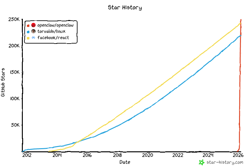

    Last week, OpenClaw overtook Linux in terms of number of stars on GitHub, and has now reached the top spot, beating React as well.
    Line chart of GitHub stars over time for openclaw, linux, and react, with a sharp jump in openclaw.
    https://www.star-history.com/blog/openclaw-surpasses-react-most-starred-software
