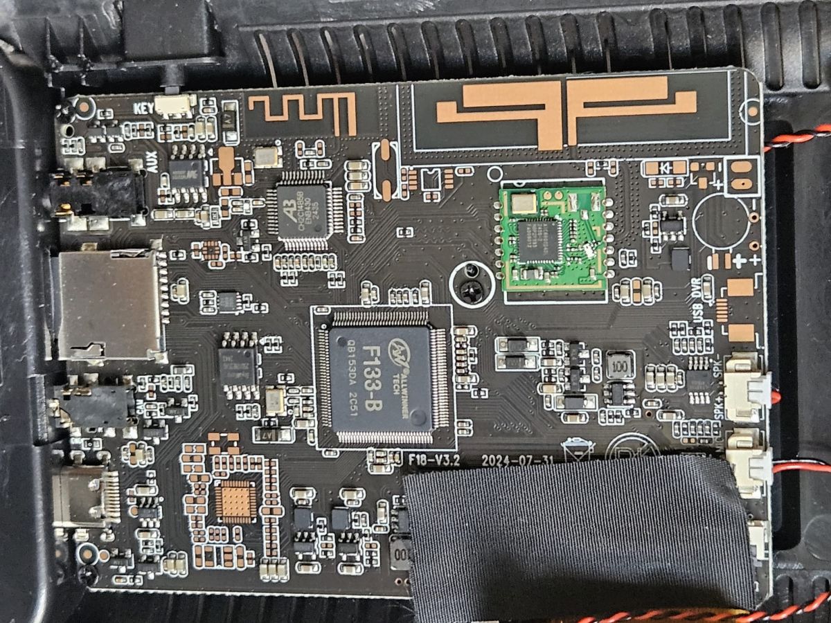

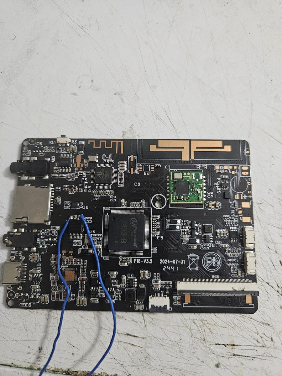

    Close-up of a PCB showing F133-B chip, F18-V3.2 marking, and a small green module on the right

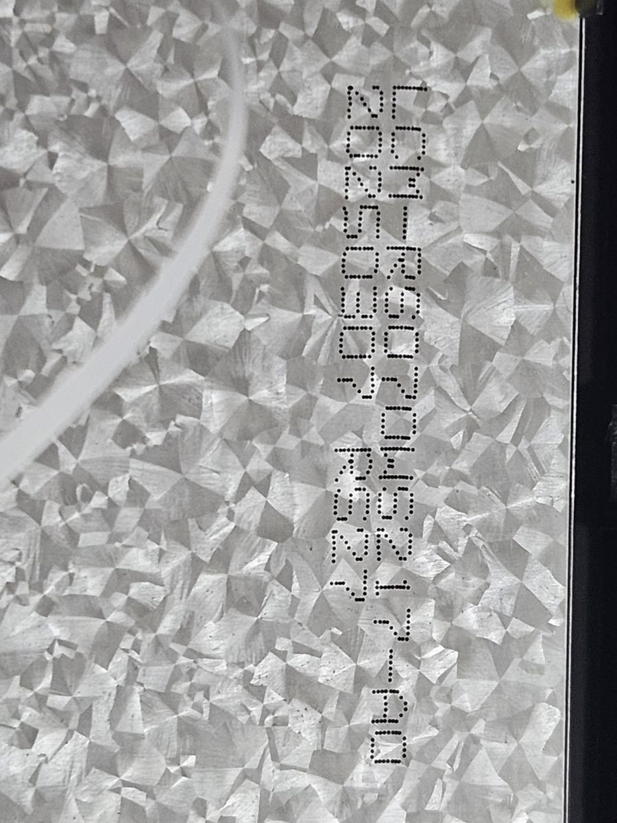

    Close-up of textured silver foil with dotted code “CWTX007A5010452247-A00”

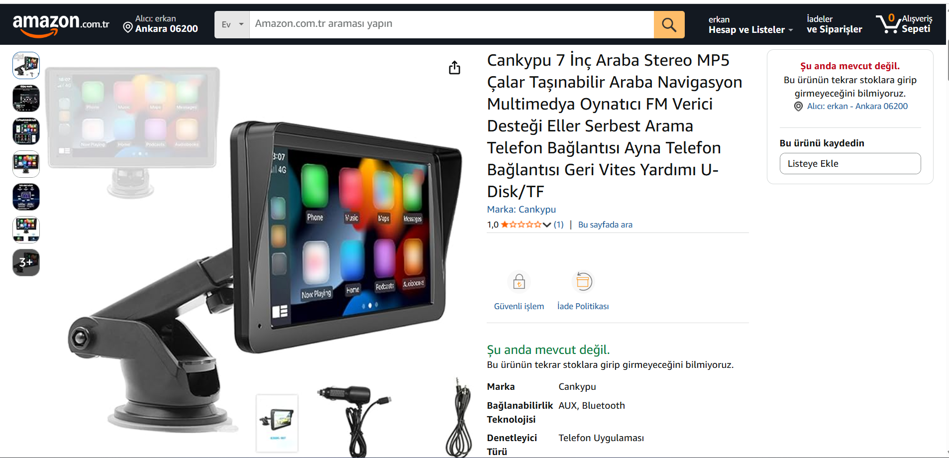

    Amazon.com.tr product page for “Cankypu 7 İnç Araba Stereo MP5” with a photo of a screen on a suction mount

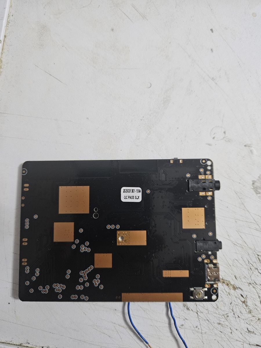

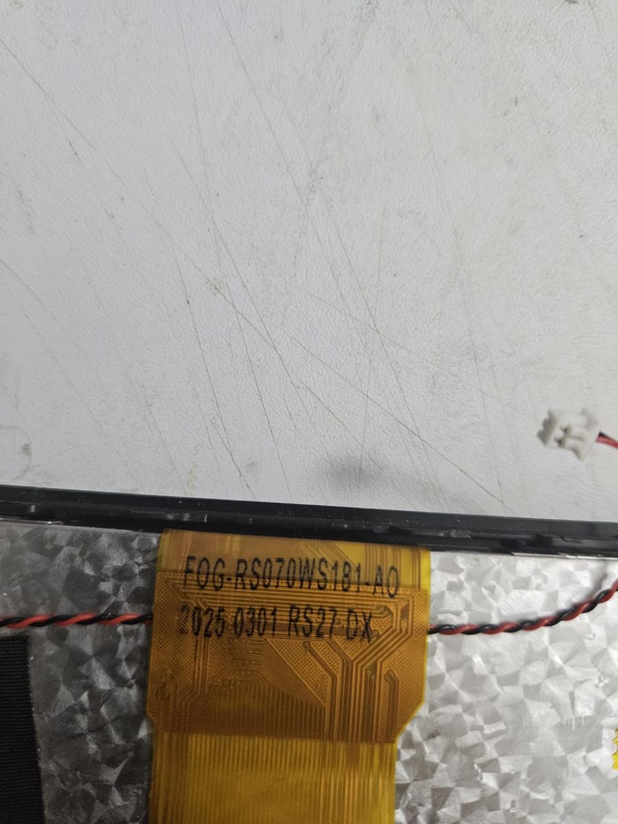

    My device bricked during the update and won't turn on. Could you send me the original or modified file? I can't find the F133B chip and F18-V3.2 version. I would appreciate your help. Thank you in advance and have a good day.
    AI: What is the exact brand and model of the device (or at least what type of device it is), and is there any label/photo from the case or PCB besides “F133B” and “F18-V3.2”?
    Cankypu 7 İnç Araba Stereo MP5 Çalar Taşınabilir Araba Navigasyon Multimedya Oynatıcı FM Verici Desteği Eller Serbest Arama Telefon Bağlantısı Ayna Telefon Bağlantısı Geri Vites Yardımı U-Disk/TF (AMAZON.COM.TR aldım
    AI: Which firmware/update file did you use, and how did you flash it (tool/method/USB/SD card)? If possible, please share the file name or link.
    mtc-10 img dosyası kullandım olmadı

    cihaza 7010b Opel yazan yazılımı yükledim, logo ve radio açılıyor, ve fakat dokunmatik çalışmıyor, işlem yapamıyorum, takılı kaldı o şekilde @ElektrodaBot @ElektrodaBot

    estatu25 wrote:
    cihaza 7010b opel yazan yazılımı yükledim logo ve radio açılıyor ve fakat dokunmatik çalışmıyor işlem yapamıyorum takılı kaldı o şekilde @ElektrodaBot @ElektrodaBot
    Users posts before the question:
    Initial assessment
    From your description and the photos, this is not a complete hardware brick.
    It is a firmware mismatch.
    Your board is clearly marked:
    - SoC: Allwinner F133-B
    - Mainboard: F18-V3.2
    - PCB date: 2024-07-31

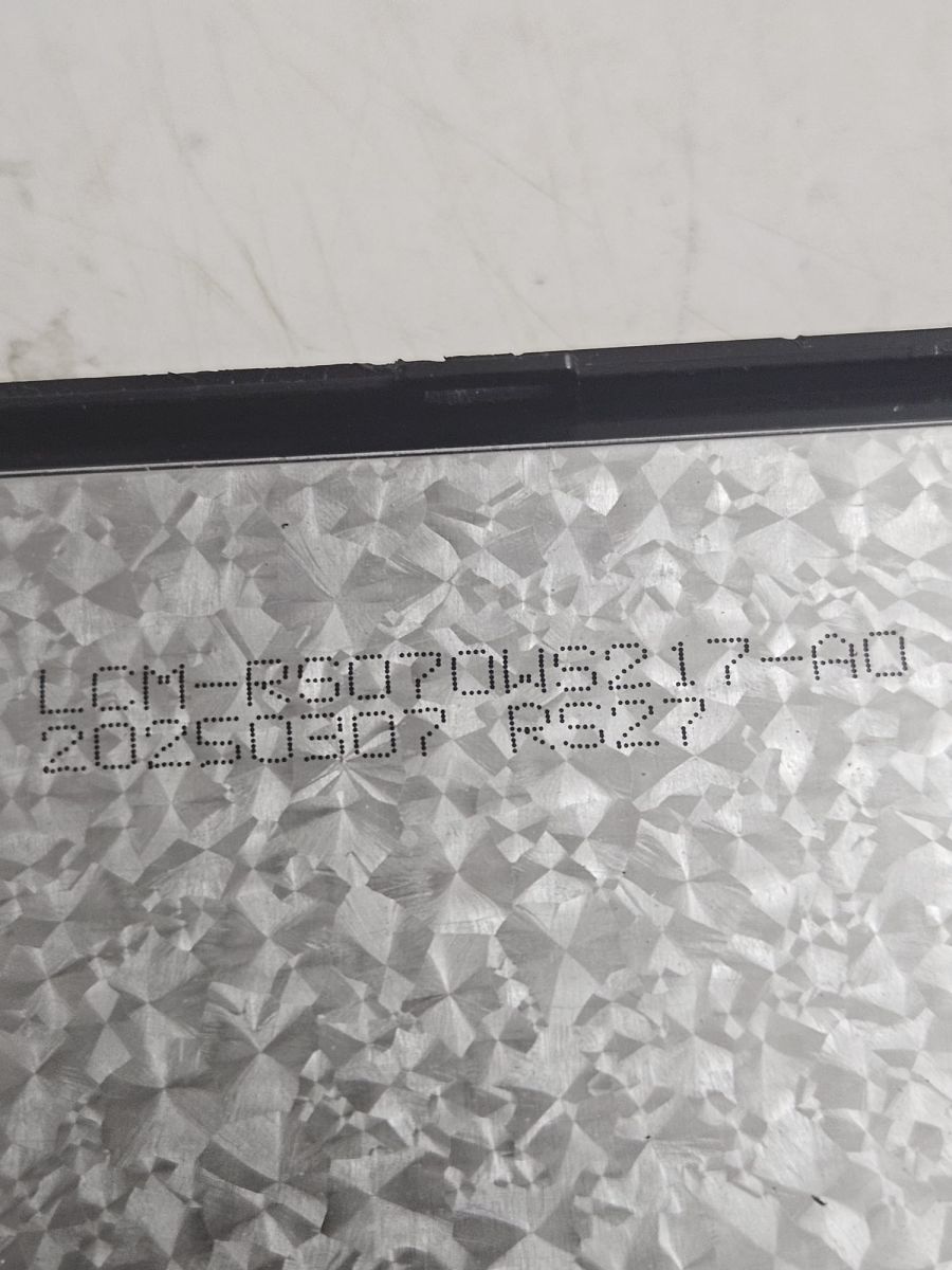

    The display label also appears to be something like:
    - LC7A-RS070WST217-TAM0
    So the important identifiers are F133-B + F18-V3.2 + the exact LCD/touch assembly.
    The name “7010B Opel” is not sufficient to choose firmware.
    Direct answer
    If the unit shows logo and radio/audio works, but touch does not respond at all, then the firmware you installed is almost certainly using the wrong touchscreen driver or wrong touch configuration for your panel.
    In other words:
    - LCD initialization works
    - main system boots
    - audio path works
    - touch controller does not match the firmware
    So the unit is partially alive, but with the wrong software.

    In your case, the symptom is very typical: wrong touch driver.
    Important correction
    A normal reset button usually does not restore original firmware.
    It only restarts the device, unless that specific bootloader has a recovery mechanism.
    Also, if touch is completely dead, this is usually not just a calibration problem.
    Calibration helps when touch is shifted or mirrored.
    Your case looks more like driver mismatch.

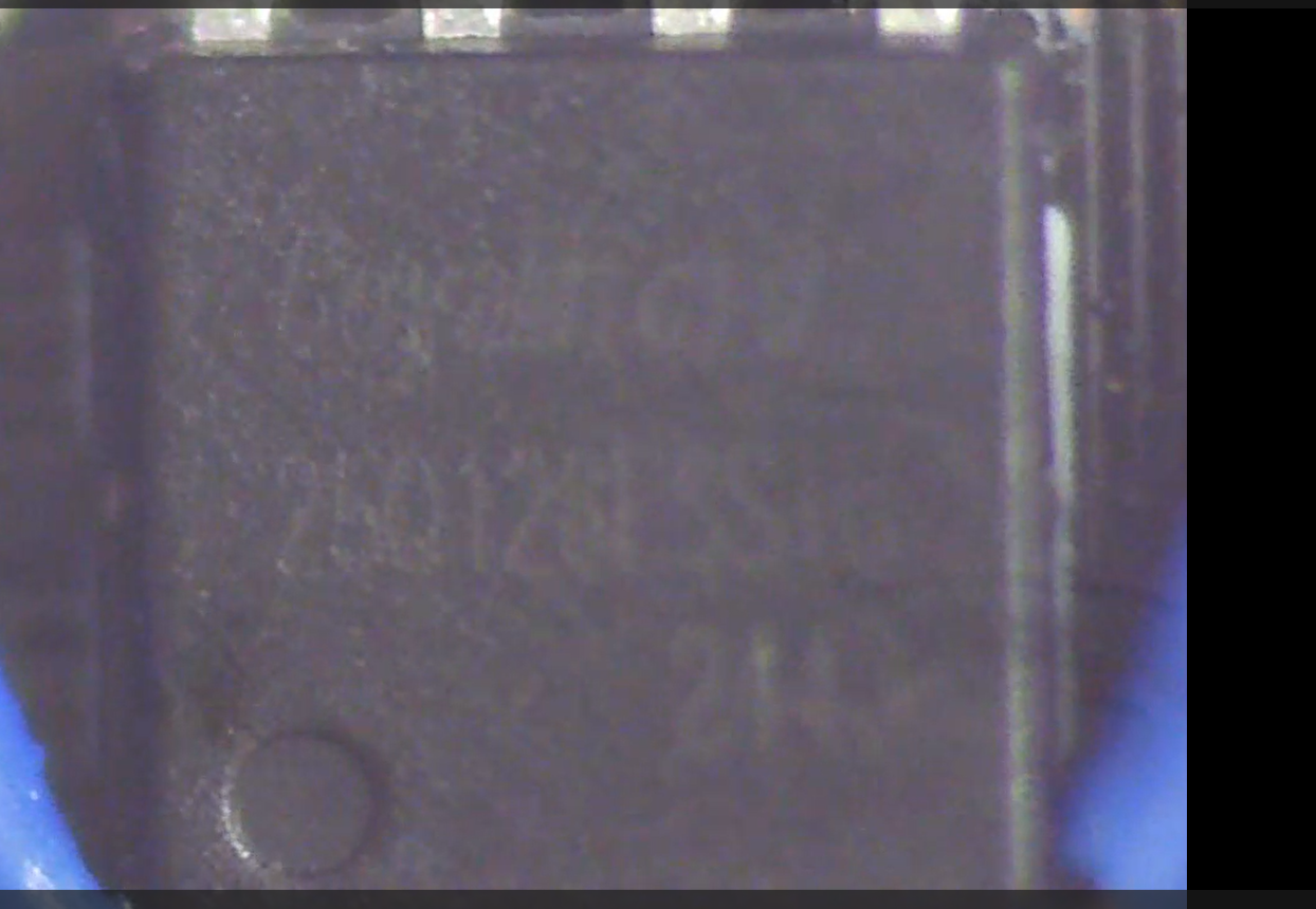

    4. If you cannot control the screen: hardware-level recovery is the reliable path
    If mouse/remote do not work, the proper repair path is:
    A. Identify the SPI flash chip
    Please post a sharp close-up of the 8-pin flash memory IC on the mainboard.
    It is usually marked something like:
    - 25Q64
    - 25Q128
    - W25Qxx
    - GD25Qxx
    - MX25Lxx
    This matters because we need to know:
    - chip type
    - voltage
    - capacity

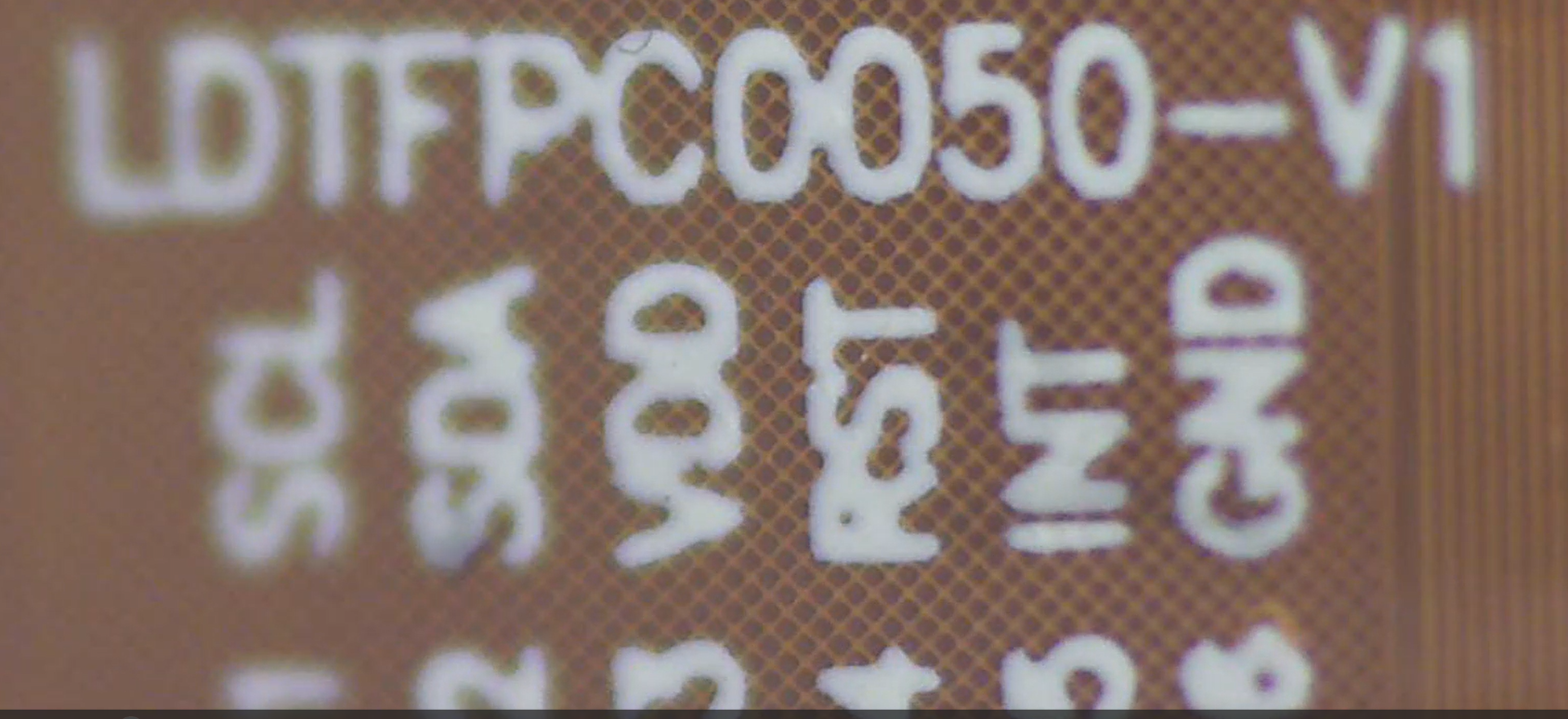

    B. Identify the touch controller
    The touch controller may be:
    - on the mainboard, or
    - on the small PCB attached to the display/touch ribbon
    Please post:
    - a sharp photo near the display ribbon connector
    - a photo of the front panel PCB
    - the back side of the mainboard
    This is often the missing piece.

    What your photos already tell us
    From the photos, I can already say:
    - this is not a classic old 7010B board type,
    - it is a newer F133-B / F18-V3.2 platform,
    - therefore older “7010B” firmware packages are unsafe,
    - the screen label may help identify the proper panel,
    - the green daughterboard is probably not the cause of the touch problem.
    So the main mistake was choosing firmware by product name instead of PCB/platform.

  • BoyaMICRO 25Q128 flash chip identified
    #4 21878330
    estatu25
    Posts: 6
    First of all, thank you for your reply. My BIOS chip says BoyaMICRO 25Q128
    Original firmware for F133B F18-V3.2 after failed update, no power Original firmware for F133B F18-V3.2 after failed update, no power Original firmware for F133B F18-V3.2 after failed update, no power
    ; I'll write the rest after reading it. Secondly, I can't connect a USB drive because it has a microSD card slot, and I'll take new pictures and send them again. Thank you for your help. You're right, the ones I uploaded are already locking it, and I have a newer version card. However, I don't have the image file; the company no longer sells it, and I can't obtain the image file, so I don't have it.
    Original firmware for F133B F18-V3.2 after failed update, no power Original firmware for F133B F18-V3.2 after failed update, no power Original firmware for F133B F18-V3.2 after failed update, no power Original firmware for F133B F18-V3.2 after failed update, no power

    Initial assessment
    Yes, we can try to find the correct software, but as of April 14, 2026 I could not verify an official downloadable
    .img
    for the exact B5308 / F18-V3.2 / F133-B unit from an authoritative source. Your Elektroda thread does confirm the important context: this is an F133B / F18-V3.2 case, the SPI flash was identified as BoyaMICRO 25Q128, and the previously flashed Opel image reaches logo/FM and then freezes. (elektroda.com)
    From the photos you added, the useful identifiers are now much better than just “B5308”:
    - Board date: 2024-07-31

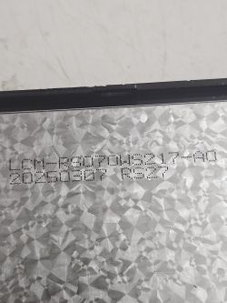

    - LCD label: LM-RG070NS217-A0
    - Touch FPC label: FOG-RS070WS48B1-A0
    - SPI flash family: 25Q128 class
    That is enough to stop guessing and search more intelligently.

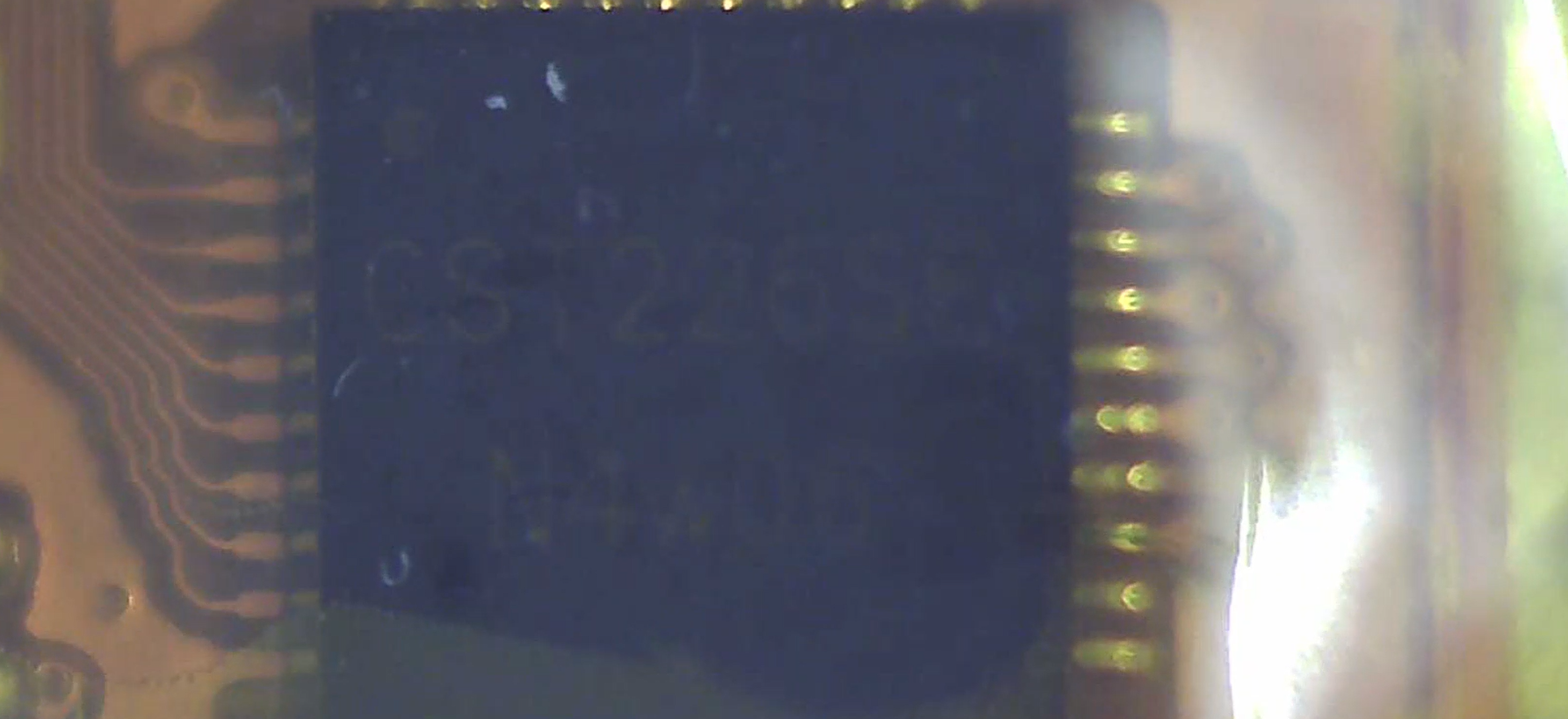

    4. preferably the same touch controller IC on the flex

    Allwinner’s own F133 brief says the F133-A/B family is used in car MP5 products and supports SD/eMMC, SPI NOR/NAND, USB host/OTG, and SDIO. That means your platform can realistically be recovered either by a correct vendor update package or by directly reprogramming the SPI flash; however, the exact boot/update path still depends on how this specific board was built. (allwinnertech.com)
    The behavior you described earlier is very important:
    - wrong Opel file boots,
    - logo appears,
    - FM/radio screen appears,
    - touch does not work / device freezes.
    From an engineering standpoint, that is much more consistent with a firmware mismatch than with dead hardware. In practice, this usually means one or more of these do not match the firmware:
    - touch controller driver,
    - touch GPIO/reset/interrupt pins,
    - LCD init sequence,
    - panel timing,
    - key mapping,
    - UI/application build for that board family.
    So the unit is likely not fully bricked. It is more likely running the wrong image.

    Best practical path now
    Option A — Best and safest: read the SPI flash first
    Because you already identified a 25Q128 flash, the smartest next step is:
    1. use CH341A or equivalent programmer,
    2. read the chip twice,
    3. save:
    read1.bin
    read2.bin
    4. compare them,
    5. if identical, keep that backup safe.
    Why this matters:
    - even a “bad” current dump may still contain
    - board config,
    - panel config,
    - touch config,
    - calibration,
    - version strings.
    This is often enough to identify what image family the device really wants.
    Voltage warning
    Use 3.3 V only on the flash chip.

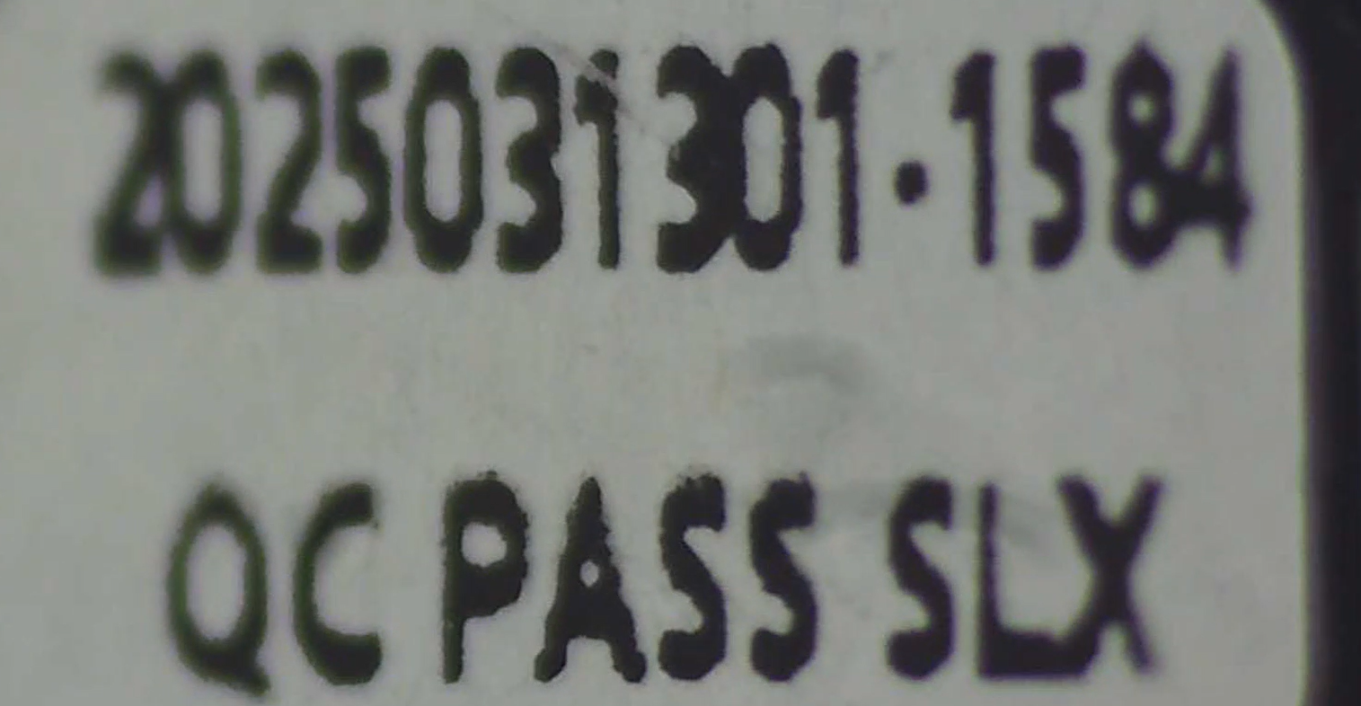

    What I suspect from your photos
    From the hardware labels, I suspect the display/touch assembly is the real discriminator here, not the “B5308” name.
    In other words, the correct software is probably:
    - same F18-V3.2 mainboard
    - same LCD
    - same touch flex/controller
    Even another F133 portable monitor image may still fail if the touch IC differs.
    One of your close-up photos of the touch area suggests there is a specific capacitive touch controller on the flex, but the marking is still too blurry to trust. That chip marking can be decisive.
    What you should upload next
    To increase the chance of locating a compatible image or adapting one, the most useful next items are:
    1. full SPI flash backup (
    read1.bin
    read2.bin
    2. sharp macro photo of the touch controller IC on the touch flex
    3. exact marking of the 8-pin flash chip
    4. if possible, a photo of the unit’s sticker/case label

    My recommendation
    If this were on my workbench, I would do it in this order:
    1. Stop flashing random images
    2. Read the 25Q128 flash
    3. Search by F18-V3.2 + panel/touch labels
    4. Prefer a same-board raw dump over a random
    .img
    5. Only after comparison:
    - write known-good dump, or
    - try exact matching update image

    - The important identifiers are F133-B + F18-V3.2 + LM-RG070NS217-A0 + FOG-RS070WS48B1-A0.
    - The previous Opel/7010B file is almost certainly the wrong firmware family.
    - The best next step is a full 16 MB SPI readout from the 25Q128 chip.
