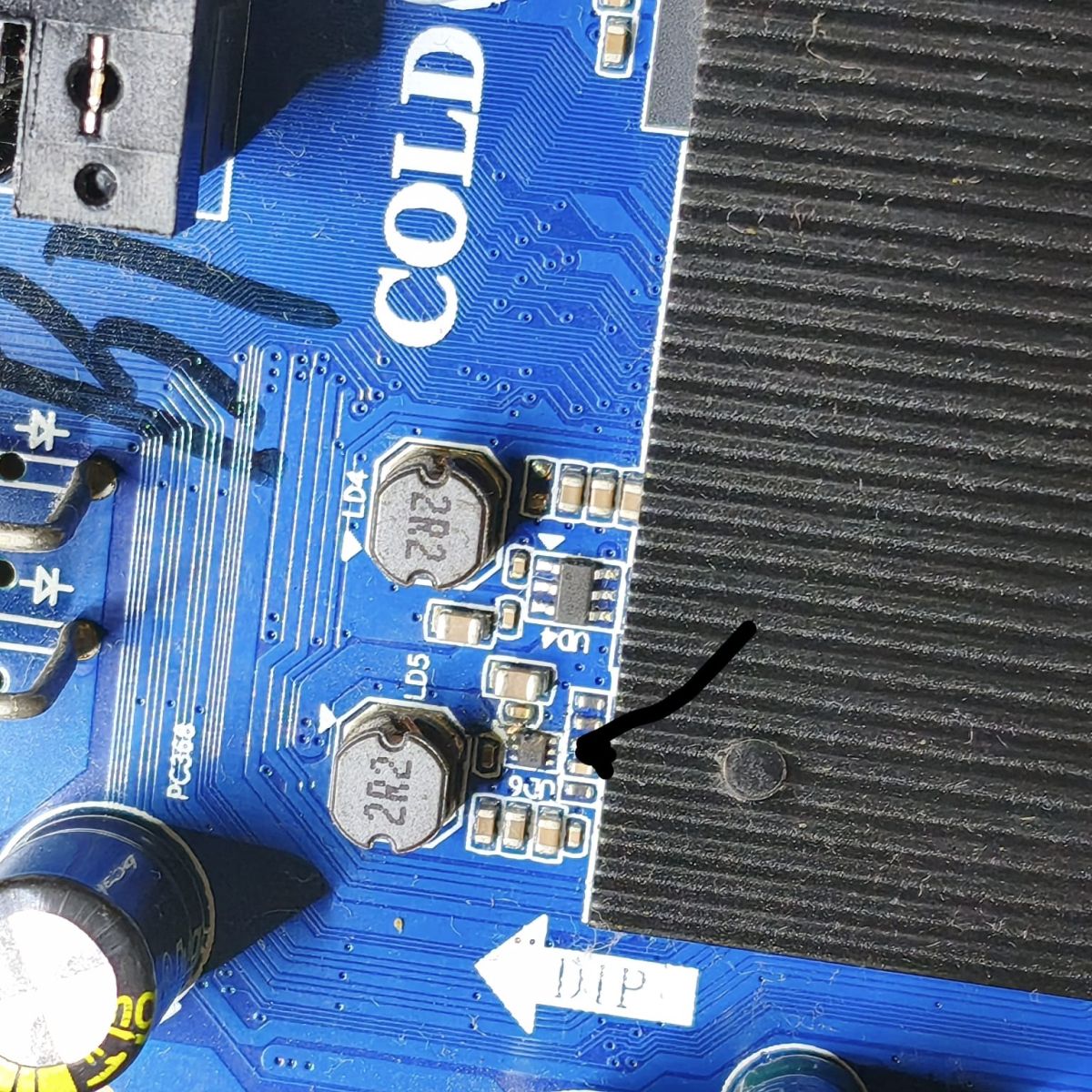

    More informations: Hi, I have this Akai AKTV604J VIDAA UHD TV that has remained with the red LED on and does not turn on either from the remote control or from the TV. The main board is a CV9602-B55. The defect seems to be due to a firmware lock. Is it possible to have the file to reprogram it? Thanks for the help.

    By analyzing more closely, I identified the defect on the motherboard; the investigated chip is the one indicated in the photo. It is located near the CPU. Can someone tell me its designation? From the indications on the motherboard, it was supposed to provide a VCC_CPU of +0.95V, which is not present, and therefore the TV does not start. Could someone tell me its designation? Thank you.
