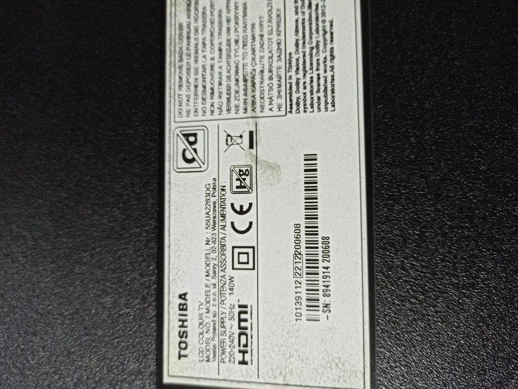

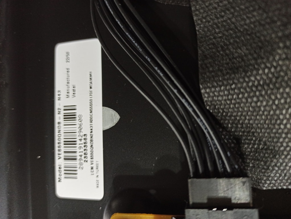

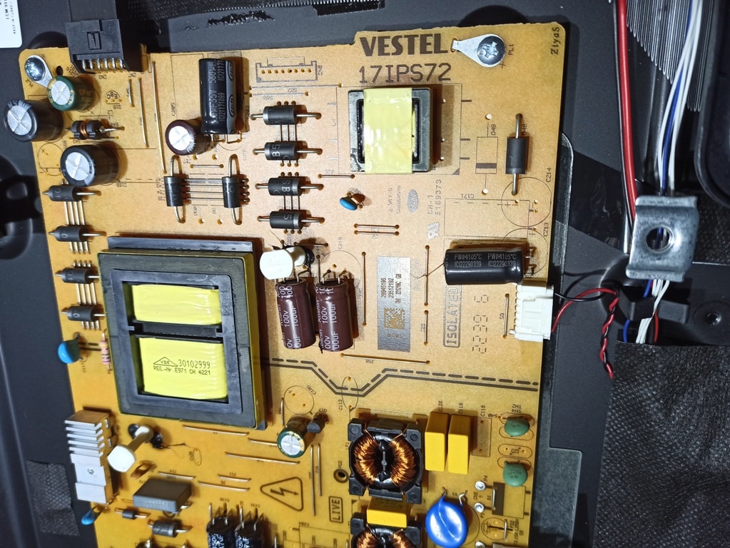

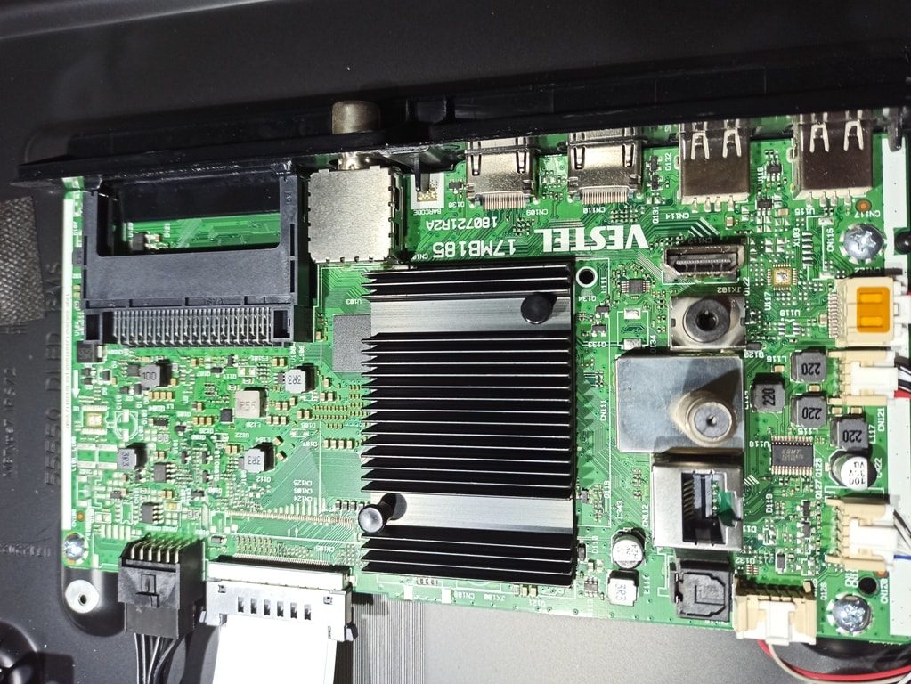

    I have this TV, and it probably needs software.
    Please, if someone can help me,
    the power supply is working properly; all the voltages are correct,
    the LED is red and does not turn on, even from the remote control
    or from the switch on the TV.
    Thanks in advance.
    AI: Can you tell us what voltages/signals you measured on the power supply and main board, especially standby 5V and whether PS-ON / BL-ON change when you try to power it on?
    I measured 12 volts, I measured 5 volts, I measured 3.3 volts, and the voltage for the backlight.
    AI: When you try to start it, is there any reaction at all (LED blinking code, backlight flash, logo, USB activity), and what is the exact code/sticker written on the 17MB185 board or NAND/eMMC label?
    The LED does not blink; it remains red.

    I have this:
    Toshiba 55UA2263DG main 17MB185 panel VES550QNDB-N2-N43. For stick.
    Since you don't have the stby LED on, it is only possible to solve it if you rewrite the EMMC memory.
    I'll post the software then I go to the site and see that you're online.
    There are many people who want a software and then it comes in a week later.
  • #3 21871980
    emman
    Posts: 32
    Thank you for your interest
    and the help you give me, this software
    billobirillo sent it to me. I put it on the stick
    but the TV stays with
    red LED Stdy on,
    I put the stick with the software on the USB
    and it doesn't respond, that's what I noticed
    is that all trends are good
    and lights up the LED of the optical fiber
    on the motherboard.
    I left it plugged in for two hours but the TV remains dead.
