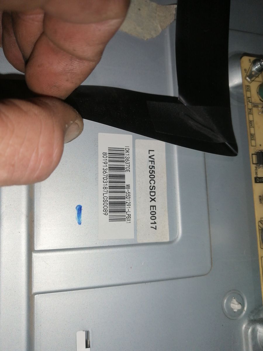

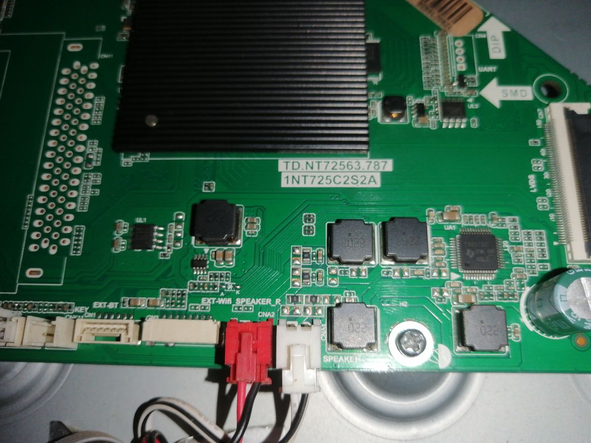

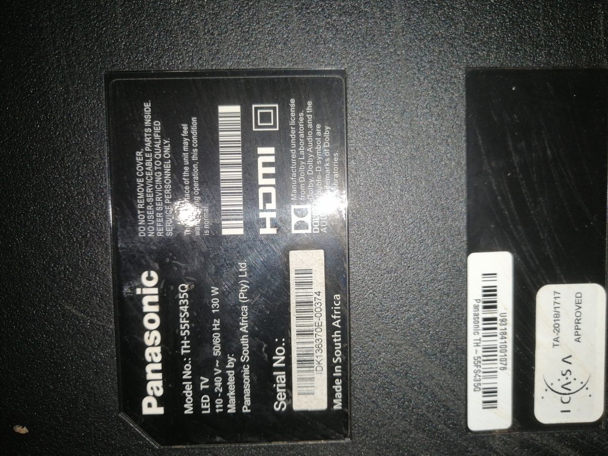

    Evening to All. I received a Panasonic TH-55FS435Q LED TV that has a black screen, though the screen is lit. It's blank, and the power light glows green for a couple of seconds and turns red, then green, and repeats the cycle. It seems to be stuck in a boot loop, and I have repeated the reset cycle, but no luck, and I can't find the firmware file, and need help, please.
    Panasonic TV specification label on the back panel, showing model TH-55FS435G and barcodes
    Hand holds black tape by a silver device housing with labels “LVF550CSDX E0017” and a barcode
    Close-up of a green PCB with a black heatsink, wire connectors, and label TD.NT72563.787
    Please can you confirm exactly what reset procedure you tried, and does the TV ever show a Panasonic logo, menu, sound, or response to the remote before it restarts?
    There is no remote, no logo, no sound, the buttons don't even respond, nothing, just a backlit black screen, and the indication light goes from green to red but at a relaxed pace.
    Can you post the chassis/main board number or a clear photo of the sticker on the main board/back cover, as the firmware may depend on that and not only on model TH-55FS435Q?
    I've attached all the codes required and attached a video of the issue I'm having

    This is an unusual model for Panasonic
    - Panasonic TH-55FS430M / TH-55FS435Q chassis NT72
    Service Manual available for download ( TCL NT72563 Service Manual ) Link
    - the repair diagram starts on page 26
    P.S.
    Google the phrase: NT72563 – you’ll find plenty of helpful information
