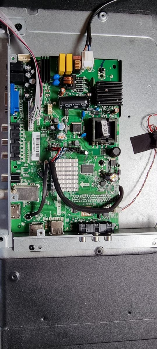

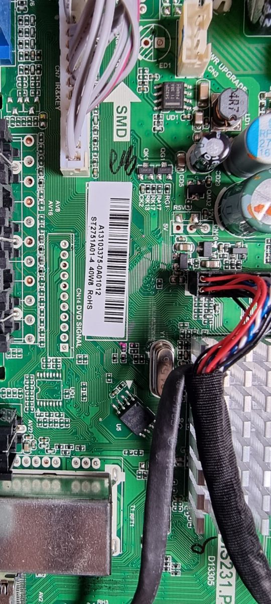

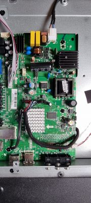

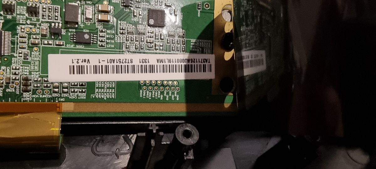

    I have two Kogan KALED28XXXZA 28" LED TV's on a boat.
    One is working fine, but one is stuck in the Kogan Logo with red green lights boot loop.
    It started doing this a few weeks ago, and after 5 minutes or so it would come on and work normally.
    Now it takes about 2 hours - and even then sometimes it just keeps looping. Other times it comes on OK.
    I have opened it up and nothing seems obviously damaged. Capacitors etc look OK visually.
    some searches for similar faults mentioned re-flashing the firmware. I can't find the firmware on Kogan's webpage for this model.
    Does anyone have any suggestions? is it likely to be a hardware issue, or a firmware issue?
    If it is a firmware issue, is there a way I can pull the firmware off the working TV? They are identical.

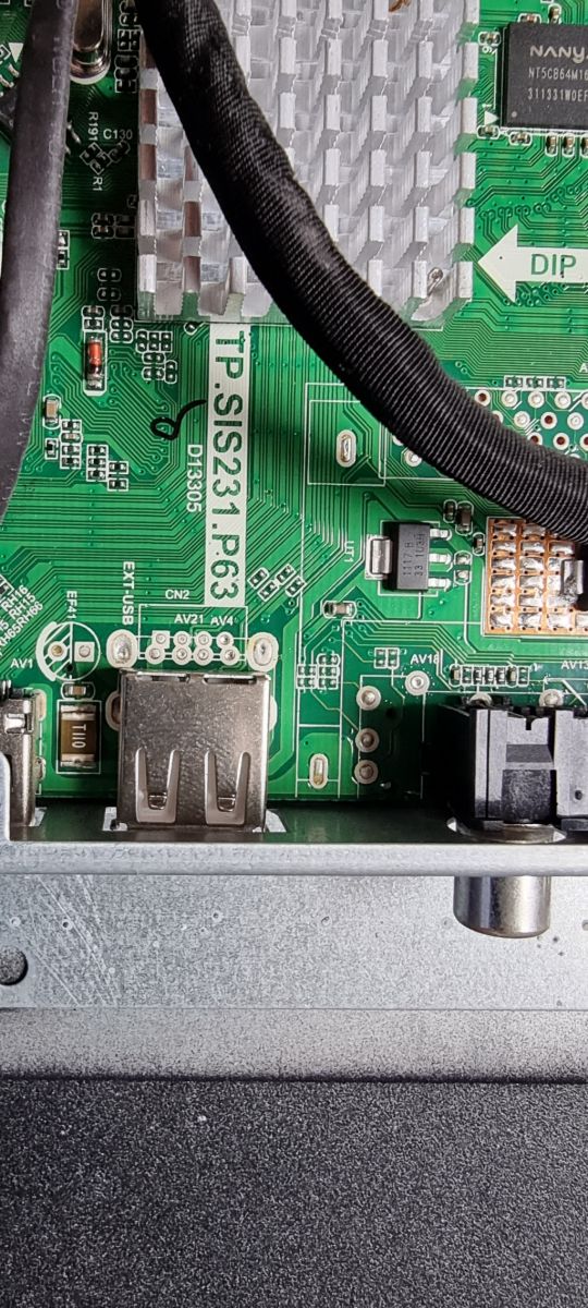

    The main board is a TP.SIS231.P63 D13305. Pictures attached. Kogan KALED28XXXZA 28 LED TV Boot Loop Issue: Red & Green Lights, Firmware or Hardware?
    I realise the TV is cheap, and ordinarily I'd buy a new one. However, it fits into a specific hole in the boat and I can't find a 28" TV anywhere anymore! 32" is the smallest and it is too big to fit!

  • #2 19291227
    jeloi
    Posts: 1745
    Help: 285
    Rate: 597

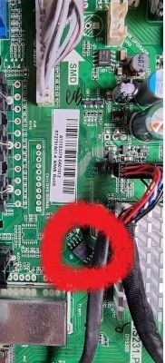

    Write GD25Q64 a new chip
  • #3 19291555
    waldi58
    Posts: 964
    Help: 66
    Rate: 252
    Typical Chinese. You just have to copy the memory from the good one to the damaged one. If this does not help, it will practically replace the main pcb
  • #4 19293714
    ARMAGEDOON
    Posts: 109
    Help: 16
    Rate: 29
    You have to rip the batch from the working TV and upload it to the non-working one Kogan KALED28XXXZA 28 LED TV Boot Loop Issue: Red & Green Lights, Firmware or Hardware?
