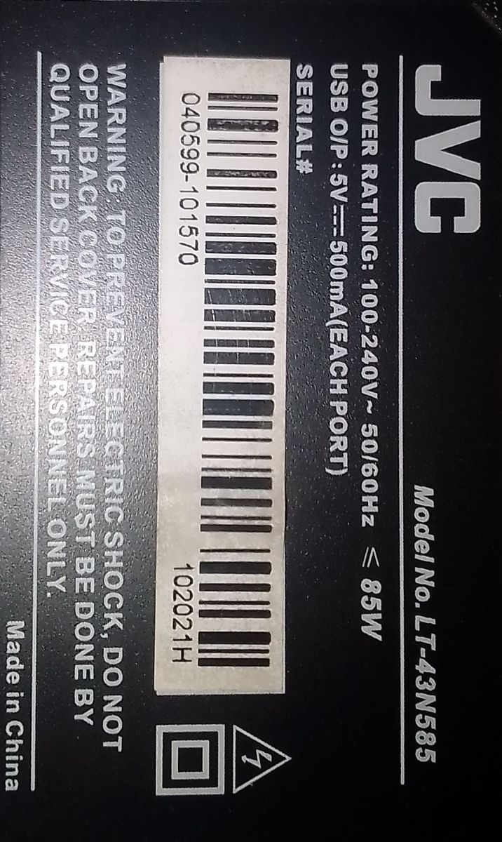

    Hello, please help.
    I need USB recovery firmware for JVC LT-43N585
    Mainboard: 17MB170 / 17MB185
    Problem: Stuck on SMART TV logo - boot loop
    Thank you
    Where to download JVC LT-43N585 USB recovery firmware for 17MB170/17MB185 bootloop?
    @ElektrodaBot
    I would like to know if these files you sent me have different models? Aww.

    https://obrazki.elektroda.pl/8...
    Initial assessment of available information
    The rear label photo confirms only:
    - Brand/model: JVC LT-43N585
    - Serial shown: likely
    040599-101570
    - Production/batch code:
    102021H
    - Made in China
    - Power: up to 85 W
    It does not confirm the mainboard type. The mainboard must be read from the PCB inside the TV, not from the rear model label.
    Direct answer to your question
    Yes — 17MB170 and 17MB185 firmware files are different and must not be treated as the same.

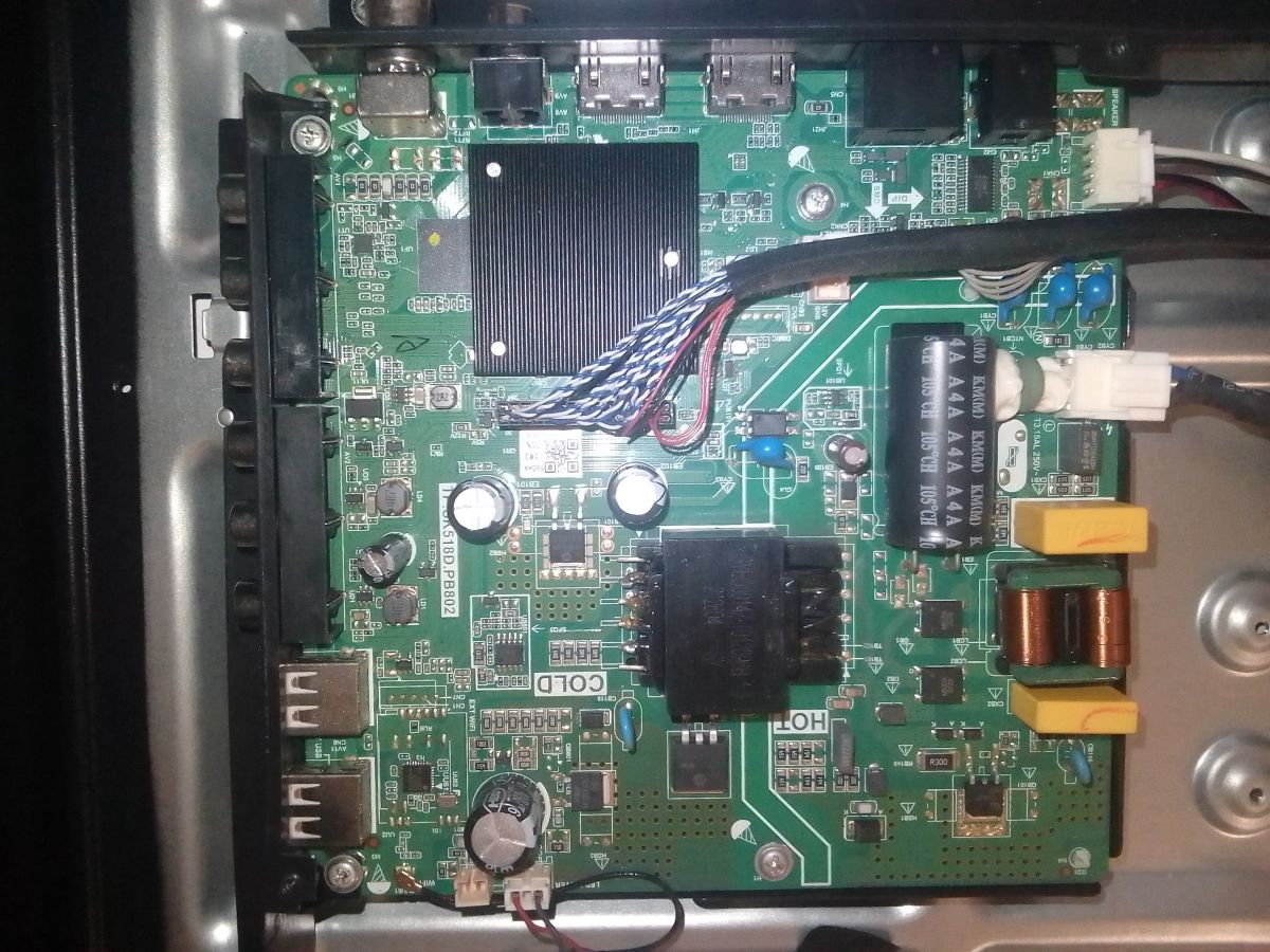

    1. Your TV may not actually be 17MB170/17MB185
    The label says JVC LT-43N585 Made in China. Some information available for the N585 family points to Chinese universal-type boards such as TP.SK535.PB801 (N), not necessarily Vestel 17MB170/17MB185. One public replacement-board document associates the N585 family with TP.SK535.PB801 (N) and shows software information for JVC LT-43N585. (manuals.plus)
    So the first important correction is:
    > Do not assume it is 17MB170 or 17MB185 from the TV model alone. Open the TV and read the PCB marking.
    The mainboard may be one of these:
    Possible board markingMeaningFirmware type
    17MB170
    17MB170-1
    17MB170-2
    Vestel Android chassisVestel MB170 firmware only
    17MB185
    17MB185Y
    Vestel Android chassisVestel MB185 firmware only
    TP.SK535.PB801
    TP.SK535.PB801 (N)
    Chinese/CVTE-type boardCompletely different firmware
    TP.SK518D.PB802
    Chinese universal/OEM boardCompletely different firmware
    If the board is TP.SK535 or TP.SK518, then 17MB170/17MB185 files are wrong.

    Before flashing anything, please provide these photos/details:
    1. Clear photo of the mainboard
    Especially the text printed on the PCB, for example
    17MB170
    17MB185
    TP.SK535.PB801
    2. Photo of the white sticker on the mainboard
    Vestel boards often have a service part number or software code.
    3. Photo of the LCD panel sticker
    It may look like
    VES430...
    C430...
    LC430...
    HV430...
    , etc.
