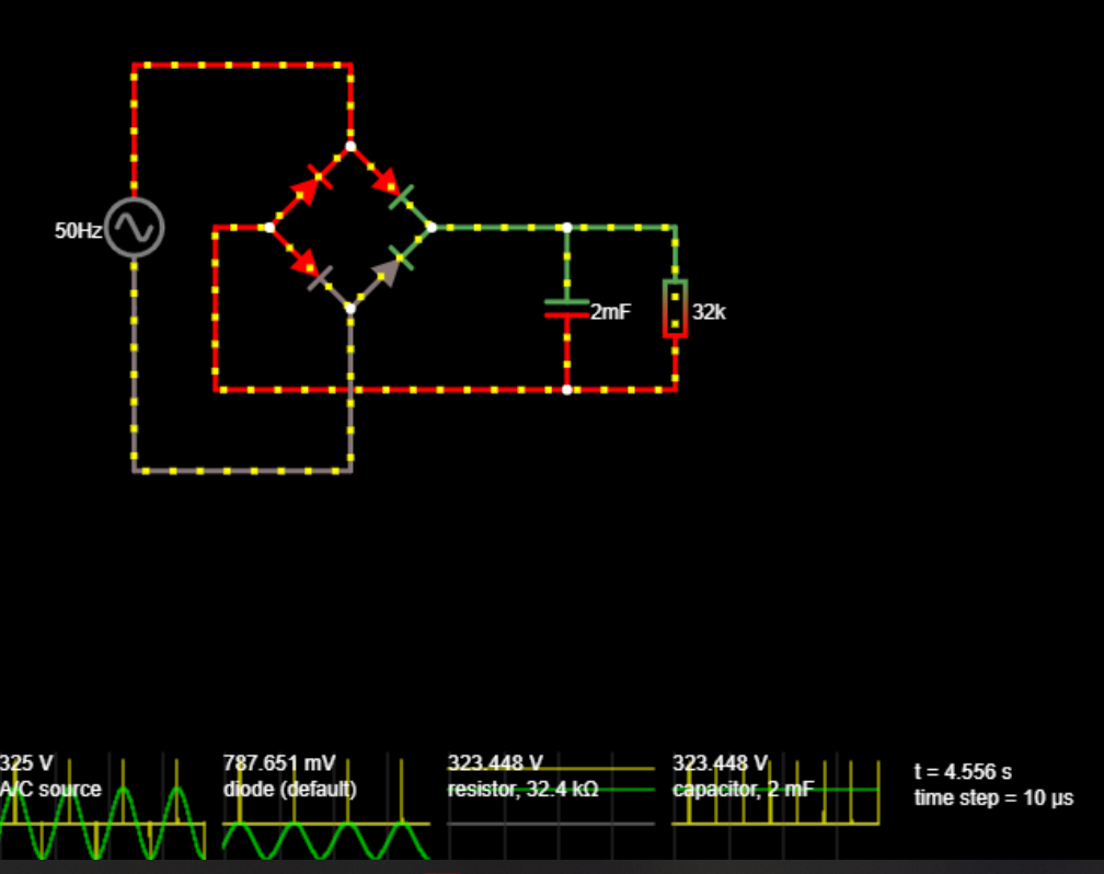

    kariak97
    Hello. Recently, I started designing a Graetz bridge power supply with an RC low-pass filter. This is what it looks like in the simulator:
    Rectified Voltage Value Dependence & Calculation: Tension after Rectification Explained
    I designed the whole thing so as to meet the conditions of task 1.27 from the Art of Electronics:
    The only deviations from the command are the fact that the input is European standard current (230 V and 50 Hz) and zero DC component. Everything seems fine, but my energy balance is not right.
    One cycle of 230V rms AC generates the same power as 230V DC applied for one period. So I would expect that after rectification and filtering I will have about 228V at the output, but even from theory it follows that after rectification the voltage will be closer to the peak value, not the effective value. So the current at the output is able to generate more power than the one at the input, which is obviously wrong.
    In this case, the ripple is less than 0.1V.
    Attached is the .txt file for the simulator.
    • circuit-20190925-1322.circuitjs.txt (723 Bytes) You must be logged in to download this attachment.

    But where is the energy/power balance wrong?
    Do you think tension is energy? And don't blame the capacitor for not knowing what rms value is, which was "invented" by man.
  • #17 18186150
    kariak97
    The point is that 230V DC generates as much power as 325V AC at peak. If after rectification we have e.g. 322 V, then the heat generated on a given resistance will be greater than before rectification.
    edit
    So before rectification we have power P = 230^2/R, and after rectification P = 322^2/R, we just doubled the power of the current that comes out of the socket simply by rectifying it.
  • #18 18186203

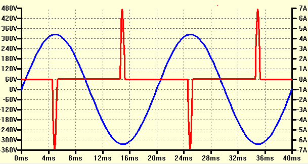

    #20 18186397
    jony
    Electronics specialist
    Posts: 7552
    Help: 1823
    Rate: 887
    kariak97 wrote:
    I know it's calculated correctly, I just don't understand why the output is more powerful than the input.
    Because you didn't take into account the current drawn from the socket in the second case.
    And the resistance seen through the "socket" is different in the system with the rectifier + RC filter than if you connected the resistor R directly to the network.
    For example, a resistor with a resistance of R = 1kΩ should be connected to the "socket".
    The active power dissipated by our resistor is:
    P = 230²/1kΩ = 52.9W.
    And now we "deliver" a bridge + capacitor with a large capacity of 2mF in front of the resistor.
    And let the voltage behind the bridge be 320V.
    This time, the resistor will dissipate power equal to P = 320²/1kΩ = 102W (current I = 0.32A).
    Let's see what the current "drawn" from the socket looks like:
    Where in blue you have the voltage in the network and in red the current "consumed" by our example rectifier.
    As you can see, the current is drawn impulsively and does not resemble a sinusoidal waveform at all (do you know why that is?).
    In addition, these pulses have a maximum value of 7A. And yet, only 0.32A flows through the resistor. Oh, a problem.
    As you can see, the matter is not as simple (obvious) as you thought at first.
    kariak97 wrote:
    It seems logical to me (yes, I know that I think wrong, but I haven't found any information about it anywhere) that if the AC voltage at the input works (from the energy point of view) like 230V DC, then at the output of the rectifier with a filter it should be 230 - 1.2 V (drop on diodes).
    I ask again. How is the poor capacitor supposed to "know" what RMS value is? And since the voltage in the socket actually has a value of 325V at peak.
    The capacitor will charge to the same voltage because this is the voltage in the socket.
