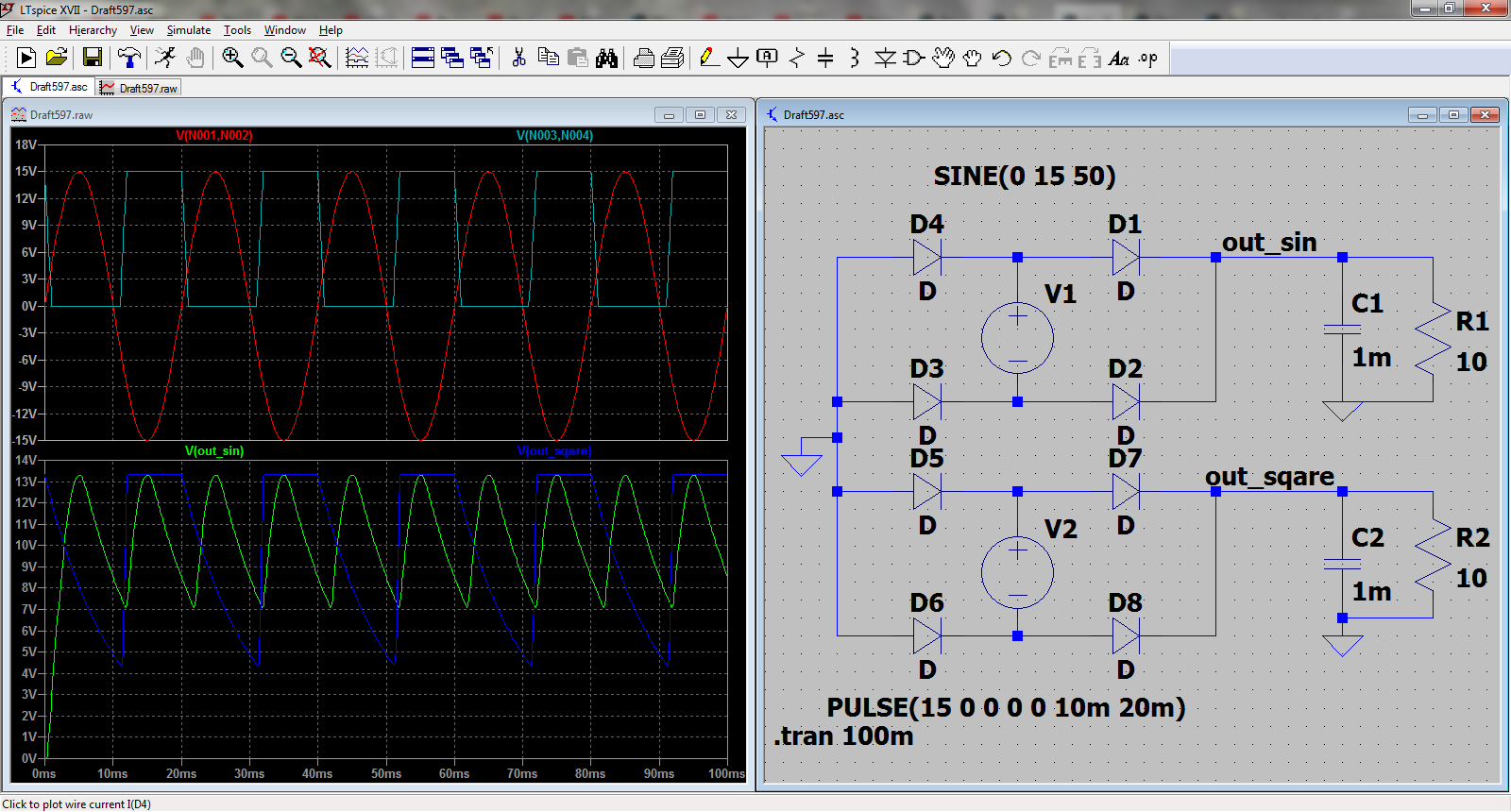

    In a full-bridge rectifier and RC filter, which combination of waveform, bi-polarity, and transformer-type will give the least ripple in the output (before a regulator)? Ie, how is ripple affected by:
    an AC source that goes negative on the troughs, vs a source that only goes positive, never below 0v?
    sine vs square source?
    pulse transformer vs non-pulse transformer?

    A difficult question, as the outcome depends on many factors.
    In theory: the ripple is higher the longer the time when the load current flows only from the capacitor.
    A rectangular waveform contains a section when the voltage does not change, which makes it easier to filter. The ripple can be smaller.
    In practice: a circuit with a mains transformer gives a few-odd volts of 100 Hz ripple easily removed with a linear stabiliser.
    A boost converter circuit gives tens - hundreds of millivolts of ripple, high frequency, very difficult to filter. A linear stabiliser will not help.
    Added after 3 [hours] 5 [minutes]: .
    Best viewed in simulation
    Screenshot of an electrical circuit simulation in LTspice XVII, showing graphs and a rectifier circuit schematic.

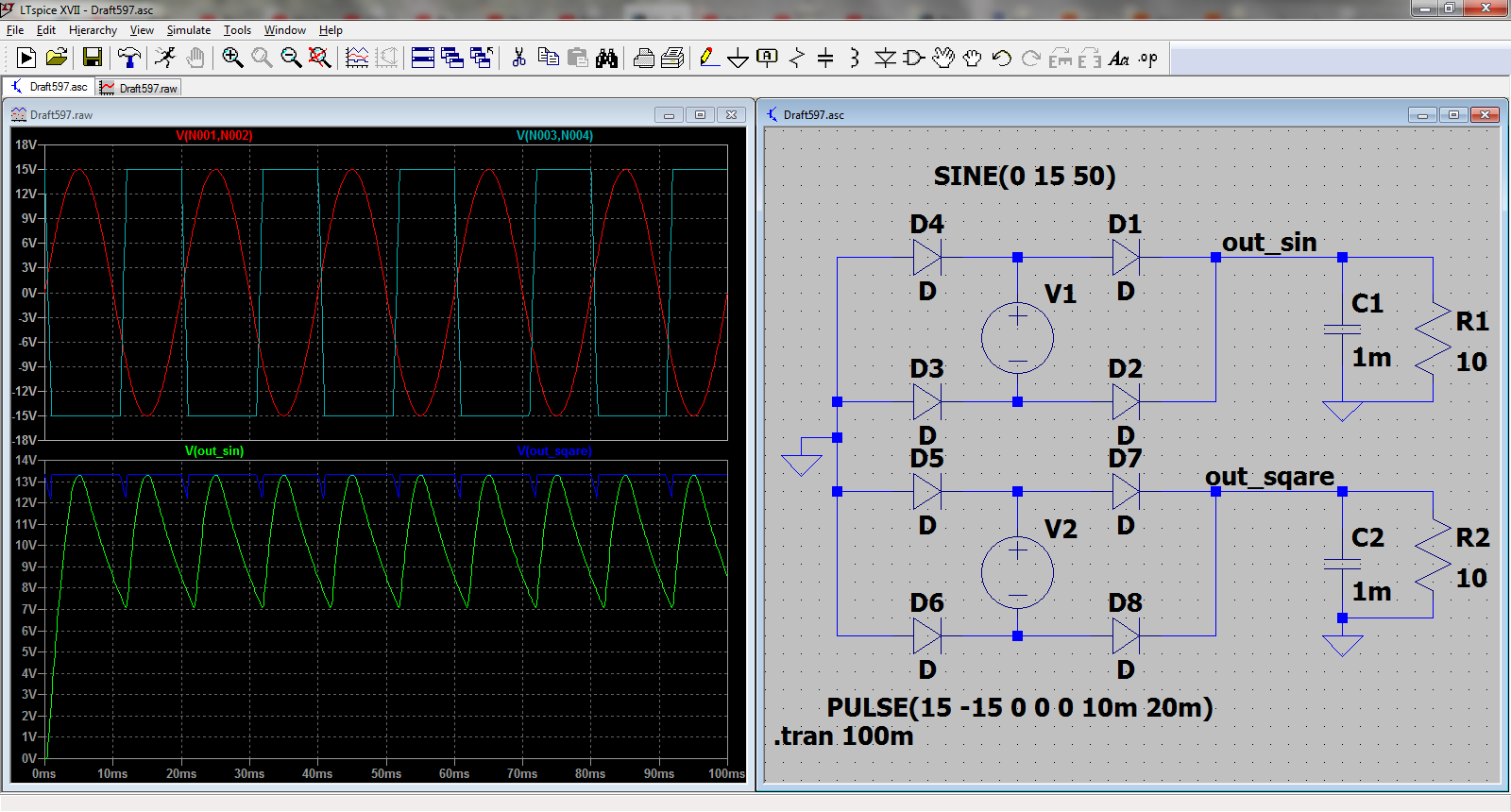

    It would be good to specify what kind of waveform it is, because, for example, a rectangular waveform alternating after 10 ms U_0 and 0 will give much higher ripple than a 50 Hz sine wave with amplitude U_0 (and the same rms voltage) after rectification. In contrast, a rectangular waveform after 10 ms +U_0 and -U_0 after rectification will give no ripple (if this waveform and the rectifying diodes are ideal).

    @_jta_ Because after rectification we will get 100 Hz from a 50 Hz sine, and a unipolar rectangular waveform will not change shape.
    Rectifier circuit simulation in LTspice with sine and square waveforms.
