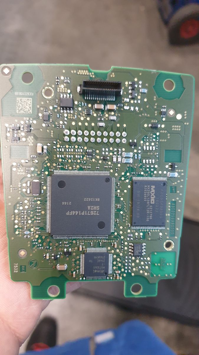

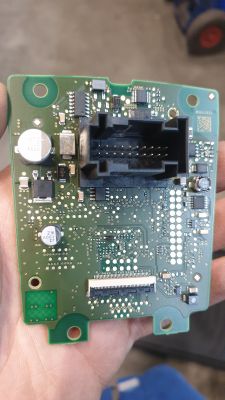

    Hi, I have a lot of similar tiles, is there gold on them? Thank you for your help.
    Where is the most gold? Where is the most gold?

    Not in the tiles themselves. As already in processors, but in microscopic amounts.
    You would probably collect more easily and faster by washing the gravel in the Lower Silesian streams ...

    This is a car controller board.
    You can also find some gold in some connectors.

    Some connectors also contain some gold.
    This "bit" is so little that it is not worth doing it.
