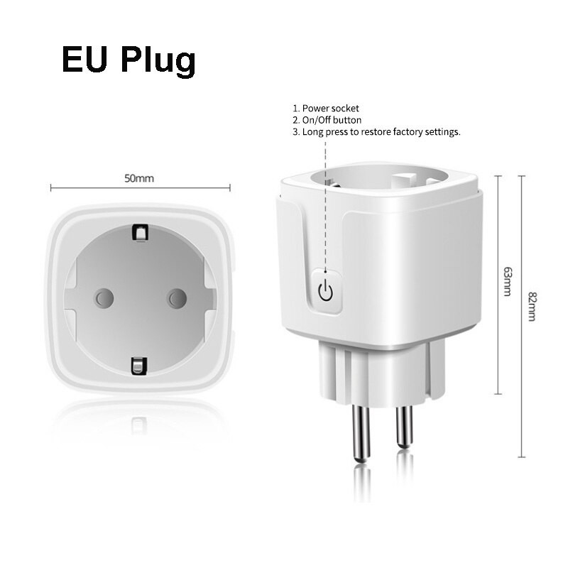

Hi everyone.
I would like to add a teardow of a generic tuya smartplug based on a wb2s.
I have bought this device some time ago from aliexpress:
It came with tuya 1.3.5 and I installed OpenBeken using tuya cutter for a BK7231T and selected the Generic Tuya NAS WR07W 16A smart plug.
Seems quite similar to LSPA7 https://www.elektroda.com/rtvforum/topic3932742.html#20300613 or Model: PE-01E IP44 https://www.elektroda.com/rtvforum/topic3927458.html
From outside is identical to LSPA9, but the led is blue instead of purple such as LSPA9.
It is based on a WB2S with BK7231T and a BL0937 to monitor electrical parameters such as voltage, intensity and power consumption.
Unfortunatelly there is not brand or label on the outside or even on the PCB.
Button is connected to PIN 1TX
LED(negative) is connected to PIN PWM0
I've used configuration from Model: LSPA7 and modified button pin to 11
Pin 6: WifiLED_n on channel 0
Pin 7: BL0937CF on channel 0
Pin 8: BL0937CF1 on channel 0
Pin 11: Button on channel 0
Pin 24: BL0937SEL on channel 1
Pin 26: Relay on channel 0
