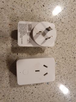

    The set includes a socket and instructions:

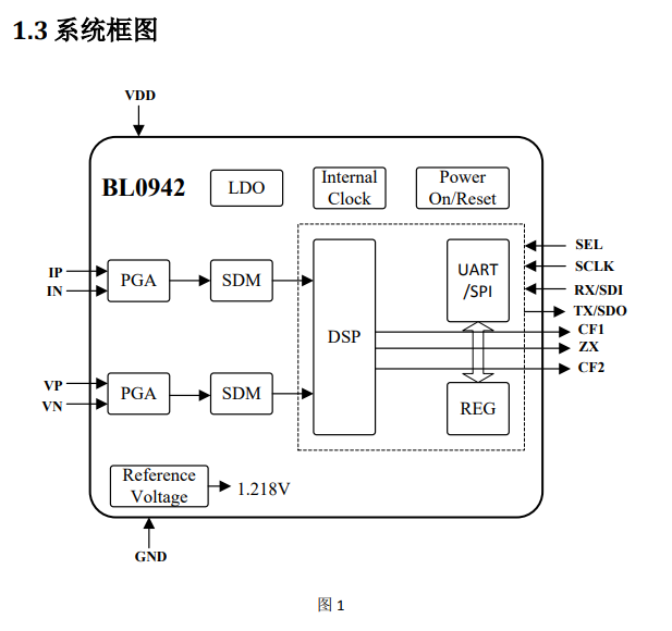

    Communication with BL0942
    Datasheet of BL0942 shows that baud rate 4200 is used.

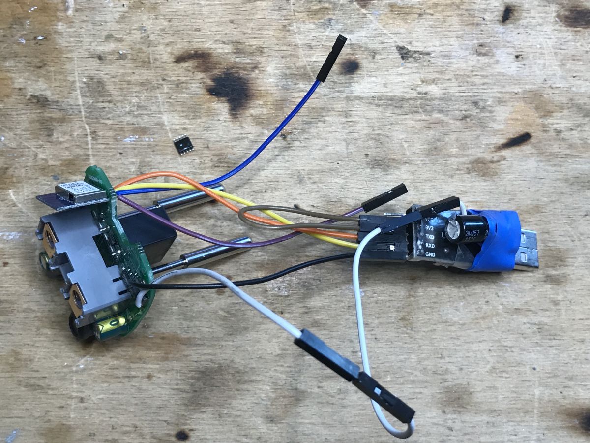

    Flashing the firmware by UART - OpenBK7231N - part2
    At first I decided to desolder the BL0942, but do not worry - it turned out to be not necessary. I will just leave the photos here for the reference.
    Tuya LSPA9 smart socket - teardown, OpenBeken flashing guide for CB2S, BL0942
    By the way, the Tuya firmware noticed the BL0942 missing right of the bat.
    And here is my flashing setup:
    Tuya LSPA9 smart socket - teardown, OpenBeken flashing guide for CB2S, BL0942 Tuya LSPA9 smart socket - teardown, OpenBeken flashing guide for CB2S, BL0942
    Flashing:
    For rebooting the chip, I used the CEN method. It is tricky because you have to connect to CEN to ground for a very short while. That sometimes confuses beginners.
    Then I soldered BL0942 and checked flashing again - it still worked. Most likely the baud rate difference and/or the specific packet expected by BL0942 to send reply was enough to ensure that it will stay silent during flashing.

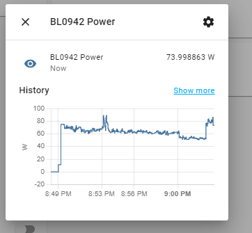

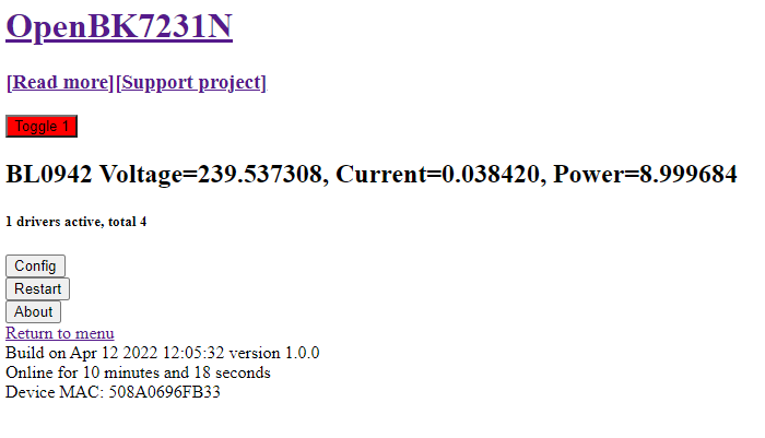

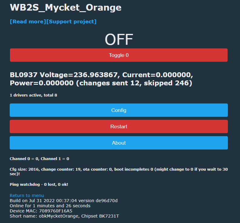

    After that, the main page should start showing measurements:

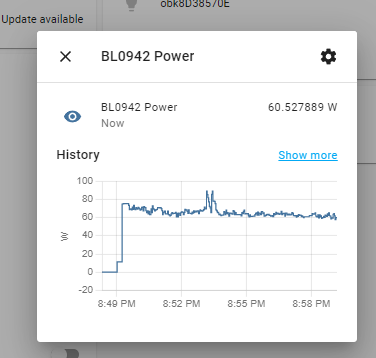

    Measurements with no load, before calibration:
    That voltage value is way too high! This is not acceptable. We need to calibrate.
    The measurements of 60W bulb without calibration:
    Again, those are wrong.

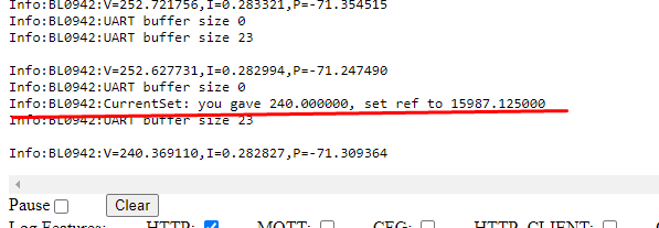

    Now, move the plug to the OpenBeken socket and enable it (OpenBeken must be measuring the very same bulb when you do the calibration, the bulb must be on!).
    Now, in the command line, type commends: VoltageSet [correntVoltageVal], CurrentSet [correntCurrentVal] i PowerSet [correntPowerVal], and write down the system replies (the correct calibration constants for your very device)
    System replies:
    So, write down that VREF = 15987.125000
    PREF = -683.023987
    IREF = 272302.687500

    Configuration YAML foor Home Assistant
    Now it's time to send our measurement results to Home Assistant by MQTT.
    First, the MQTT needs to be configured in Config->MQTT, just like with any other device.
    Then, peek to Config->Generate Home Assistant Config to get short device name, something like obk0696FB33.
    You can also copy the configuration from there, but it will work only for relay mode.
    Extra manual configuration is required for power metering.
    Here is an example:
    sensor:
      - platform: mqtt
        state_topic: "obk0696FB33/voltage/get"
        unit_of_measurement: "V"
      - platform: mqtt
        state_topic: "obk0696FB33/current/get"
        unit_of_measurement: "A"
      - platform: mqtt
        state_topic: "obk0696FB33/power/get"
        unit_of_measurement: "W"
    Replace my device short name with your device names.
    After changing configuration.yaml, restart the Home Assistant. Then you should already get measurement results visible on HA charts:

    Let's play around a bit. This is power consumption by my notebook in normal power mode:
    Will "Power saving mode" from Windows change power consumption?
    As you can see, not much. What about "High performance" mode?
    Some more measurements, after a certain time:
    Voltage:
    I have rechecked it with my Brymen BM857s and indeed, the voltage has changed over time.

    Posts: 14757
    Rate: 12885
    Basic BL0937 implementation is working already, altough I will be improving it in the future.
    For BL0937 configuration, please set appropriate pins in the pins config. The driver should start automatically.
    For calibration, follow the BL0942 steps, the commands are the same.
    Remember that your pinout might be different.

    jony4t
    Posts: 21
    Hi. for my wifi plug this is the configuration. thanks for your help. Tuya LSPA9 smart socket - teardown, OpenBeken flashing guide for CB2S, BL0942

    Just thought I'd share my device details of an Australian single plug with power monitoring. The make/model is Brilliant Smart/20925 Series II
    Tuya LSPA9 smart socket - teardown, OpenBeken flashing guide for CB2S, BL0942 [img-1] Tuya LSPA9 smart socket - teardown, OpenBeken flashing guide for CB2S, BL0942 Tuya LSPA9 smart socket - teardown, OpenBeken flashing guide for CB2S, BL0942
    I've been replacing a bunch of newer devices with ESP based chips but came upon this project and decided to have a go. A fairly steep learning curve but I made it and now have the plug (with power monitoring) working in Home Assistant.
    The config is:
    I de-soldered the chip to program it and also to accurately trace to ensure which pins the BL0937 chip was connected to. It took a while and I cocked up my mirroring/tracing which too a couple of hours to untangle. Whoda thunk it would take so long to trace 3 lines - maybe because it was past midnight!! :not:
    After that I had difficulty setting the calibrations for the BL0937, I tried to use the "VoltageSet" command in the web interface but it did not work. It did work in the /app interface though.
    Anyway it's working so I'll say thanks to all who have contributed and all hail :please: to their computing prowess

    Arlec Grid Connect Smart Plug (PC191HA)
    Chip = WB2S
    Power Chip = BL0937
    Work well also, had to remove the WB2S to flash as the button is attached to the RX line.
    These work out cheaper in the 4 pack @ $65.00 and the button is better located on the top
    https://www.bunnings.com.au/arlec-grid-connec...g-in-socket-with-energy-meter-4-pack_p0273368

    I had a bit trouble with calibrating. When I set "VoltageSet 225" or "CurrentSet 0.138" it happend to me that the device wasn't anymore reachable and disconnect itself from my WiFi. My guess is some trouble with parsing the command in the backend.
    So I tried a couple of times and it appeared to me the feedback "Command not found", but eventually it worked.

    I'm still unable to calibrate the power meter. I tried with OpenBK7231N_1.15.22 and OpenBK7231N_1.15.30 firmware. If I send 'VoltageSet 234, CurrentSet 0.266, PowerSet 62.8' or any of the individual commands it does not crash but it responds with 'Command not found'. Have you had any success with the power calibration jet?

    DerThomas
    @nkuehnel86 Thank you for your very detailed response!
    nkuehnel86 wrote:
    So after flashing, write "startDriver BL0942" in the command line, measure voltage, and current of a reliable consumer (like a 60 W light bulb). The command line told me as well "Command not found" but it does worked. When you go back to the main page the voltage is around the value it supposed to be. Same as current and power. I performed a restart (power off) of the device after the calibration to see if it was saved, and so it was.
    So maybe my device is already calibrated and I do not know because I just had eyes for the "Command not found" message :-)
    OK tested it again and you are abolutely right - it is executing the calibration and only sending the wrong reply to the screen
    Because of this post of @p.kaczmarek2 I just expected a different message:

    omelchuk890
    Posts: 70
    Rate: 10
    Greetings to all forum members.
    Has anyone come up with a way ...
    to open the socket housing with minimal aesthetic losses?
    I carried out six "operations" - there is no stability, the amount of glue and the length of the filling are different in each case.
