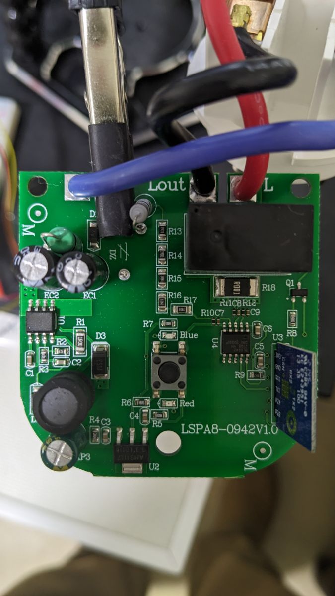

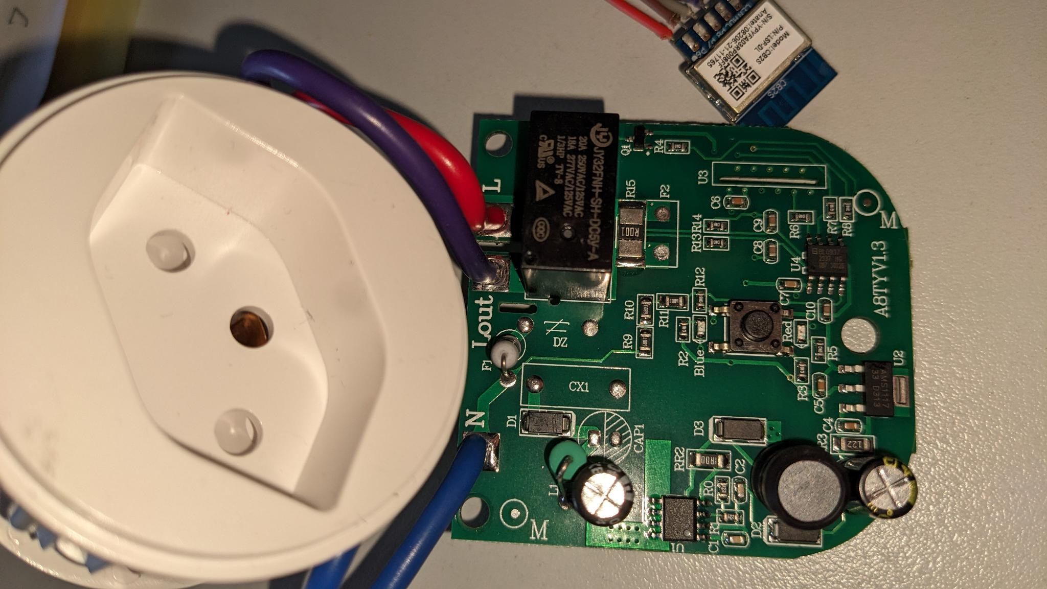

    Photos of the inside of the Smart WIFI Switch
    Generic Tuya WIFI Smart Socket for different countries (LSPA8) Generic Tuya WIFI Smart Socket for different countries (LSPA8) Generic Tuya WIFI Smart Socket for different countries (LSPA8) Generic Tuya WIFI Smart Socket for different countries (LSPA8)

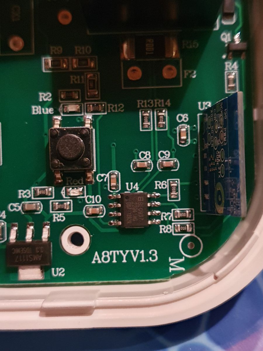

    The next photo shows how to program the WB2S.
    3.3V, GND, RX and 1RX have to be connected to the UART programmer.
    Program a new firmware with the BkWrite tool.
    At beginning of programming, connect CEN to GND for 1 sec to reset the BK7231T.
    Important: To program the WB2S, the switch on the PCB connected to the 1RX pin of the WB2S module needs to be disconnected (because it has a pull up resistor which disturbs the programming). This can be done easily: Just "remove" the solder from the 1RX pin which connects the two PCBs so that the two PCBs are no longer connected on the 1RX pin.

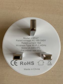

  • BK7231tools flash offset 0x11000 for LSPA7 plug
    #5 20300613
    beniamino38
    Thanks for this post! I am new to this, and used this info to get OpenBK on a similar but smaller plug. Mine is a generic 16A UK LSPA7, but the internals are similar -- WB2S and BL0937. It opened easily with a craft knife, and I had to desolder the AC power pins to remove the main board. The WB2S would not accept programming when attached to the main board, so I desoldered it altogether. I also found that 'uartprogram' failed, first with an error 'cannot set baud rate', and then (at a lower baud rate) a write error. I tried bk7231tools with an offset of 0x11000, which worked fine. The OpenBK configuration settings seem to work correctly for this device -- the LEDs, relay and power measurement all seem to be working. Thanks again!
    Generic Tuya WIFI Smart Socket for different countries (LSPA8) Generic Tuya WIFI Smart Socket for different countries (LSPA8) Generic Tuya WIFI Smart Socket for different countries (LSPA8) Generic Tuya WIFI Smart Socket for different countries (LSPA8) Generic Tuya WIFI Smart Socket for different countries (LSPA8)
    Edit: The chip was reported as a "BK7231S_1.0.6" but I used the BK7231T firmware.
  • #6 20300619
    Posts: 14755
    Rate: 12880
    It's good that it worked out. Tell me if you need any special features, I can add them for you.
    LSPA7 is not yet on our devices list, so thank you for photos, I will add them here:
    If you have any other IoT devices not listed, feel free to post a separate teardown in this forum section.

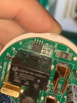

  • OpenBK flash succeeds but CB2S plug stays offline
    #8 20422032
    itzikR
    Hi.
    Thank you very much for this post.
    I have a similar plug, looks completely identical, also using CB2S.
    See attached p
    hoto.
    T tried flashing OpenBK using bk_writer1.6 and also the BK7231 Easy UART Flasher.
    I can download the firmware successfully, (see attached) but the device will not come up and I am not able to find it with WiFi scanner.
    Any ideas?
    Thank

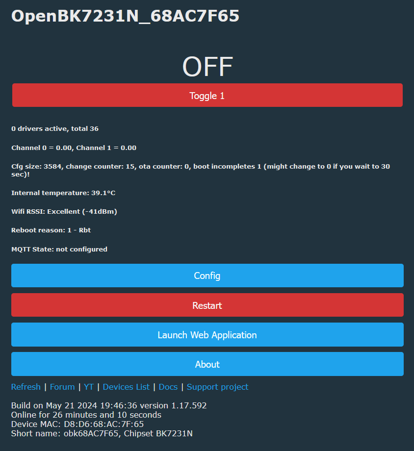

  • #9 21087931
    geni0815
    Posts: 7
    Hello, I have this LBP8 (Link) which has the CB2S chip
    I have flashed the version 1.17.588 Chipset BK7231N and configured the same as the version with the WB2S.
    Now the relay works but the power monitor shows all values as 0.
    What do I have to change in the configuration?
    • signal-2024-05-19-130009_002.jpeg (356.67 KB) You must be logged in to download this attachment.
  • #10 21087938
    Posts: 14755
    Rate: 12880
    Have you tried to do Tuya Config Extraction?
    @itzikR the WiFi will not work if you are powering device from low quality/low power power supply. Try desoldering flashing wires and run it with original circuit
  • #11 21089314
    geni0815
    Posts: 7
    Thanks, everything works!
