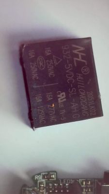

    I will present here the interior of a very cheap "outdoor" Tuya socket, which also offers energy measurement. Here I will provide information on how to change its firmware and show the ready configuration OpenBeken for this slot. I will show how to run the statistics system for this socket in OBK and use the Home Assistant Discovery. This socket has a WB2S WiFi module inside and a BL0937 chip for energy measurement OpenBeken Support.
    Mycket Smart Socket PE-01E IP44
    The socket is quite distinctive, I think it will be easy to recognize, even though I won't include screenshots from the listing here - I just got them from its importer who supports OpenBeken's development.
    Here is the box:
    Mycket Smart Outdoor Socket PE-01E IP44 with energy measurement Mycket Smart Outdoor Socket PE-01E IP44 with energy measurement
    The interior of the PE-01E, loading the charge
    Unfortunately, it is not a Blitzwolf BW-SHP6 that is easy to disassemble and assemble. It is also not simply a clone of LSPA9. The cover can be removed, but then there is a problem with the pins:
    You can see the energy measurement system - BL0937.
    The pins do not twist. They are soldered. Unfortunately...
    The PCB was removed, but at what cost:
    There is a WB2S module inside. I took it out for programming:

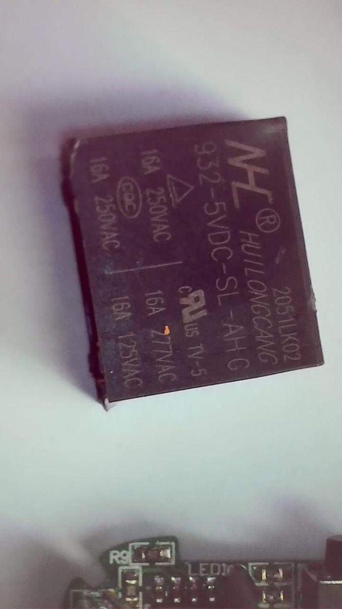

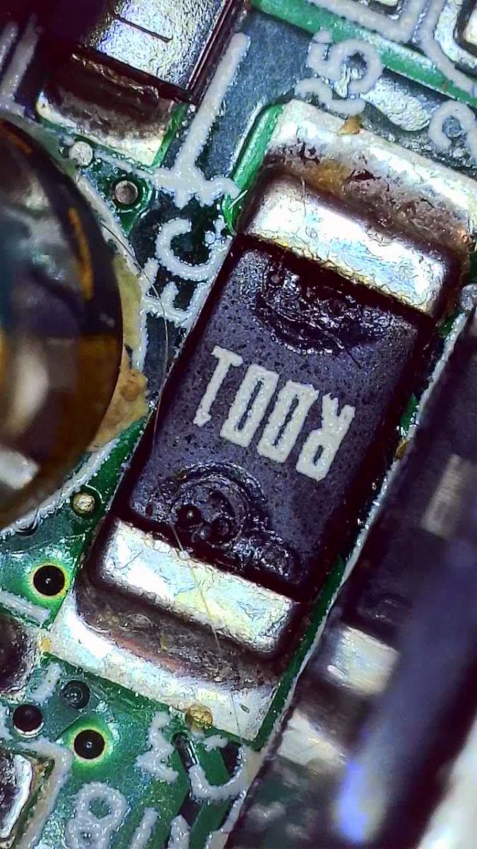

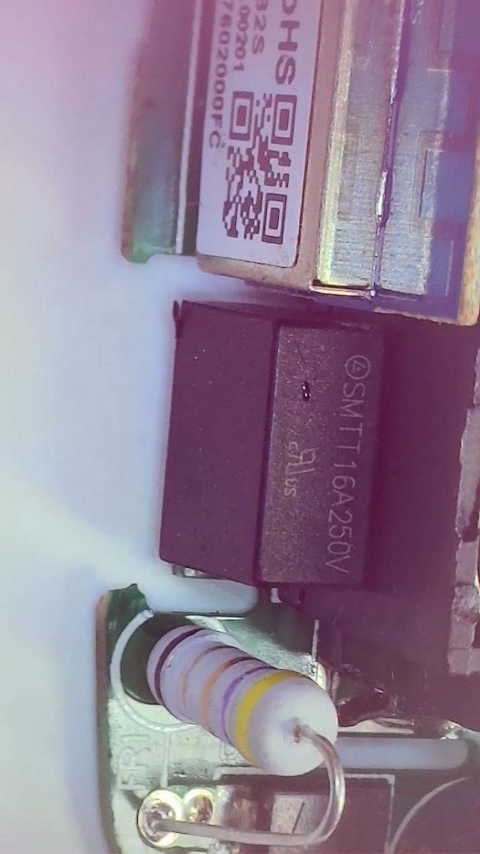

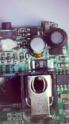

    In this socket, as in the documentation, there is a 1mOhm shunt?
    https://datasheet.lcsc.com/lcsc/1811151441_BL-Shanghai-Belling-BL0937_C94616.pdf So the equipment is deadly to fumble around at work, I don't follow the topic but it's probably 99.99% of cases that there is a shunt instead of a CT.
    What is the resolution of the current / power measurement?
  • BL0937 energy meter likely uses 1 mΩ shunt
    #3 20386417
    dbizarro
    Here you have some pics....

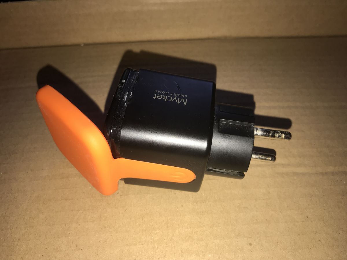

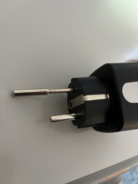

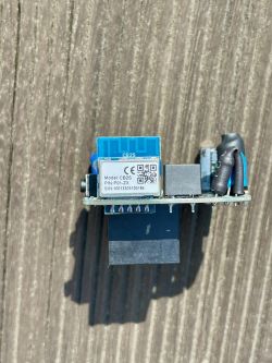

  • Request for details on resoldering hidden socket pins
    #4 20790915
    ThWi
    Hi
    may I ask how did you solve this:
    "Luckily I had a soldering iron strong enough and the pins returned to their place"
    Because I believe if i use a strong enough soldering iron i will will smell the plastic cover where the pins are in? Furthermore, how can I be sure that solder is successful placed because I cant see it anymore the cover hides it?
    Can you give more details how you solved the problem?
    Tnx in advance
    Thomas

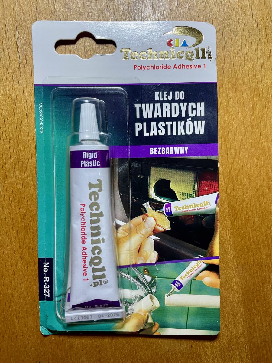

  • Pb solder mix and wick used for case joint

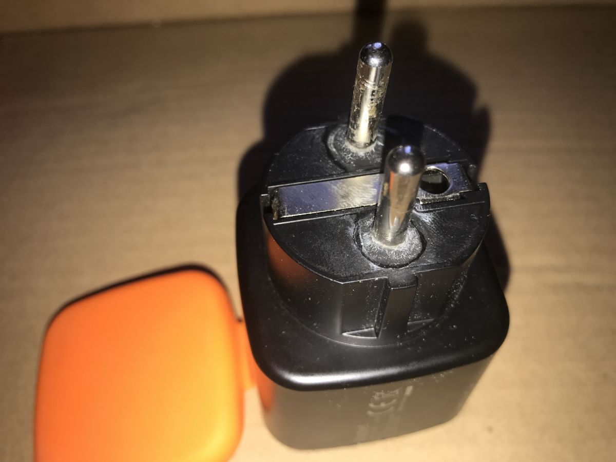

    #5 20791696
    Posts: 14797
    Rate: 12955
    Hello @ThWi, welcome to Elektroda.
    There is no magic in soldering, I just mixed some Pb solder with the original one, added some flux, then used solder wick to remove the old solder mix, then readded new Pb solder (because of the low melting point of the mix), melted it well and then made the joint.
    Futhermore, in this particular case, I think I soldered pins first, then I put on the case, but I may be wrong. It was long time ago already.

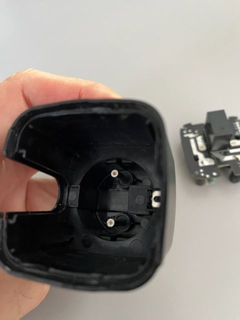

  • Pins should be inside the cover, not bottom-mounted
    #6 20791775
    ThWi
    thanks for your feedback.
    I think I got it, you right soldering isn't a big issue.
    But the pins shout be inside the cover (moved from buttom). May be I'm wrong but it might be you reamed the hole for the pin? I've no clue how it could work? Please have a look to the pictures? I know is not a mycket because I have GreenSun Plugs, but it is exact the same only, vendor and color are different ;-)
    thanks for your assistant.

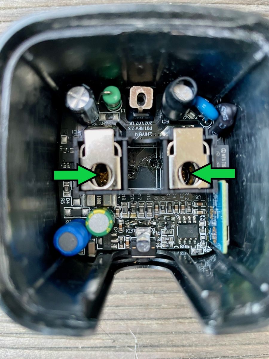

    ThWi Interior of a plastic casing with two protruding pins and a disassembled electronic component. Two-pin electrical plug on a grey surface.
  • Tuya JSON pinout for PE-01E socket
    #7 20791960
    Posts: 14797
    Rate: 12955
    Ah, I see what you are asking for, I can see the problem, but I don't remember how I solved it.
    I can show you how socket looks now:
    Black and orange smart plug adapter with three prongs. Close-up view of a black plug with two metal pins.
    I can see that I glued the pins.... but I dont remember why.
    Btw, here's a Tuya JSON for this device:
  • #8 20792312
    ThWi
    Hi,
    great, this points me out! I can see the glue means you drilled out the cover holes to put the pins from "inside" through the hole. That's what I expected.

  • PCB removal is difficult on this socket model
    #16 21101011
    Posts: 14797
    Rate: 12955
    Now I understand, so you have specifically this version, the "external" one? Well it's hard, it's going to get worse and worse, they probably don't even produce devices on the old software anymore.
    What method do you use to dismantle it now? On this particular model there is a problem with removing the PCB at all. Apparently it can also be done like this:
    Two white, damaged smart plugs by BLOW with exposed internal electronics. Close-up of a damaged electrical device with a visible opening through which wires and a PCB are protruding. View of a modified electrical plug with exposed wires and PCB. Damaged plastic device casing with visible interior and PCB. Damaged plastic device casing with visible interior and PCB. but that might be even worse way in terms of tightness, because how to fix it afterwards..

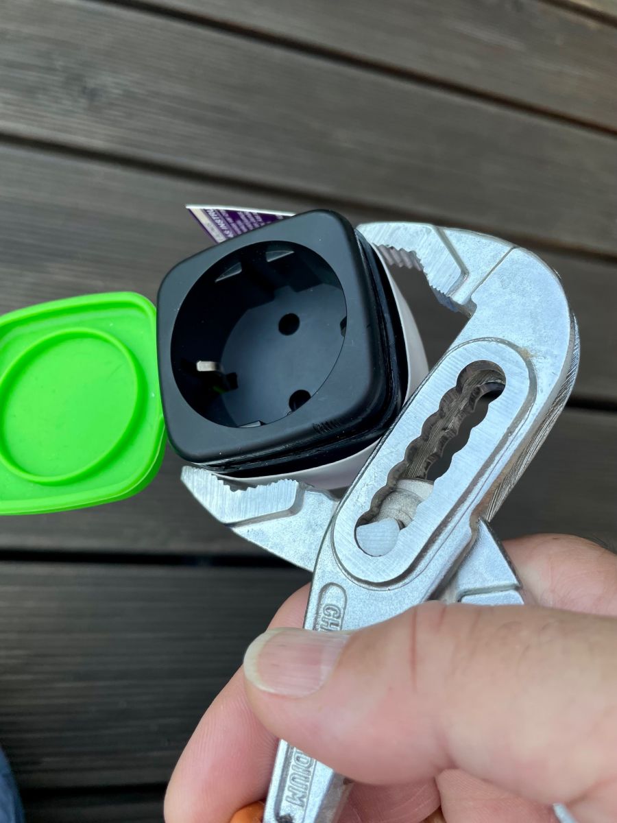

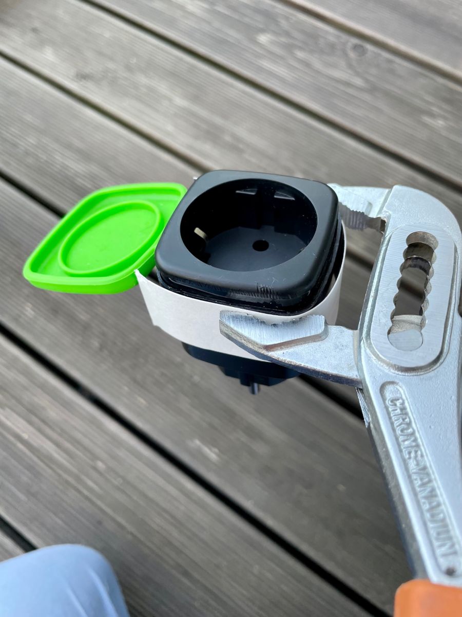

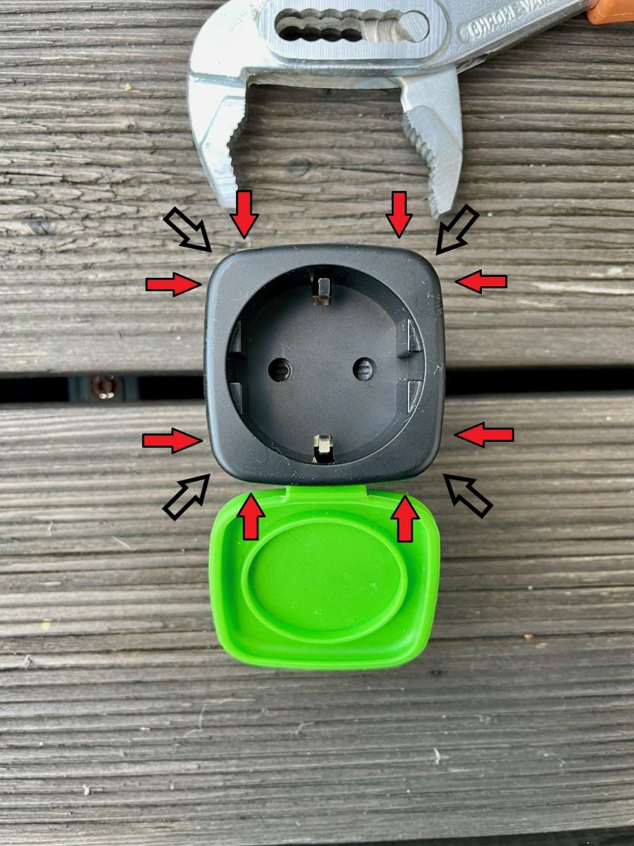

  • Non-destructive opening and reassembly of PE-01E socket
    #18 21114565
    tomik67
    Posts: 111
    Rate: 11
    I managed to open this plug harmlessly.
    Inspired by the frame idea, I used a vise for the first plug and a hydraulic spanner for the other two.
    In both cases, use spacers of hard cardboard or thin plastic to avoid unsightly damage to the housing.
    The imprints visible in the photos are the remnants of previous unsuccessful attempts to open the socket.
    1 Using a plumber's spanner through the spacer, squeeze the plug at the top of the housing at the points marked by the arrows repeatedly with varying force and feel, diagonally across the plug also.
    With enough pressure you should hear the cracking of the glue points of the lower and upper housing, after which you should feel that the upper part is loose, if it still holds something, with up-down, left-right movements eliminate the last points of resistance.

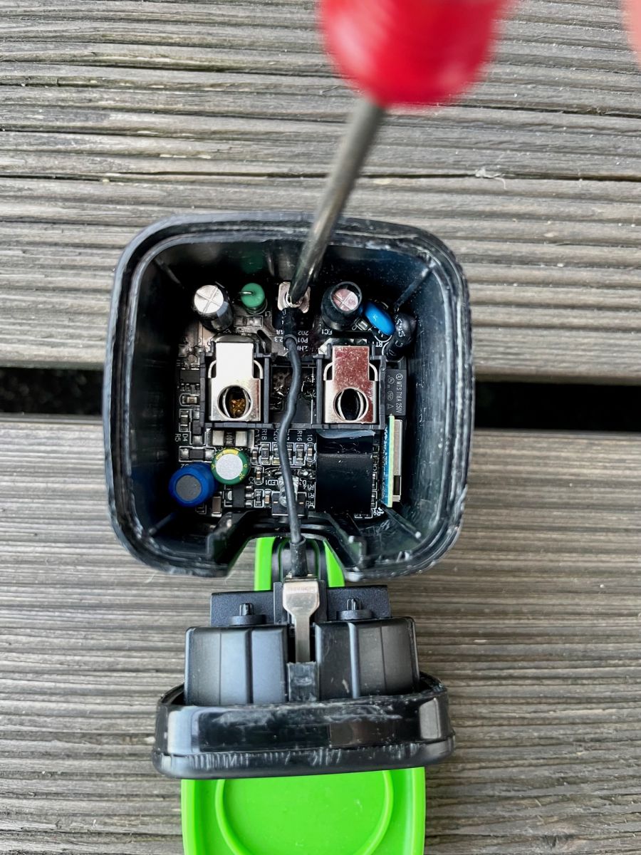

    Example of using a pipe wrench to open a plug. Electrical plug held in a pipe wrench with a cardboard spacer. The image shows a disassembled plug and a pipe wrench on a wooden surface. Red and black arrows indicate pressure points on the black casing. .

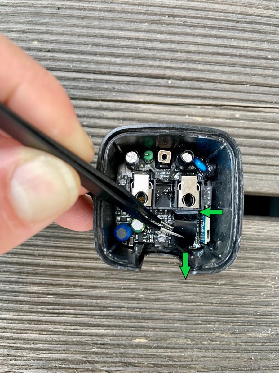

    2. after freeing the top of the case, unscrew the earth wire
    Opened plug housing with visible electronics inside. .
    3. then gently cut the silicone with which the cover of the PCB mounting screw is glued and slide out the freed cover
    Opened plug housing showing internal components with highlighted arrows. .
    4 This gives us access to the two mounting screws securing the PCB to the chassis located in the plug pin sockets, we pull out the PCB
    Inside view of a plug housing with visible electronic components and marked arrows. .
    Assemble everything in reverse order.
    To get IP44 splash proof again you need to glue the plug together, I used hard plastic glue for this Technicqll Polychloride Adhesive 1 which melts the plastic at the connection point for better effect and tightness and I left the compressed housing for 12 hours for the glue to cure. Clean the case tongue and groove before gluing.
    Packaging of Technicqll adhesive for hard plastics .
    Of the three plugs received in one delivery only one had a WB2S module, the others had CB2S, the PCB in all was the same.
    PCB with CB2S module and CE markings on a wooden surface. .

  1. Clamp the top shell gently with a hydraulic spanner using plastic spacers; apply diagonal pressure until glue joints crack.

  3. Remove two hidden screws inside the pin cavities, then slide out the PCB [Elektroda, tomik67, post #21114565]
How do I restore waterproofing after reassembly?
Clean the tongue-and-groove, apply polychloride adhesive, press the shells in a vice for 12 h. The glue re-melts the plastic and recovers the IP44 rating [Elektroda, tomik67, post #21114565]
