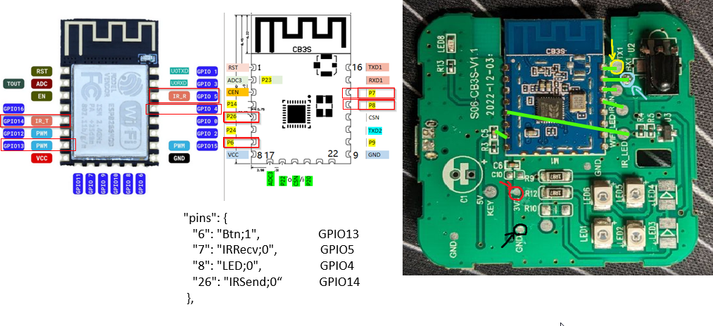

  • Tuya S06 IR Blaster with a CB3S module was converted to an ESP-12F and flashed with tasmota_ir.bin to capture and replay Panasonic fan IR codes.
  • The mod relied on matching power, chip enable, and reset pins, plus added 10k pullup/pulldown resistors for Chip Enable and GPIO15.

I have a requirement to be able to capture/send IR RAW data to make my Panasonic Fan working.
Since IR RAW feature will take some time to appear in OpenBeken, I decided to go the hard way.
I had a S06 with CB3S Module.
When you inspect the CB3S Module alongside ESP-12F you could see a perfect match for critical PINs like Power, Chip Enable and Reset.
ESP-12F and CB3S modules with S06 IR Blaster board.
So I decided to replace the CB3S Module with ESP-12F Module.
I first flashed tasmora_ir.bin image on to ESP-12F (There are plenty of tutorials available on flashing ESP-12F module on the internet).
I did not do a very good job in de-soldering and soldering in the new module. It was the first time for me to use the heat gun and I accidentally blew off a tiny SMD resistor and a capacitor in the process. Hopefully I can do a better job next time :-)
Circuit board with ESP-12F module and component labels.
I blew up R3 & C5 [4] during the process. These are connected to RESET button on the device. For the moment the RESET button is trivial for me as I can always power cycle the device externally. Perhaps I will make some corrections later to the hardware.
Close-up of a circuit board with a highlighted section showing electronic components.
Needed to solder 10k pullup/pulldown resistors as shown for Chip Enable [1] and GPIO15 [2] as shown.
One more issue remains. I could not get the LED8 [3] to light up. When I touch the R13 with a tweezer the LED gets lit up faintly. The output on GPIO4 where the LED is connected to toggles between 0V and 3.2V ish value correctly. Need to see whether R13 needs to be changed. Again this is a trivial matter for me at the moment.
