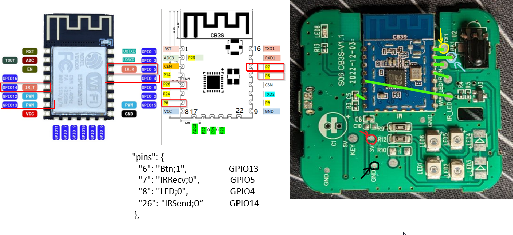

    I have a requirement to be able to capture/send IR RAW data to make my Panasonic Fan working.
    Since IR RAW feature will take some time to appear in OpenBeken, I decided to go the hard way.
    I had a S06 with CB3S Module.
    When you inspect the CB3S Module alongside ESP-12F you could see a perfect match for critical PINs like Power, Chip Enable and Reset.
    ESP-12F and CB3S modules with S06 IR Blaster board.
    So I decided to replace the CB3S Module with ESP-12F Module.
    I first flashed tasmora_ir.bin image on to ESP-12F (There are plenty of tutorials available on flashing ESP-12F module on the internet).

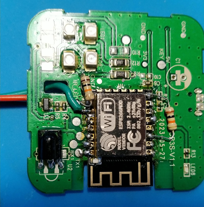

    I did not do a very good job in de-soldering and soldering in the new module. It was the first time for me to use the heat gun and I accidentally blew off a tiny SMD resistor and a capacitor in the process. Hopefully I can do a better job next time :-)
    Circuit board with ESP-12F module and component labels.

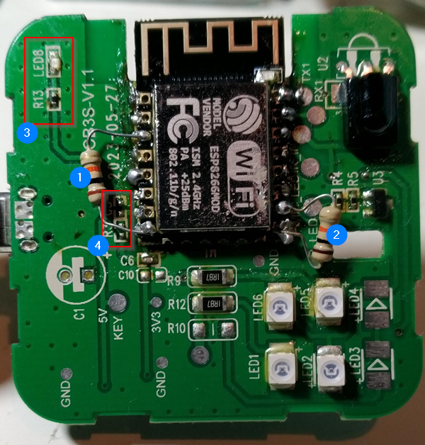

    I blew up R3 & C5 [4] during the process. These are connected to RESET button on the device. For the moment the RESET button is trivial for me as I can always power cycle the device externally. Perhaps I will make some corrections later to the hardware.
    Close-up of a circuit board with a highlighted section showing electronic components.
    Needed to solder 10k pullup/pulldown resistors as shown for Chip Enable [1] and GPIO15 [2] as shown.
    One more issue remains. I could not get the LED8 [3] to light up. When I touch the R13 with a tweezer the LED gets lit up faintly. The output on GPIO4 where the LED is connected to toggles between 0V and 3.2V ish value correctly. Need to see whether R13 needs to be changed. Again this is a trivial matter for me at the moment.

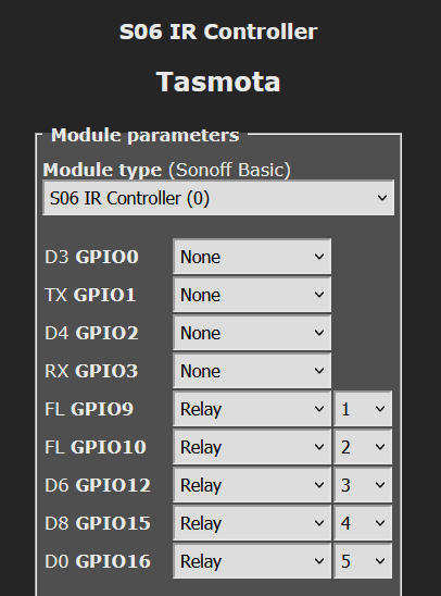

    Tasmota Setup:
    Screenshot showing template parameters settings for S06 IR controller in Tasmota.

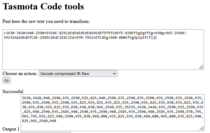

    The following conversion is not required. We can directly play back the above raw data string received
    The RAW data received can be converted in to a string which can be transmitted using IRSend command using the following tool:
    https://tasmota.hadinger.fr/util
    Screenshot of Tasmota Code Tools with raw IR data.
    Data received in following RAW Date message can be played back:
    21:32:56.983 RSL: RESULT = {"IrReceived":{"Protocol":"UNKNOWN","Bits":78,"Hash":"0x94972B6F","Repeat":0,"RawData":"+3525a+830-2700Bc+825-935DcBcDcBeDeBeDeDeB-2695BeDeDcBeDeDeDcDc+845-2675DfBcDeD-39350+3565-3485DfBcDeDcDc+850hDeL-910D-940DeDeDcBeDeDcDeDeDeBfDcDcDfDcDeDiA-3520DcDcDeDcL-2670+855pLmDnLmDeDnDcQmLmLpDnDeDeLpDcLpQpLpLmD","RawDataInfo":[155,155,0]}}
    IRSend 0, +3525a+830-2700Bc+825-935DcBcDcBeDeBeDeDeB-2695BeDeDcBeDeDeDcDc+845-2675DfBcDeD-39350+3565-3485DfBcDeDcDc+850hDeL-910D-940DeDeDcBeDeDcDeDeDeBfDcDcDfDcDeDiA-3520DcDcDeDcL-2670+855pLmDnLmDeDnDcQmLmLpDnDeDeLpDcLpQpLpLmD
    I did a further optimization by deleting parts of the string from the end, working backwards until I find a +/- symbol. When you press the remote you might press it too longer than required. So the extra data stream can be removed like this on trial & error basis. This way you can figure out the minimum length of data string to play back. See the example of Tasmota rule for the final outcome.

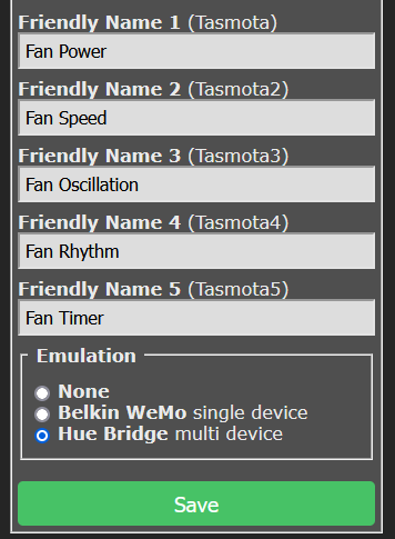

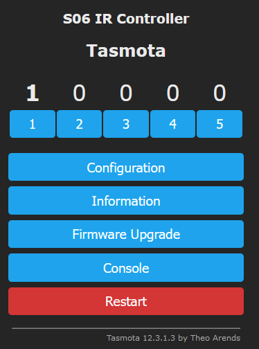

    Defined 5 x Virtual Relays using unused GPIOs to be used as Buttons on WebGUI:
    Screenshot of Tasmota configuration for S06 IR controller
    User interface of S06 IR Controller in Tasmota

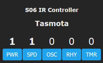

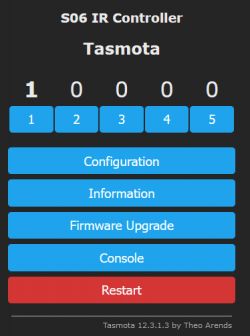

    Changed the labels on the buttons:
    02:36:18.449 CMD: WebButton1 PWR
    02:36:18.454 RSL: RESULT = {"WebButton1":"PWR"}
    02:36:29.105 CMD: WebButton2 SPD
    02:36:29.110 RSL: RESULT = {"WebButton2":"SPD"}
    02:36:39.275 CMD: WebButton3 OSC
    02:36:39.281 RSL: RESULT = {"WebButton3":"OSC"}
    02:36:53.438 CMD: WebButton4 RHY
    02:36:53.443 RSL: RESULT = {"WebButton4":"RHY"}
    02:37:03.340 CMD: WebButton5 TMR
    02:37:03.344 RSL: RESULT = {"WebButton5":"TMR"}
    Tasmota user interface with five control buttons.
    Created Tasmota Rules for button toggles (here is an example for PWR and SPEED buttons:
    Rule1
    ON POWER1#STATE DO IRSend 0,+3500-3550+875-2650+880dC-885CdCdC-2645EfC-890CfEfCfCdEfCfCdCfCfCfCdCdCdCgEdCfC
      ENDON
    ON POWER2#STATE DO IRSend 0,+3500-3550+855-2670CdC-910+850dFdCdCdFdCdCdCdFeC-905CeCdCeCeFeCeFeFeCgCeCdC ENDON
    Now the Fan can be controlled via Web URL or MQTT using POWER1, POWER2, POWER3, POWER4, POWER5 commands.

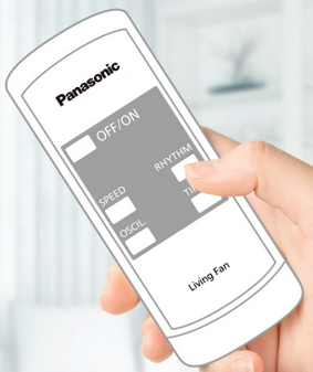

    jkwim wrote:

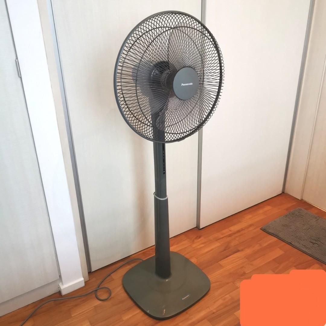

    my Panasonic fan
    Which fan? ceiling?
  • #3 20877192
    jkwim
    Posts: 186
    Rate: 25
    Like this:
    Panasonic standing electric fan on a wooden floor in a bright room.

    The fan already had a remote controller with 5 buttons.
    Panasonic remote control for a fan with five buttons in a hand.
    I created 5 buttons on Tasmota GUI.
    [Well, I actually went further. I did a custom build of Tasmota with IR Raw driver only and then activated Philips Hue Bridge in Tasmota. Now I can integrate the 5 buttons as 5 devices to Alexa]
    Tasmota GUI with 5 buttons for fan control.
    A little awkward conversation with Alexa:
    "Alexa, turn on Fan Speed!" and I see the POWER2 ON command on Tasmota.

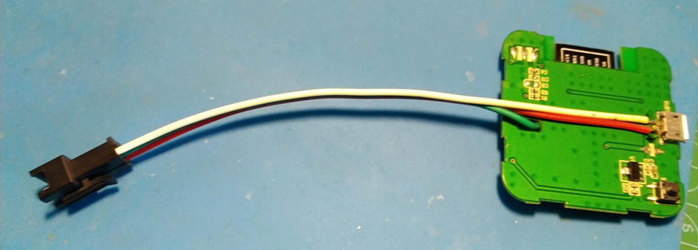

    I wanted to add a connector for a WS2812 Led Strip to the same PCB so that I can mount this neat device on the wall and have dual functionality.
    1. Soldered a JST Pigtail's power wires directly to the USB connector so that external 5V can be directly supplied to LED strip.
    PCB with connected JST connector and three wires.
    2. Soldered the Data wire to GPIO2

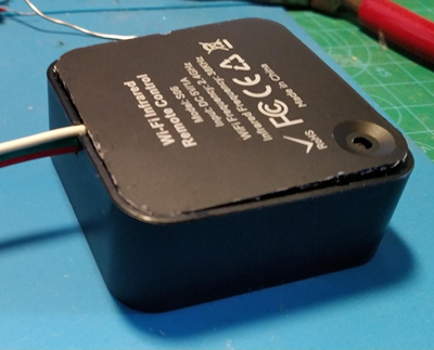

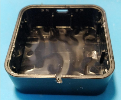

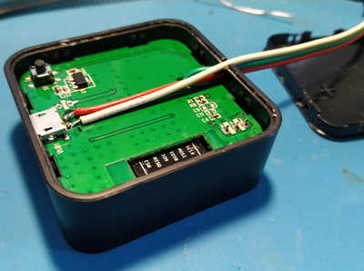

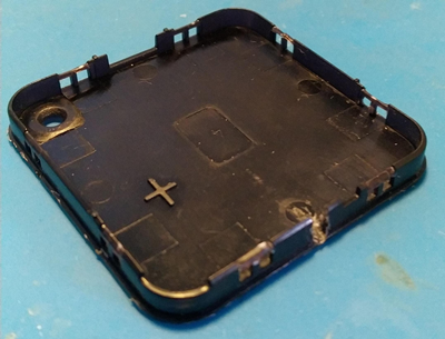

    3. Prepared the casing with a small cutout for the wires
    Plastic casing with cutout for wires
    Plastic base of an electronic device housing on a blue background.
    PCB board with connected power wires and casing
    Black Wi-Fi enclosure with cables on a blue table background.
    Now I have a neat dual function IOT device.

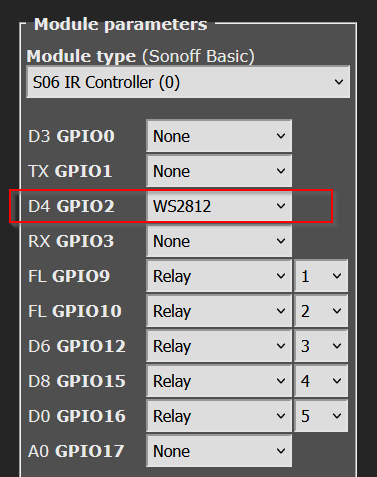

    Configured GPIO2
    Screenshot of Sonoff Basic module parameters with WS2812 selected for D4 GPIO2.
    And now I have LED strip controls as well.

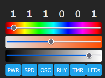

    12:56:00.452 CMD: webbutton6 LEDs
    12:56:00.457 RSL: RESULT = {"WebButton6":"LEDs"}
    IOT control panel with RGB sliders and six buttons.
    Once I connect this to the MQTT network, many things can be done. Even an animation via MQTT is possible.

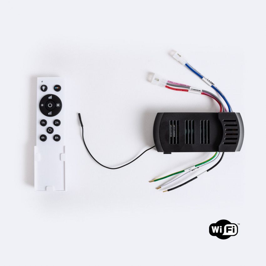

    @jkwim Have you considered using a Tuya compatible universal fan controller? Maybe you could reprogram it and adapt it to your needs.
    WiFi controller with remote for BLDC fan.
  • Longer IR codes require Tasmota RAW support
    #9 20878341
    jkwim
    Posts: 186
    Rate: 25
    The main reason that I did all this is that this particular remote requires longer codes which OpenBK does not support at the moment. I was told that adapting Tasmota's RAW codes is in the plan. So until such time, I took the shortcut. The added benefit was that I am able to use Philips Multi Device Hue Emulation and incorporate this into the existing Alexa config easily.
    OpenBK supports Wemo protocol for a single device, and I am currently using it for a different device.
    I would certainly look into the controller that you have mentioned to see whether it can control a 3x switch controlled old desk fan that we have. I don't know how reliably you can implement the 3x switch interlock mechanism found in old fans, i.e., only one of the speed switches can be left pressed at a time. When you use relays, you need to ensure that only one relay gets activated at a time and that there should be a delay between deactivation of the first relay and activation of the second relay to ensure power is fed only to one of the coils.

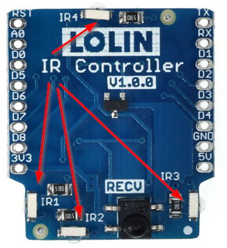

  • Wemos D1 Mini IR shield as alternative build

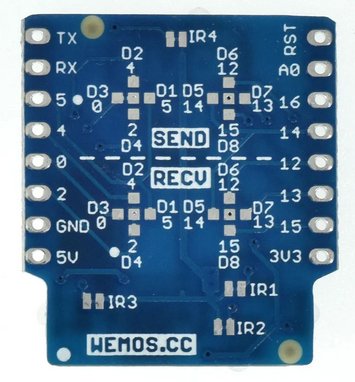

    If you are building from scratch, there is another option. For Wemos D1 Mini there is a stackable IR Shield available
    IR module for Wemos D1 Mini with labels IR1, IR2, IR3, and IR4.
    Blue PCB of IR shield module for Wemos D1 Mini with labels and pins.
    https://www.aliexpress.com/item/32891173618.html

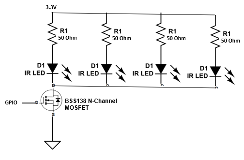

    Just curious how to add more ir transmitter properly on the esp01m board
  • Parallel LED driver circuit for extra IR transmitters
    #15 20909130
    jkwim
    Posts: 186
    Rate: 25
    ferbulous wrote:
    @jkwim yes, i already have the d1 mini with the ir shield.
    Above IR Shield board has 1 x transistor and 4 x resistors to drive 4 x LEDs.
    If you trace the paths probably it will be 4x Resistor+LED strings in parallel driven by the transistor.
    Something like this (apologize for my crude way of illustrating it):
    Circuit diagram with MOSFET transistor and LED diodes.
    If you replicate the above circuit on a PCB and connect it to a GPIO, then it should work.

  • The finished fan control setup used 5 WebGUI buttons mapped to fan functions: PWR, SPD, OSC, RHY, and TMR. [#20876437]

How do you create virtual relays and WebGUI buttons in Tasmota to control fan functions like PWR, SPD, OSC, RHY, and TMR?
Define unused GPIOs as relay outputs, then rename the Web buttons and attach IR rules to each power state. The thread used 5 virtual relays and renamed them with WebButton1 PWR, WebButton2 SPD, WebButton3 OSC, WebButton4 RHY, and WebButton5 TMR. Each button then triggered a rule such as ON POWER1#STATE DO IRSend ... ENDON. That turned the Tasmota WebGUI into a five-button fan remote. [#20876437]

How do you add more IR transmitter LEDs for wider coverage on an ESP-01M or DIY Tasmota IR board, and what resistors or transistor driver circuit should be used?
Use one transistor driver and multiple resistor-plus-LED branches in parallel from a GPIO-controlled stage. The thread notes that a D1 Mini IR shield uses 1 transistor and 4 resistors to drive 4 LEDs, likely as four parallel resistor+LED strings switched by the transistor. Replicating that circuit on a PCB should widen IR coverage more safely than tying several LEDs straight to a GPIO. If transmit never works, the driver stage is the first place to verify. [#20909130]
