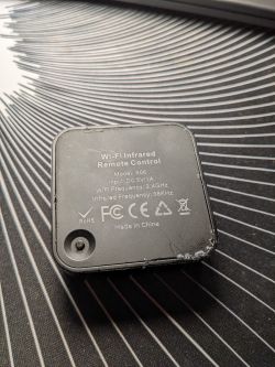

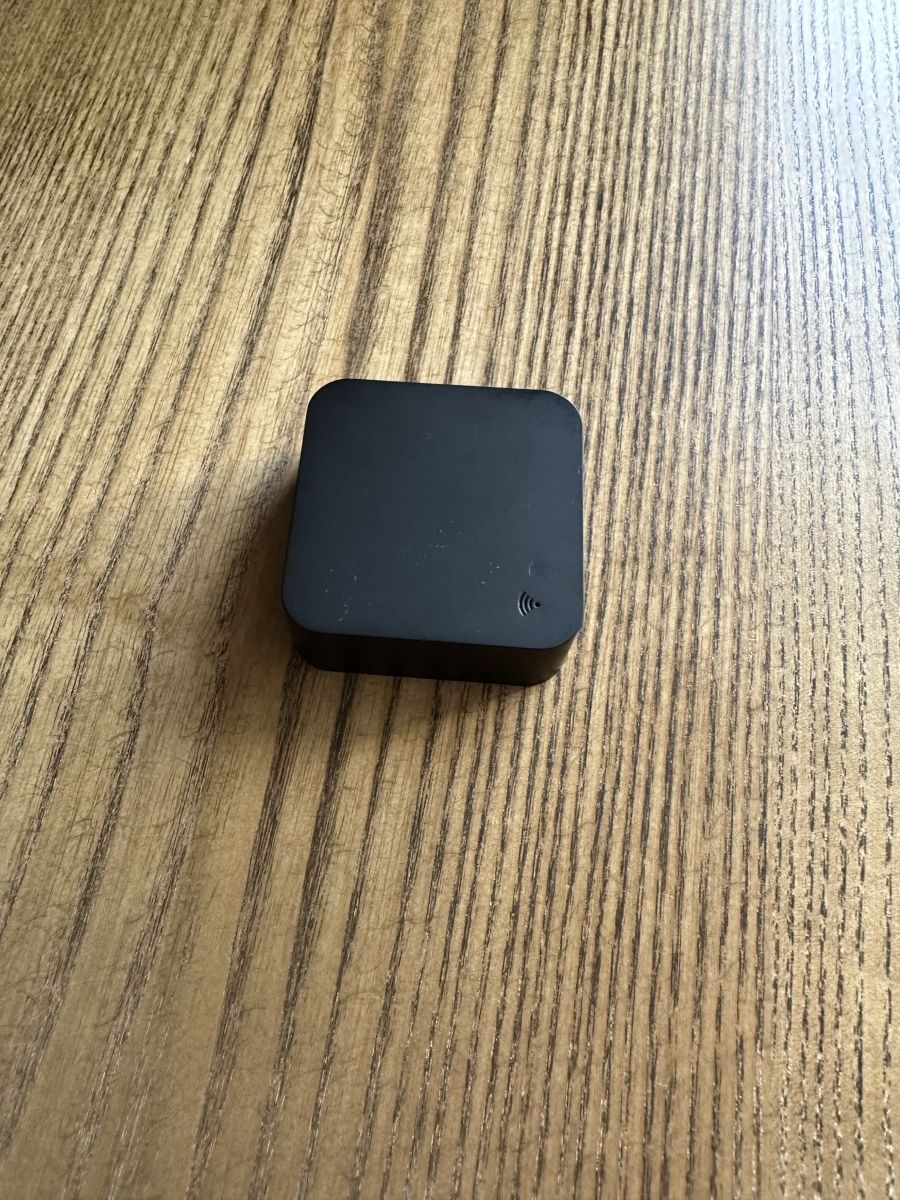

  • Hello,
    this product is the S06 Version of the IR Blaster. For the S06Pro Version I found this Teardown article:
    https://www.elektroda.com/rtvforum/topic3926882.html#20238985
    Which is similar, has the same package and case but a different pcb and another Chip. I didnt found this product on the official list so I took it on me to make a little post for someone who had the same questions like me.
    Teardown, flashing and configuration for Smart Tuya IR Blaster S06 [CB3S] Teardown, flashing and configuration for Smart Tuya IR Blaster S06 [CB3S]

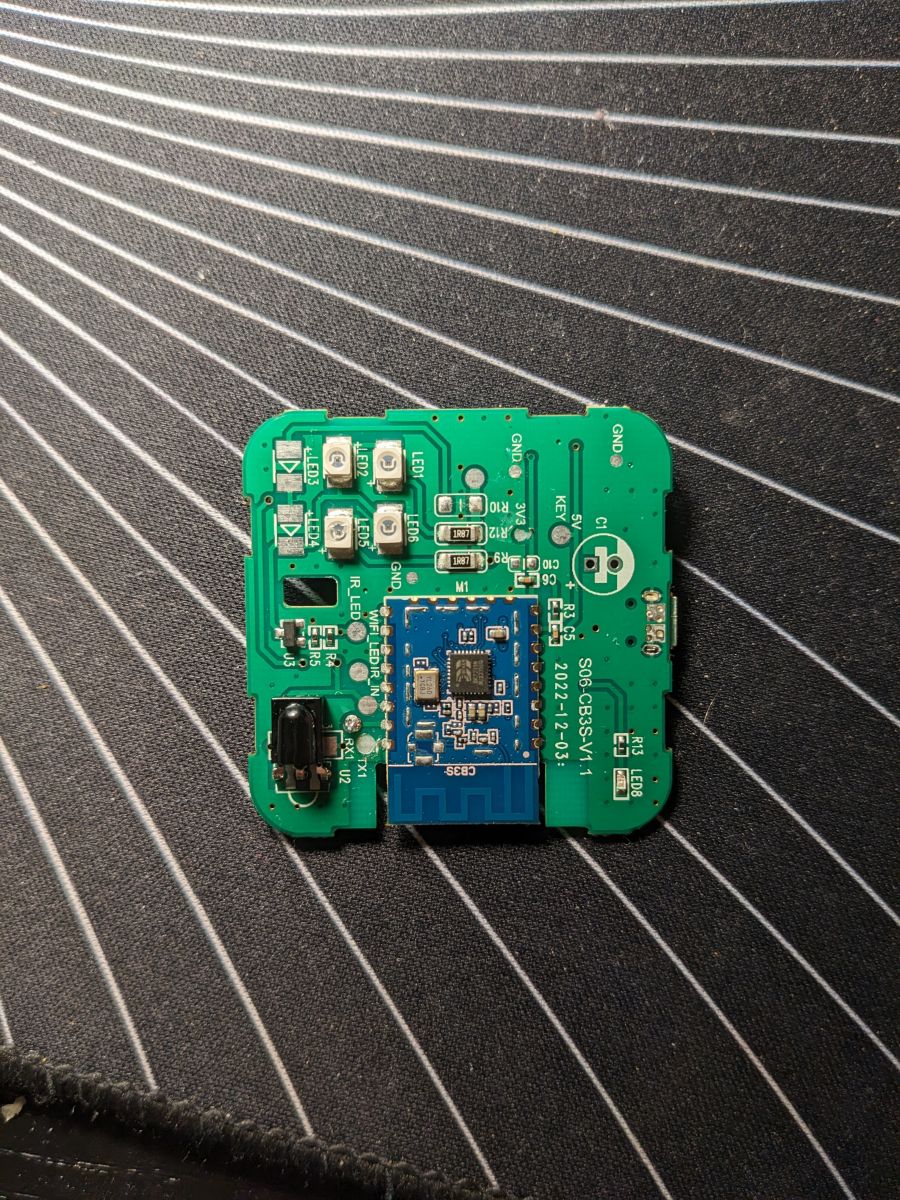

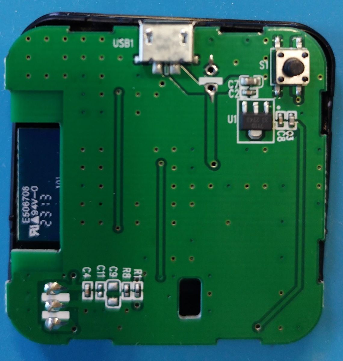

    This IR one uses the CB3S chip. Here is the PCB

    I used the BK7231Flasher Tool to Flash the Chip with the OpenBK7231N Firmware. The Tool is very useful and even downloads the right file for you. Because this IR Blaster uses the CB3S Chip, you have to select BK7231N Type. After downloading the firmware I connected the Chip to my USB to TTL bridge. You can use any bridge (The Github guide of the tool was a good tutorial). It should have VCC on 3.3V. I soldered the wires onto the PCB on the right places, no need to go straight onto the chip.
    VCC-> 3.3V
    GND -> GND
    RX -> TX1
    TX -> RX1
    (See colored Points in picture)

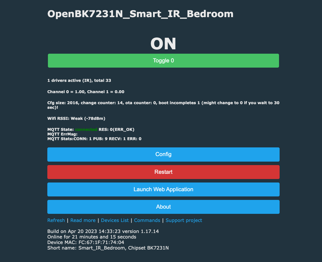

    After starting the flash process I disconnected the VCC wire from the TTL Bridge and reconnected it, instead of shorting ground with the CEN pin. After Flashing it, it opened the Access Point and I could configure it on the webpage.
    The Pin Configuration is this (This took the longest time to find out, by using the multimeter and Trial and Error):
    IRRecv | P7 (PWM1)
    IRSend | P26 (PWM5)
    LED | P8 (PWM2)
    Btn | P6 (PWM0)

    Can you copy-paste JSON config from "Launch Web Application" main page?
  • BK7231N config with pin mapping and TODOs

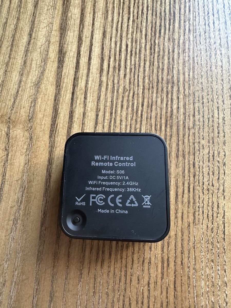

    The same configuration is working for S18 version of IR blaster:
    Teardown, flashing and configuration for Smart Tuya IR Blaster S06 [CB3S] Teardown, flashing and configuration for Smart Tuya IR Blaster S06 [CB3S] Teardown, flashing and configuration for Smart Tuya IR Blaster S06 [CB3S]
    To open you need to use something flat.
    RX, TX, 3.3V and GND pads are on the back of board but it is easier to solder directly to CB3S.

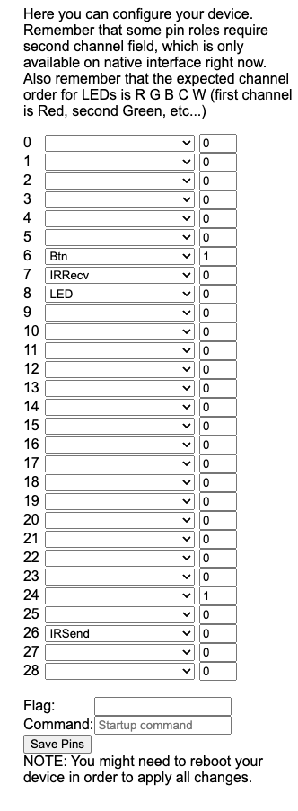

  • IR receiver not logging any codes
    #12 20549513
    rakalexei
    Posts: 21
    Hey guys, I have a question regarding how to read IR codes. I successfully flashed the device, filled out pins like this
    "pins": {
    "6": "Btn;1",
    "7": "IRRecv;0",
    "8": "LED;0",
    "26": "IRSend;0"
    Then I checked the Logs page and tried to point my tv remote to the IR box, but nothing happened, no logs regarding any cmd or codes. What I'm doing wrong?

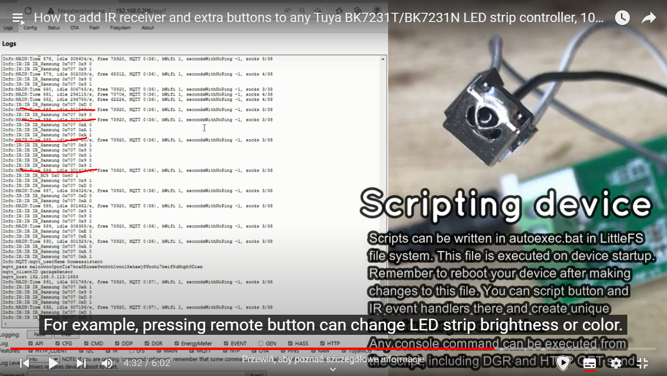

  • #13 20549613
    Posts: 14755
    Rate: 12878
    @rakalexei is the GPIO config correct?
    Take a look here, there should be logs in the Web App:
    A screenshot from the video above:
  • IR receive works after pin remap, but send fails
    #14 20549684
    rakalexei
    Posts: 21
    @p.kaczmarek2
    Hey, thank you for your reply. I think I have some progress :) I changed my pins to this one
    "pins": {
    "8": "IRRecv;0",
    "24": "WifiLED;0",
    "26": "IRSend;0"
    Now I can receive codes from my TV remote control like this - Info:IR:IR IR_Samsung 0x707 0x2 0.
    Then I tried to execute a command: IRSend Samsung 0x707 0x2 0
    Info:IR:IR send Samsung 0x707 0x2 0 protocol 18 addr 0x707 cmd 0x2 repeats 0
    Info:CMD:[WebApp Cmd 'IRSend Samsung 0x707 0x2 0' Result] OK
    But TV is not reacted to that command. I need further help, what to do?

  • AC codes not readable after flashing firmware
    #23 20550928
    rakalexei
    Posts: 21
    @p.kaczmarek2
    Good day, I solve the issue, and found the correct PIN, I'm able to receive and send commands to my Samsung TV, but I couldn't get any codes from my AC.
    Is it a limitation of the firmware or how I can read the codes? Before I flashed it, it could control AC without problems.
    Looking for advice.
    "pins": {
    "7": "IRSend;0",
    "8": "IRRecv;0",
    "24": "WifiLED;0"

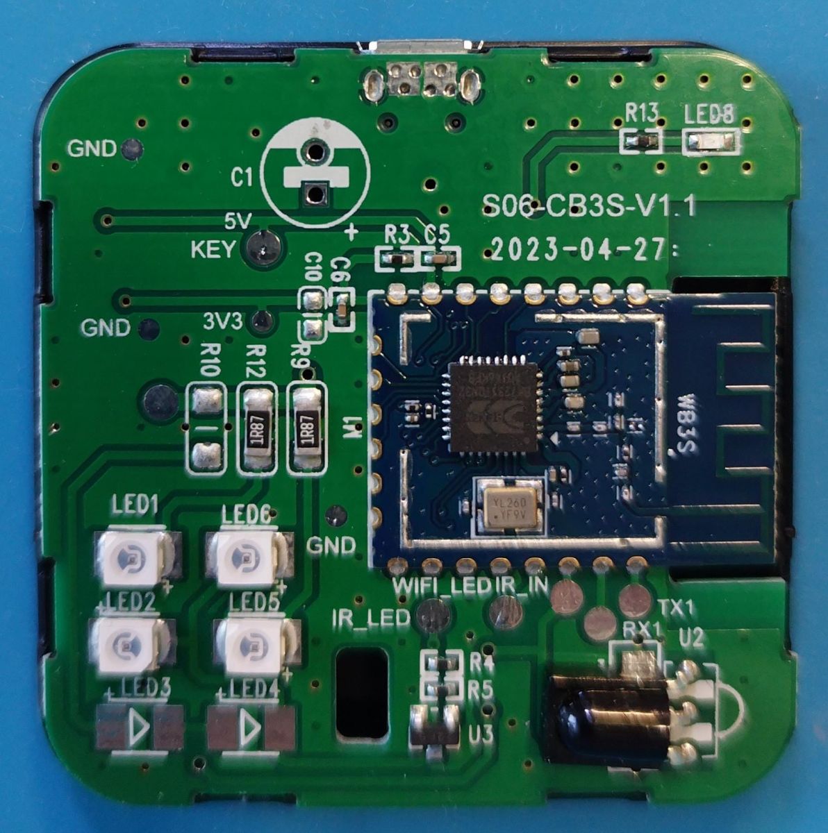

    Hello, I have one of these with exactly the same PCB as the OP's BUT a different wifi module, WB3S instead of CB3S. The silkscreen states "S06-CB3S-V1.1" (same as the OP's), so it seems the PCB was originally designed for CB3S but later on some units were sold with a different module, almost pin-for-pin compatible but with different MCU, BK7231N in CB3S and BK7231T in WB3S.
    So this probably explains why some of the people who posted here have had difficulties using the same configuration as the OP. Analyzing the PCB and the module's datasheet, in my case, the configuration should be the same as posted here for this device. The differences are shown in the following table:
    PIN FUNCTION CB3S WB3S
    5 IR_LED GPIOP_26 GPIOP_26
    7 KEY GPIOP_6 GPIOP_6
    13 WIFI_LED GPIOP_8 GPIOP_9
    14 IR_IN GPIOP_7 GPIOP_8
    These are the pictures of my unit's PCB:
    Printed circuit board with a WB3S module and various electronic components. Image of a green printed circuit board with electronic components and a USB connector.
    In case it's of help for somebody, I'm attaching the original FW of my device (EDIT: V1.1.3)

    drmarvel wrote:
    @morgan_flint I managed to flash
    But ¿Which FW did you flash? ¿Open Beken, as per the first post, or the original FW I posted here?
    In the first case, just configure Open Beken by acceding the web page at the IP that your router assigned to the device and configure it using the template posted by zweigang here, if your unit has the CB3S module, or, if your module is WB3S, use the same template with the following "pins" section:
      "pins": {
        "6": "Btn;1",
        "8": "IRRecv;0",
        "9": "LED;0",
        "26": "IRSend;0"
    Only the lines for IRRecv and LED change.
