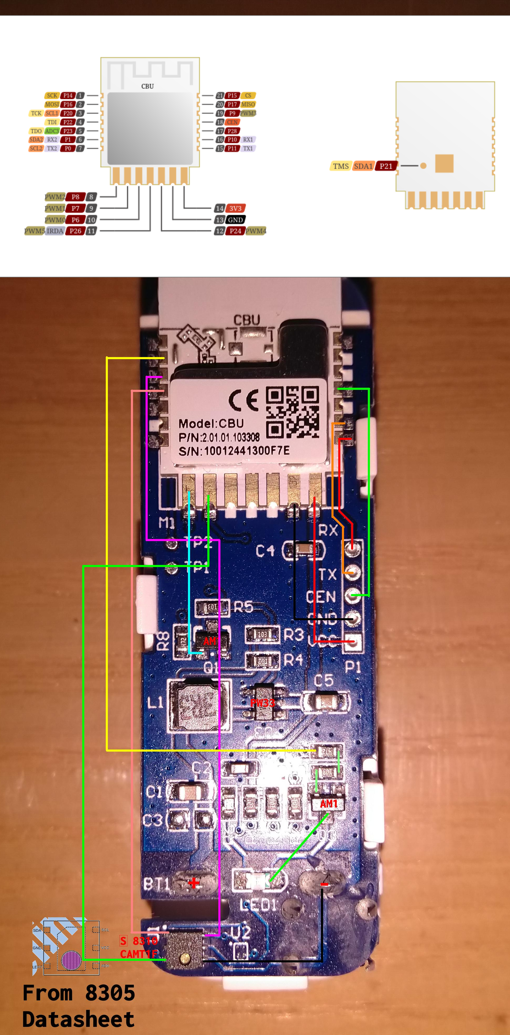

I recently bought a few of 'Tuya WiFi Temperature and Humidity Sensor'.
I looked for an existing thread for this exact device but only found a few users posting pictures of this board.
Here is a picture of the PCB: PCB board of Tuya WiFi sensor with highlighted components and connections.
And here is the firmware from an unused device:
tuya_r..zip (1002.72 kB)You must be logged in to download this attachment.
Tuya JSON:
It does not have a TuyaMCU and is using I2C to communicate with the Temp+Humidity sensor CHT8305.
This device requires deep sleep to run on batteries longer than few days.
Please see related topics for details:
https://www.elektroda.com/rtvforum/topic4025593.html
https://www.elektroda.com/rtvforum/topic3945688.html
https://www.elektroda.com/rtvforum/find.php?q=CHT8305
I have flashed esphome and aside from I2C, and deep-sleep, everything else works.

I hope this information is sufficient to 'port'/support openbeken for this device.
Let me know if i can help any other way.

johnypean 13 Jan 2024 21:03
I have it working quite well. I have gathered information from multiple threads about these sensors here. Even the battery is working and showing up in HASS. "pins": { "8": "BAT_Relay;0", "14":... [Read more]

nacxoffw 29 Jan 2024 17:42
Hi! Thanks a lot about this post and the information given. I have one of this PCB with CBU chip. Here a resume about my configuration: https://obrazki.elektroda.pl/2744555700_1706546227_thumb.jpg... [Read more]
nacxoffw 30 Jan 2024 07:17
Solved!! Setting Channel 4 for gpio of configured battery send MQTT data. https://obrazki.elektroda.pl/7046929300_1706595312_thumb.jpg Data appear as unavailable in sleep time is solved after... [Read more]
