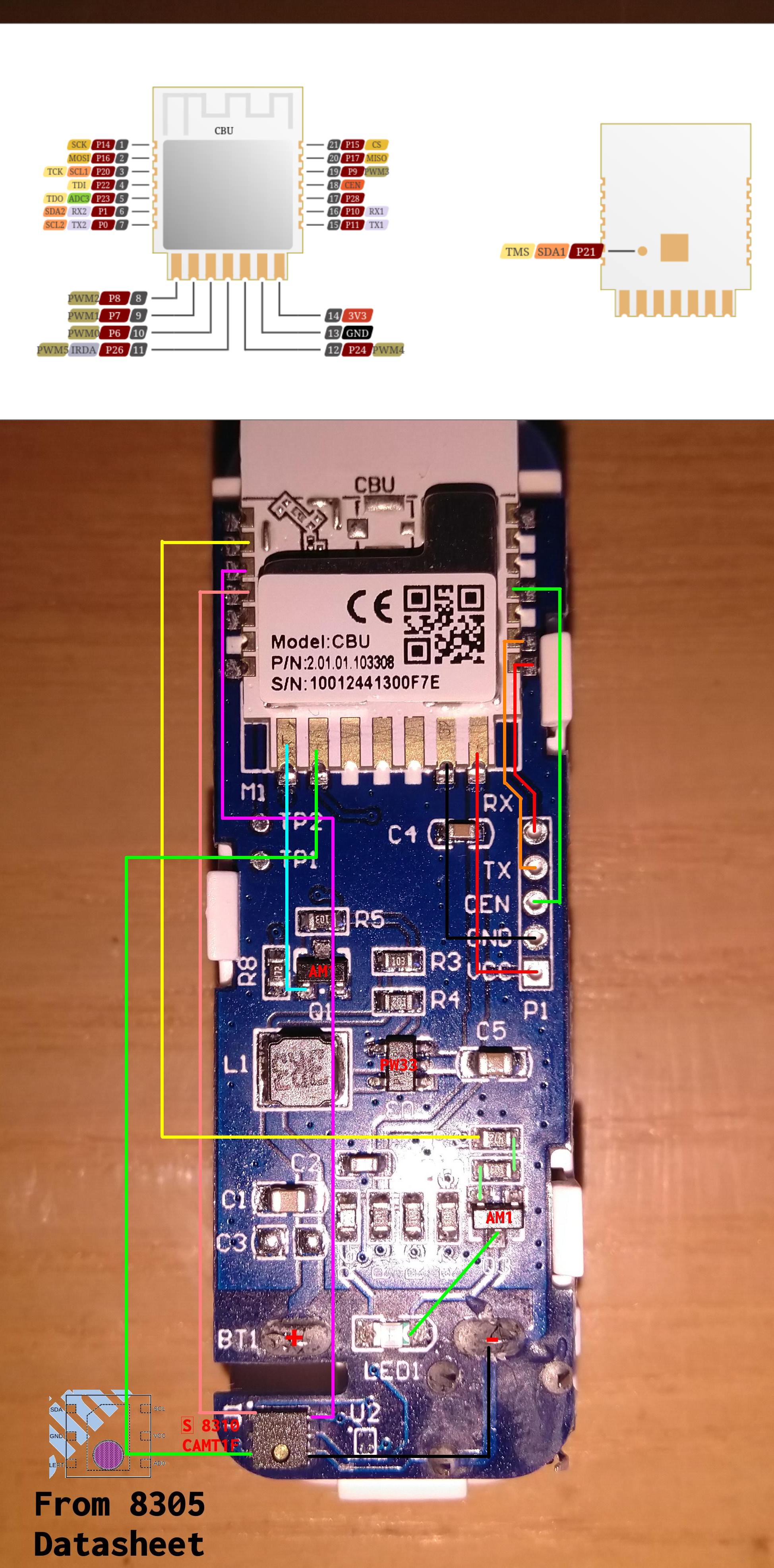

  • I recently bought a few of 'Tuya WiFi Temperature and Humidity Sensor'.
    I looked for an existing thread for this exact device but only found a few users posting pictures of this board.
    Here is a picture of the PCB: PCB board of Tuya WiFi sensor with highlighted components and connections.
    And here is the firmware from an unused device:
    tuya_r..zip (1002.72 kB)You must be logged in to download this attachment.
    Tuya JSON:
    It does not have a TuyaMCU and is using I2C to communicate with the Temp+Humidity sensor CHT8305.
    This device requires deep sleep to run on batteries longer than few days.
    Please see related topics for details:
    https://www.elektroda.com/rtvforum/topic4025593.html
    https://www.elektroda.com/rtvforum/topic3945688.html
    https://www.elektroda.com/rtvforum/find.php?q=CHT8305
    I have flashed esphome and aside from I2C, and deep-sleep, everything else works.

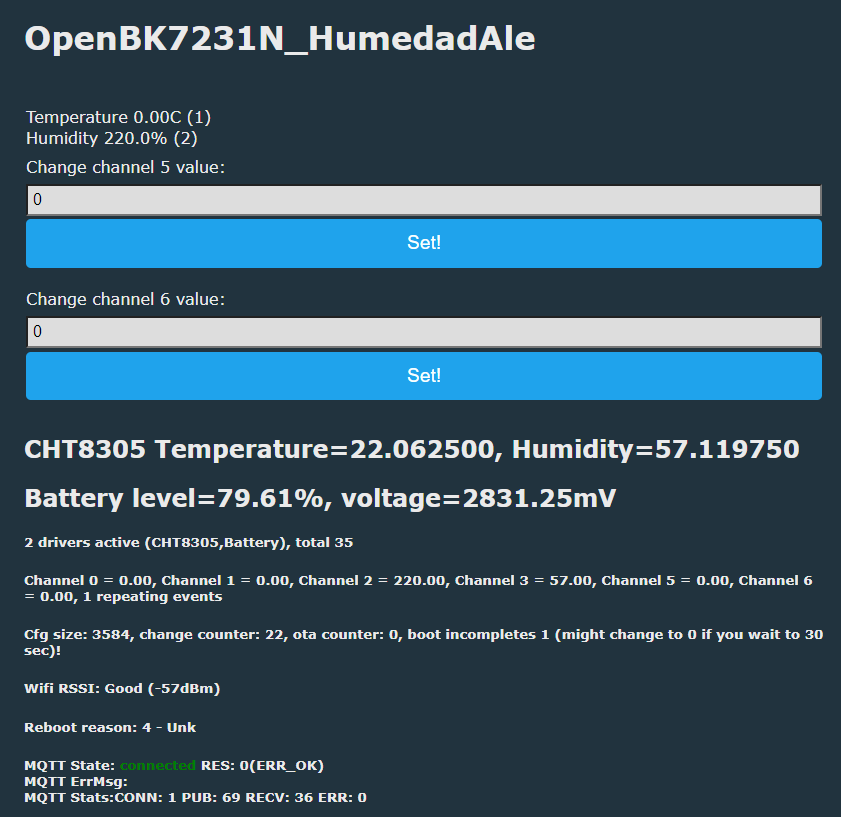

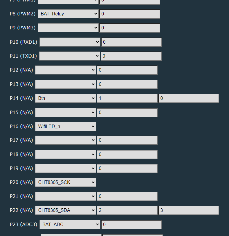

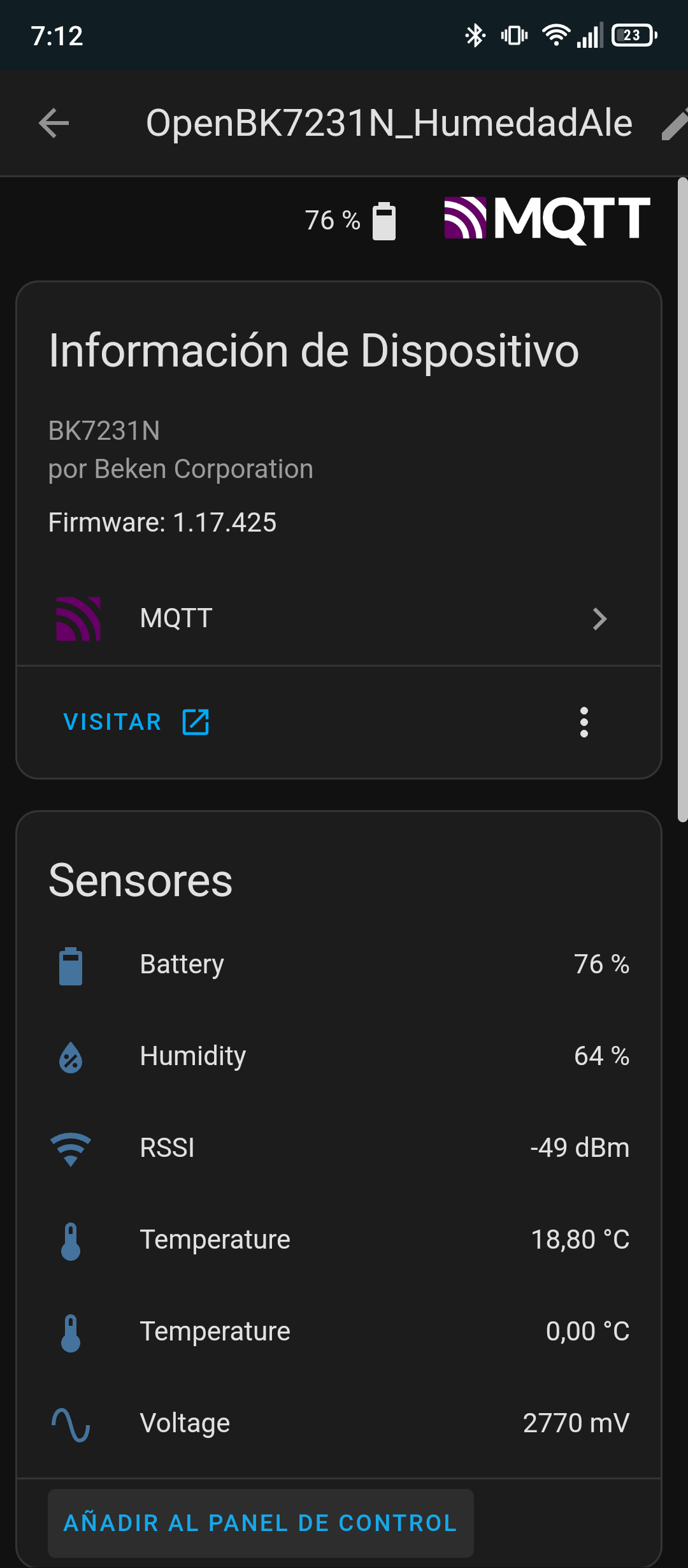

    Here a resume about my configuration:
    Screenshot of the OpenBK7231N_HumedadAle user interface showing temperature, humidity, battery level, and other details. Screenshot showing port configuration for a PCB board with CBU chip. Screenshot of script code with configuration information about sleep mode.
    Flags to 1092
    Logs about MQTT:
    Info:MAIN:Time 97, idle 59042/s, free 75040, MQTT 1(1), bWifi 1, secondsWithNoPing 31, socks 2/38 POWERSAVE
    Info:MQTT:Publishing val zzzzzz to homeassistant/humedadAle/ssid retain=0
    Info:MQTT:Publishing val 2 to homeassistant/humedadAle/sockets retain=0
    Info:MQTT:Publishing val -54 to homeassistant/humedadAle/rssi retain=0
    Info:MQTT:Publishing val 97 to homeassistant/humedadAle/uptime retain=0
    Info:MQTT:Publishing val 75040 to homeassistant/humedadAle/freeheap retain=0
    Info:MQTT:Publishing val 192.168.zz.zz to homeassistant/humedadAle/ip retain=0
    Info:MQTT:Channel has changed! Publishing 0 to channel 0
    Info:MQTT:Publishing val 0 to homeassistant/humedadAle/0/get retain=0
    Info:MQTT:Channel has changed! Publishing 0 to channel 1
    Info:MQTT:Publishing val 0 to homeassistant/humedadAle/1/get retain=0
    Info:MQTT:Channel has changed! Publishing 218 to channel 2
    Info:MQTT:Publishing val 218 to homeassistant/humedadAle/2/get retain=0
    Info:MQTT:Channel has changed! Publishing 57 to channel 3
    Info:MQTT:Publishing val 57 to homeassistant/humedadAle/3/get retain=0
    Info:MQTT:Channel has changed! Publishing 0 to channel 5
    Info:MQTT:Publishing val 0 to homeassistant/humedadAle/5/get retain=0
    Info:MQTT:Channel has changed! Publishing 0 to channel 6
    Info:MQTT:Publishing val 0 to homeassistant/humedadAle/6/get retain=0
    Info:MAIN:Time 98, idle 78157/s, free 75040, MQTT 1(1), bWifi 1, secondsWithNoPing 32, socks 2/38 POWERSAVE
    Info:MQTT:MQTT client in mqtt_incoming_publish_cb topic homeassistant/humedadAle/0/get
    Info:MQTT:MQTT client in mqtt_incoming_publish_cb topic homeassistant/humedadAle/1/get
    Info:MQTT:MQTT client in mqtt_incoming_publish_cb topic homeassistant/humedadAle/2/get
    Info:MQTT:MQTT client in mqtt_incoming_publish_cb topic homeassistant/humedadAle/3/get
    Info:MQTT:MQTT client in mqtt_incoming_publish_cb topic homeassistant/humedadAle/5/get
    Info:MQTT:MQTT client in mqtt_incoming_publish_cb topic homeassistant/humedadAle/6/get

    nacxoffw
    Posts: 13
    Solved!!
    Setting Channel 4 for gpio of configured battery send MQTT data.
    View of the OpenBK7231N app screen displaying device information and sensor data.
    Data appear as unavailable in sleep time is solved after enable flag option 35 and remove MQTT item and reasync in HomeAssistant.
    Futhermore the physical button question left!!! Please help, think is a good idea to sabe battery.
