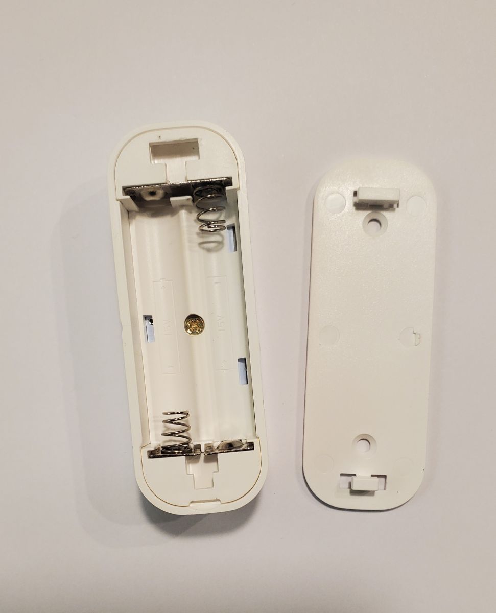

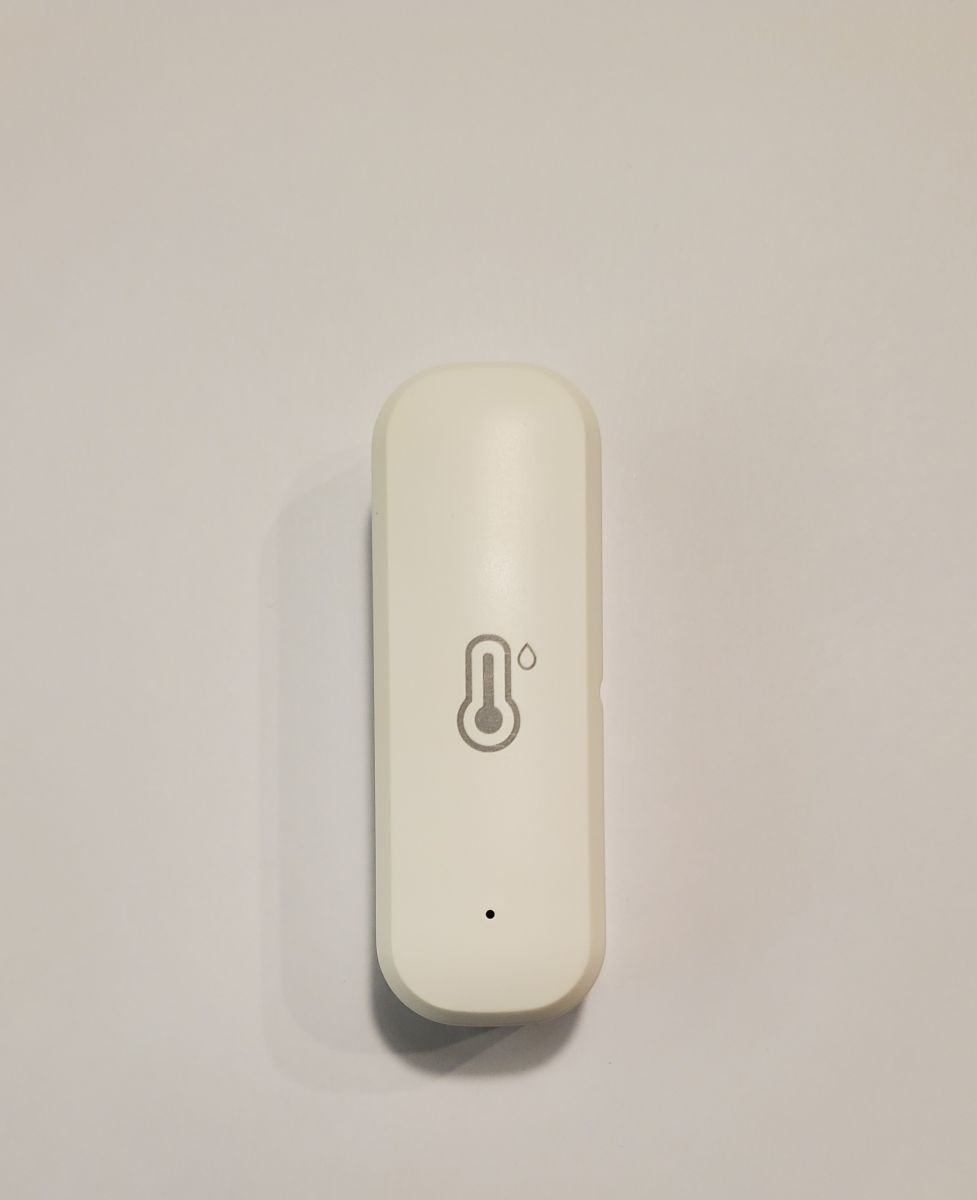

  • A generic AliExpress WiFi temperature and humidity sensor based on a BK7231N CBU module was torn down and identified.
  • The teardown includes device pinout notes and references for the BK7231N uC and Sensirion SHT30 sensor, with the specific part marked SHT30 DIAS7M.
  • The WiFi version arrived from de.aliexpress.com in about 2 weeks to Austria.
  • The latest BK7231N image could be flashed via console, but OpenBK7231T still lacks an SHT30 driver, tracked in GitHub issue 574.
  • Hi! Here is a teardown of a random super generic temperature and humdity sensor from aliexpress.
    Bought From:
    https://de.aliexpress.com/item/1005004854419532.html
    Wifi Version, really quick delivery to austia ~ 2 weeks

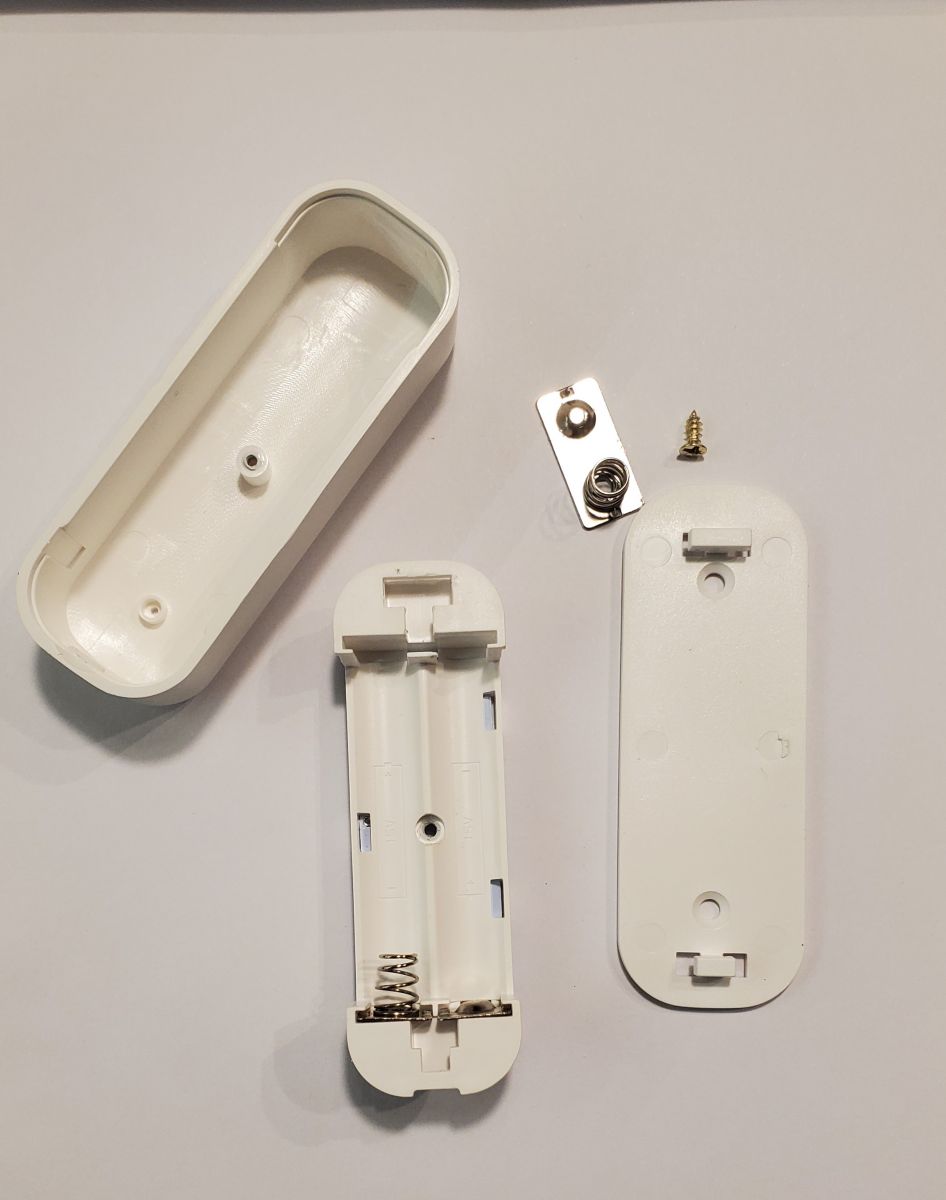

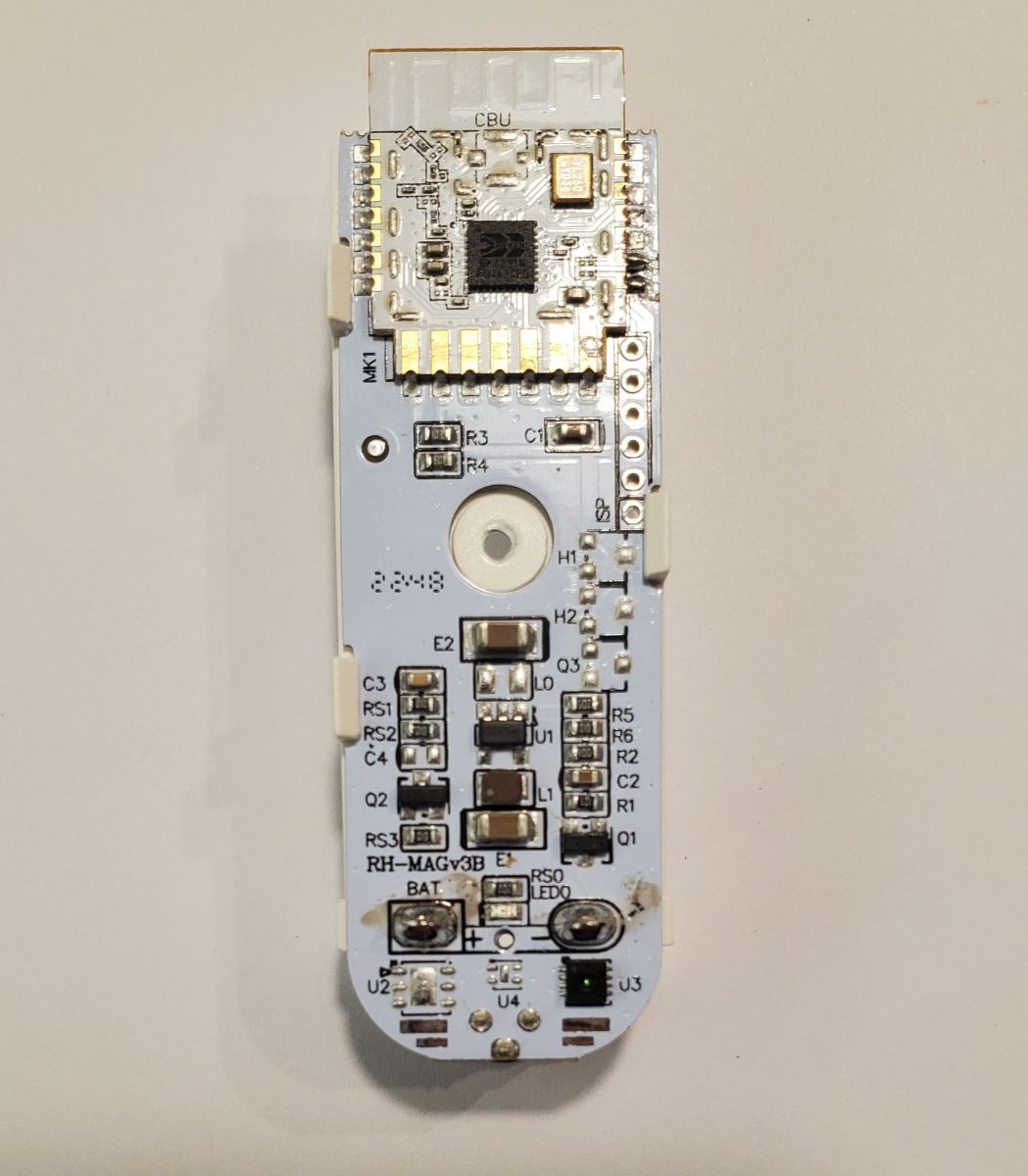

    Pictures:

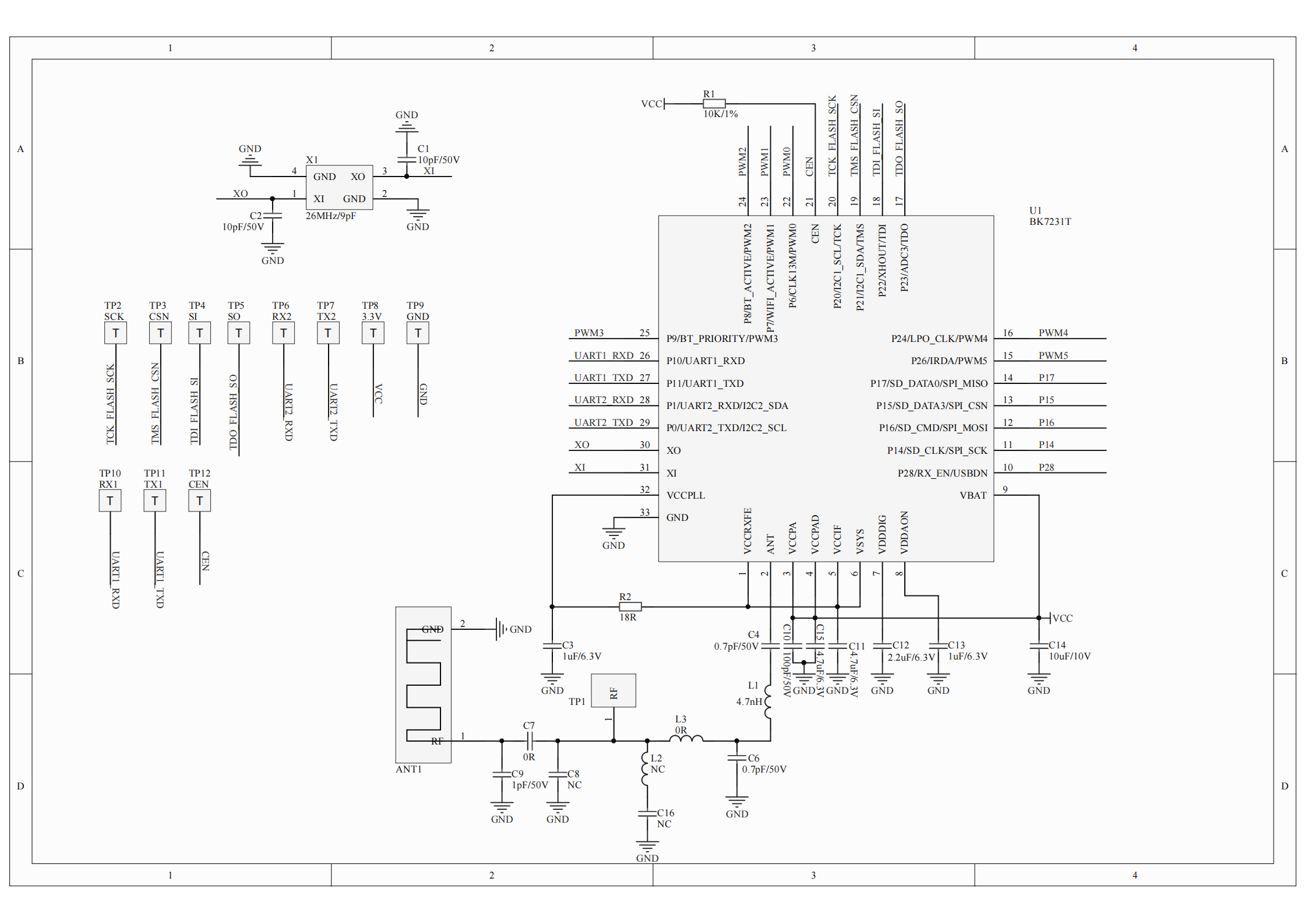

    [BK7231N CBU] Generic Temperature and Humidity Sensor [BK7231N CBU] Generic Temperature and Humidity Sensor [BK7231N CBU] Generic Temperature and Humidity Sensor [BK7231N CBU] Generic Temperature and Humidity Sensor [BK7231N CBU] Generic Temperature and Humidity Sensor [BK7231N CBU] Generic Temperature and Humidity Sensor

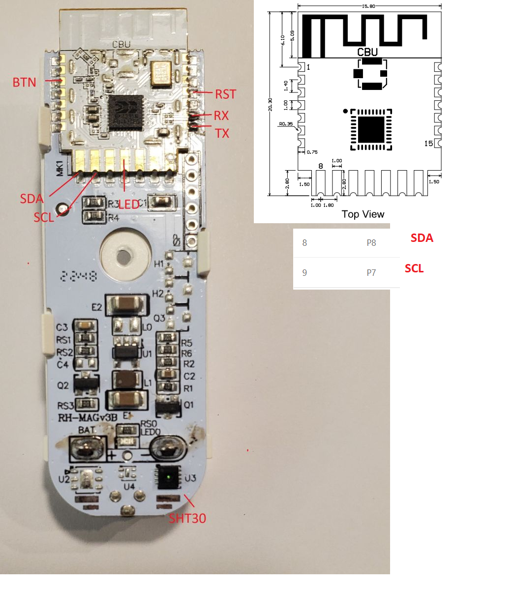

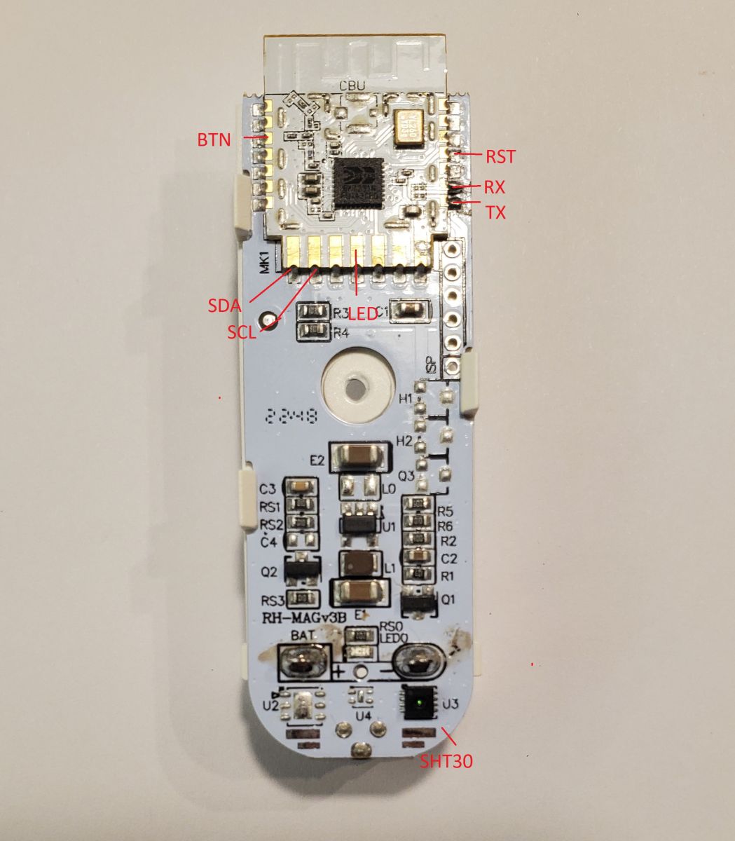

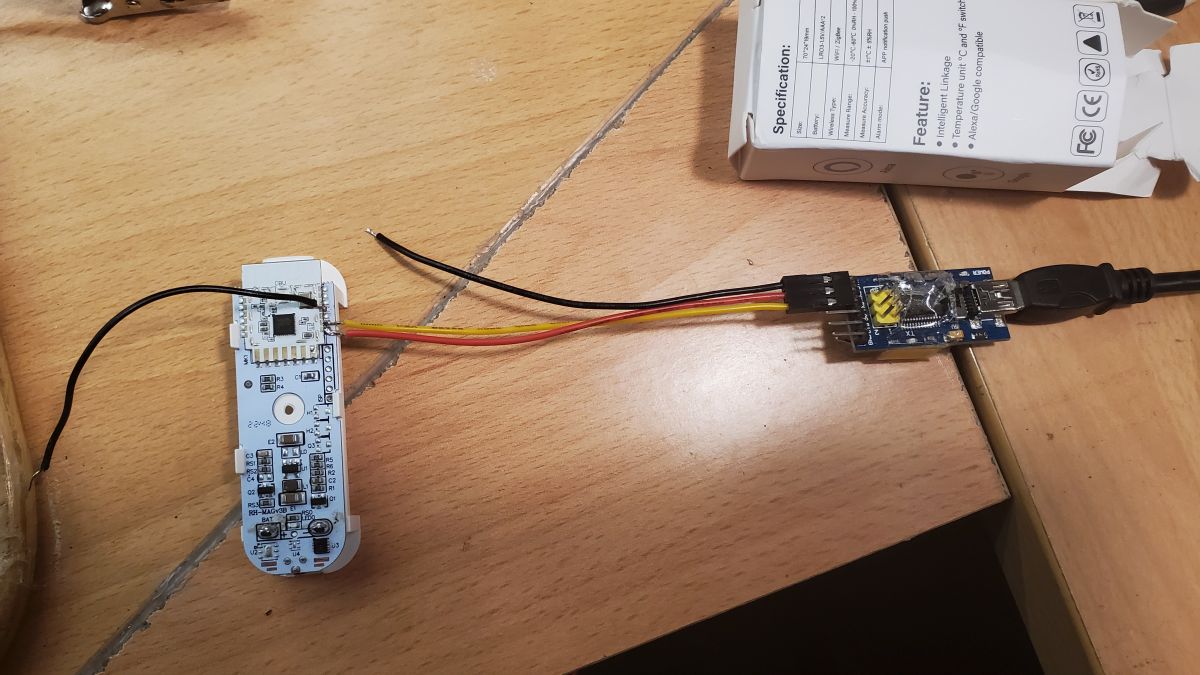

    Device Pinout:
    Datasheets:
    uC: https://developer.tuya.com/en/docs/iot/cbu-module-datasheet?id=Ka07pykl5dk4u
    SHT30: https://sensirion.com/media/documents/213E6A3B/63A5A569/Datasheet_SHT3x_DIS.pdf
    Specific Device ID: SHT30 DIAS7M

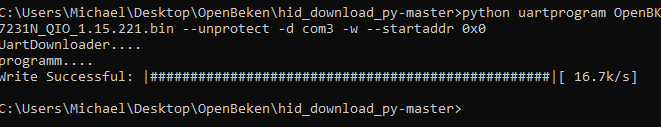

    Flashing:
    I could flash latest BK7231N Image via console.

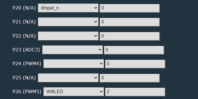

    Config:

    SHT30, however, seems very simple to support. I could do it remotely. For now, can you please tell me where is SHT30 connected? Which pins of CBU?
    I wonder if they are using a hardware I2C of Beken.
    EDIT: I see you marked SCL and SDA, great, wait a sec...
    Here:
    P8 and P7...

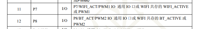

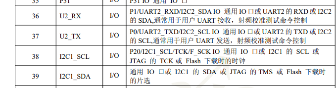

    Doesn't look like a hardware I2C:
    Here are I2C pins of BK7231:
    So we will need software I2C for your device.
    I could try to figure out something remotely, do a software I2C test with other device and then ask you for testing... I will think about it.

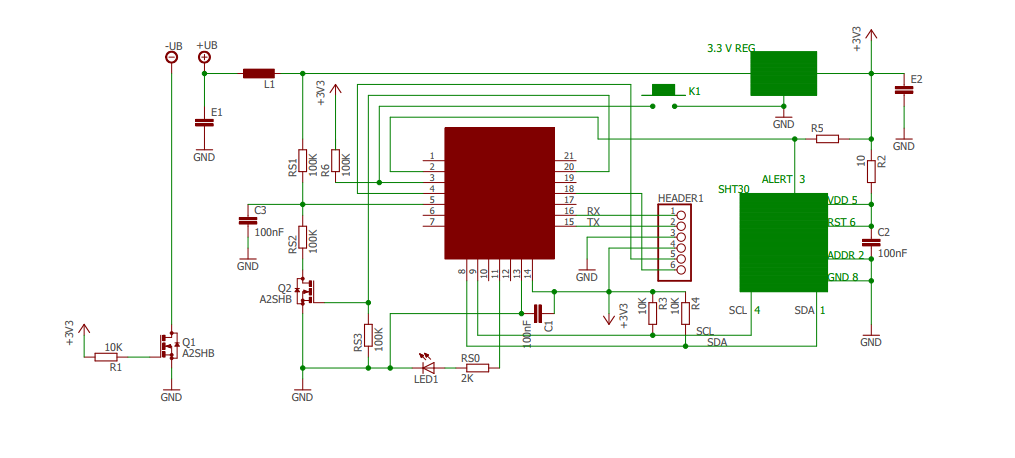

  • Asking for BK7231N datasheet and sleep strategy

    Please do that schematic, if you want. Our teardowns database needs exactly that kind of materials.

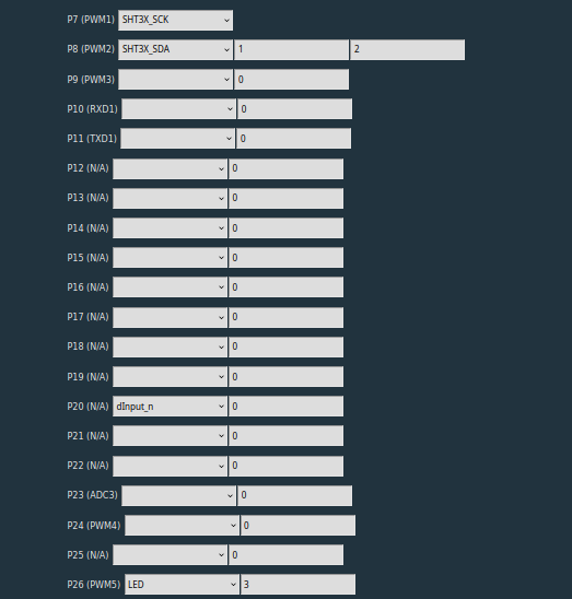

    i have publish a merge request to add the sht3X support. it works but measurement is not ideal even if i have taken the constructor reference for the sht3X. i support that the board has some heating dissipation that impact the sensor.
    So Temp is higher of 5 Celsius Degrees And Humidity lower from around 10 (you can easily correct that on HA)
    Feel free to test
    here the config apply at captor level :
    SCL on pin P7
    SDA on pin P8 with Channel 1 , 2
    Button on pin P20
    LED on pin P26 with Channel 3

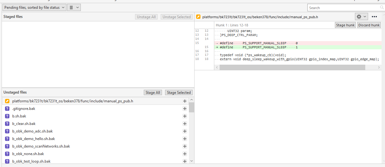

  • Manual deep sleep via BK7231 SDK APIs
    #17 20386012
    Posts: 14753
    Rate: 12875
    @btsimonh , any progress with deep sleep?
    There is an API for deep sleep in the Beken SDK but I am not sure if I should point you towards it, @dheenhasty . If you enable deep sleep, then you might end up unable to reset device for a long time because it is in so low power mode that power off/on cycles does not affect it due to the capacitors on the board. I remember also having issues with CEN, but I am not sure now.
    There is a deep sleep that can be waken up by IO press:
    void PINS_BeginDeepSleep() {
    #ifdef PLATFORM_BK7231T
    	bk_enter_deep_sleep(g_gpio_index_map, g_gpio_edge_map);
    #else
    #endif
    https://github.com/openshwprojects/OpenBK7231T_App/search?q=bk_enter_deep_sleep
    https://github.com/openshwprojects/OpenBK7231T/search?q=bk_enter_deep_sleep
    note that the IO press wakes up the device, but device reboots from 0, like a fresh boot.
    There was also somewhere a timer-based deep sleep but I am not sure if we have managed to get it working.
    Related files:
    https://github.com/openshwprojects/OpenBK7231...k7231t_os/beken378/func/include/wlan_ui_pub.h
    https://github.com/openshwprojects/OpenBK7231...1t/bk7231t_os/beken378/func/wlan_ui/wlan_ui.c
    The automatic power save is already in place, but the thing we need is a manual PS to make device sleep deep for 10 minutes and then boot from start and do a report. You might need to look into manual_ps.c:
    /** @brief  Request deep sleep,and wakeup by gpio.
    Added a command for testing that, but it doesn't work for me yet:
    https://github.com/openshwprojects/OpenBK7231...mmit/f5ec52f94f0512f4897f4de4b742e95a524505c7
    device does not wake up - any ideas why?

    Here is the only change needed to compile:
    If you are compiling for N, and for example SCTRL_LOW_PWR_CLK is undefined, do a Notepad++ search for SCTRL_LOW_PWR_CLK in all SDK files and try to include missing header.
    Please try to add missing headers and tell me how it goes. You could also do a pull request to our N platform SDK.

  • Battery voltage measurement via P17 and ADC
    #20 20387961
    nelliug54
    Posts: 7
    @dheenhasty Very good job
    Here is the shematic.
    I think a new massurement could be taken, that is battery voltage.
    Just putting P17 high, ADC meassuremet and P17 low.
    So Ubattery = 2*ADC_meassurement if we take RQ2on ~ 0
    I don't get the function of the Q1 n-mosfet , its connections have been checked several times...
    I hope no mistakes.
    Yesterday I was finally successfull to download OpenBK7231 to my device and to start and run it correctly.
    I had a problem caused by powering the circuit with the power supply of the serial converter. It was continuously rebooting. Finally powered with a battery everything working fine.
    Fantastic environment. I'm gratefully surprised
    Now I will try to configure as you mentioned ..

    @nelliug54 very good job! I didn't analyze it yet, but I know that MOSFET can be used a protection against reverse polarity connection.
