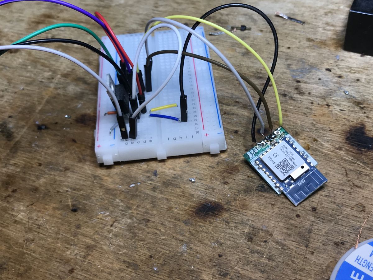

  • OpenBeken flashed successfully, and the controller paired with Home Assistant while LED commands and discovery worked automatically.
  • Programming is awkward because the WiFi module must be removed or desoldered, since TuyaMCU uses the same UART port as flashing.

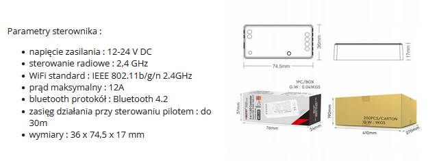

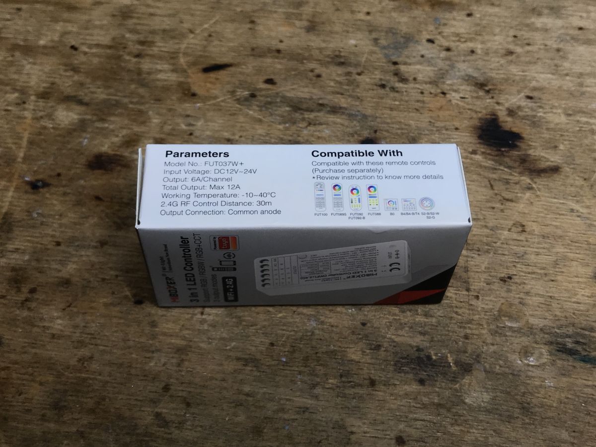

Let`s see the item description from the seller:
Description and photo of the Miboxer MiLight FUT037W+ controller with packaging.
Yes, you can control it via WiFi or remote controls. Now the specifications:
Technical details and packaging of the Miboxer FUT037W+ controller.
Information about Bluetooth from the description suggests that there will be no ESP8266 inside.
User manual for Miboxer FUT037W+ controller

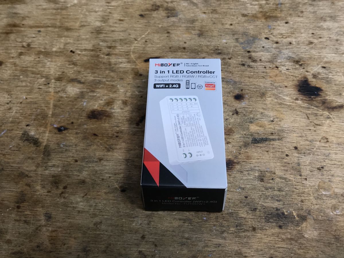

What do we get in practice?
LED controller Miboxer FUT037W+ packaging Miboxer FUT037W+ LED Controller Packaging Box of Miboxer FUT037W+ LED strip controller on a wooden table. Miboxer FUT037W+ LED controller box on a wooden surface
Set contents:

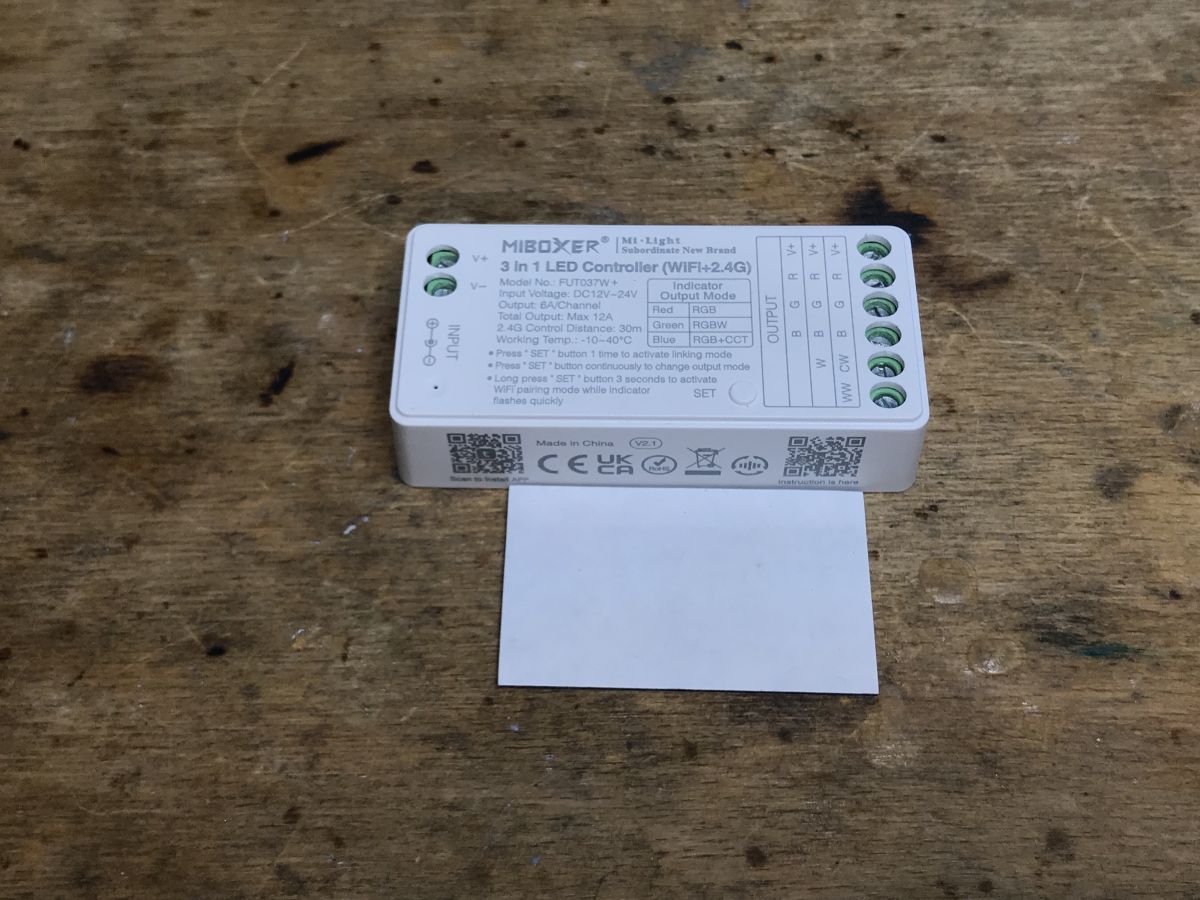

White casing of the Miboxer FUT037W+ LED controller on a wooden surface, featuring certifications and QR codes. Packaged LED controller Miboxer FUT037W+ on a wooden table Miboxer FUT037W+ LED Controller on a workbench

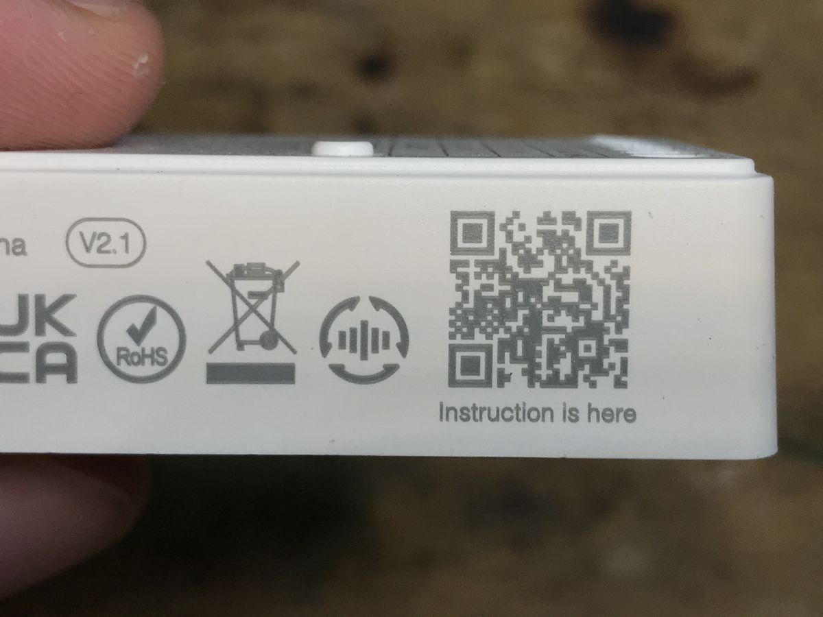

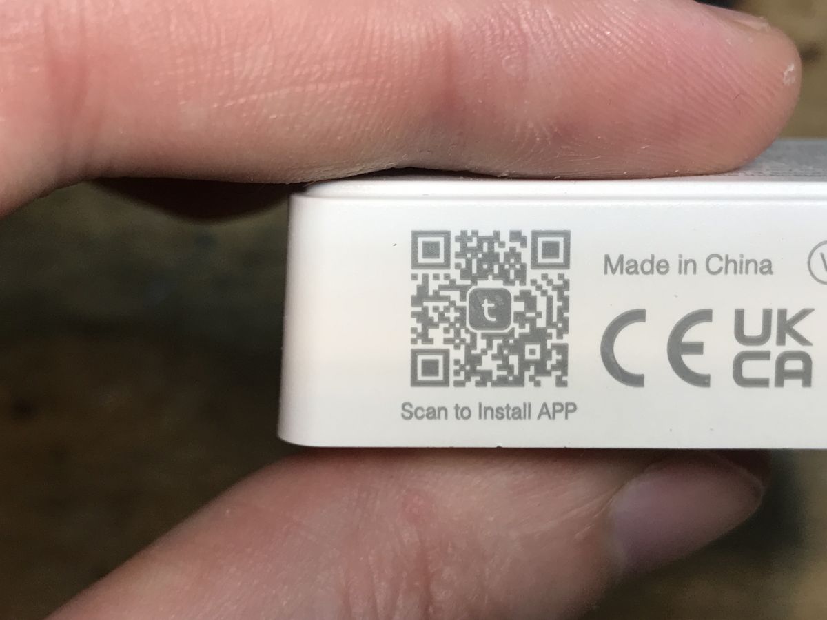

QR codes:
Close-up of a QR code on the Miboxer FUT037W+ device. Sticker with QR code and markings on LED controller

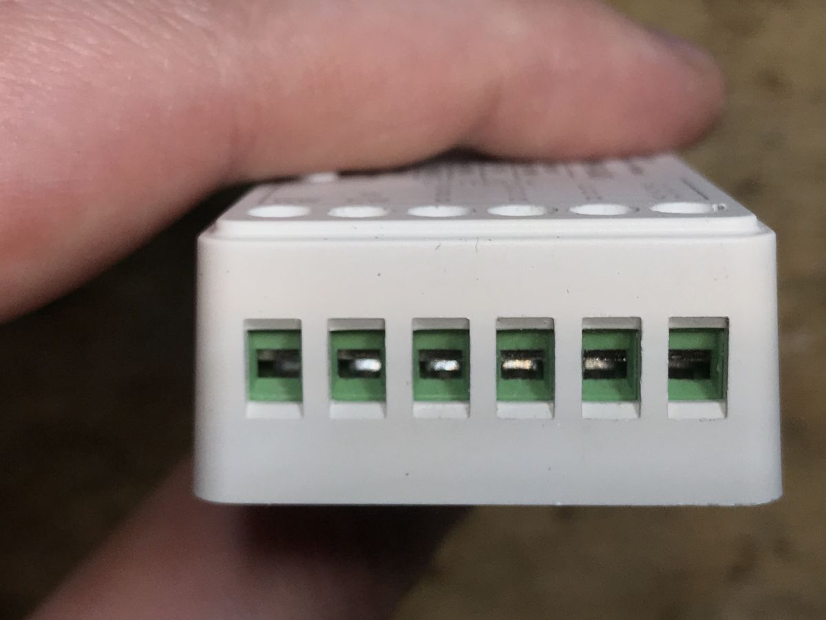

This controller has a separate DC jack input and a separate input for cables - smart and convenient.
Power and wire inputs on the Miboxer FUT037W+ LED controller.
And here are the outputs for the LED strip:
Close-up of electrical terminal connectors of Miboxer FUT037W+ LED controller

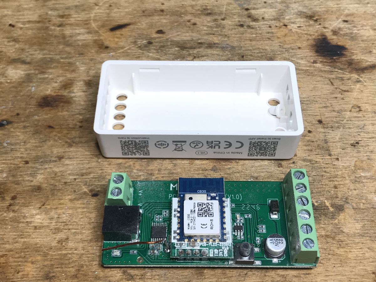

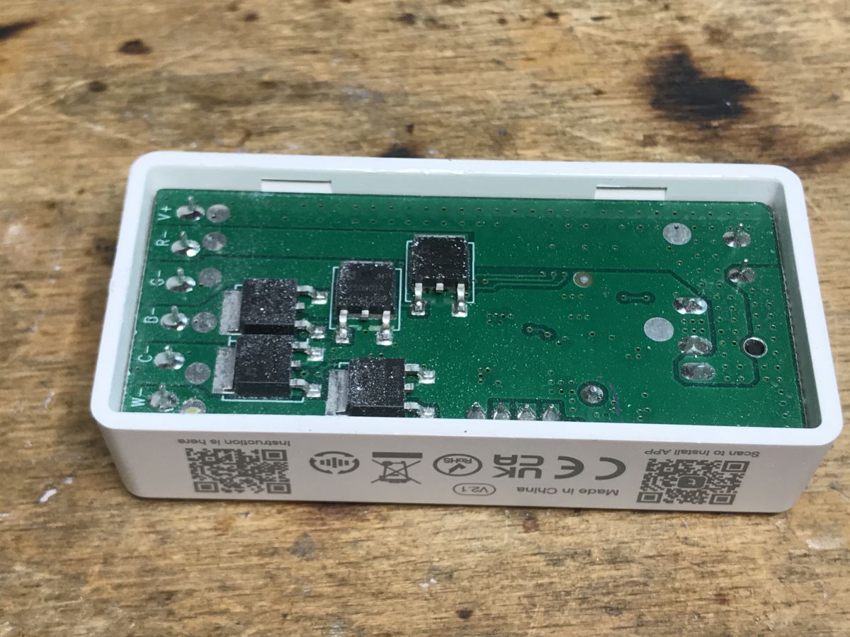

Interior of Miboxer FUT037W+
Just lift the cover, there are no screws:
Interior of the Miboxer FUT037W+ LED strip controller

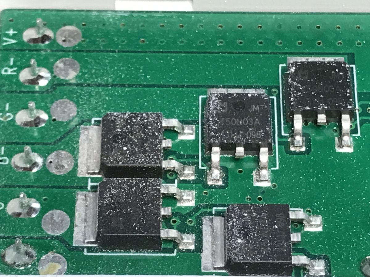

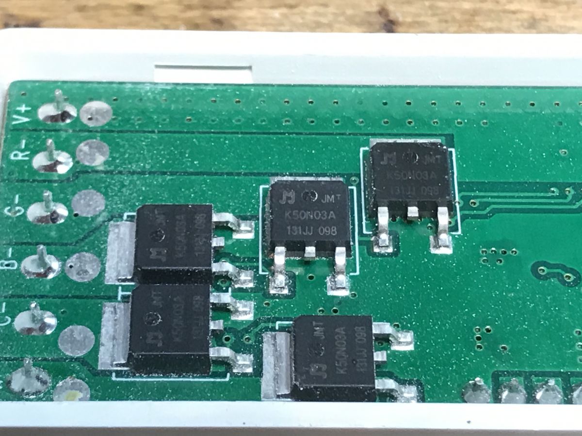

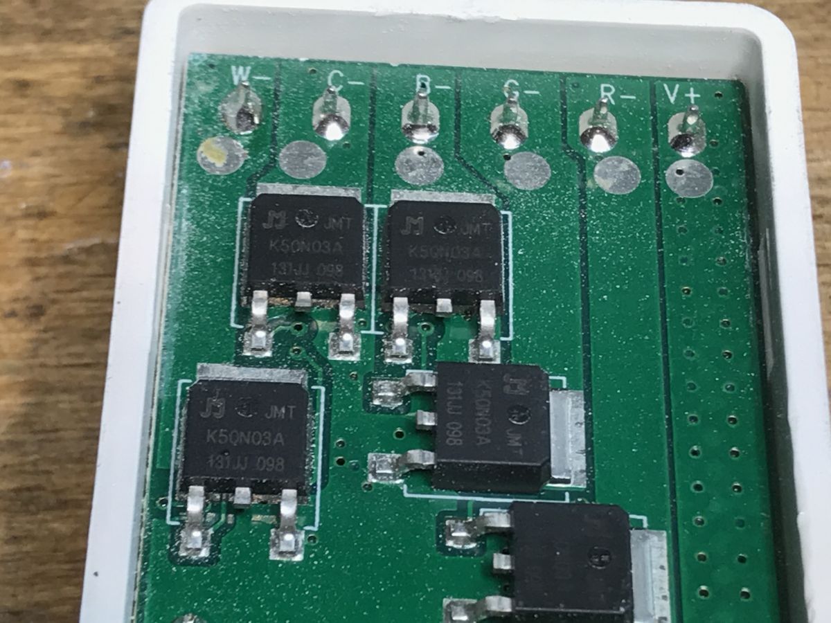

You can immediately see that the MOSFET transistors are more powerful than usual, but why are they so dusty?
Close-up of a circuit board with MOSFET transistors in the Miboxer FUT037W+ controller
Slightly better:
Close-up of MOSFET transistors on a printed circuit board.
Electronic circuit board of the Miboxer FUT037W+ LED controller

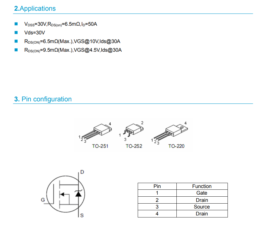

K50N03A, really good parameters:
Diagram showing specifications and pin configuration of a MOSFET transistor.

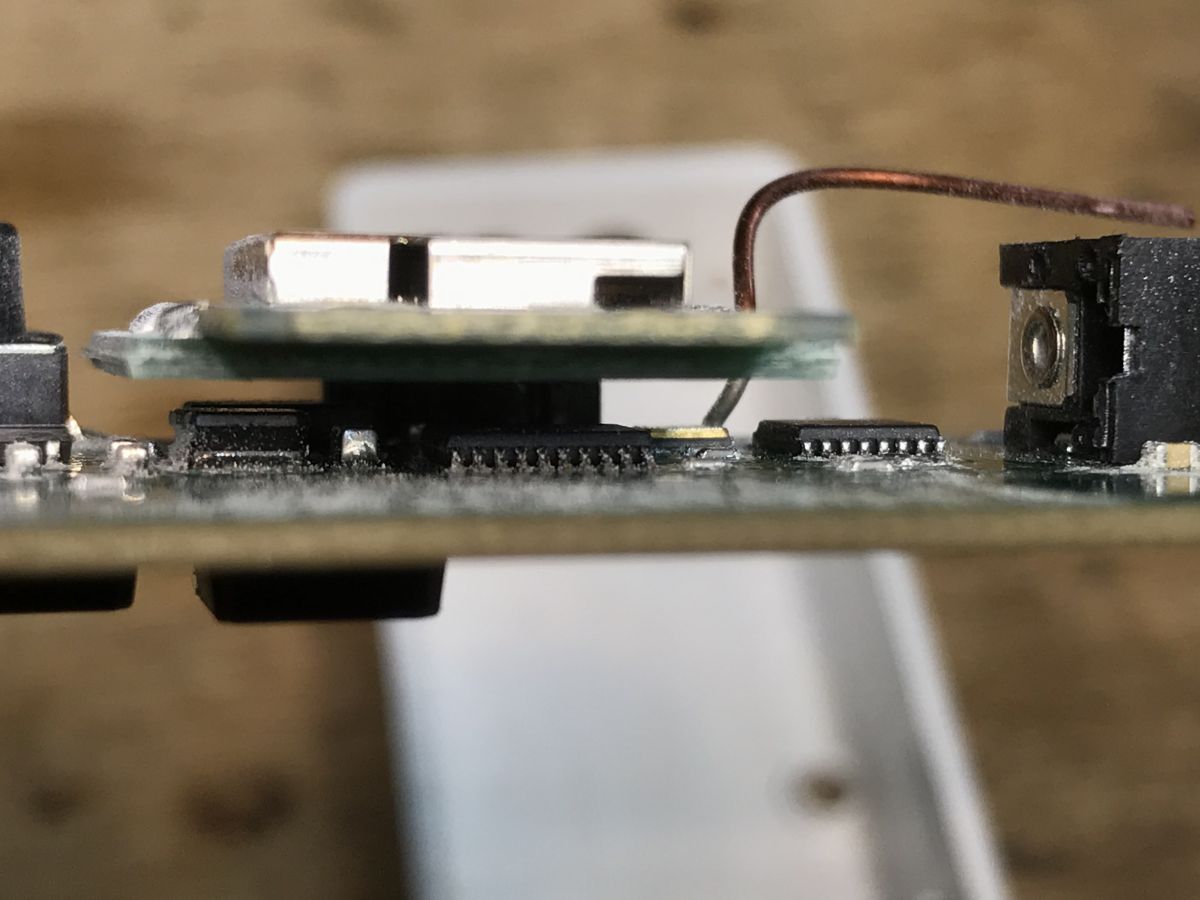

We can now remove the PCB and look at the rest of the electronics:
Interior of Miboxer FUT037W+ LED controller Interior of Miboxer FUT037W+ LED controller with CB3S WiFi module

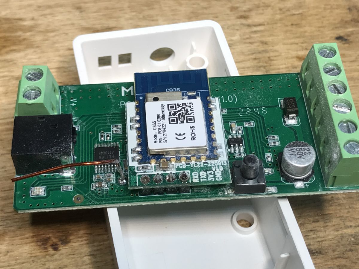

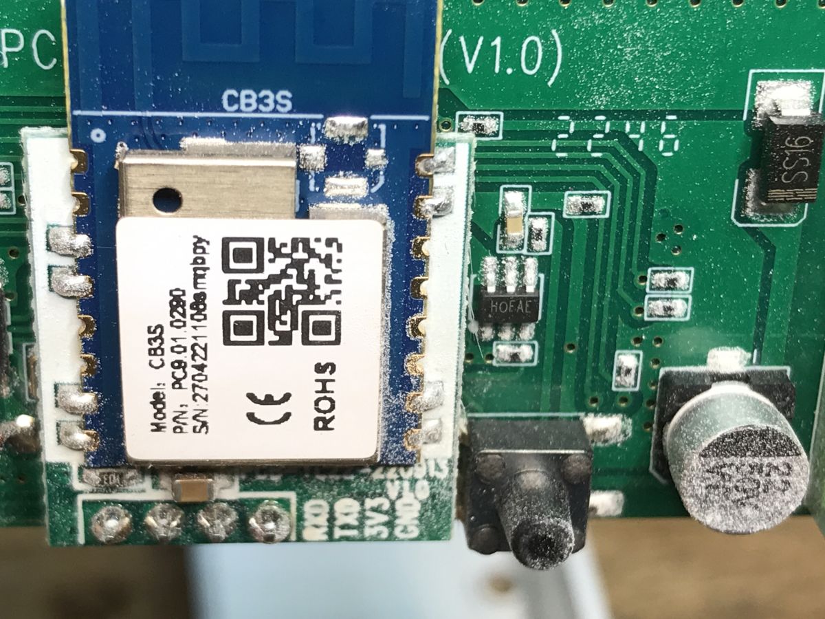

The WiFi module is WB3S, but it is on a separate board and connects to the base only with four goldpins. Here we have 3.3V, ground and TX and RX.
This is a typical example of a device based on TuyaMCU. Details in this topic:
class="notranslate"> TuyaMCU protocol - communication between the microcontroller and the WiFi module

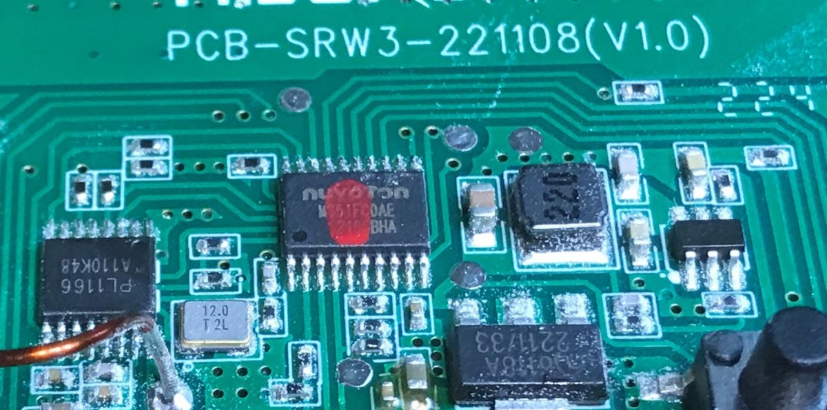

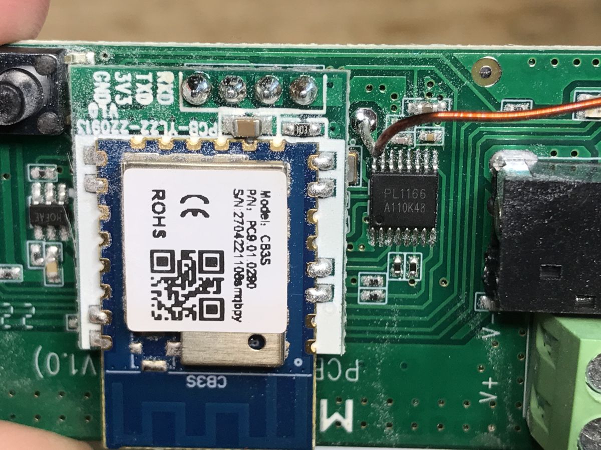

Here I see the step down controller, it probably generates 3.3V from 12V from the belt:
CB3S WiFi module on the PCB of Miboxer FUT037W+ LED controller
And here we have the PL1166 A110K48 RF system (the MCU is under the WiFi module):
Close-up of the Miboxer FUT037W+ controller's circuit board with visible electronic components.
Close-up of electronic modules in the Miboxer FUT037W+ LED controller.

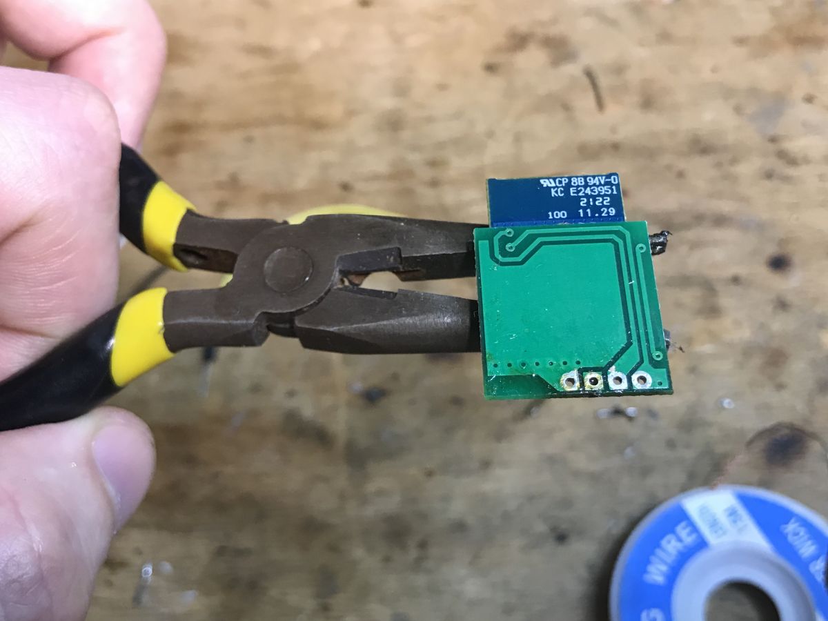

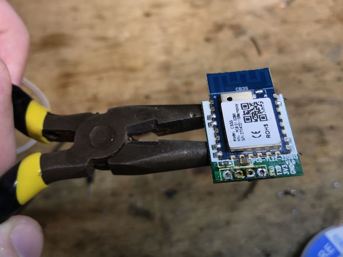

I desoldered the board with the WiFi module to see what the MCU is there:
WiFi module CB3S held by pliers WiFi module on a circuit board with a holder.

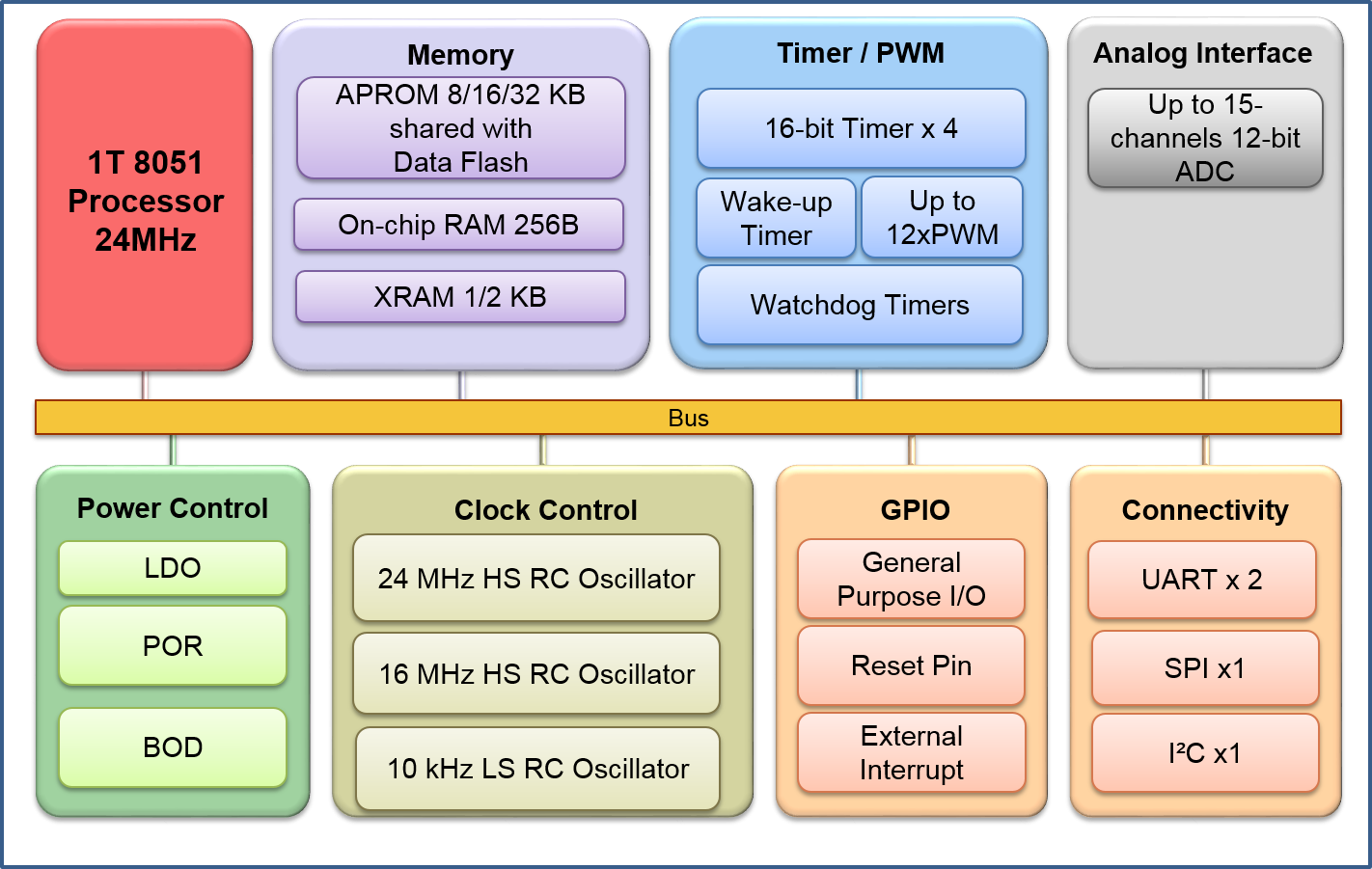

This is Nuvoton MS51FC0AE:
Close-up of a circuit board with a Nuvoton chip and other electronic components.
Close-up of the Miboxer FUT037W+ circuit board with visible electronic components.
Block diagram of a 24MHz 8051 microcontroller
This MCU supports the RF system and transistors, and communicates with the WiFi module via UART.

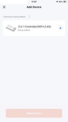

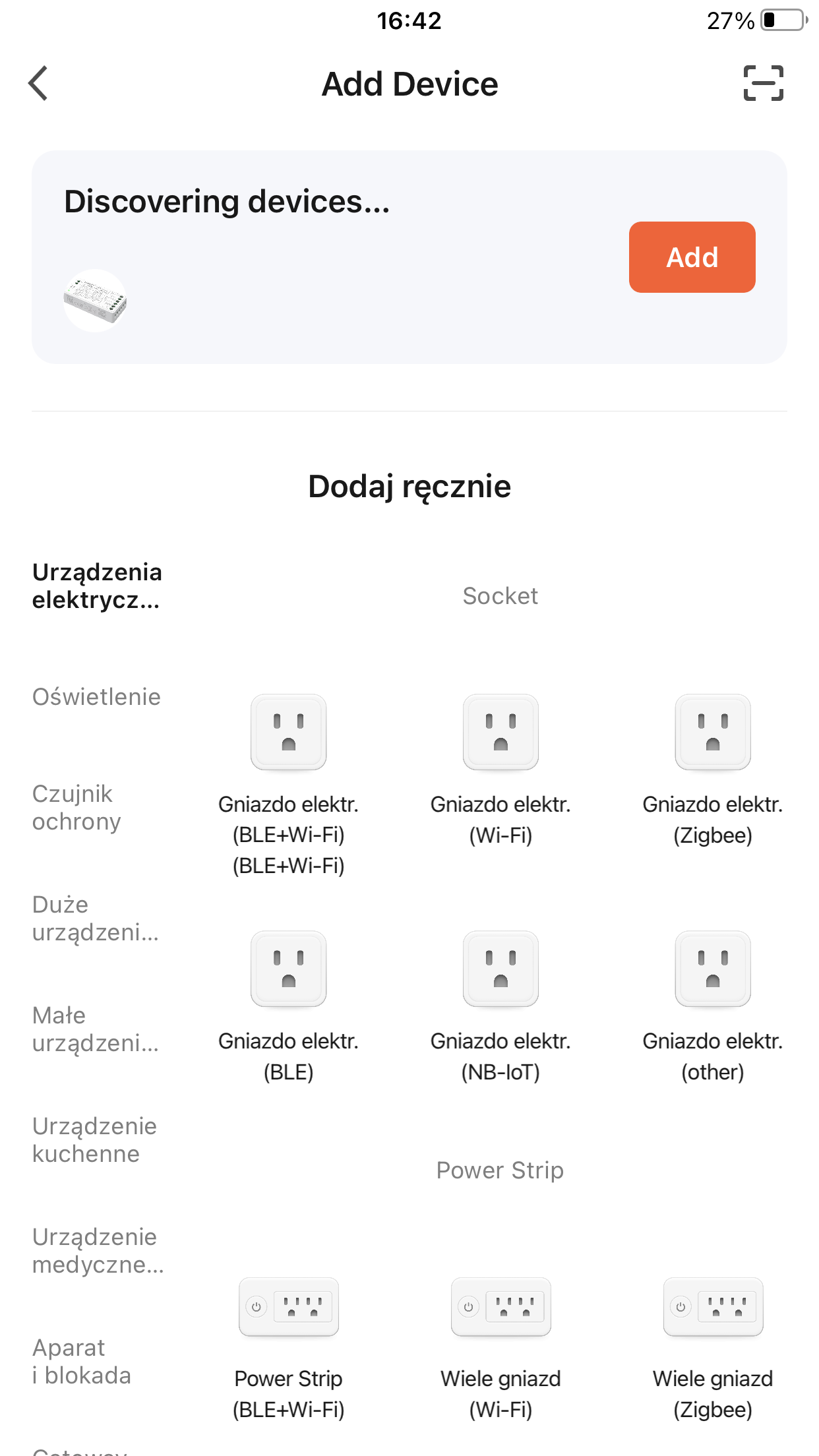

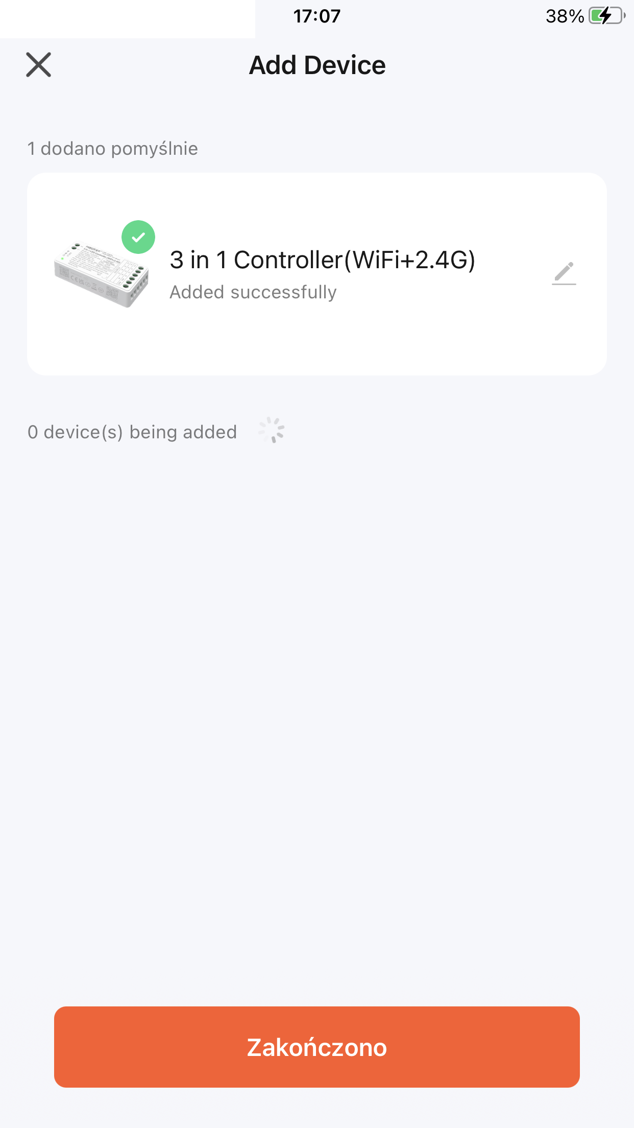

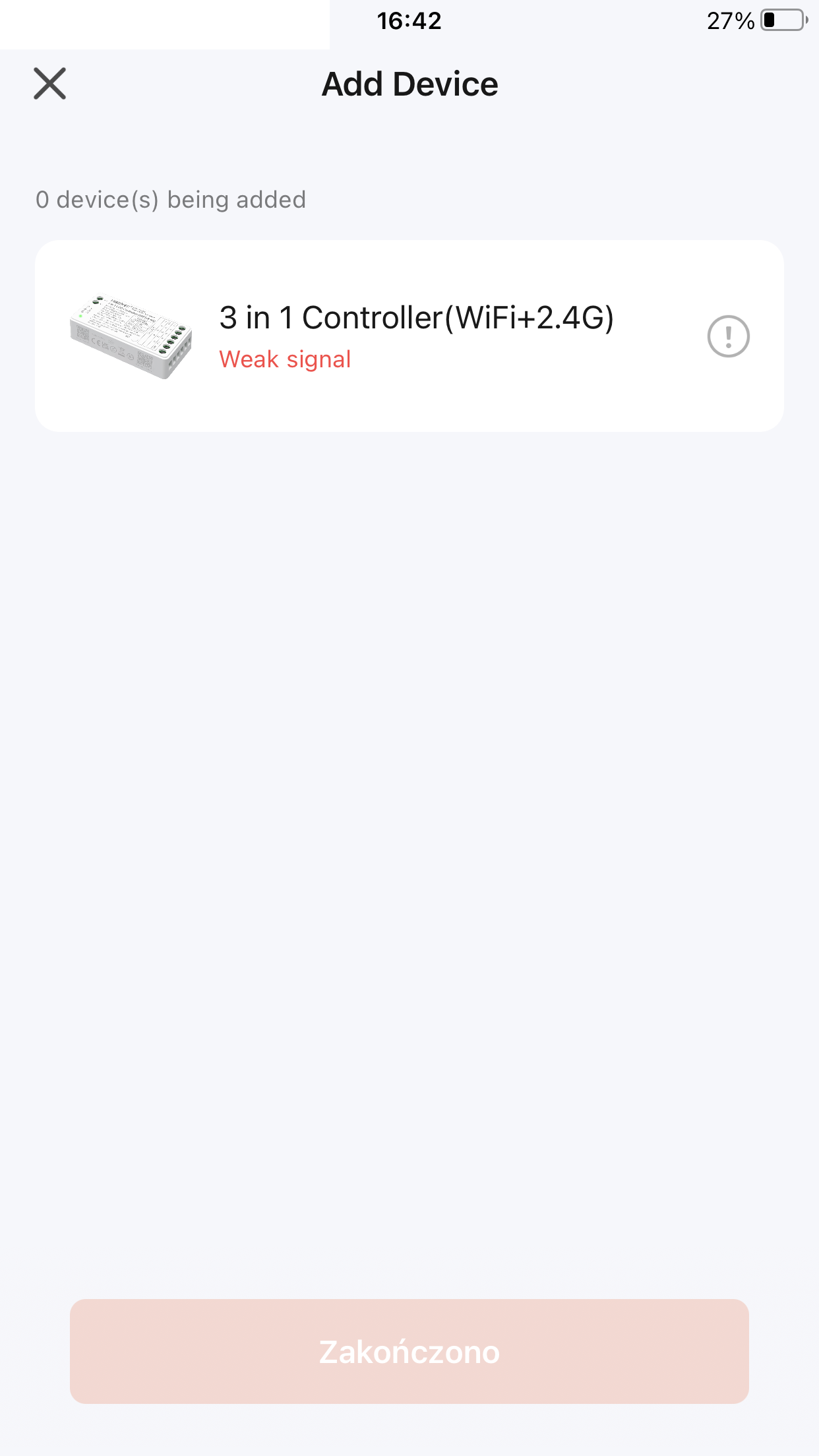

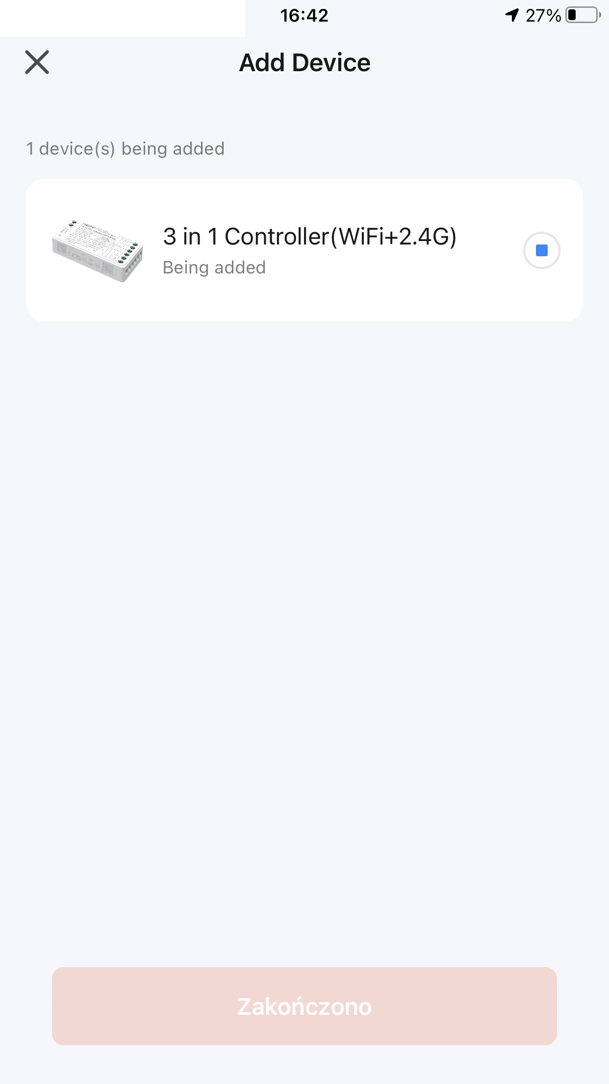

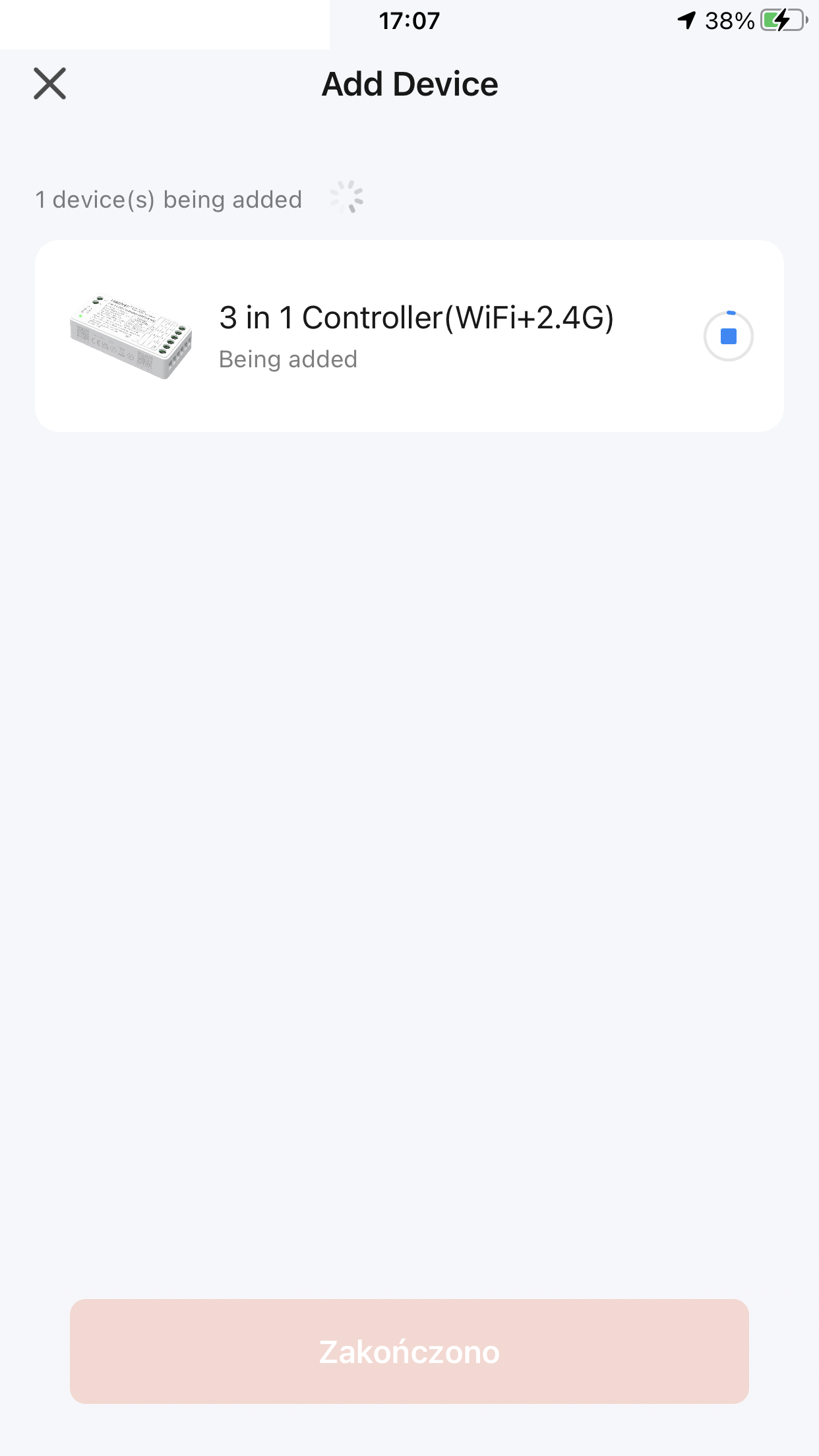

So, the Tuya app recognizes the device from a distance:
App interface for adding a new device.
Despite one failure ("weak signal"), pairing is successful:
App screen showing the addition of a 3 in 1 (WiFi+2.4G) device App screen for adding a device with Miboxer LED controller showing weak signal App screen showing Tuya device being added. App screen showing successful addition of 3 in 1 Controller (WiFi+2.4G) device.

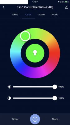

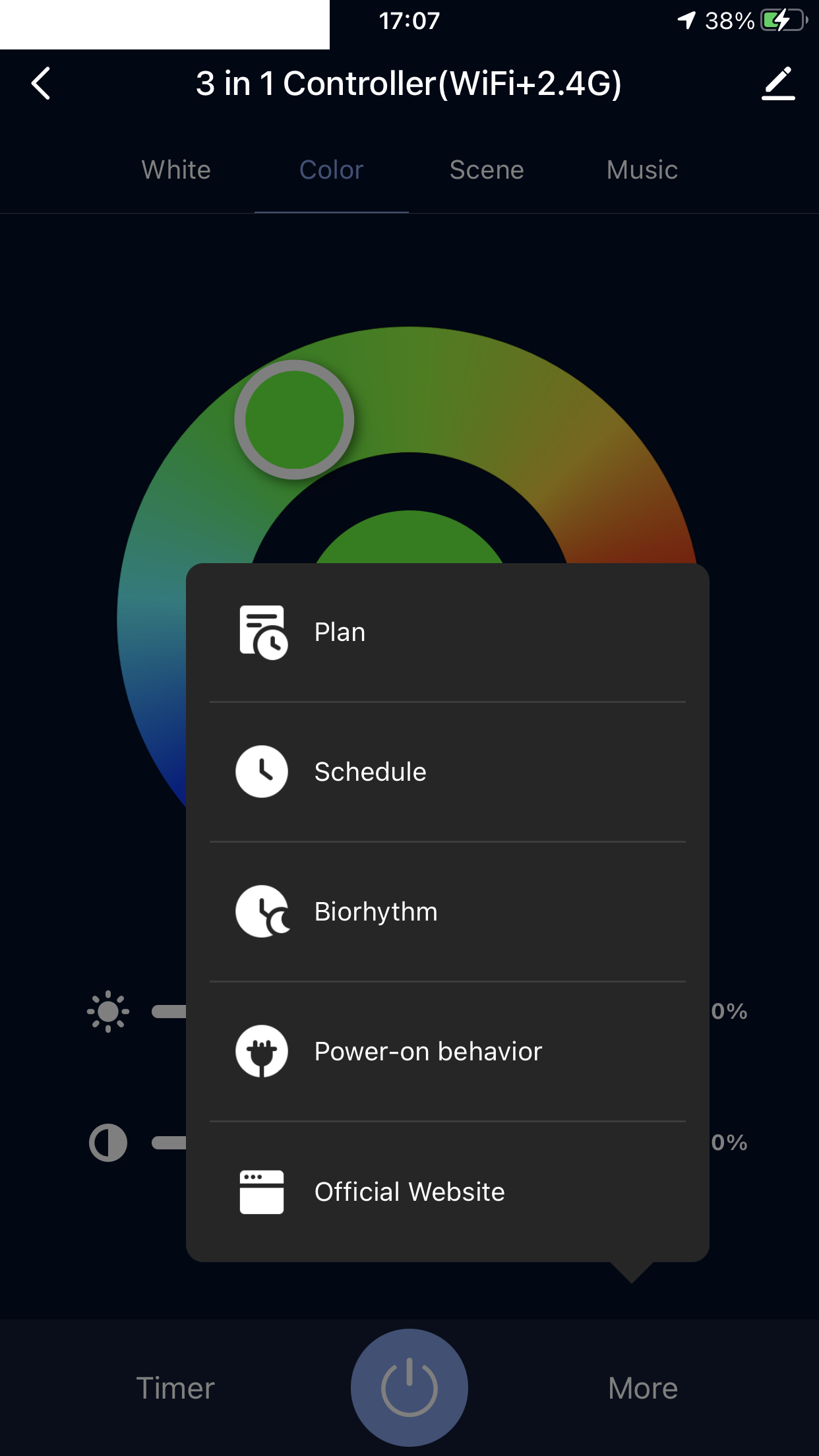

Inside we have a typical RGBCW controller:
Mobile application interface of MiBoxer showing LED control with color wheel and brightness sliders.
Of course, there are options here such as the initial state, calendar, etc., but I have discussed this before, so I will skip it.
Interface of Miboxer FUT037W+ LED controller app

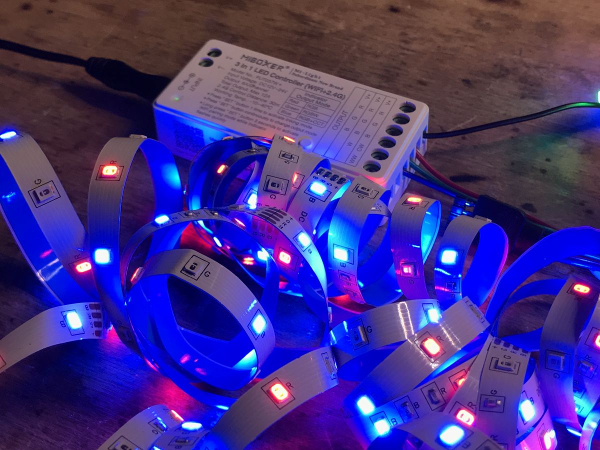

Everything works:
Miboxer FUT037W+ LED controller with connected light strips displaying various colors.

Power On->Initial mode option:
55 AA 00 06 00 10 21 00 00 0C 00 00 00 00 00 00 00 00 03 E8 00 00 2D 55
55 AA	00	06		00 10	2100000C000000000000000003E80000	2D
HEADER	VER=00	SetDP		LEN	dpId=33 Raw V=00 00 00 00 00 00 00 00 03 E8 00 00		CHK
Power On->Restory Memory option:
55 AA 00 00 00 00 FF 55 AA 00 06 00 10 21 00 00 0C 00 01 00 00 00 00 00
00 03 E8 00 00 2E 55 AA 00 00 00 00 FF
HEADER	VER=00	Heartbeat		LEN		CHK
55 AA	00	06		00 10	2100000C000100000000000003E80000	2E
HEADER	VER=00	SetDP		LEN	dpId=33 Raw V=00 01 00 00 00 00 00 00 03 E8 00 00		CHK

Uploading OBK
We upload with my flasher:
Unfortunately, you have to remove (or desolder - depending on the PCB version) the WiFi module outside the system, because TuyaMCU uses the same UART port as programming.
Wireless module Miboxer FUT037W+ connected to a breadboard
later we need to create autoexec.bat : :
// start driver
startDriver TuyaMCU
// always send wifi state 0x04 to MCU - paired and connected to cloud
tuyaMcu_defWiFiState 4
// set baud rate (if your device is using 9600, remove this line)
tuyaMcu_setBaudRate 115200
// setup Tuya LED color dpID 24 and Color format 1
// (the other dpIDs are taken from default settings)
tuyaMCU_setupLED 24 1
The code is really very short, but the remaining dpIDs are set to default values. OBK does not send dpID 28 at the moment, but tests have shown that sending dpID 22 is sufficient.
The above code will connect the LED controller with OBK to the MCU from this device, so all LED commands as well as Home Assistant Discovery will work automatically.

I flashed this bar again. This time for someone else. Packaging and product: https://obrazki.elektroda.pl/6787749600_1709577063_thumb.jpg https://obrazki.elektroda.pl/7863337400_1709577035_thumb.jpg... [Read more]
priva7eer 24 Dec 2024 00:53
I converted the FUT037W+ today according to these instructions. Specifically, I soldered the module board - that is, those 4 pins, without surface soldering or hot air, and used those pins for programming.... [Read more]
p.kaczmarek2 24 Dec 2024 05:47
So in your copy the baud was the default 9600 and not 115200? It's interesting and strange that different copies of the same product (different versions?) use different baud. It's good to know that this... [Read more]

trynio132 21 Mar 2025 00:25
Hi, I have uploaded the Tasmot software to myself on the ESP-12S board. (Interestingly on the ESP-12F boards after soldering it doesn't work because I have some weird voltage on the GPIO0 pin) I soldered... [Read more]
p.kaczmarek2 22 Mar 2025 09:38
What is the current configuration of the Tasmota that you used? [Read more]
trynio132 23 Mar 2025 14:42
After uploading the tasmota, I used a template like this { "NAME": "name", "GPIO":[0,2272,0,2304,0,0,0,0,0,0,0,0,0,0,0,0], "FLAG":0, "BASE":54, "CMND": "DimmerRange 0,1000 | TuyaMCU 21,23 | | TuyaMCU... [Read more]

Key insight: The controller itself is not a simple Wi‑Fi PWM board. The Wi‑Fi module is only a UART front end; the external MCU handles LEDs and RF, so firmware success depends more on TuyaMCU mapping and baud rate than on flashing alone.
  • The unit discussed cost about PLN 90 and exposes separate DC jack input and wire input, which the author called a convenient layout for LED-strip installs. [#20926307]
  • Internally, the Wi‑Fi module gets 3.3 V, while the board appears to derive that from the strip’s 12 V supply through a step-down stage. [#20926307]
  • The decoded Tuya schema shows key ranges: dpID 22 brightness = 10–1000, dpID 23 white temperature = 0–1000, and dpID 26 timer = 0–86400 s. [#20926307]
  • One confirmed OpenBeken setup needed tuyaMcu_setBaudRate 115200, but another confirmed FUT037W+ copy only worked after removing that line because its TuyaMCU ran at 9600 baud. [#21360725]
  • The board uses stronger-than-usual MOSFETs marked K50N03A, which is why the author recommended it for somewhat larger LED installations. [#20926307]

How do I flash OpenBeken onto a Miboxer FUT037W+ with a CB3S/WB3S BK7231N module and TuyaMCU architecture?
Flash the Wi‑Fi module separately, then restore TuyaMCU settings in OpenBeken. 1. Remove or desolder the CB3S/WB3S module and flash it with BK7231GUIFlashTool. 2. Reinstall the module and create autoexec.bat with startDriver TuyaMCU, tuyaMcu_defWiFiState 4, the correct baud, and tuyaMCU_setupLED 24 1. 3. Reboot and verify that sliders, heartbeats, and LED control work. The author states this setup also enables automatic Home Assistant Discovery. [#20926307]
Why do I need to remove or desolder the CB3S/WB3S module before flashing the FUT037W+ with BK7231GUIFlashTool?
You need to remove it because TuyaMCU shares the same UART used for programming. The thread states that the module must be removed or desoldered, depending on PCB version, since the external MCU is still connected to TX/RX during flashing. One later report confirms successful work by soldering only the 4-pin module board and programming through those pins, without full hot-air removal of the whole carrier. [#21360725]

Which MCU and RF chips are inside the Miboxer FUT037W+, and what roles do the Nuvoton MS51FC0AE, PL1166, and CB3S/WB3S modules play?
The FUT037W+ contains a Nuvoton MS51FC0AE MCU, a PL1166 A110K48 RF system, and a CB3S/WB3S BK7231N Wi‑Fi module. The Nuvoton MCU drives the transistors and handles the TuyaMCU side. The PL1166 covers RF remote-control functions. The CB3S/WB3S board provides Wi‑Fi connectivity and talks to the main MCU through UART over four pins. This two-MCU layout is the reason the device supports both Wi‑Fi and RF control. [#20926307]
