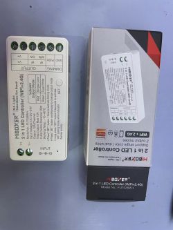

    Hi guys.
    The main and the only question is in the title.
    I ordered FUT036W from eBay. It is from a China seller. However, the seller sent me a message that he currently has no FUT036W in stock and that he can send me a "similar one," and asked if it is OK. I told him that I cannot say neither OK nor not OK if I don't know which model is the "similar one," especially because I don't want to use it with Tuya cloud. I told him that I need something that can be flashed either with OpenBeken or Tasmota/ESPHome, so I asked him to provide me a model, then I can tell if it is OK. This morning, he sent me a photo of the similar one. It is FUT035W+, but as you can imagine with Chinese sellers, shortly after that I received an email from eBay that my package is on the way (without my confirmation that FUT035W+ is OK for me). Yes, I know I can complain to eBay and most probably they will return my money, but I would rather keep this FUT035W+ if someone knows and can confirm that it has a Beken chipset and it could be flashed with OpenBeken, also successfully configured.
    Many thanks in advance.

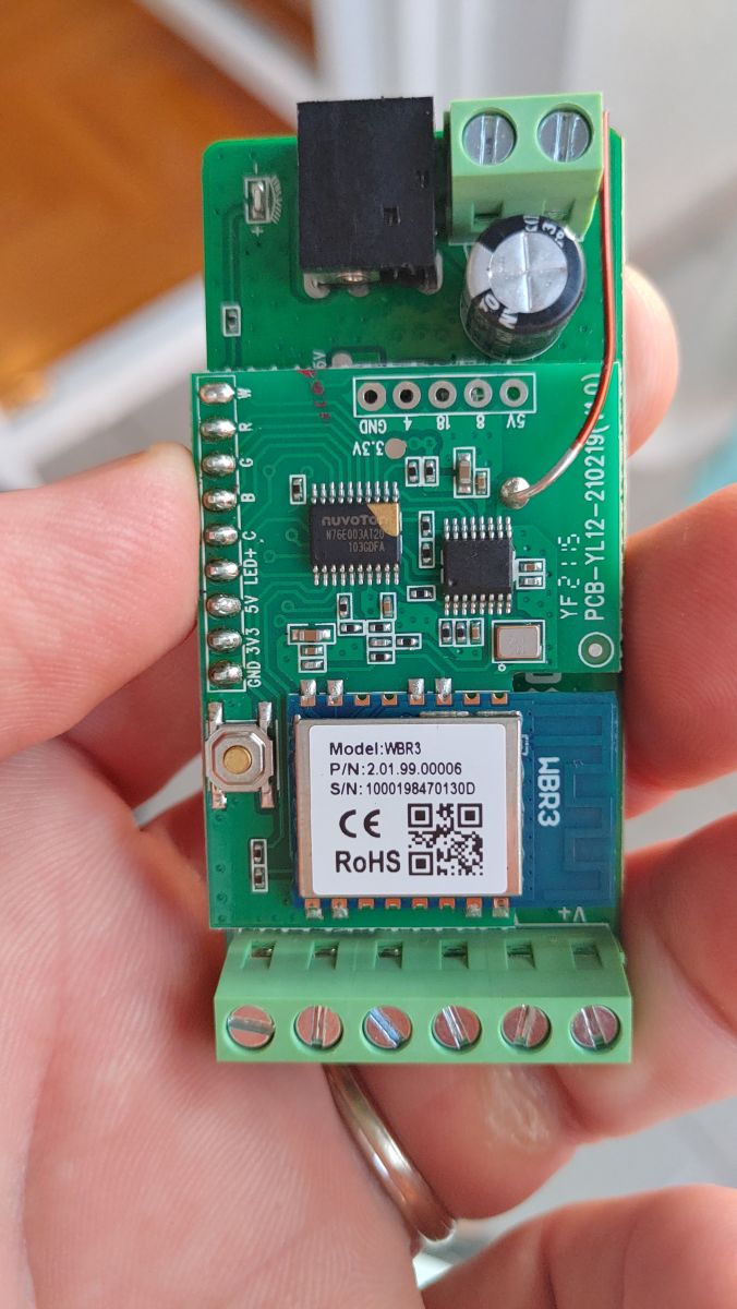

    #6 20635797
    stiw47
    Posts: 7
    This was one veeeery long shipment and it seems bad luck at the end.
    First to make clear, at the end seller sent me FUT036W as I initially ordered, not FUT035W as he said he will sent, confusing 😁. Anyway, after almost 2 months, FUT036W finally arrived today.
    [Q]Does MiBoxer FUT035W+ has Beken chipset and is it supported with OpenBeken?
    As far as I understand, this is not Beken chip at all.
    If I check in another thread also with FUT036W, on @mplum photos there is a chip which is declared as "Model: CB3S". Next, if I google-fu for CB3S, I can find the info on Tuya site that it is based on BK7231N.
    As you can see on my photo above, on my chip it is written "Model WBR3", and Tuya site says it is some W701-VA2-CG 😥
    I have no idea could this be flashed with OpenBeken and should I try at all.
    At the end, I am very sad cause I didn't ordered FUT036Z (ZigBee) instead of FUT036W 😁
  • #7 20635808
    Posts: 14765
    Rate: 12899
    Not yet, but we're working on that. Please stay tuned and watch for updates. The chip you got is very rare, we don't get that one often.

Why can’t I get direct PWM control after flashing?
MiBoxer routes LED control through a secondary MCU (TuyaMCU) over UART. The BK7231’s PWM pins do not drive LEDs directly. [Elektroda, p.kaczmarek2, post #20571991]
Can I bypass TuyaMCU and wire PWM directly for full local control?
Yes, by desoldering the TuyaMCU and wiring BK7231 PWM pins to LED driver inputs. This needs careful soldering and tracing. [Elektroda, p.kaczmarek2, post #20571991]
How can I discover my device’s dpIDs before configuring?
Keep stock Tuya firmware, sniff UART, or use OpenBeken’s tuyaMcu_sendQueryState to enumerate dpIDs. Tasmota supports TuyaMCU colors too. [Elektroda, p.kaczmarek2, post #20636169]
What if my unit keeps dropping Wi‑Fi due to MCU heartbeat?
Force a stable state toward the MCU. Use tuyaMcu_defWiFiState 4 to present as paired/connected for continuous operation. [Elektroda, p.kaczmarek2, post #20732612]
I only need 12V single‑color at around 10A. What’s the easier path?
Pick a PWM‑based BK7231 LED controller without TuyaMCU from the OpenBeken devices list. They are easy to flash and configure. [Elektroda, p.kaczmarek2, post #20572457]
Can I control MiBoxer without flashing using a hub?
Yes. Build an ESP8266 MiLight hub (with NRF24L01), integrate via MQTT in Home Assistant, and pair the FUT unit. [Elektroda, stiw47, post #20637109]
Does OpenBeken now handle RGB/RGBCW color on these controllers?
Yes, recent updates added a TuyaMCU LED driver. Use tuyaMCU_setupLED 24 1 and defWiFiState 4 for color control. [Elektroda, p.kaczmarek2, post #20877683]
