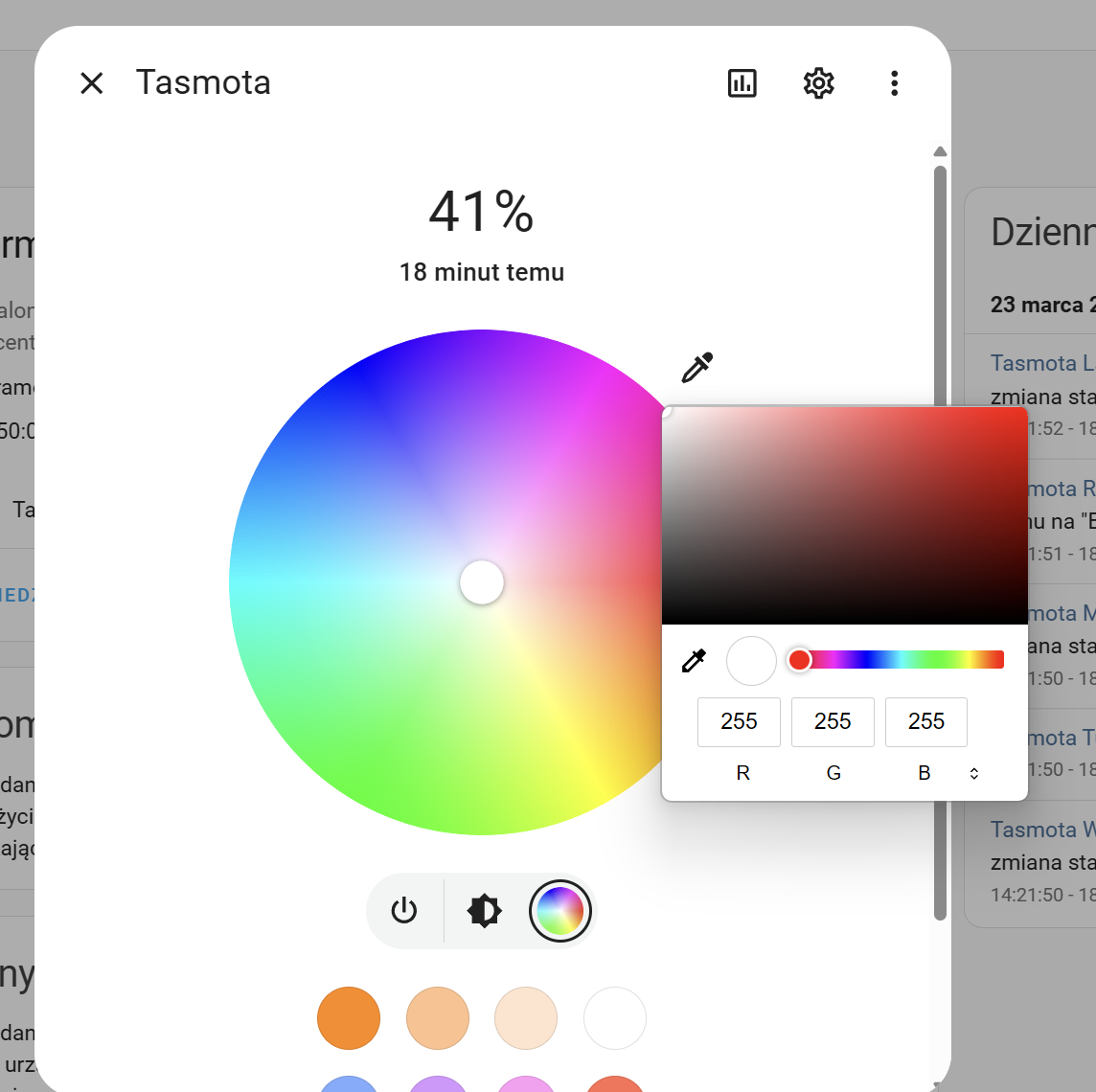

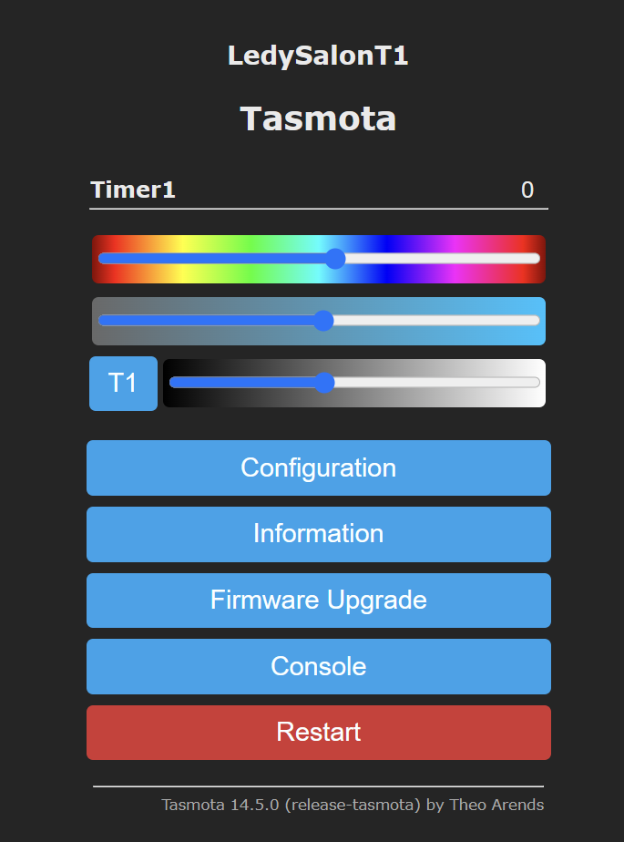

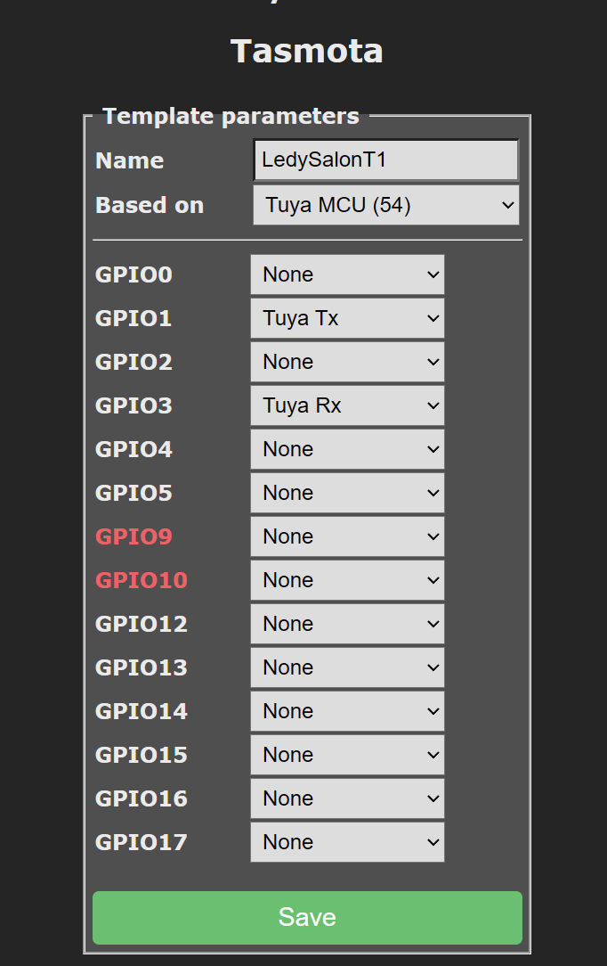

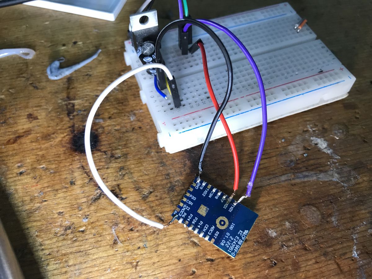

  • OpenBeken flashed successfully, and the controller paired with Home Assistant while LED commands and discovery worked automatically.

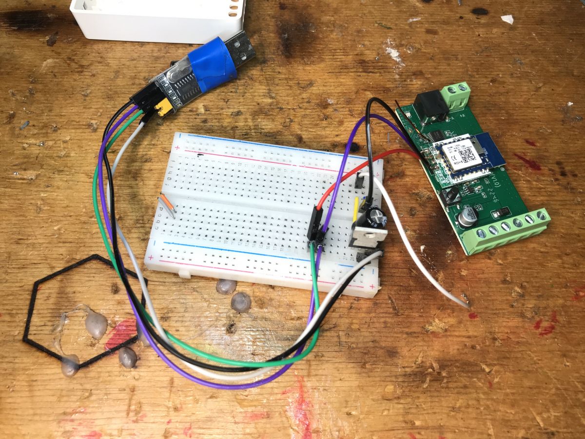

  • Programming is awkward because the WiFi module must be removed or desoldered, since TuyaMCU uses the same UART port as flashing.

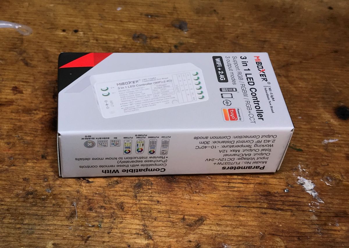

    Let`s see the item description from the seller:
    Description and photo of the Miboxer MiLight FUT037W+ controller with packaging.
    Yes, you can control it via WiFi or remote controls. Now the specifications:
    Technical details and packaging of the Miboxer FUT037W+ controller.
    Information about Bluetooth from the description suggests that there will be no ESP8266 inside.
    User manual for Miboxer FUT037W+ controller
    What do we get in practice?

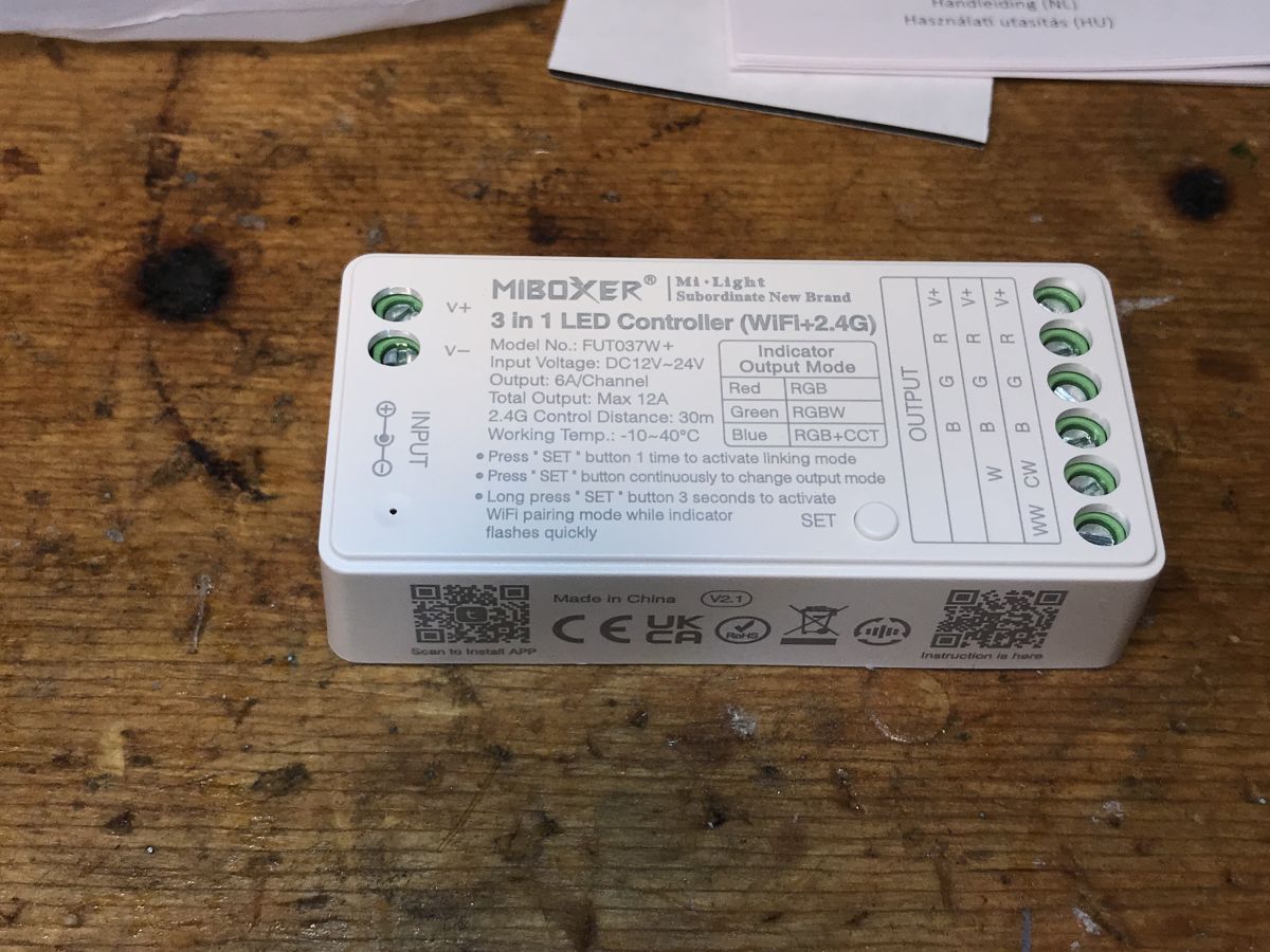

    LED controller Miboxer FUT037W+ packaging Miboxer FUT037W+ LED Controller Packaging Box of Miboxer FUT037W+ LED strip controller on a wooden table. Miboxer FUT037W+ LED controller box on a wooden surface
    Set contents:

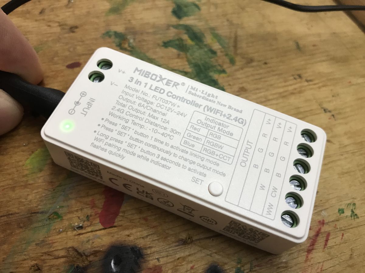

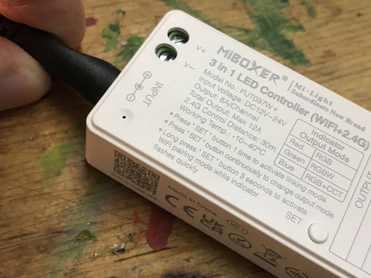

    White casing of the Miboxer FUT037W+ LED controller on a wooden surface, featuring certifications and QR codes. Packaged LED controller Miboxer FUT037W+ on a wooden table Miboxer FUT037W+ LED Controller on a workbench
    QR codes:
    Close-up of a QR code on the Miboxer FUT037W+ device. Sticker with QR code and markings on LED controller
    This controller has a separate DC jack input and a separate input for cables - smart and convenient.
    Power and wire inputs on the Miboxer FUT037W+ LED controller.
    And here are the outputs for the LED strip:
    Close-up of electrical terminal connectors of Miboxer FUT037W+ LED controller

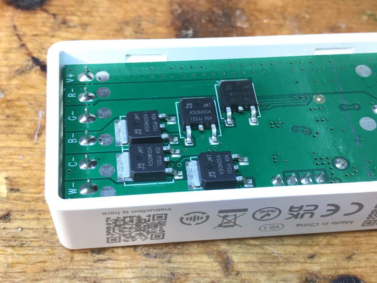

    You can immediately see that the MOSFET transistors are more powerful than usual, but why are they so dusty?
    Close-up of a circuit board with MOSFET transistors in the Miboxer FUT037W+ controller
    Slightly better:
    Close-up of MOSFET transistors on a printed circuit board.
    Electronic circuit board of the Miboxer FUT037W+ LED controller
    K50N03A, really good parameters:
    Diagram showing specifications and pin configuration of a MOSFET transistor.

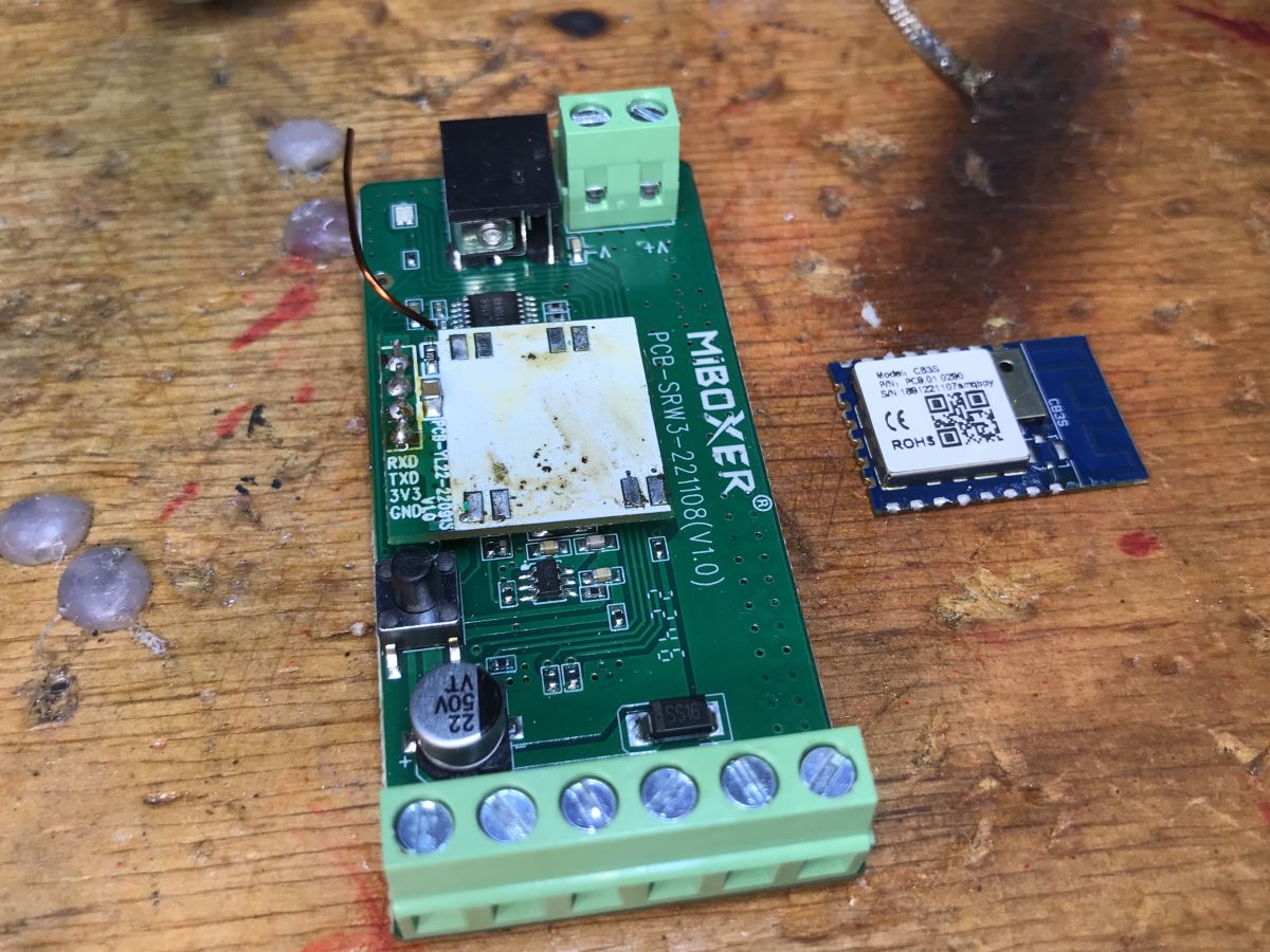

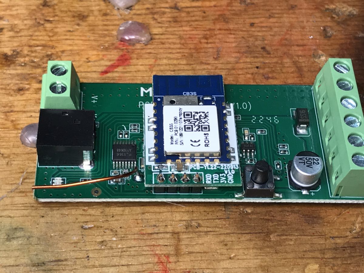

    We can now remove the PCB and look at the rest of the electronics:
    Interior of Miboxer FUT037W+ LED controller Interior of Miboxer FUT037W+ LED controller with CB3S WiFi module

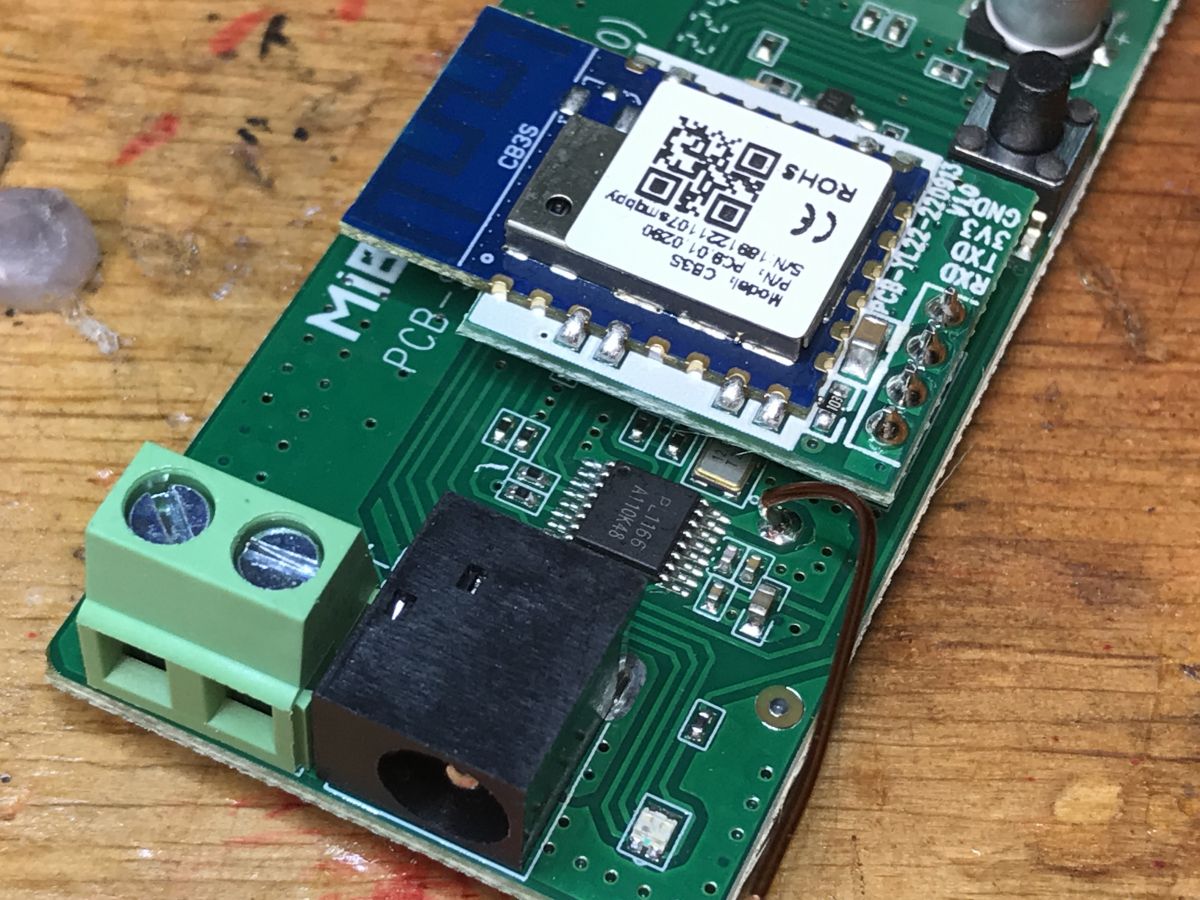

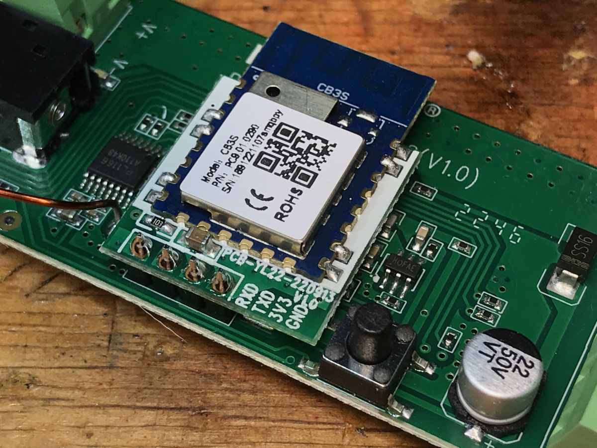

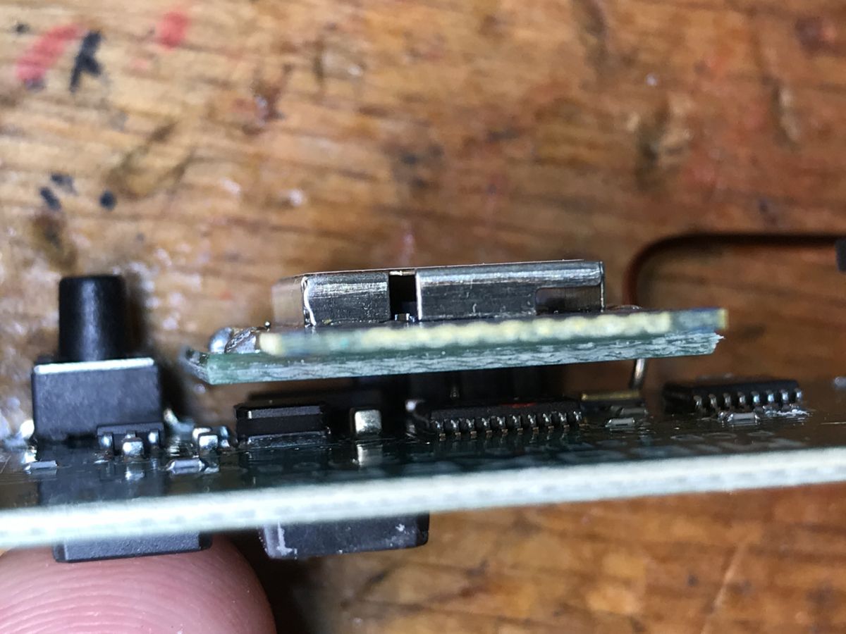

    The WiFi module is WB3S, but it is on a separate board and connects to the base only with four goldpins. Here we have 3.3V, ground and TX and RX.
    This is a typical example of a device based on TuyaMCU. Details in this topic:
    class="notranslate"> TuyaMCU protocol - communication between the microcontroller and the WiFi module
    Here I see the step down controller, it probably generates 3.3V from 12V from the belt:
    CB3S WiFi module on the PCB of Miboxer FUT037W+ LED controller
    And here we have the PL1166 A110K48 RF system (the MCU is under the WiFi module):
    Close-up of the Miboxer FUT037W+ controller's circuit board with visible electronic components.
    Close-up of electronic modules in the Miboxer FUT037W+ LED controller.

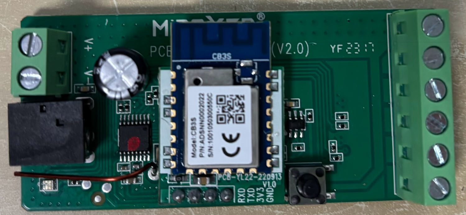

    I desoldered the board with the WiFi module to see what the MCU is there:
    WiFi module CB3S held by pliers WiFi module on a circuit board with a holder.
    This is Nuvoton MS51FC0AE:
    Close-up of a circuit board with a Nuvoton chip and other electronic components.
    Close-up of the Miboxer FUT037W+ circuit board with visible electronic components.
    Block diagram of a 24MHz 8051 microcontroller
    This MCU supports the RF system and transistors, and communicates with the WiFi module via UART.

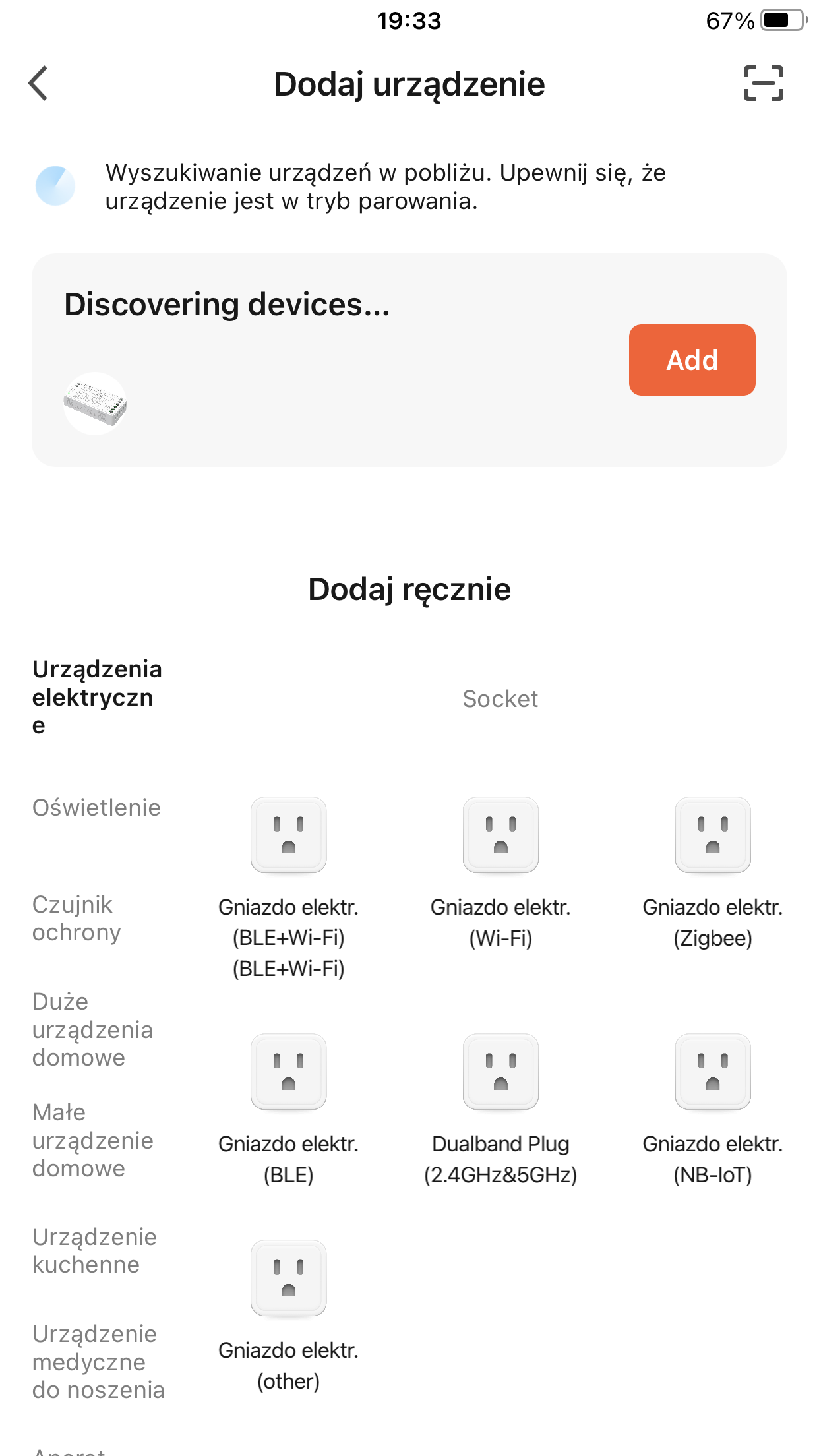

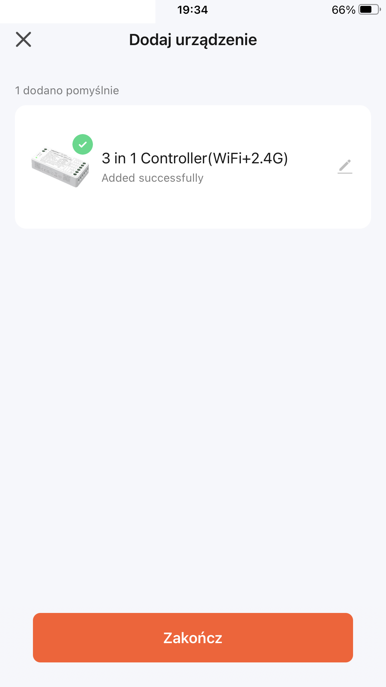

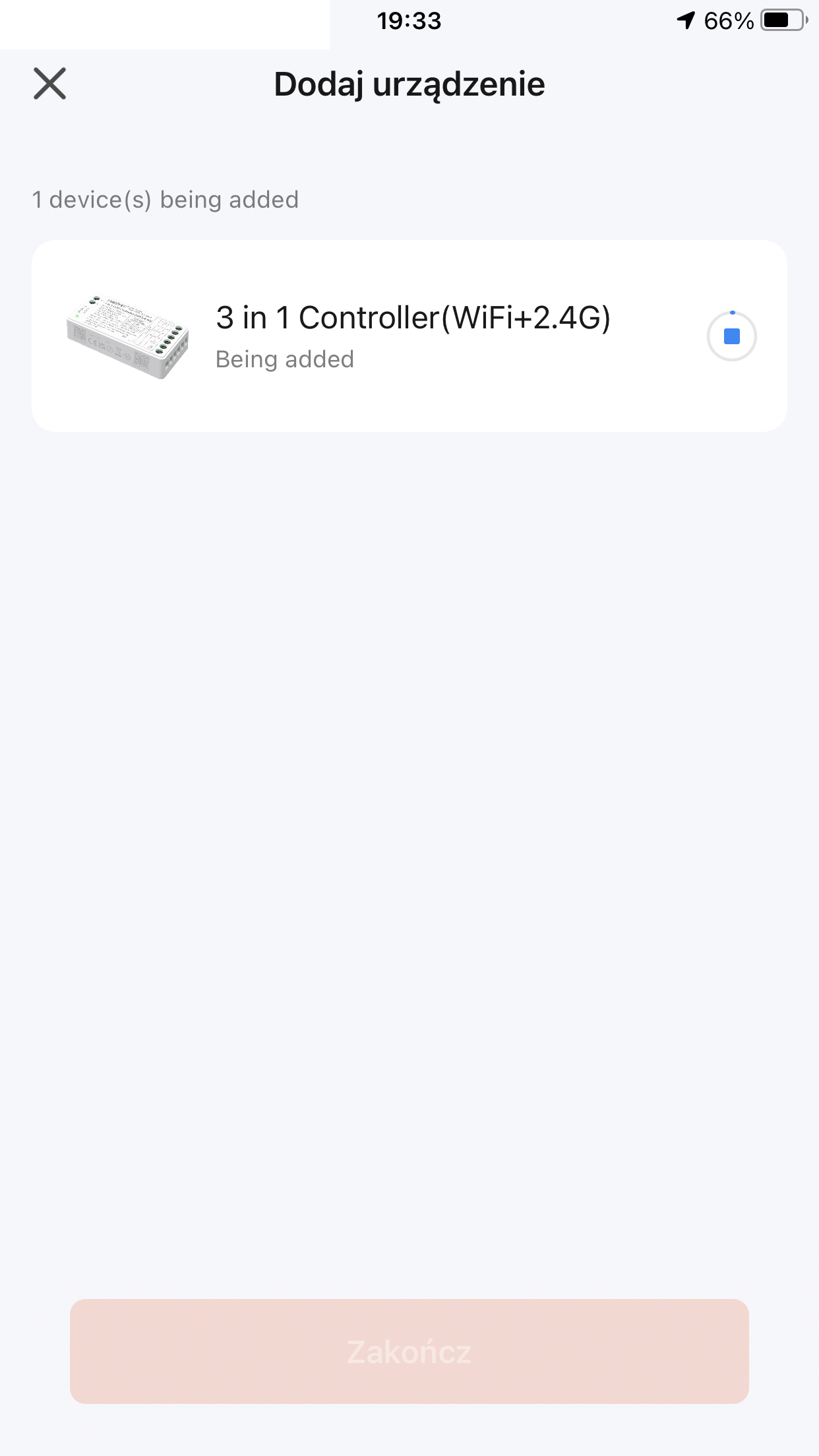

    So, the Tuya app recognizes the device from a distance:
    App interface for adding a new device.

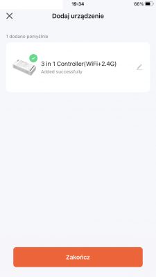

    Despite one failure ("weak signal"), pairing is successful:
    App screen showing the addition of a 3 in 1 (WiFi+2.4G) device App screen for adding a device with Miboxer LED controller showing weak signal App screen showing Tuya device being added. App screen showing successful addition of 3 in 1 Controller (WiFi+2.4G) device.

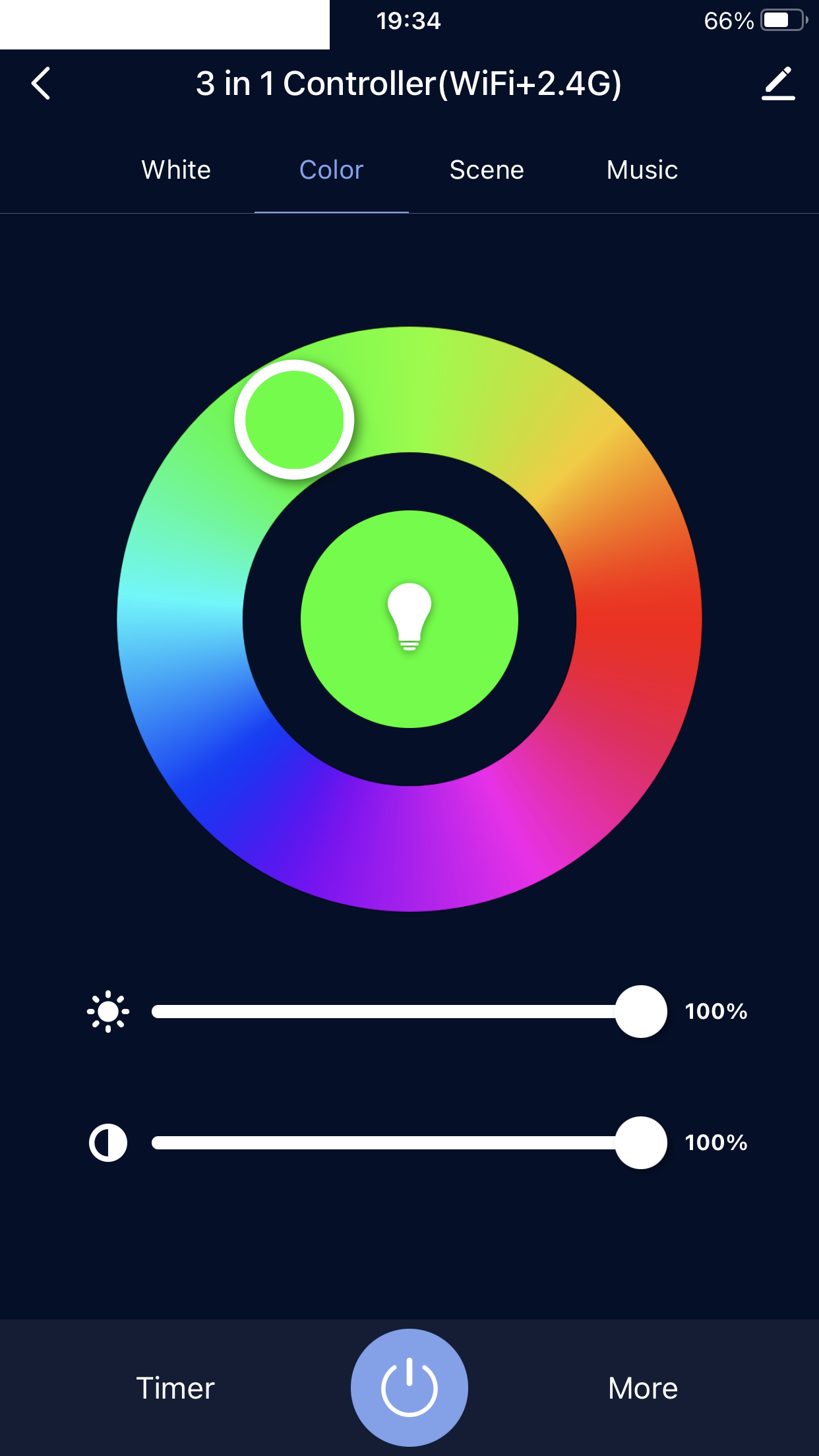

    Inside we have a typical RGBCW controller:
    Mobile application interface of MiBoxer showing LED control with color wheel and brightness sliders.
    Of course, there are options here such as the initial state, calendar, etc., but I have discussed this before, so I will skip it.
    Interface of Miboxer FUT037W+ LED controller app

    We upload with my flasher:
    Unfortunately, you have to remove (or desolder - depending on the PCB version) the WiFi module outside the system, because TuyaMCU uses the same UART port as programming.
    Wireless module Miboxer FUT037W+ connected to a breadboard
    later we need to create autoexec.bat : :
    // start driver
    startDriver TuyaMCU
    // always send wifi state 0x04 to MCU - paired and connected to cloud
    tuyaMcu_defWiFiState 4
    // set baud rate (if your device is using 9600, remove this line)
    tuyaMcu_setBaudRate 115200
    // setup Tuya LED color dpID 24 and Color format 1
    // (the other dpIDs are taken from default settings)
    tuyaMCU_setupLED 24 1
    The code is really very short, but the remaining dpIDs are set to default values. OBK does not send dpID 28 at the moment, but tests have shown that sending dpID 22 is sufficient.
    The above code will connect the LED controller with OBK to the MCU from this device, so all LED commands as well as Home Assistant Discovery will work automatically.

    As for the construction itself - the transistors inside are certainly better than in the controller that I tested (and repaired) some time ago in the topic WiFi SmartLife single-color LED strip dimmer - test, interior, diagram , so basically I think we can recommend this product for slightly larger installations.

  • CB3S module removed for flashing
    #2 20990322
    Posts: 14765
    Rate: 12899
    I flashed this bar again. This time for someone else. Packaging and product:
    Miboxer 3 in 1 LED controller with green light on a wooden surface. MIBOXER 3 in 1 LED Controller (WiFi + 2.4G) packaging on a wooden table. MiBoxer 3 in 1 LED controller packaging on a wooden table MiBoxer 3 in 1 LED controller on a wooden table. Miboxer 3 in 1 LED controller on a wooden table.
    App:
    App interface of 3 in 1 Controller with color and brightness settings for light. App interface for adding electrical devices. App screen adding device 3 in 1 Controller (WiFi+2.4G) with an option to finish the process. App screen showing the addition of a 3 in 1 Controller (WiFi+2.4G).
    Interior:
    Close-up of an electronic circuit with an exposed module. View of the interior of a white plastic electronic device with a mounted green circuit board and several black components. Close-up of a circuit board with a CB3S module and electronic components. Close-up photo of a PCB with a CB3S module installed. CB3S module mounted on a circuit board.
    For the duration of flashing, I removed the CB3S with hot air:
    Electronic module with a breadboard and wires on a wooden surface. Photo of a MiBoxer electronic module on a workshop table. Electronic circuit with wires on a breadboard.
    Added after 26 [seconds]:
    At this moment - the interior remains unchanged.

    priva7eer
    I converted the FUT037W+ today according to these instructions. Specifically, I soldered the module board - that is, those 4 pins, without surface soldering or hot air, and used those pins for programming. I uploaded OpenBK7231T_UA_1.17.803.bin without any major problems, configured OBK with my WiFi, MQTT and saved them as well. I am using Flasher bk7231flasher_1.3.3.
    After assembling and commissioning, the chip booted and the LEDs lit up white, but there were no sliders or buttons to control the light in the device panel.
    I went to Web Application > Filesystem. I added (Create File) autoexec.bat with the contents above. After a reboot, the sliders and buttons appeared, but did not control anything. The LEDs remained white. After searching for a while, I found the solution:
    I remembered that when trying to convert the Tuya configuration I got a message
    Sorry, no meaningful pins data found. This device may be TuyaMCU or a custom one with no Tuya config data.
    Baud keyword found, this device may be TuyaMCU or BL0942. Baud value is 9600
    No module information found.
    Removing that line worked. Thanks for the cool soft!
    PCB with mounted CB3S module and various connectors. .

    trynio132
    After uploading the tasmota, I used a template like this
    { "NAME": "name", "GPIO":[0,2272,0,2304,0,0,0,0,0,0,0,0,0,0,0,0], "FLAG":0, "BASE":54, "CMND": "DimmerRange 0,1000 | TuyaMCU 21,23 | | TuyaMCU 81,26 }
    Tasmota configuration settings for LED controller. .
    And then by trial and error I arrived at this configuration :) .
    Backlog DimmerRange 0,1000; TuyaMCU 11,20; TuyaMCU 26,21; TuyaMCU 21,21; TuyaMCU 24,24; TuyaMCU 81,26; TuyaMCU 98,101;
    On these settings it now works properly, as I specifically have the RGB + W bar and can control the colours, white light on and off as well as the dimming function works.
    Tasmota user interface with sliders for lighting control. .
    Also thanks for your help.
    As a curiosity I can say that I bought the same driver in the zigbee version - that is FUT037Z+ and it turns out that in it there is no possibility to switch on the white diode at the same time together with the RGB, I found some discussions on github regarding this driver and everyone confirms that the zigbee version does not cope with switching on the RGB diode at the same time, and the W/CCT
    Also, if anyone is wondering what to use when building a smart home, it is definitely better to choose the Wifi model and solder the chip to the ESP :) .
    The only inconvenience I have is that in this configuration I can't turn on the white LED alone from the homeassistant. RGB alone works for me of course, and RGB in combination with the white LED, however it is not possible to switch on the white alone without RGB (but from the remote it works fine so it's a detail)
    In the example of the homeassistant, such a setting makes the white light shine and the RGB diode shine red
    This is of course probably a matter of the lighting widget in the homeassistant itself :) .
    Tasmota interface with color wheel for RGB and white lighting control.

  • The board uses stronger-than-usual MOSFETs marked K50N03A, which is why the author recommended it for somewhat larger LED installations. [#20926307]
