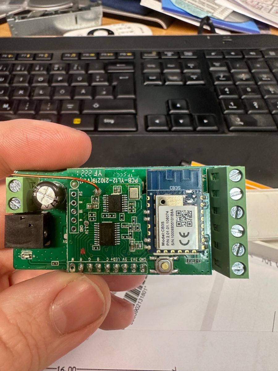

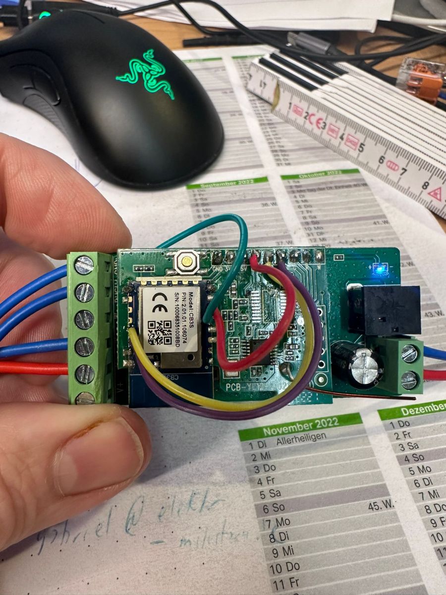

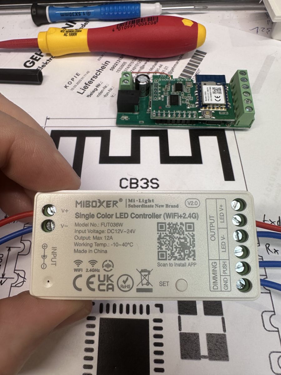

    Hi,
    Hello, I have the LED controller Miboxer Fut036w with WiFi and 2.4GHz.
    I have flashed with the ObenBK Firmware.
    The flashing and the CRC is OK.
    CRC matches 0x4ACF98A4!

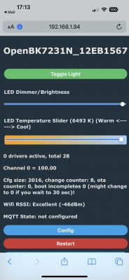

    Writing file data to chip success.
    When I connect the power I can see the WiFi.
    Then I can connect to my home WiFi.
    I can connect to MQTT.
    But I can't control it via the web.

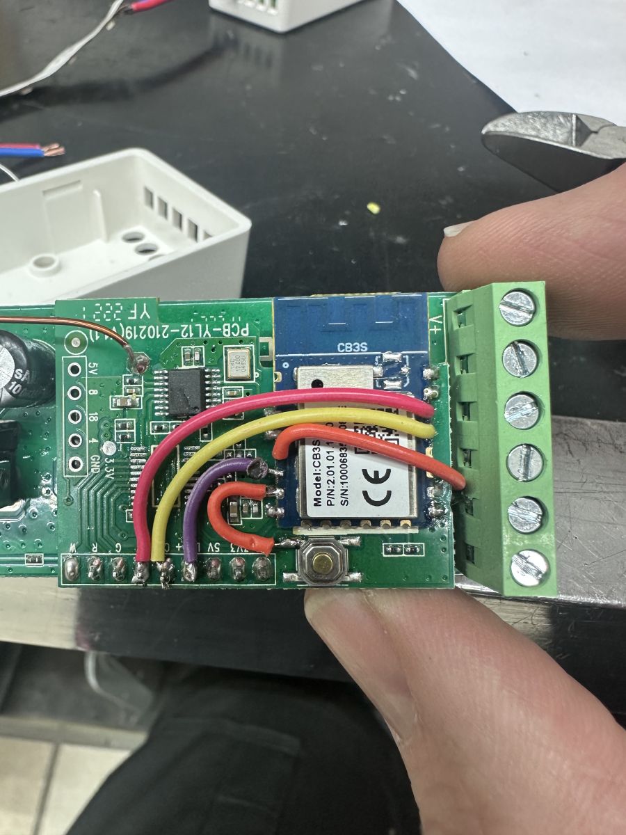

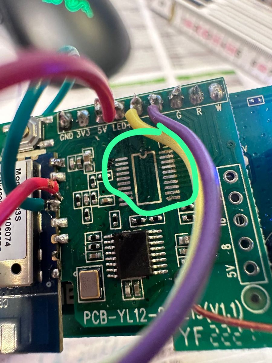

    Then I have seen that there is another µC. So I have dismounted it and have connected the pins from the CBS to the MOSFET, the WiFi LED, and the button.
    WiFi LED is working good.
    On the PCB, there are 2 MOSFETs, and there is both the same LED. It is only a backup when one MOSFET is damaged or is it for more power?
    The FUT036w is built for 12-24V 13A LED.
    The button I have some questions too.

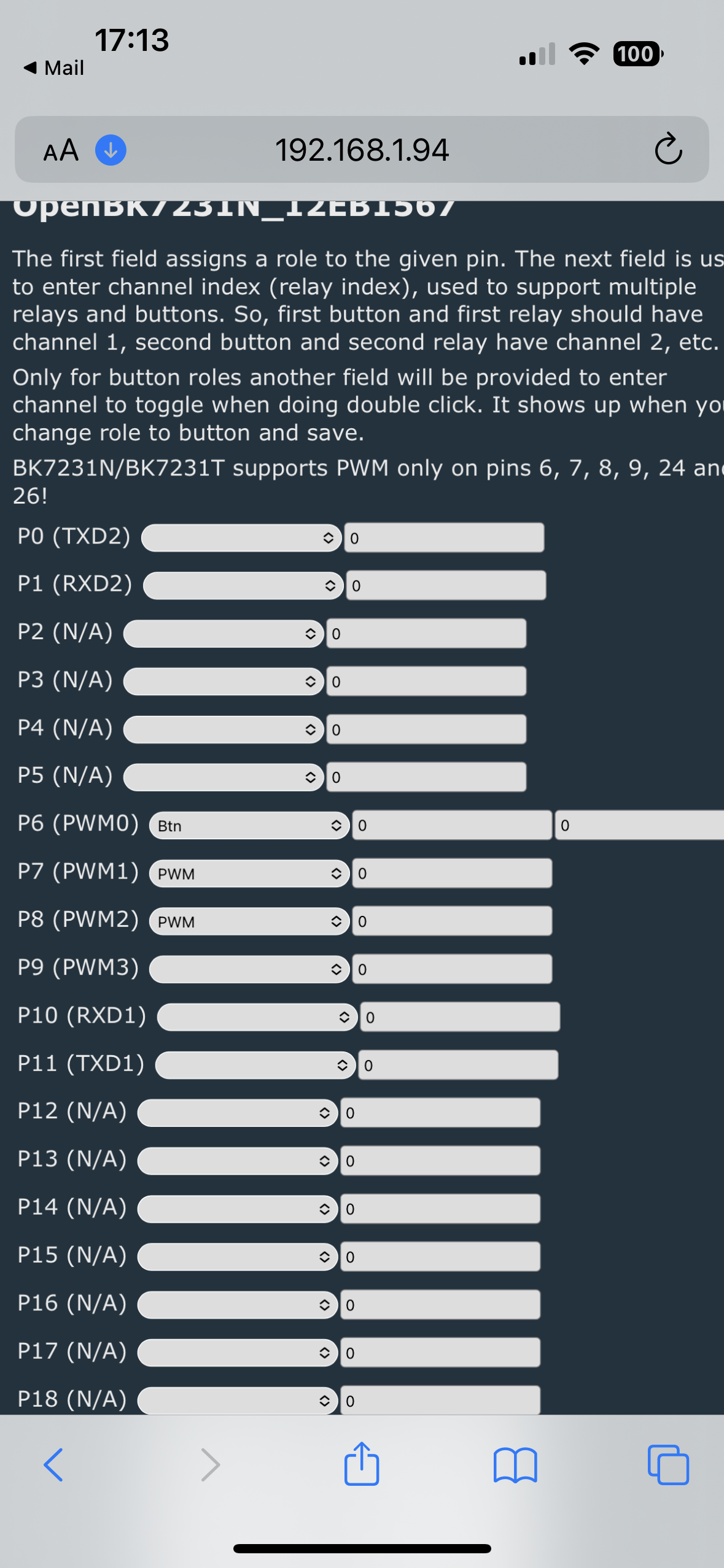

    The layout has a pull-up. So I have 3.3V on the pin and when I press the button then I have 0V.
    But when I select button or smart button, the internal pull-up is active and it's not working.
    When I select Dinput_No_PullUp then I can use it. But then I can't use the smart button.
    Is it possible to make a script and can someone give me a tip on where I need to look?
    And the second, when I use the smart button you can switch on/off and increase the PWM. I will change it so that you can dim to the maximum and then wait. And when you press the button again long, you will decrease the value to the minimum (but not zero).
    Here I need also help to change the program.

    Here I have dismounted the other µC and quick and dirty a new connection for the CB3S.

    Hello, I have seen that device recently. It is indeed a bit more complicated version of an average LED strip controller.
    mplum wrote:
    Then i have see that there is an another µC.
    This is called TuyaMCU. The TuyaMCU is communicating with WiFi module via a simple UART protocol. TuyaMCU is supported by OpenBeken, but each TuyaMCU device has a device-specific packet types which we must first capture and analyze in order to support them.
    mplum wrote:
    So ih have dismount it und have connect the Pins from the CBS to the Mosfet, the Wifi LEd and the Button.
    This is an alternate solution and it's also a good approach. It should work, but please remember to connect one of PWM pins to MOSFET, because BK7231 has PWM only on 6 chosen GPIOs, and if you choose non-PWM GPIO, you won't get smooth control of light.
    mplum wrote:
    On the PCB there are 2 Mosfets, and there are both an the Same LED. It is only a Backup, when one Mosfet is damaged= or is sit for more Power?
    The FUT036w is build für 12-24V 13A LED .
    If they are connected together, then they are used to increase the current capability, more power.
    Keep in mind that you can sometimes get a strip where a MOSFET is left unused and not connected, and then you can repurpose such device to drive one extra colour channel.
    mplum wrote:
    The Layout have a Pull up. So i have 3,3V on the Pin and whe i press the Button then i have 0V.
    But when i select Button or Samrt Button the the internal pull up is active and its not working.
    Whe i select Dinput_No_PullUp then i can use it. But then i canßt use the samrt button.

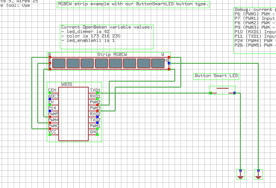

    Really? Btn_SmarLED is not working because of pull up resistor on PCB?
    Well, the quickest solution would be to remove the pull up resistor from PCB.
    We don't need pull ups on PCB, OpenBeken GPIO has internal pull up resistors.
    Btn_SmartLED should work as long as it is connected between GPIO and GND. Pressing button shorts GPIO to GND.

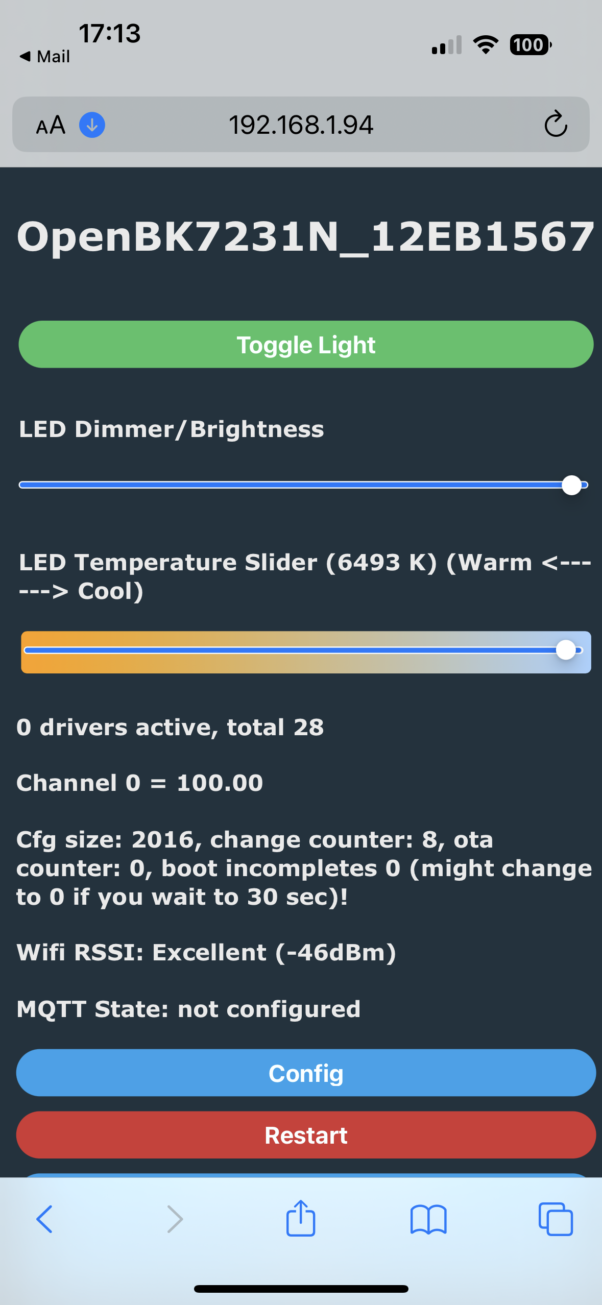

    And the Secon.d When i use Smart Button you can switch on/off and increase the PWM. i will change it, that you can dimm to the maximum. and then Wait.
    I am sorry but I am not sure if I understand correctly what you are trying to achieve. Can you be more clear and rephrase your question in I way that I can understand?
    The Btn_SmartLED should give you full LED control you need, as shown on our videos:
    https://www.youtube.com/watch?v=vDh8Y_NDrb4
    https://www.youtube.com/watch?v=e1xcq3OUR5M
    Btn_SmartLED, once setup, should allow you to:
    - turn on and off device
    - adjust brightness
    - scroll list of a predefined colours
    - toggle between 3 temperature modes: warm, cool, mixed

    mplum
    Posts: 34
    mplum wrote:
    On the PCB there are 2 Mosfets, and there are both on the Same LED. It is only a Backup, when one Mosfet is damaged or is it for more Power?
    The FUT036w is built für 12-24V 13A LED .

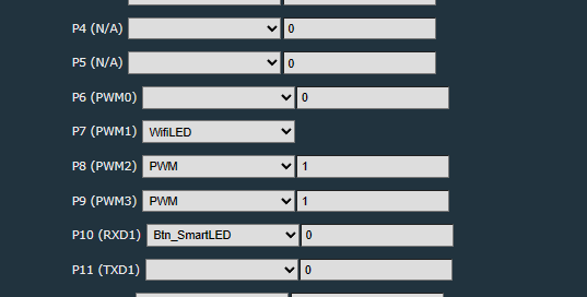

    OK, can I use one PWM to control both mosfet? when I select 2 Pins with PWM1, then the second pwm channel is the color.
    I know that I can only use the 6 PWM pins.
    mplum wrote:
    The Layout has a Pull up. So I have 3.3V on the Pin and when I press the Button then I have 0V.
    But when I select Button or Smart Button the internal pull up is active and it's not working.
    Really? Btn_SmartLED is not working because of pull up resistor on PCB?
    When I switch to button or do BTN_smart the internal Pull up is active. Then I need only switch the button to GND.
    But with the original Layout I have 3.3V on the Signal and when I press the Button it goes to zero. But when I connect the wire to the Pin, it is not going to zero.
    In my opinion there is now a double pull up. But is it possible to deactivate the internal Pull up of the CB3s when I use the BTN_SmartLED??

    mplum wrote:
    OK, can i use one PWM to contol both mosfet? when i selecct 2 Pins with PWM1, then the second pwm channel is the color.
    i know that i can only use the 6 PWM pins.
    If you have two use one PWM to control two MOSFETs you can try connecting both MOSFETs to that PWM, but everything depends on the specs of the MOSFETs. It should be also possible to set two PWM pins to a single channel and they will both mimic value from this channel.
    mplum wrote:
    When i switch to button or du BTN_smart the internal Pull up is active. Then i need only switch the button to gnd.
    But with the original Layout i have 3,3V on the Signal and when i press the Button is go to zero. But when i connect the wire the the Pin. is not ggoing to zero.
    in my oppinion there is now a double pull up. But it is possible to deactivate the interal Pull up of the CB3s when i use the BTN_SmartLED??
    In my opinion it still should go to zero. It is possible to change the code Btn_SmartLED and add extra role: Btn_SmartLED_noPullUp, but still, maybe you can try removing the physical resistor (pull up) from the board, if you think it breaks the button mechanism?

    mplum wrote:
    OK, can I use one PWM to control both MOSFET? When I select 2 Pins with PWM1, then the second PWM channel is the color. I know that I can only use the 6 PWM pins.
    If you have to use one PWM to control two MOSFETs you can try connecting both MOSFETs to that PWM, but everything depends on the specs of the MOSFETs. It should be also possible to set two PWM pins to a single channel and they will both mimic value from this channel.
    OK and what I need to do? I have enough Ports. So I can use one port for one MOSFET. But then I select PWM with both number one then I can see on the web the slider for cold and warm white.
    mplum wrote:
    When I switch to button or do BTN_smart the internal Pull up is active. Then I need only switch the button to GND. But with the original Layout I have 3.3V on the Signal and when I press the Button it goes to zero. But when I connect the wire to the Pin, it is not going to zero. In my opinion there is now a double pull up. But is it possible to deactivate the internal Pull up of the CB3s when I use the BTN_SmartLED??
    Yes I will connect directly to the CB3s and disconnect the pullup.

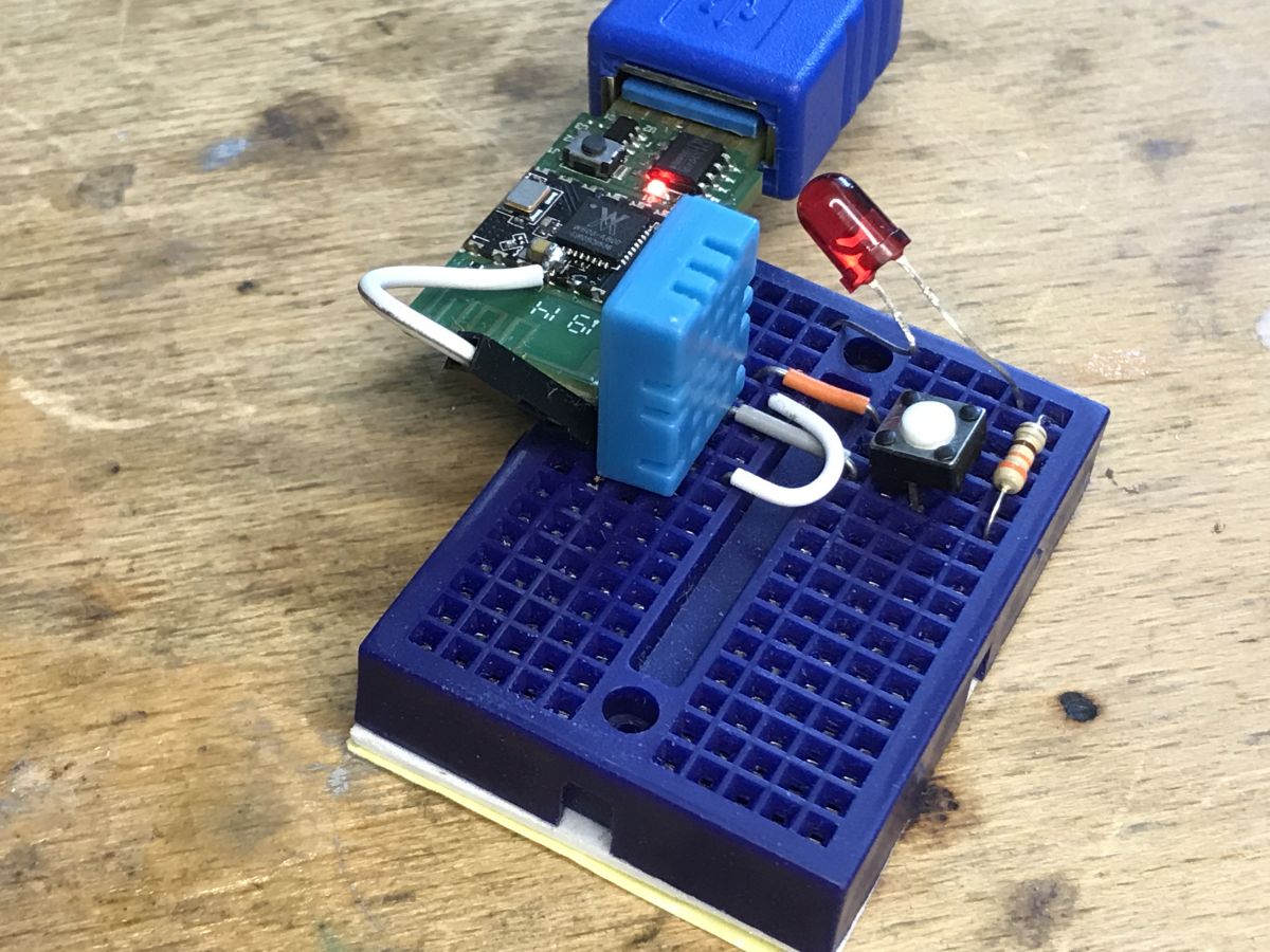

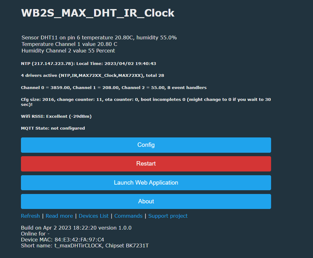

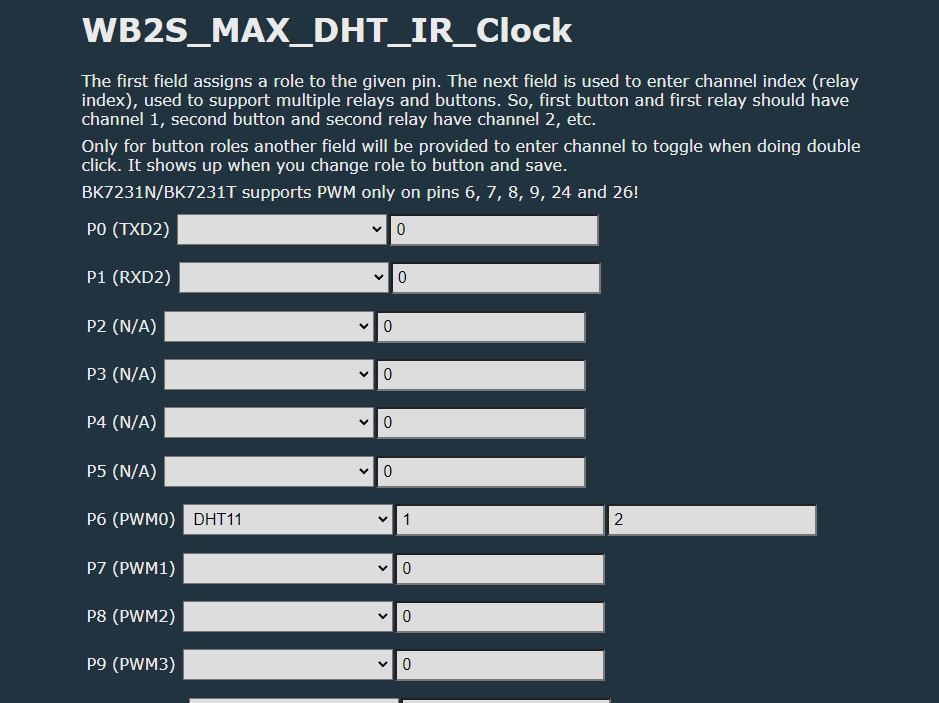

    it is possible to connect 1-wire sensors to the CB3s?? for example
    DS1820??
    i need to measure a temperature and then i will regulate a fan with pwm
  • #8 20521459
    Posts: 14765
    Rate: 12899
    Currently we are supporting DHT family of sensors, I am playing with one on W600 platform (OBK runs on many platforms):
    Miboxer FUT036w and CB3s Issues: Flashing Firmware, WiFi Connectivity, and Button Control Miboxer FUT036w and CB3s Issues: Flashing Firmware, WiFi Connectivity, and Button Control
    The DS18B20 is on TODO list.

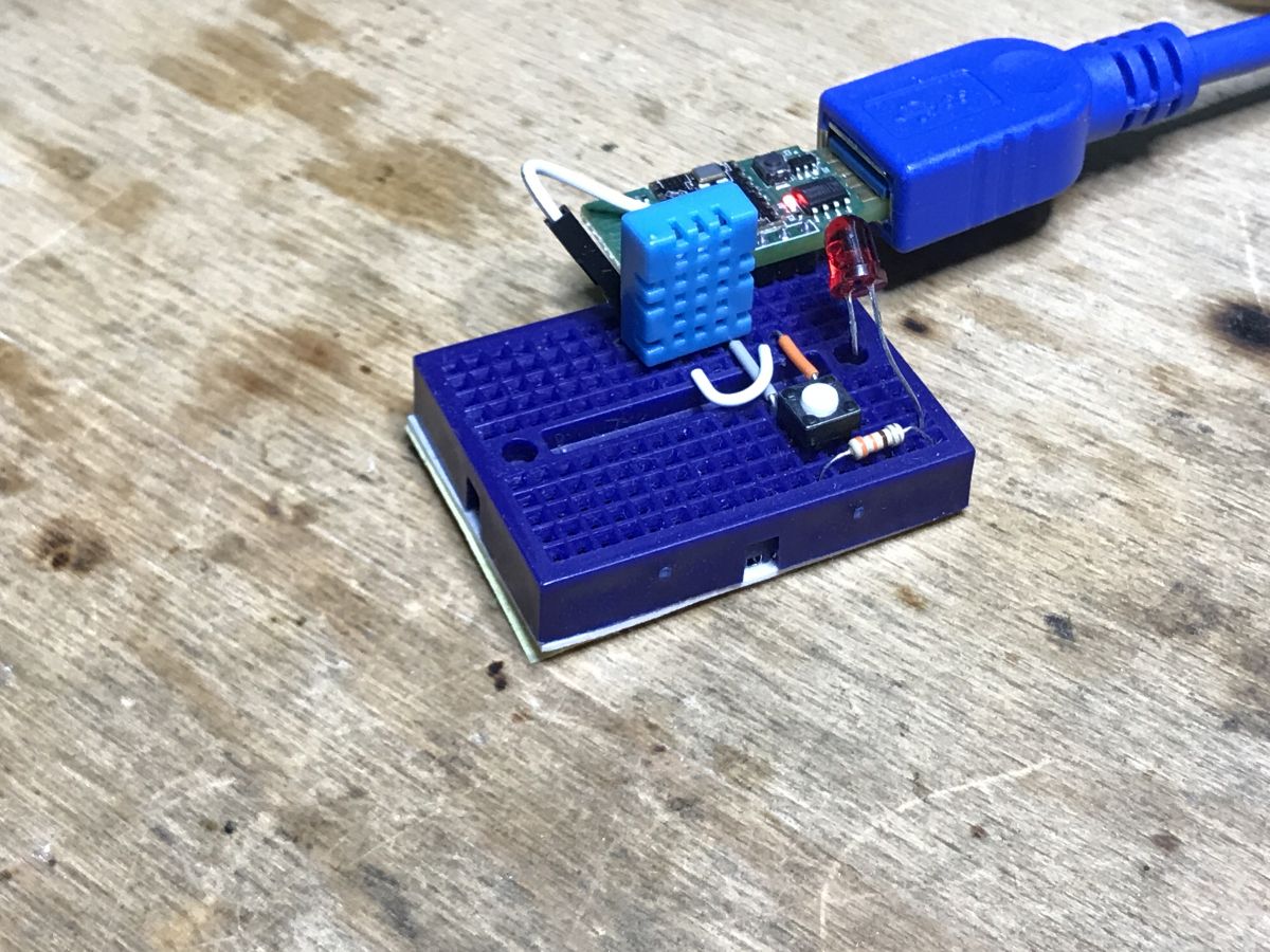

    mplum
    Posts: 34
    ok. then I will buy some dht11. the dht11 is still working?
  • #10 20521627
    Posts: 14765
    Rate: 12899
    Yes it is:

  • Webfront temperature slider forces channel 0 to zero
    #20 20529544
    mplum
    Posts: 34
    Is working. When you set Both pwm Channel to the Same number Then both Channels have the Same value.
    But, in the webfront you can See the Slider for the led Temperature. And when you Slide the temperature the Channel goes to zero. And you Need to restart
    When you Not restart the led so Not Go on. Channel 0 Always Zero Miboxer FUT036w and CB3s Issues: Flashing Firmware, WiFi Connectivity, and Button Control Miboxer FUT036w and CB3s Issues: Flashing Firmware, WiFi Connectivity, and Button Control
  • #21 20529567
    Posts: 14765
    Rate: 12899
    Which firmware version?
  • #22 20529603
    mplum
    Posts: 34
    Version 1.15.661.
  • #23 20529653
    Posts: 14765
    Rate: 12899
    You are right, one file didn't make it into the build.
    Please try 1.15.662 and tell me if it works.
  • Smart button behavior and flag 17 limitations
    #24 20529781
    mplum
    Posts: 34
    Ok. With Version 1.15.663 all is Working. There is no 2nd slider. And Both Channels have the Same value
    And I have Activate flag 12 and 17 together. Then I can't activate. I can toggle on off But always value 0. Then I have deactivated Both flags. Then it was ok. Then activate only flag 12, is also ok. Then activate flag 17. Then is also Working. 🤔
    But with Flag 17 is only Working when I change the value in the Web. When the led is off and I Press the Smart Button the led going Not ON.
    Can you say something about Smart Button. About dimm up to the Maximum, and Then dimm down to the Minimum.
    Normally I can do it with a Script? When I Press the Button Long I get the actual value and increase with 1 until the Maximum is Reached. When I stop Pressing and Press Then Long again Then I decrease until the minus is reached. how Long is the Time for 1 Zyklus? When I increase oder decrease 1 Every Zyklus. How fast I reached the 100?

    #27 20534271
    mplum
    Posts: 34
    I only use a single white LED. I use PWM1 and 2 für Channel 0.
    When I have activated both flags, the fan toggles on and off, but the brightness was always 0. I can't select the brightness over the web or with the smart button. I restarted the device. Also no brightness. Then I switched both flags off and made a restart. Then it was working.
    Then I activated only flag 12, which is also ok. Then I activated flag 17. Then it is also working. 🤔
    But with flag 17, it is only working when I change the value in the web. When the LED is off and I press the smart button, the LED does not turn on.

  • Single PWM and BtnSmartLED button dimming test
    #30 20534303
    Posts: 14765
    Rate: 12899
    Hmm that must be a bug. Can you please tell, if you have a single PWM pin, and BtnSmartLED, is there a way to increase brightness through that button?
    Can you check?
    Added after 14 [minutes]:
    I just tested with physical device (BK7231T):
    For that configuration, I can use Button to both turn on and off and adjust dimmer....
    Both flags (12 and 17) set. Also works without them.
    Can you please tell me how to exactly reproduce your issue?
