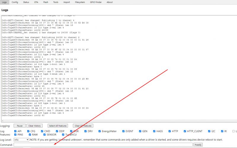

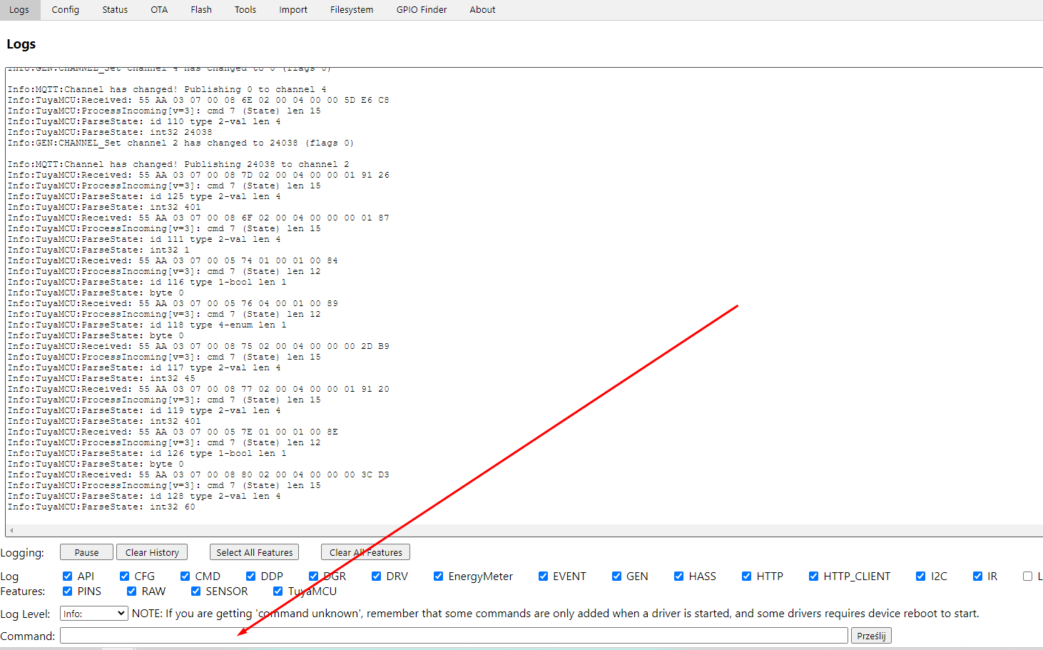

So now, once you have this autoexec.bat and you have rerun it or rebooted device, you can assign the following command in the console:
tuyaMcu_sendQueryState
Once you do, you should get a large reply from TuyaMCU:
Screenshot of OpenBeken logs for TuyaMCU with commands and dpID identifiers.
It will be something like:

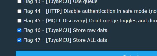

Now, go to the flags and set 46 and 47:
Screenshot showing configuration options for TuyaMCU flags in OpenBeken.
Those flags will enable a TuyaMCU dpID storage on OBK side. This will allow you to run DP command.
Now, once those flags are set, rerun tuyaMcu_sendQueryState

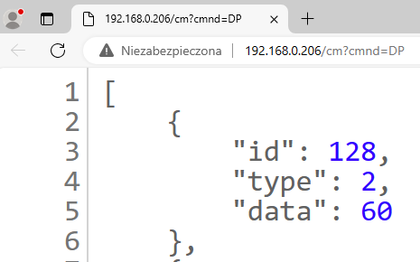

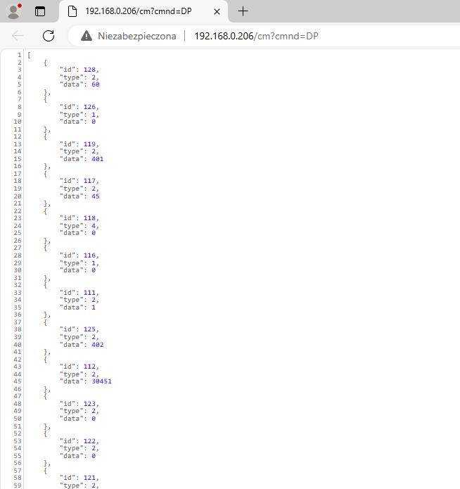

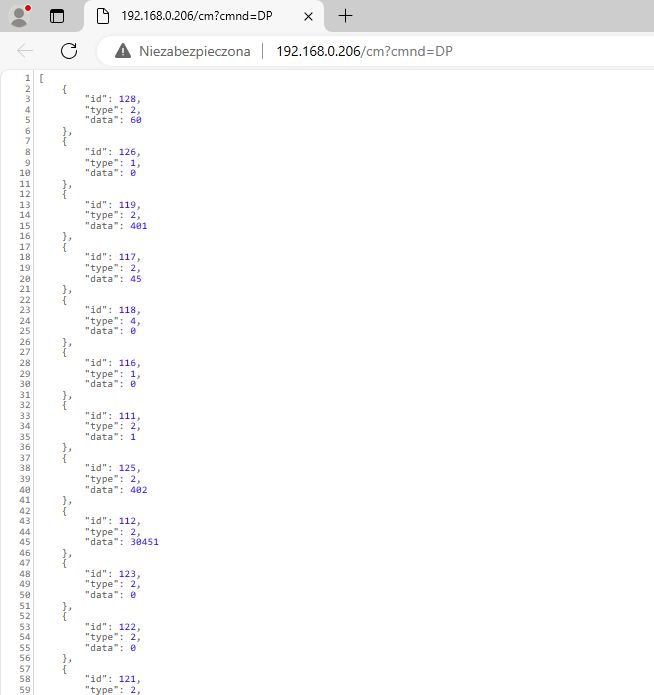

The received dpID values are now stored by OBK. Access them via HTTP command:
http://192.168.0.206/cm?cmnd=DP
Here is how it looks like on my device:
Screenshot showing dpID data from a TuyaMCU device in JSON format displayed in a browser window.
They are in JSON format and you can also get the same result via MQTT:
This means that you can process them either in Home Assistant (via MQTT) or in your application (via HTTP) or even from HTML page hosted on OBK itself (again, via HTTP rest API). You don't even need to configure OBK channels, you get direct access to dpIDs.
