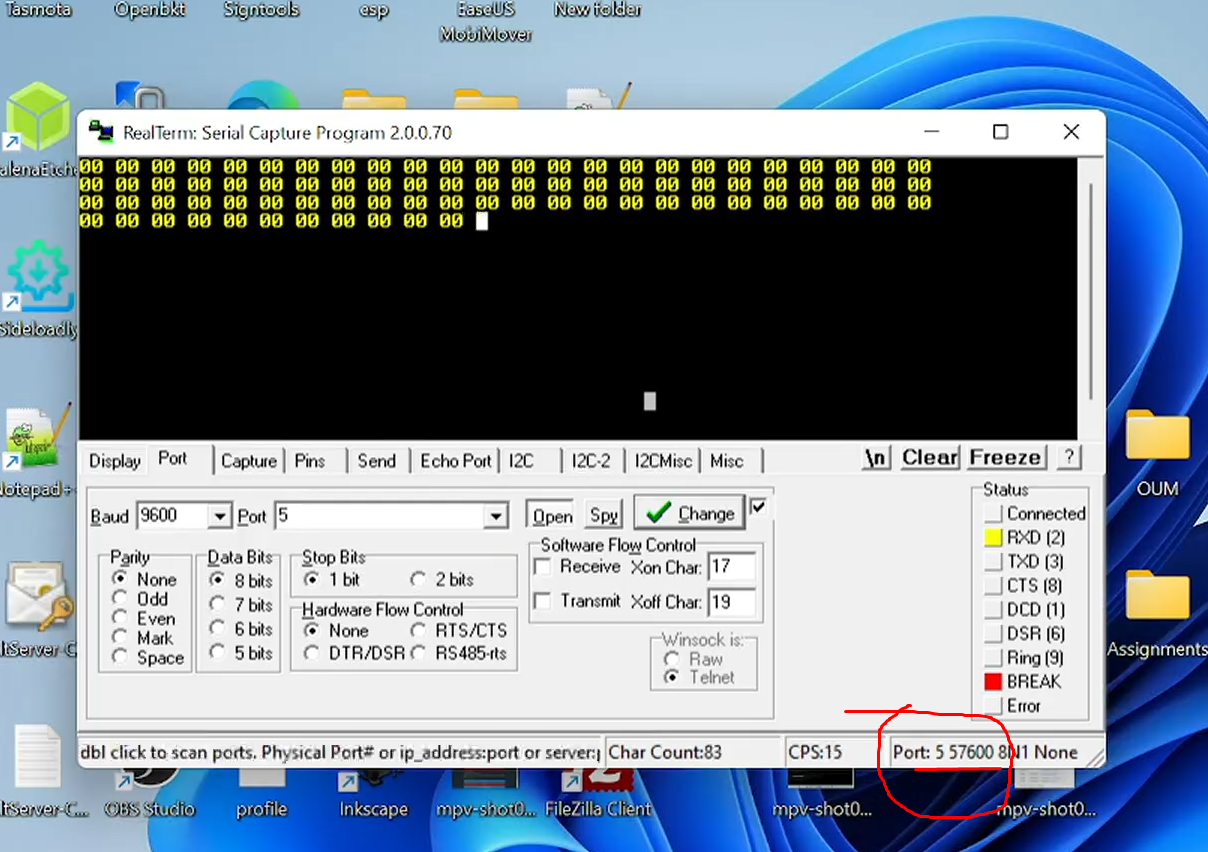

    Capturing is easy to do in RealTerm:
    Screenshot of RealTerm: Serial Capture Program version 2.0.0.70 with open interface.
    It is best to choose hex with spaces (not binary):
    Screenshot of RealTerm program with ASCII display format selected.
    Then you should enable writing to the file, so it's more convenient:
    Screenshot of RealTerm program for capturing serial communication.

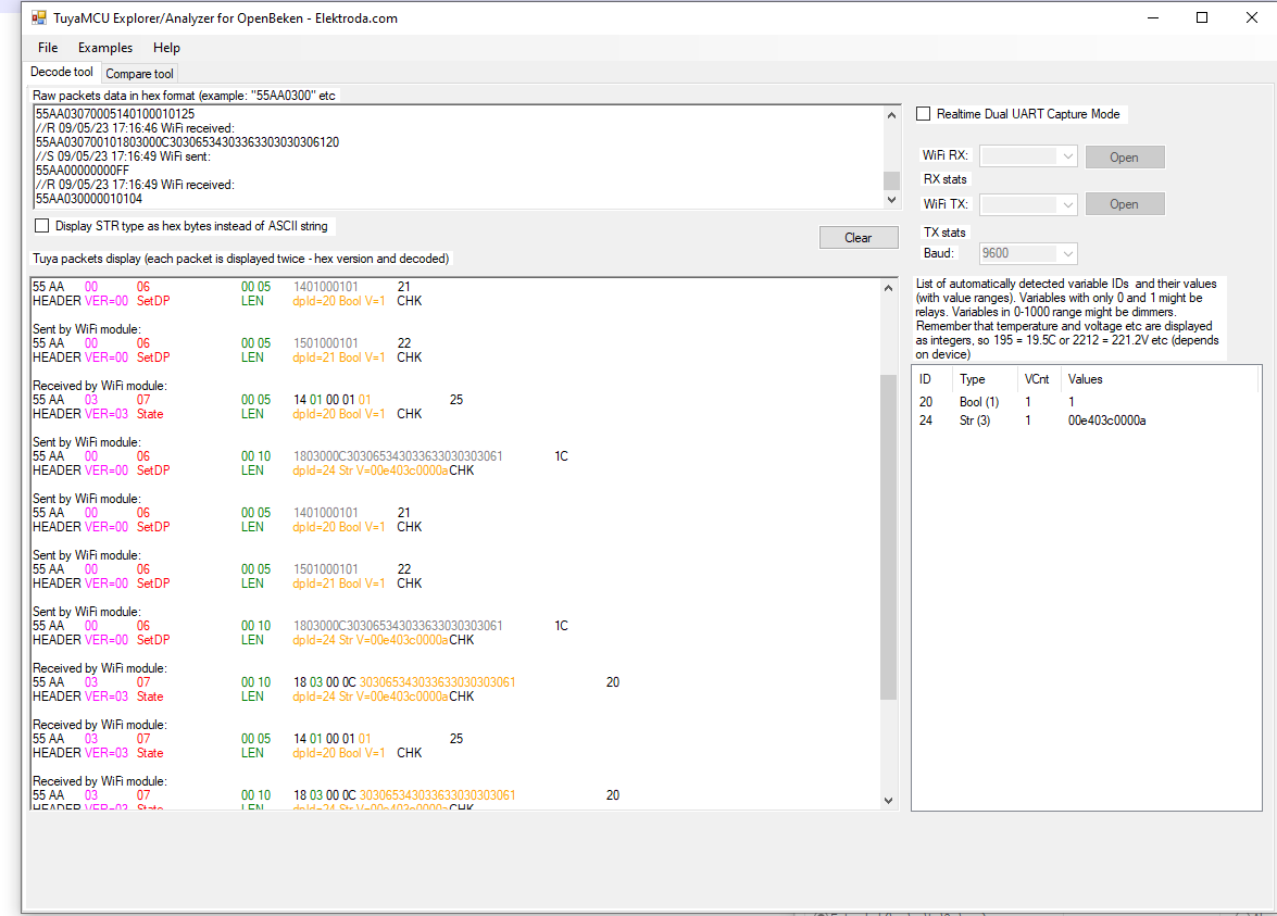

    TuyaMCU analyzer
    The program can be downloaded from Github, already in compiled form:
    https://github.com/openshwprojects/TuyaMCUAnalyzer

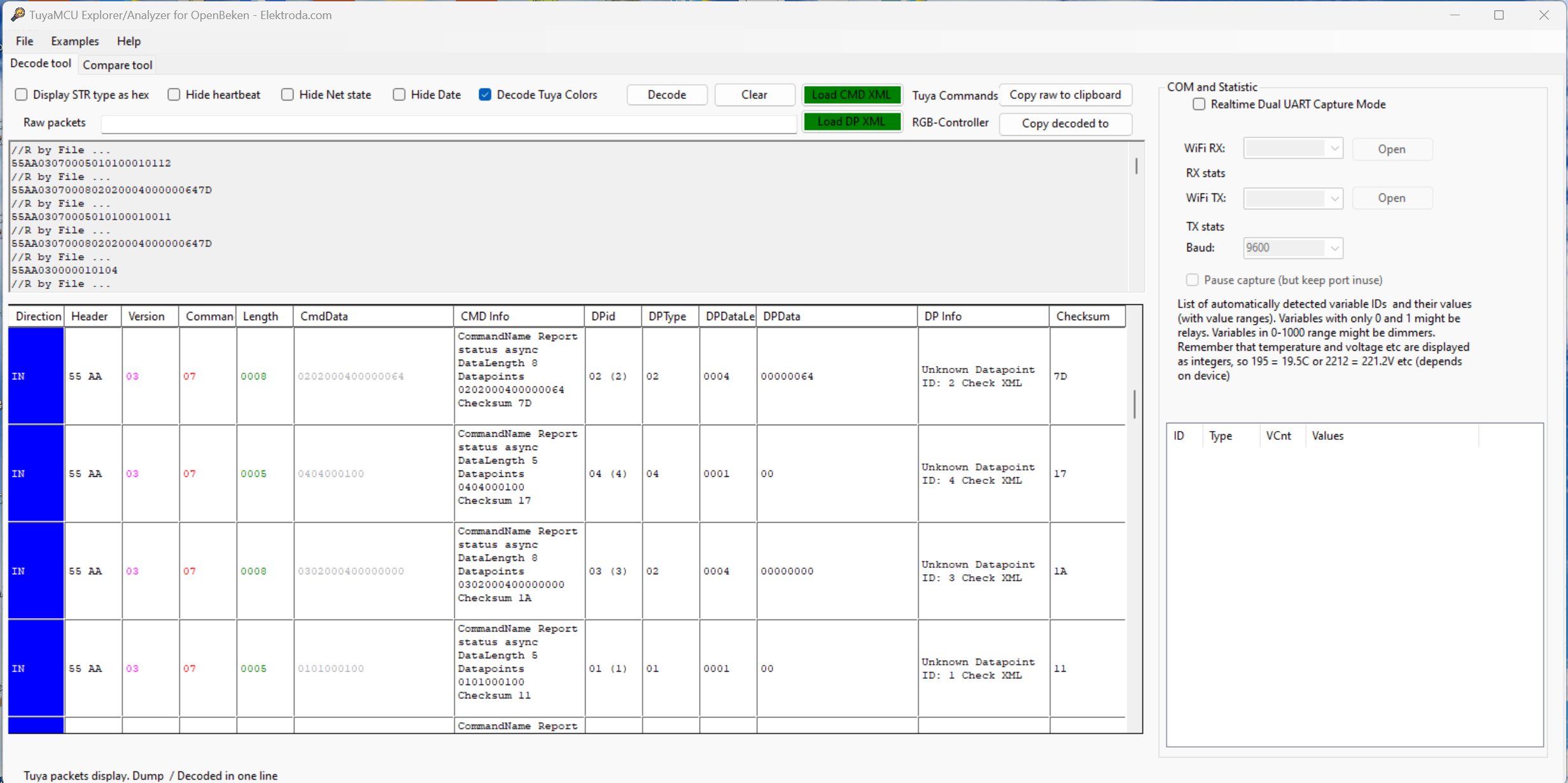

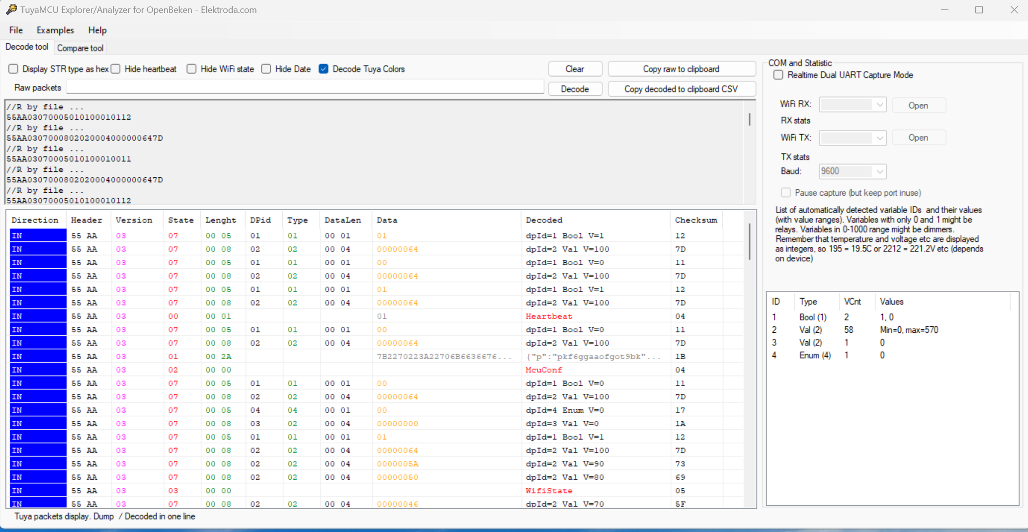

    After running the program, we already have a sample package entered:
    Screenshot of the TuyaMCU Explorer tool for packet data analysis.
    To the field Raw packet data we can paste the hex record of packets captured by, for example, Realterm. The system allows spaces and transitions to the next line between hex codes, this is used to increase readability.
    Field Tuya packets display shows each packet twice - first it breaks its bytes into divisions according to their role and colors them, and below it gives their roles and interpretations.
    Plus a section List of automatically detected variable IDs contains a summary of detected dpIDs along with their captured values. This can help, for example, in determining which value is, for example, the brightness level of the dimmer, i.e. it usually has values from 0 to 1000. On the other hand, the relay states can only be 0 or 1.
    In addition, the program offers a set of sample packages loaded from the folder samples , they are available in this menu:
    Screenshot of TuyaMCU Explorer with a dropdown menu.
    The .bin extension means a binary file, with packets as bytes, while .txt means a text file, where packets are already saved as hex codes (already in ASCII, human readable).
    Also, there is a bookmark Compare tool , which is a tiny tool useful for determining what has changed in the packages when, for example, we changed the color of the lamp (e.g. the Miboxer led strip controller uses TuyaMCU):
    Screenshot of the TuyaMCU Explorer application showing a tool for comparing hexadecimal strings.
    The program treats each line as a separate packet. If the given byte in each line is the same, it is highlighted in green, otherwise it is in red.

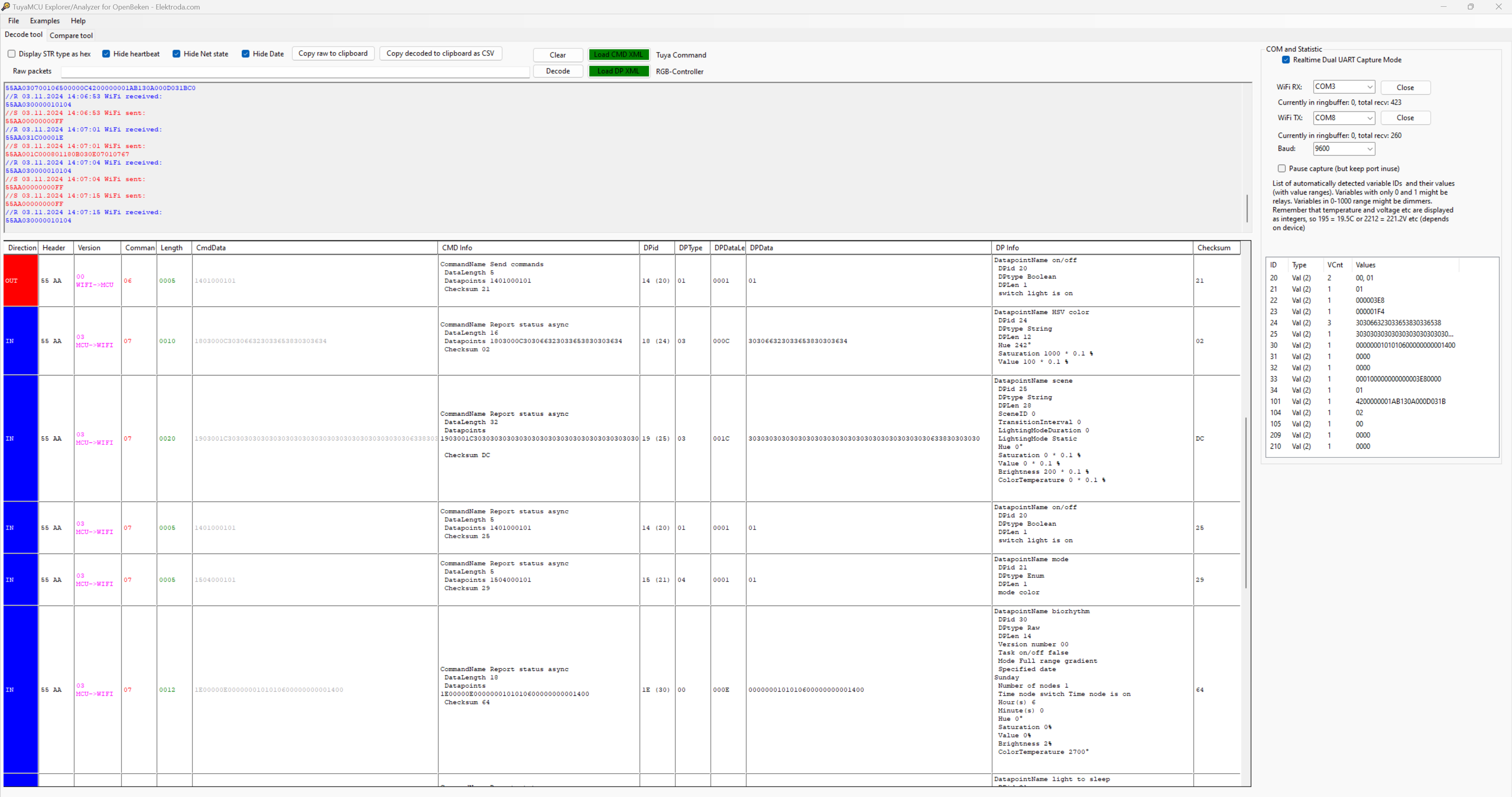

    TuyaMCU analyzer has been updated. The ability to do dual UART capture with two USB dongles has been added. It's not perfect, because sometimes order of request/reply packets is wrong due to the C# SerialPort class handing lag, but we're constantly improving it further. Some misc options like file opening dialog, etc, has been also added.

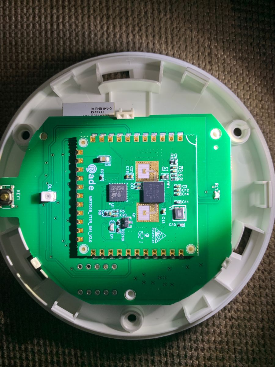

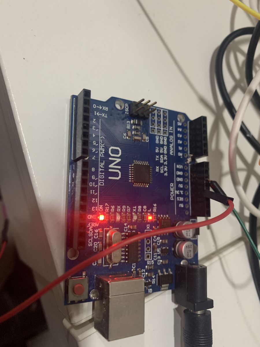

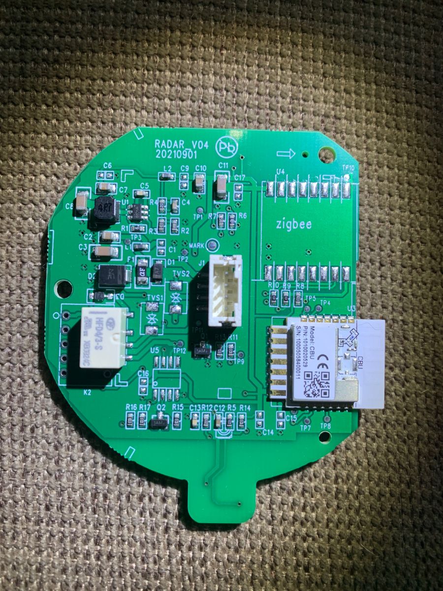

    Hi, I'm not sure if I'm doing it right
    I connect the necessary pins, using arduino uno for 3.3v
    I can see the led lights blinking on the pcb, on the tuya app device is not online
    I can't be sure where to find the input of AMS1117-3.3 on the pcb.

    First of all, you have to press "Change" to apply baud change. You change baud to 9600 in the combobox, but you don't apply change. Please see the marked area in the screenshot:
    TuyaMCU analyzer - UART packet decoder for Tuya devices - dpID detector
  • #7 20630469
    ferbulous
    Posts: 419
    Help: 8
    Rate: 56
    ok, i've changed it this time
  • #8 20630487
    Posts: 14825
    Rate: 13000
    How do you know it's really a TuyaMCU device? You can also try alternate baud: 115200.

    Where did you connect USB to UART converter RX?
  • #11 20630553
    ferbulous
    Posts: 419
    Help: 8
    Rate: 56
    Like this
    UART TX -> CBU RX
    UART RX -> CBU TX
  • #12 20630570
    Posts: 14825
    Rate: 13000
    Where are RX and TX of CBU connected? Please check with multimeter.
    Are you sure that this second module/MCU also gets power? You can check that with multimeter as well.
    Which CBU pins are used on this PCB (except the obvious RX, TX, and power)?
    Do you have 2MB flash backup so I can check for TuyaMCU baud there?
    I'll do that once I have my multimeter
    How do I check on the second module using the multimeter?
    Not yet, probably due to the tx/rx connected another module on the pcb. i'll have to desolder the chip and do a backup from there.

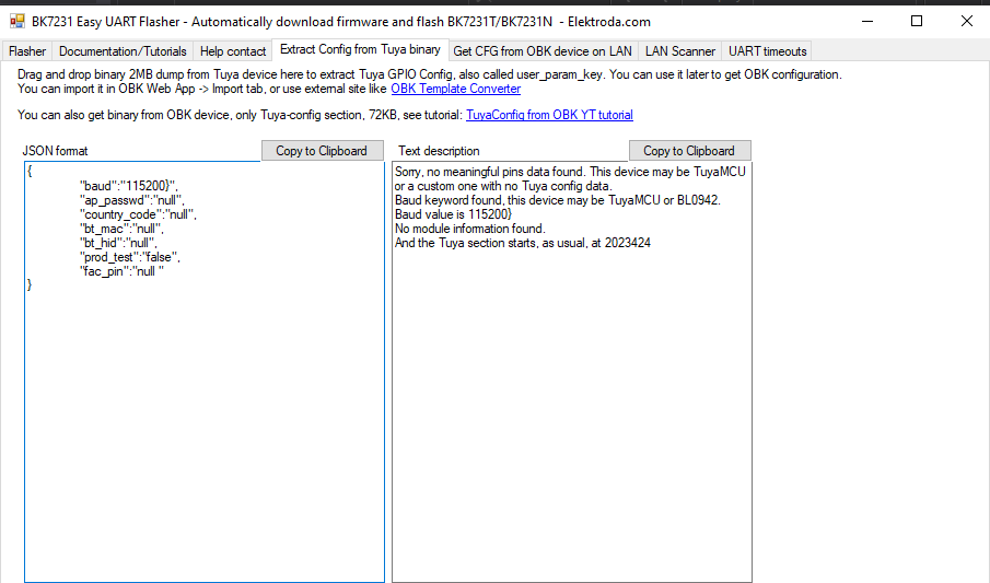

    @p.kaczmarek2 hi, desoldered the chip and this is the backup firmware bin
    • readResult_BK7231N_QIO_radar_2023-26-6--21-21-42.bin (2 MB) You must be logged in to download this attachment.
  • #15 20631789
    Posts: 14825
    Rate: 13000
    It looks like there is a baud setting in this flash:
    So there is a fair chance it's a TuyaMCU.
    Maybe the second module is not powered or something. How is it powered? Or maybe it's like a battery powered device, where second module only sometimes enables wifi module power to report data to cloud. We need more information.

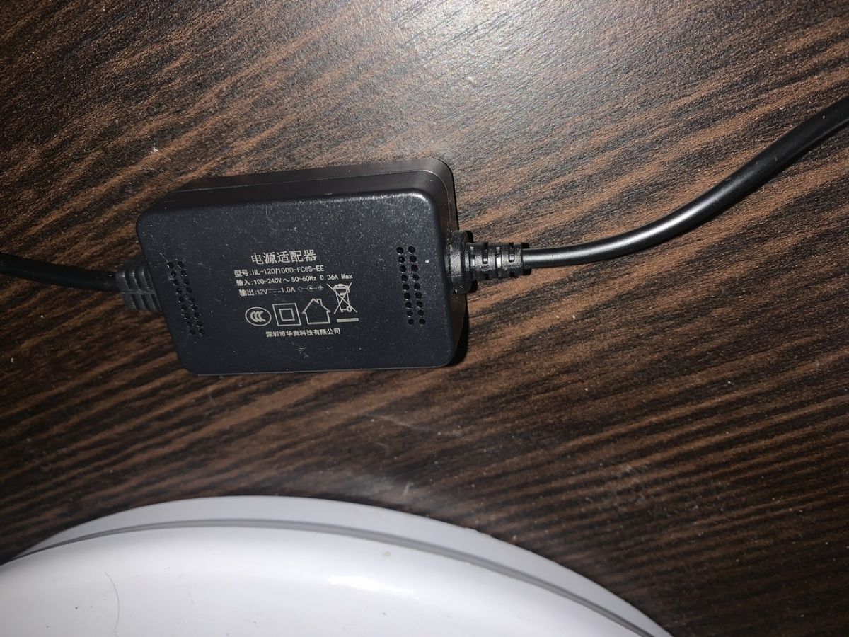

    Well, to be honest, if your power supply is an isolated one, then there should be no problems. The question is, is your power supply an isolated one.
    Also, maybe your device would work if you were to connect USB 5V to 12V input? If there is a step down converter, then it should work.
    Maybe you can also check the circuit. Why do they use 12V and not 5V there? That's interesting.

    Also since there’s 2 pads on the pcb, the second pad for zigbee chip with cbu pinout.
    Could i just solder:
    1st pad - cbu with tuya firmware
    2nd pad - another cbu with openbk
    Then i check the dpid using the openbk web ui and compare the values with the tuya app. If it’s possible

    It depends on the power supply inside. Flybacks have isolation, and bucks do not.
    Using another OBK for that is planned but I am not sure if it will work at the moment.
    Okay, back to the main topic... I am updating the analyzer:
    TuyaMCU Explorer/Analyzer interface displaying data packet analysis.

    TuyaMCU analyzer version 0.4 is released - https://github.com/openshwprojects/TuyaMCUAnalyzer/releases
    Improvements:
    - added ability to hide heartbeat packets
    - decoding colors is available now for tuyaMCU controlled lights
    - strings can now be shown as HEX or ASCII
    - app window can now be maximized

    #24 21277196
    theosoft
    Posts: 37
    I do have changed some things.
    Decoded window now as list.
    Windows do have a movable splitter
    Handling on decoding messages.
    Anti flickering
    Date filter added.
    Layout & font changed.
    TuyaMCU Explorer/Analyzer interface with visible data packets

    Posts: 5256
    Help: 451
    Rate: 924
    cool. I like it. It's easier to read and the refresh/flickering was annoying.
    there's a typo - Lenght=Length
    and is "//R by file ..." the equivalent of "Received by WiFi module:"?
  • #26 21277215
    theosoft
    Posts: 37
    >>21277208
    Typo fixed :-)
    And yes. But is more to keep the same decoding machine.....
