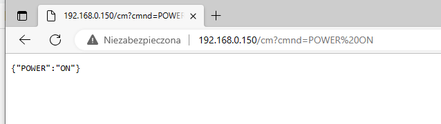

    We send the command itself via HTTP GET, for example:
    http://192.168.0.201/cm?cmnd=POWER%20ON
    It is a POWER command with an ON argument, i.e. switching on a relay or lighting a lamp.
    Then the device returns JSON:

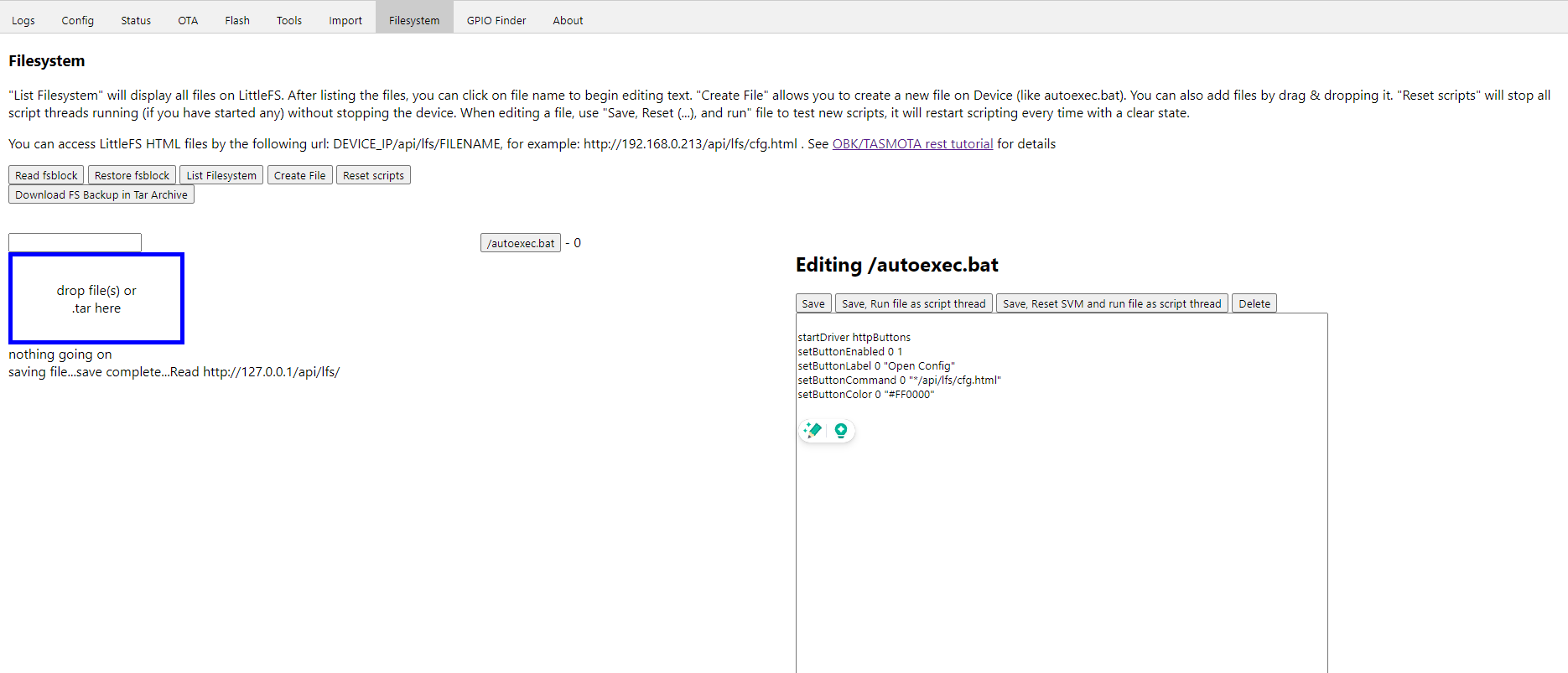

    LittleFS file system on OpenBeken
    The LittleFS file system is available from the Web App panel, i.e. a panel that is itself downloaded from Github and communicates with the IoT device itself via the REST interface. Of course, it doesn't mean that you won't be able to access this panel without the Internet - if you want, you can host its sources in your network and simply change their address in the OBK configuration.
    We open the Web Panel:
    OpenBeken as a mini HTTP hosting - writing pages in Javascript, Tasmota REST
    We open the LittleFS tab:
    Here is the file system interface:
    Create creates a new file, List refreshes their list.
    Here we can create autoexec.bat (which is executed at the beginning), any other scripts for the startScript command, and just HTML files and scripts.
    We can also drag existing files onto the field

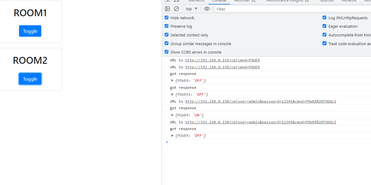

    			let baseURL = "http://192.168.0.210";
    It allows me to run it on Windows, which is basically anywhere, because it sets the IP of the device. When uploading a device to LittleFS, this variable should be an empty string.

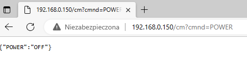

    According to Tasmota's documentation, POWER without an argument will only return the current state, and with an argument (ON, OFF or Toggle) it will change it.
    You can test this in a browser:

  • Button link to LittleFS page via httpButtons
    #4 20626417
    Posts: 14751
    Rate: 12871

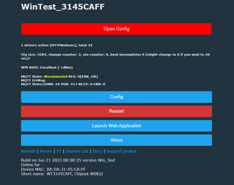

    UPDATE:
    If you want to make a button link to LittleFS on latest OBK version, do:
    startDriver httpButtons
    setButtonEnabled 0 1
    setButtonLabel 0 "Open Config"
    setButtonCommand 0 "*/api/lfs/cfg.html"
    setButtonColor 0 "#FF0000"
    The * marks that command is not OBK script command, but an URL and it will treated as such. Without *, it is treated as command to execute on OBK console:
    It will make a button on main page opening given link:

    I have tried my best to keep my examples compatible with Tasmota, although OpenBeken features some more advanced API which is useful for handling TuyaMCU devices. @DeDaMrAz knows some more about it, as I have written an interface for his radar sensor. The code for his sensor will not work with Tasmota, as Tasmota doesn't even provide direct access to TuyaMCU dpIDs, as far as I know.
    The window.onload function is Javascript function, it doesn't have anything to do with Tasmota or OBK. You are most likely referring to REST API call that is done in window.onload.

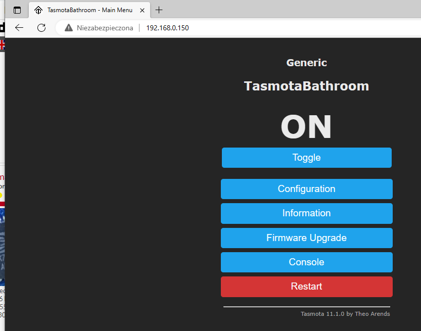

    Regarding the sendPower code, best way to test it is to use web browser. First, without argument:
    Then, with argument:
    To be clear, it's a Tasmota device:
    If it works with browser, then it must work in code, unless you have some kind of mistake in the script. The POWER sending sample I think is in the first post of this topic.
    Let me know if you need any REST javascript code examples for either OpenBeken or Tasmota. If you give me details, I can write a simple Javascript sample for you.

    Thanks , I already modified the code found on the git...
    This is my modified code:
    First is OpenBeken
    Second is Tasmota.
    "Onload" state of the Tasmota device doesn't get updated (2nd button stay blue) .
    user and pass are correct. tried even without user and pass. still no luck.
    I dont know what to do next.. tried everything
    Code: Javascript
    When I change the 2nd device to OpenBeken its all working fine.

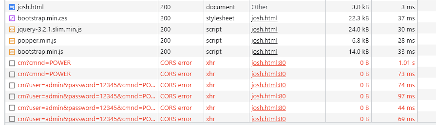

  • Tasmota now enforces CORS on REST requests
    #10 20628733
    Posts: 14751
    Rate: 12871

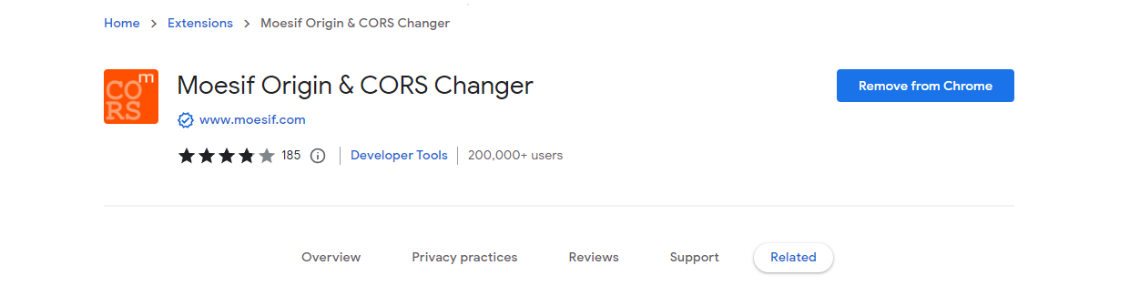

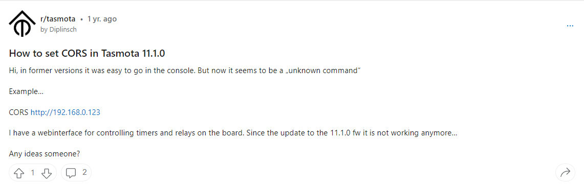

    It looks like Tasmota has changed something recently. They are enforcing CORS policy now. I've found a related Reddit thread:
    You can see that in the connections of Chrome inspector:
    I've checked some Github threads for a SetOption setting for that, but I've found none so far. Of course it could be fixed with recompiling Tasmota, but it's not a perfect solution.
    I have tested it with latest Tasmota device and I can confirm there is a problem. I have currently fixed it by using Chrome extension:
    called "Moesif Origin & CORS Changer" but I don't like using Chrome extensions, they may be a vulnerability thread. I will try to find another solution if possible.
