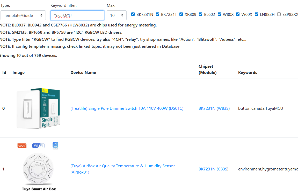

    - open our devices list, tick "detailed" checkbox and search for "TuyaMCU", read the found teardowns

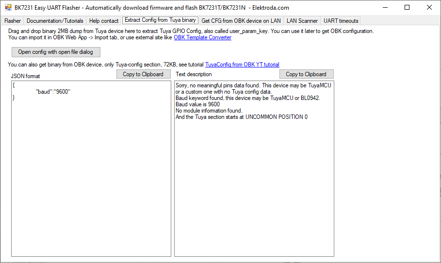

    2. Determine baud setting
    The best way to find out baud setting is to use our flash tool: our flasher, just get a 2MB flash backup of device taken by UART or just download Tuya config partition via Tuya config extraction in OBK and drag and drop it on the flasher:
    BK7231 Easy UART Flasher interface with settings and TuyaMCU device information
    TuyaMCU baud rates are 9600 (default) and 115200 (high speed)

    - you can also search our devices list for similiar devices, maybe some dpID are matching

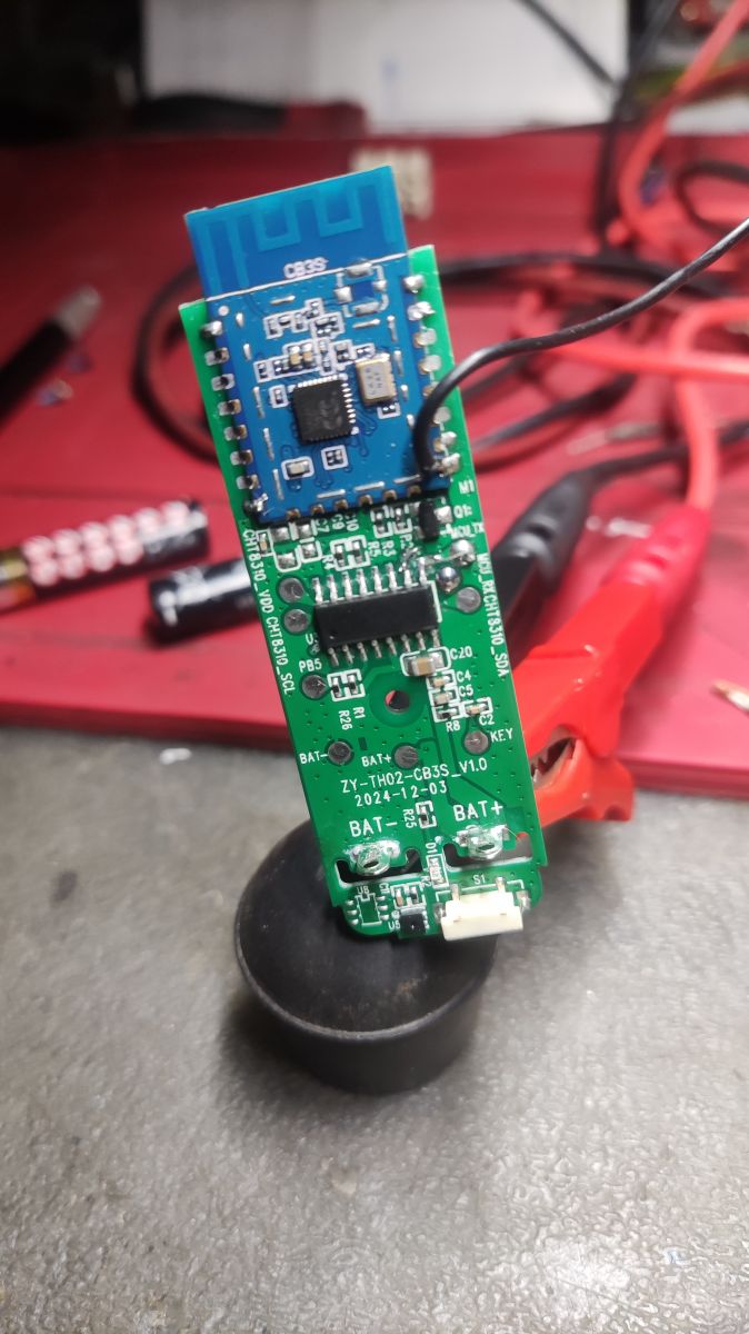

    Battery powered TuyaMCU devices are special - the MCU controls the power of WiFi module there. MCU only enables WiFi module when it needs to report data. This requires a special driver called tmSensor.
    Please see a sample tmSensor guide for more information:
    Energy-saving (?) Battery-operated door / window sensor for WiFi DS06
    [CB3S/BK7231N] Temperature/Humidity Sensor with TuyaMCU - Diagram, Reverse Enginering

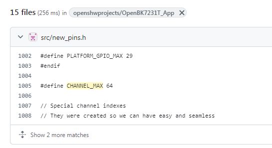

    Channel numbers greater than 99 seem not to be supported. I tried to use 101 and 102, as these were my corresponding dpID's, but the controls were not displayed in GUI until I changed channel number to 7 and 8.
  • #5 21229830
    Posts: 14755
    Rate: 12877
    There are 64 available channels in OBK:
    Code snippet in the new_pins.h file showing that 64 channels are available in the OpenBK7231T_App project.

    Close-up of a green PCB with a blue electronic module mounted on it.

  • TuyaMCUAnalyzer channel mapping fixed sensor setup
    #14 21443445
    doudouni100
    Level 4  
    Posts: 7
    >>21443231
    Hey !
    Your probably right ! It makes sense.
    After trying everything I found on this forum and others with no success, I thought I'd give it a go myself and also learn something on the way.
    The "startDriver tmSensor" was there from my previous tries and I didn't question it because what do I know :)
    Once I found the proper channels with TuyaMCUAnalyzer for temp, humidity and battery I just plugged those numbers in the previous autoexec and It worked !
    I cant imagine it will do it any harm and since it is battery powered I'm not going to take it apart and try it .
    Or maybe my curiosity will win and I will take it apart now that you mentioned it :)

    At first, I thought EasyFlasher was the tool of choice for PINs and MCUs. I always thought if the tool couldn't extract PINs, then it was an MCU device. But that can't be true, since I bought seven different smart sockets with metering functions from Aliexpress. The tool only extracted PINs for one of them (the one from Aubess). However, since I got the other smart plugs to work exclusively with PIN assignments using https://openbekeniot.github.io/webapp/devicesList.html, the EasyFlasher now tells me very little about them.
    Regarding the question: Is an MCU installed? How do you recognize an MCU? Without training in microelectronics, a layperson can't tell whether, for example, a BL0937 imprint is an MCU or not.
    The EasyFlasher has never shown me a baud setting when trying to extract PINs.
    In addition to the smart plugs, I also bought a collection of battery-operated Tuya devices. Included are the "TH08B" temperature and humidity sensor, the "TH01" motion sensor, the "P01" motion sensor, the "HW400B" motion sensor (round, USB-C connector), the "WiFi Carbon Monoxide Detector" with display, and a "Smart Air Box" (measures 5 different values ​​in the air).
    Can I assume that all battery-operated Tuya devices are TuyaMCU devices?
    Are there also mixed devices that use PINs and TuyaMCU? Then, as a layperson, I could work by the process of elimination. If PINs are mentioned in the device list—even if it's just one—then I can be sure that TuyaMCU is no longer an issue.
    What about devices that use eWeLink or CozyLife software? Do these always use PINs?
    Did I understand correctly that the device overview at https://openbekeniot.github.io/webapp/devicesList.html only helps with devices that use PINs, not with TuyaMCU?
    This overview is also the basis for the WebApp -> Config.
    A layman like me reads, after installing OBK, that all he has to do is select the corresponding device, click "Copy Device Settings," then click "Save PINs" and "Save Types," and then he's done.
    After that worked with the smart plugs, I did the same with the TH08B, the TH01, and the P01 and was surprised that nothing worked.
    If a device is a TuyaMCU device, I have to work with the TuyaMCU Analyzer. As I've seen, the tool can now also read RX and TX directly, and you no longer need RealTerm.
    I tried it directly with the TB08B and failed, see attachment.
    I have to measure RX1 and TX1 with the tool, i.e., the points where I also flash OBK, right?
    If it founds no pins, but founds a baud rate, there is a fair chance the device is a TuyaMCU.[/quote]
    This list contains all devices. There are also TuyaMCU devices there:
    TuyaMCU flashing, setup and configuration guide - configure dpIDs for Home Assistant
    It's just that in case of them, you need to open linked topic and find autoexec.bat
    Fair point, maybe we need to add a message or a better mechanism for that, but basically for TuyaMCU devices you need to open linked device topic on Elektroda and find matching autoexec.bat and try to import and run that.
    Keep in mind that Tuya might change something in a meantime, so it's good to have basic underestanding of the TuyaMCU. And you can always ask on forum.
    We can't automatically download autoexec.bat to LittleFS because Github pages are HTTPS only and OBK doesn't have HTTPS (TLS) built in in main release. That's why you need to copy it manually. We could have done it only through Web App.... I will think about it.
    Yes, but never measure when device is connected to mains!!! This may short 230V to your PC!!! You can also skip connecting and use other method to get dpIDs:
