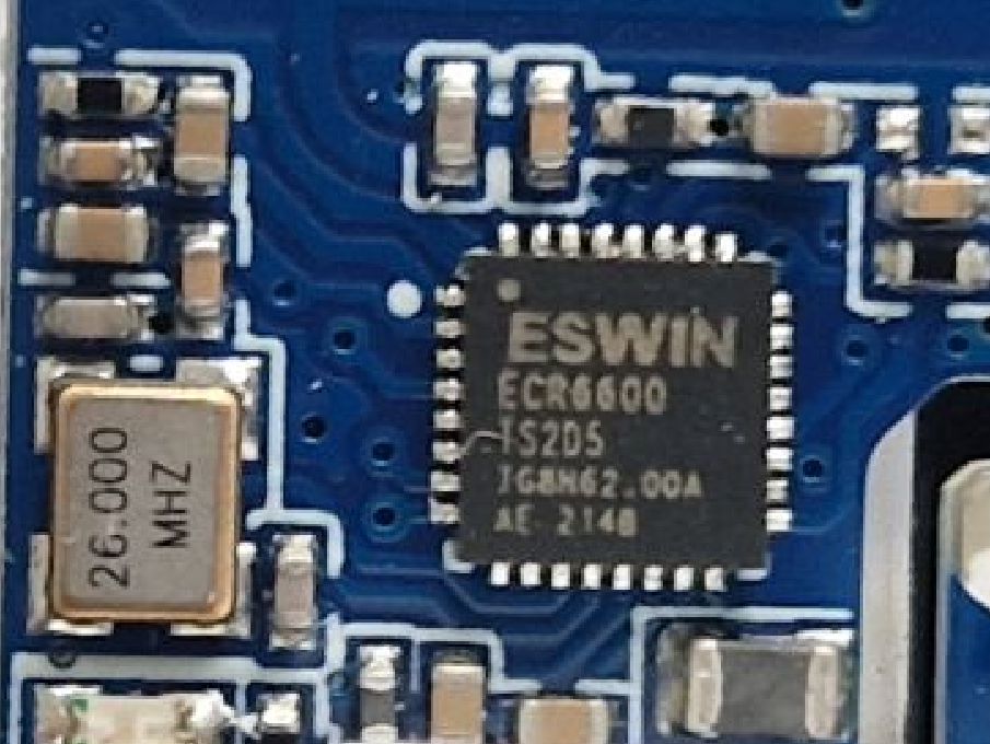

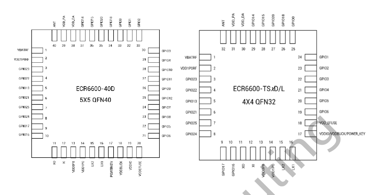

ECR6600 can be found in two surface-mount packages, ECR6600-40D (5x5 QFN40), and ECR6600-TSxD/L (4x4 QFN32):
Diagrams of two ECR6600 integrated circuits in QFN40 and QFN32 packages.
See the table for the full list of variants:
VariantPackaging
ECR6600-40DQFN40 5x5
ECR6600-TS2DQFN32 4x4
ECR6600-TS2LQFN32 4x4
ECR6600-TS4DQFN32 4x4
ECR6600-TS4LQFN32 4x4

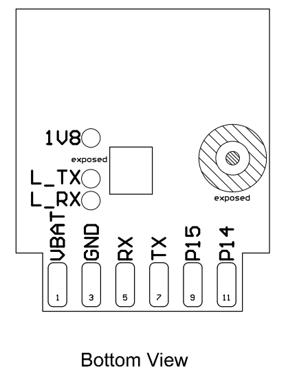

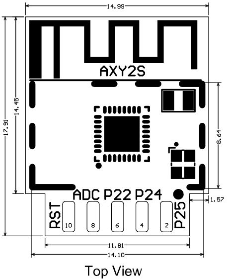

ECR6600 can be found in a form of some Tuya modules, for example, AXY2S, which is similar to Beken-based CB2S, WB2S or ESP8266-based TYWE2S.
Top view schematic of an electronic module.
Bottom view of a PCB with pin labels.
Pinout:
Pin number Symbol Type Function
1 VBAT P Power supply pin (3.3V)
2 P25 I/O GPIO_25, hardware PWM, correspond to Pin 7 of the IC
3 GND P Power supply reference ground
4 P24 I/O GPIO_24, hardware PWM, correspond to Pin 8 of the IC
5 RX I/O GPIO_5, UART0_RXD (user serial interface)
6 P22 I/O GPIO_22, hardware PWM, Pin 4 of the IC
7 TX I/O GPIO_6, UART0_TXD (user serial interface)
8 ADC AI GPIO_20, common GPIO, which can be used as ADC. The range of input voltage is 0 to 3.3V. Correspond to Pin 27 of the IC.
9 P15 I/O GPIO_15, hardware PWM, Pin 28 of the IC
10 RST I/O Reset pin, reset at a low level. The module has been pulled to a high level and the user can control the pin externally.
11 P14 I/O GPIO_14, hardware PWM, correspond to Pin 29 of the IC

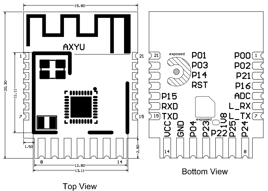

Another similar module is AXYU, which is in form of a well-known CBU.
Technical drawing of an electronic module with top and bottom views.
Pinout:
1 P00 I/O GPIO_00, common GPIO, which can be reused as SPI_SCK and corresponds to Pin 25 of the IC
2 P02 I/O GPIO_02, common GPIO, which can be reused as SPI_MOSI and corresponds to Pin 23 of the IC
3 P21 I/O GPIO_21, common GPIO, correspond to Pin 6 of the IC
4 P16 I/O GPIO_16, common GPIO, correspond to Pin 10 of the IC
5 ADC I/O GPIO_20, common GPIO, which can be used as ADC. The range of input voltage is 0 to 3.3V. Correspond to Pin 27 of the IC.
6 L_RX I/O GPIO_17, UART_Log_RXD (used to receive information about the external logs of the module), which can be configured as a common GPIO
7 L_TX I/O GPIO_13, UART_Log_TXD (used to send information about the internal logs of the module), which can be configured as a common GPIO
8 P24 I/O GPIO_24, hardware PWM, correspond to Pin 8 of the IC
9 P25 I/O GPIO_25, hardware PWM, correspond to Pin 7 of the IC
10 P22 I/O GPIO_22, hardware PWM, correspond to Pin 4 of the IC
11 P23 I/O GPIO_23, hardware PWM, correspond to Pin 3 of the IC
12 P04 I/O GPIO_04, hardware PWM, correspond to Pin 21 of the IC
13 GND P Power supply reference ground
14 VCC P Power supply pin (3.3V)
15 TXD I/O GPIO_6, UART0_TXD (user serial interface)
16 RXD I/O GPIO_5, UART0_RXD (user serial interface)
17 P15 I/O GPIO_15, common GPIO, correspond to Pin 28 of the IC
18 RST I/O Reset pin, reset at low level. The module has been pulled to a high level and the user can control the pin externally.
19 P14 I/O GPIO_14, common GPIO, correspond to Pin 29 of the IC
20 P03 I/O GPIO_03, common GPIO, which can be reused as SPI_MISO and corresponds to Pin 22 of the IC
21 P01 I/O GPIO_01, common GPIO, which can be reused as SPI_CS and corresponds to Pin 24 of the IC

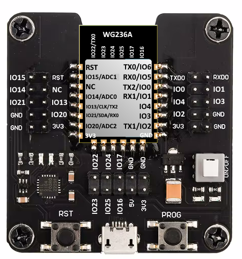

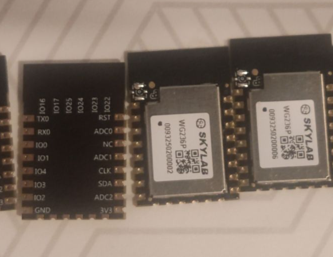

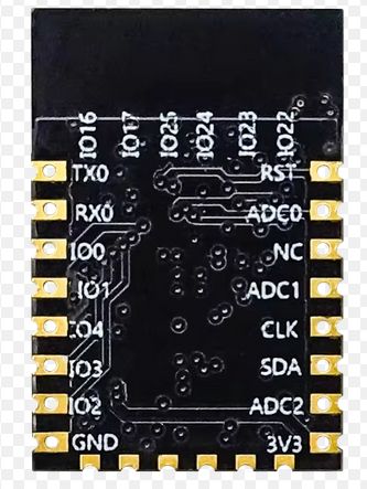

Of course, there are also non-Tuya ECR6600 modules, for example, WG236, which is in form similar to ESP12 or CB3S/WB3S/TYWE3S:
Electronic modules with SKYLAB labels and designations.
Electronic module with connectors and labeled pins.

For the flashing, there are just few important pins:
- IO6/TX0 - programming port
- IO5/RX0 - programming port
- IO13/TX2 - boot log output - 115200 baud - use it to check if firmware boots correctly
You may also need RST and obviously power pins (GND and 3.3V).
Connection requirements
ECR6600 connection for flashing is very similar to Beken - there is no GPIO0 like on ESP, you just need to reset when prompted.
This procedure was tested with a WG236 module using an ESP adapter, but it should work with any ECR chip.
Electronic module with pin labels and connectors.
So, solder to GND, VCC and TX0 (GPIO6) and RX0 (GPIO5) according to however real device allows this if possible. Also preferably RST pin, so you can do reboot.

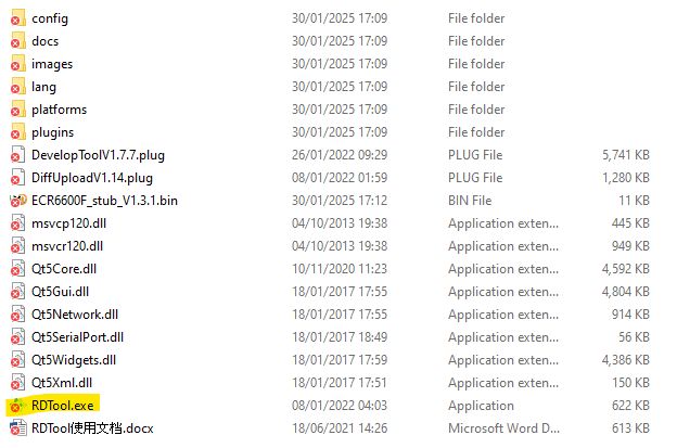

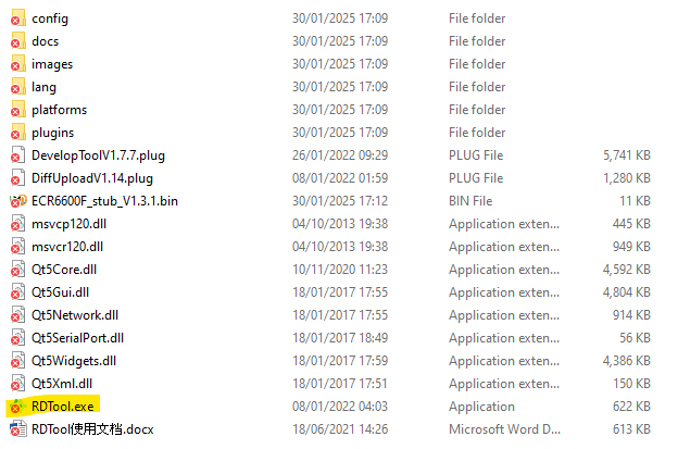

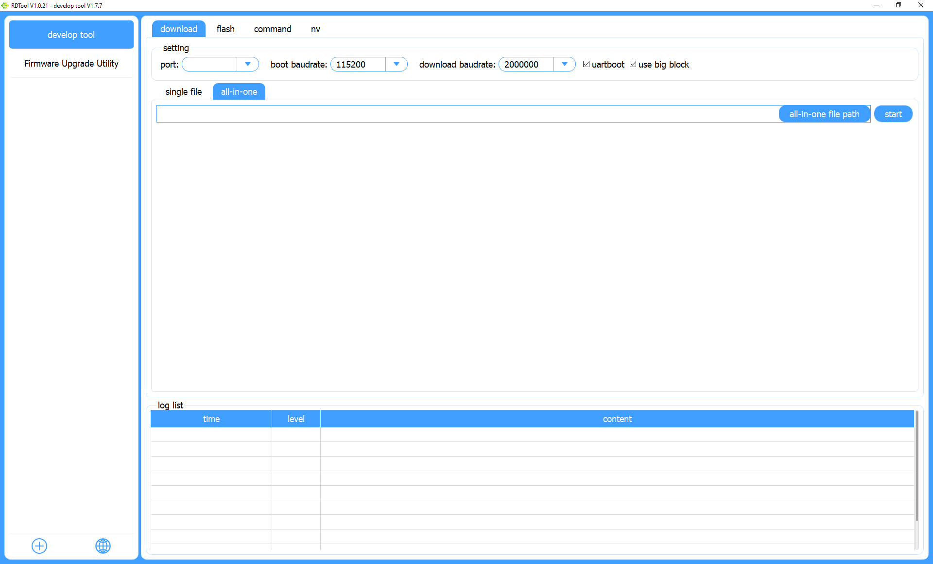

So, to backup the firmware - start by running the ESWIN RDTool.exe program after downloading and unzipping ESWIN_ECR6600_RDTool_v1.0.21.zip from https://github.com/openshwprojects/FlashTools/tree/main/TransaSemi-ESWIN
Screenshot showing the contents of a folder with files and subfolders in a file manager.

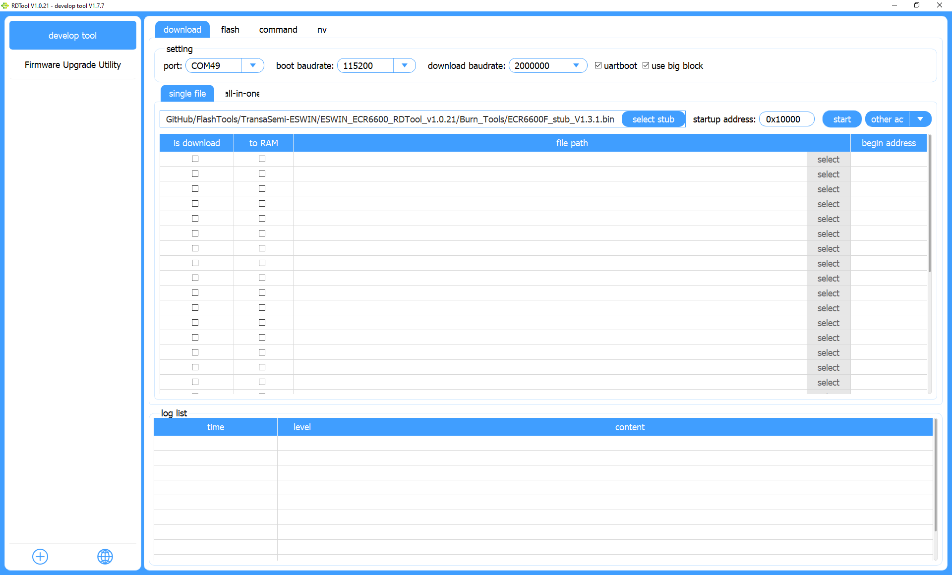

When loaded double-click the develop tool plugin.

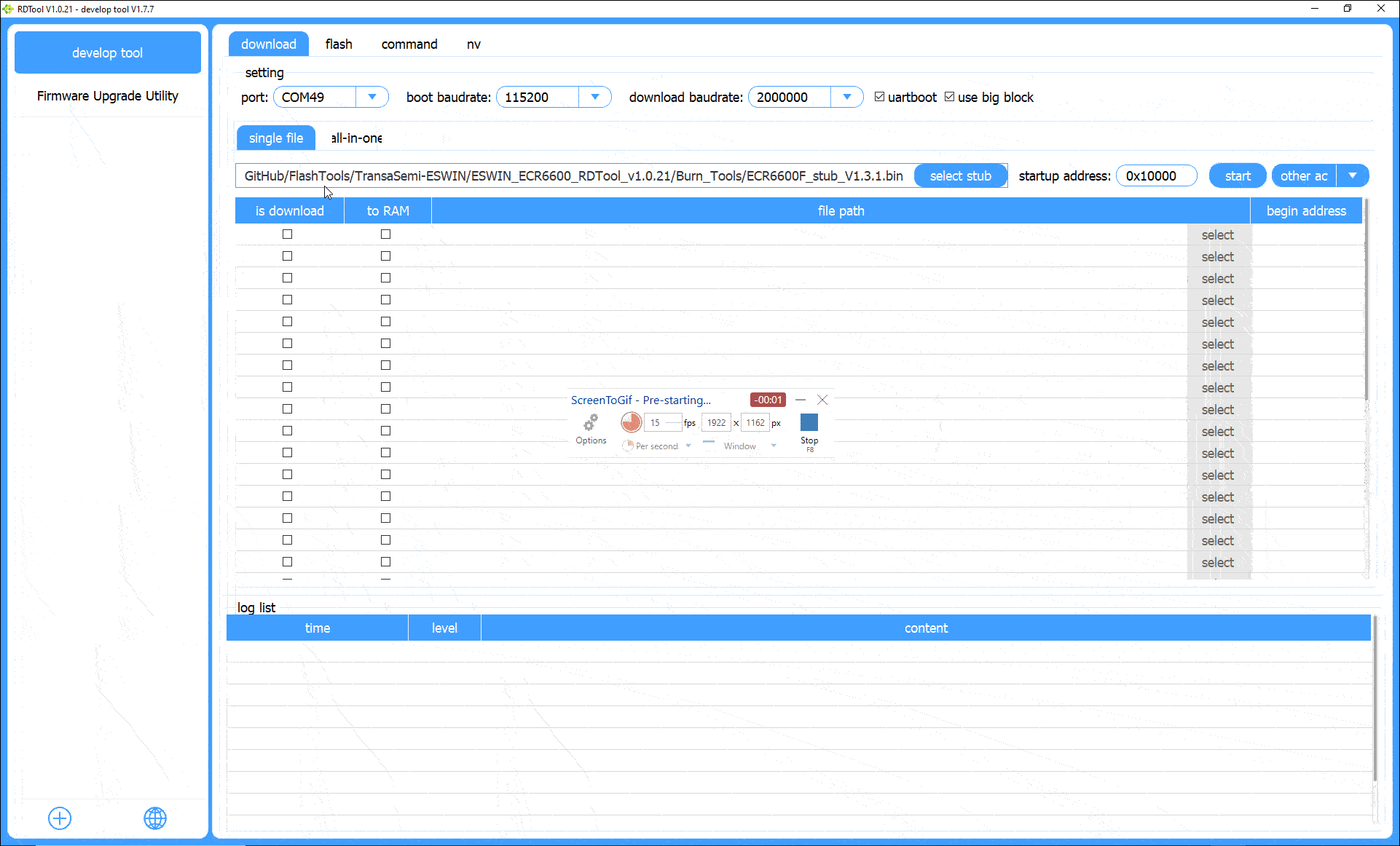

Screenshot of a firmware upgrade tool.
Select the single file tab and choose the file ECR6600F_stub_V1.3.1.bin from the unzipped files in the open dialog box after clicking select stub.
Ensure the startup address is 0x10000 and select the correct COM port
Screenshot of a firmware upgrade tool program with a list of settings and files.
At the moment you hit start, reset (ground CEN/RST) or power-on 3.3V to the device. The window of opportunity is very small so timing is crucial.
Screenshot of a firmware upgrade tool with various configuration options.

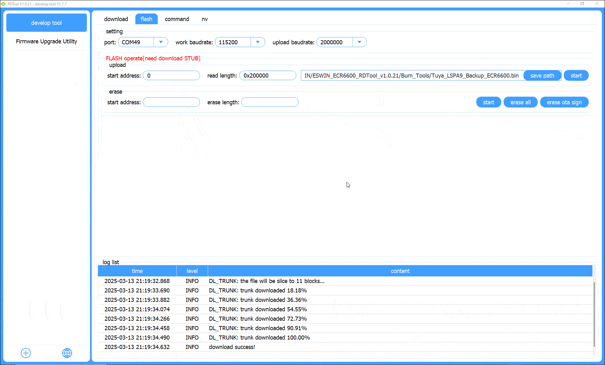

Switch to the flash tab, choose port again and enter start address of 0 and read length of 0x400000 or 0x200000, depending on your chip flash size (4MB or 2MB). If not sure, first try 0x400000, then, in case of "FLASH is not enough!" error, fall back to 0x200000. Select save path and give your backup an informative name eg; Tuya_LSPA9_Backup_ECR6600.bin. Click start next to save path to begin device flash backup to file.
Screenshot of firmware upgrade software with progress logs.
Once backup is done, please consider sharing it with us, but be aware - it will contain your SSID and other data after pairing, so better backup firmware before connecting device to the cloud.

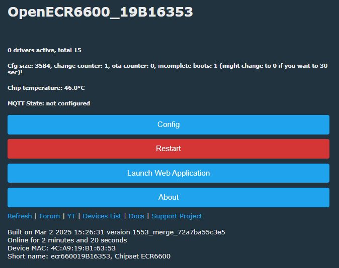

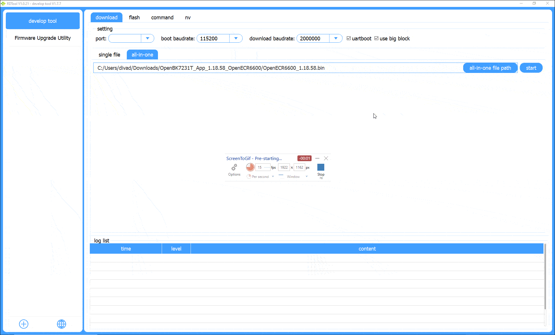

Flashing new firmware - OpenECR6600
Run RDTool as above, go to the develop tool plugin but navigate to all-in-one on the download tab. Download the latest OpenECR600 UART flash binary from the release page https://github.com/openshwprojects/OpenBK7231T_App/releases/
Choose the downloaded file after selecting all-in-one file path. Click start and perform CEN/RST or power-on quickly, just like with the backup.
Flashing OBK does not require the same stub step that backup requires.
Animation showing a firmware update tool interface.

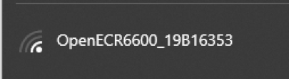

Reboot by doing power off and power on cycle. The device WiFi access point should appear, just like with Tasmota, connect to it and visit configuration page to proceed. Everything as usual.
Wi-Fi network name OpenECR6600_19B16353 with signal icon.
Screenshot of the OpenECR6600 device management interface.
At the time of writing (March 2025), our firmware release for this platform is a WIP testing version, so there still may be imperfections, but we'll try to increase the stability soon...
