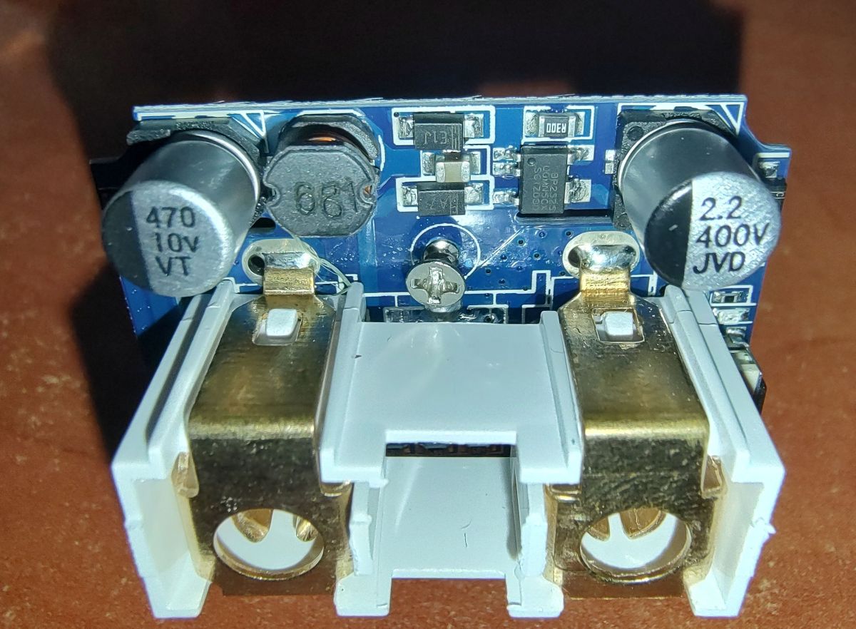

    Bought another smart plug hoping for BL0942 as reported recently in the forum, but got something else...
    From Here

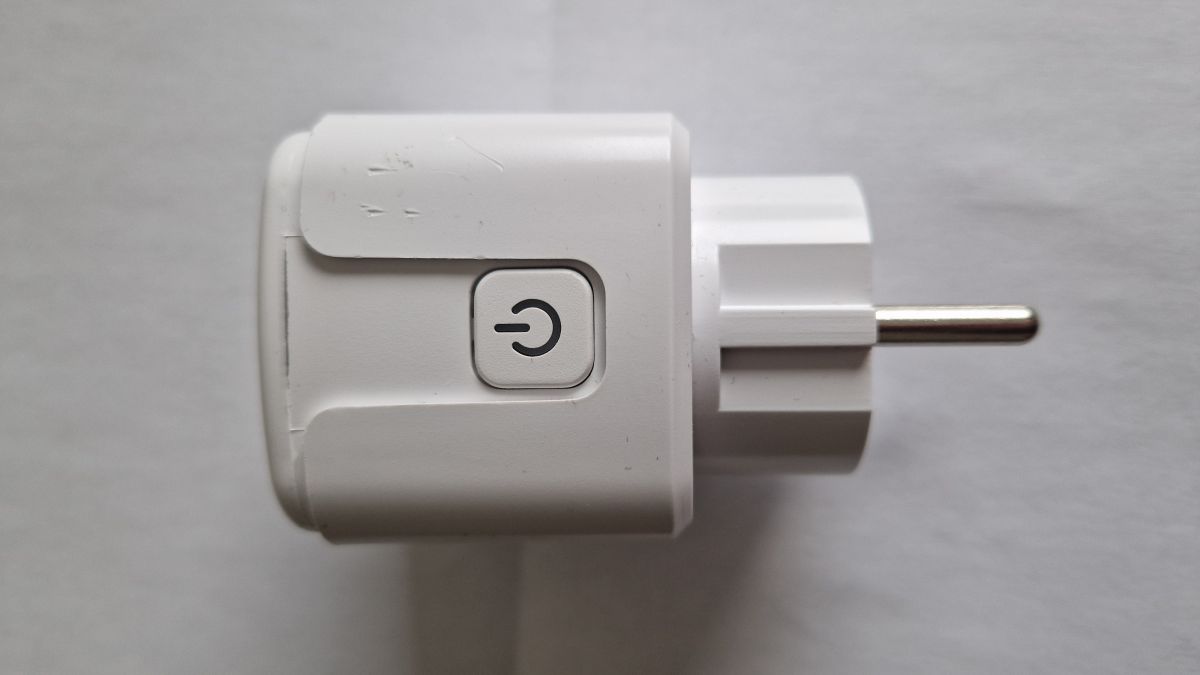

    Typical plug appearance, no markings on outside
    White smart plug with a power button on the side.

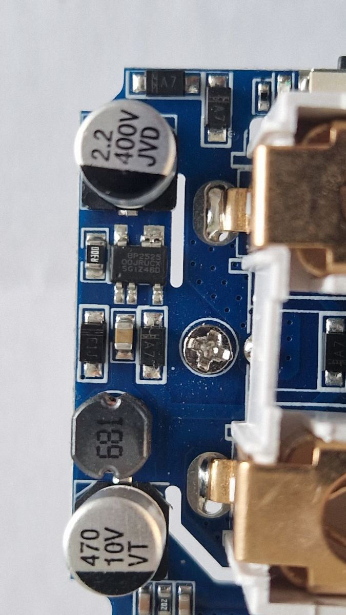

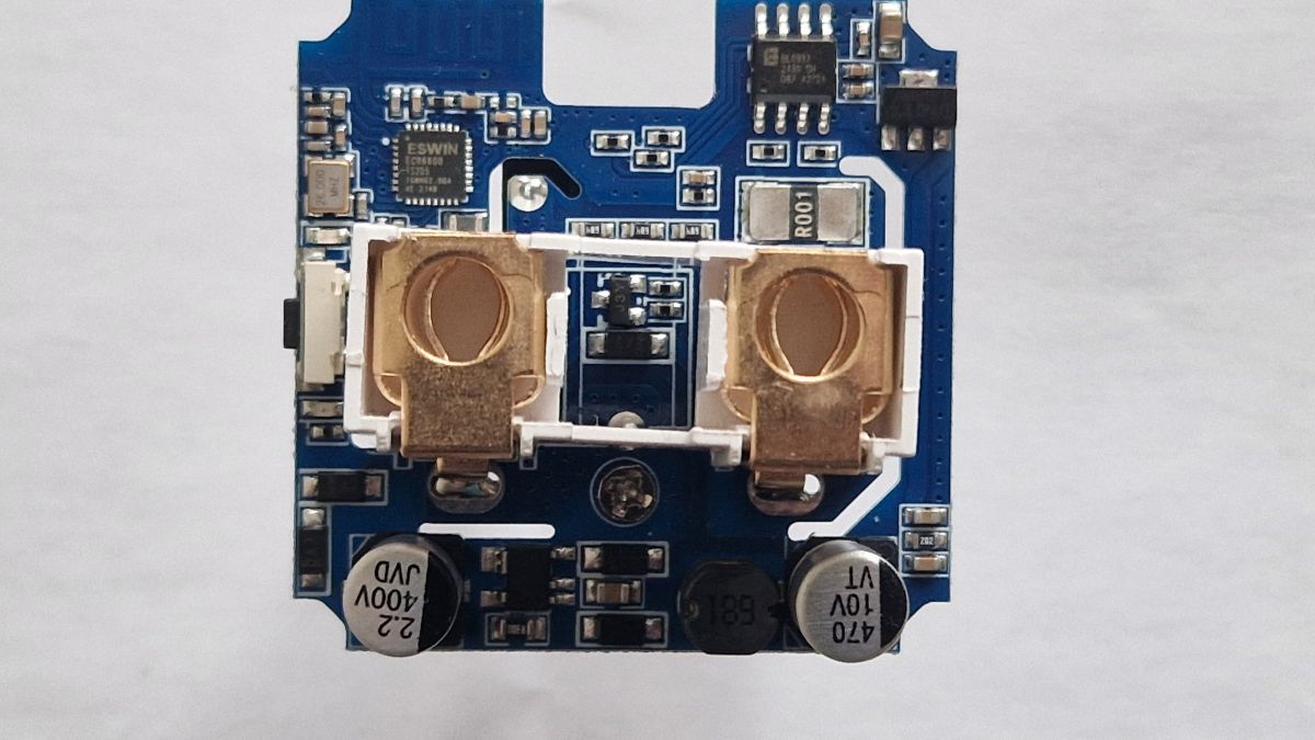

    Better polymer capacitors maybe, but no fusible resistor or MOV, but two LEDs
    Image of a smart plug's printed circuit board with various electronic components.

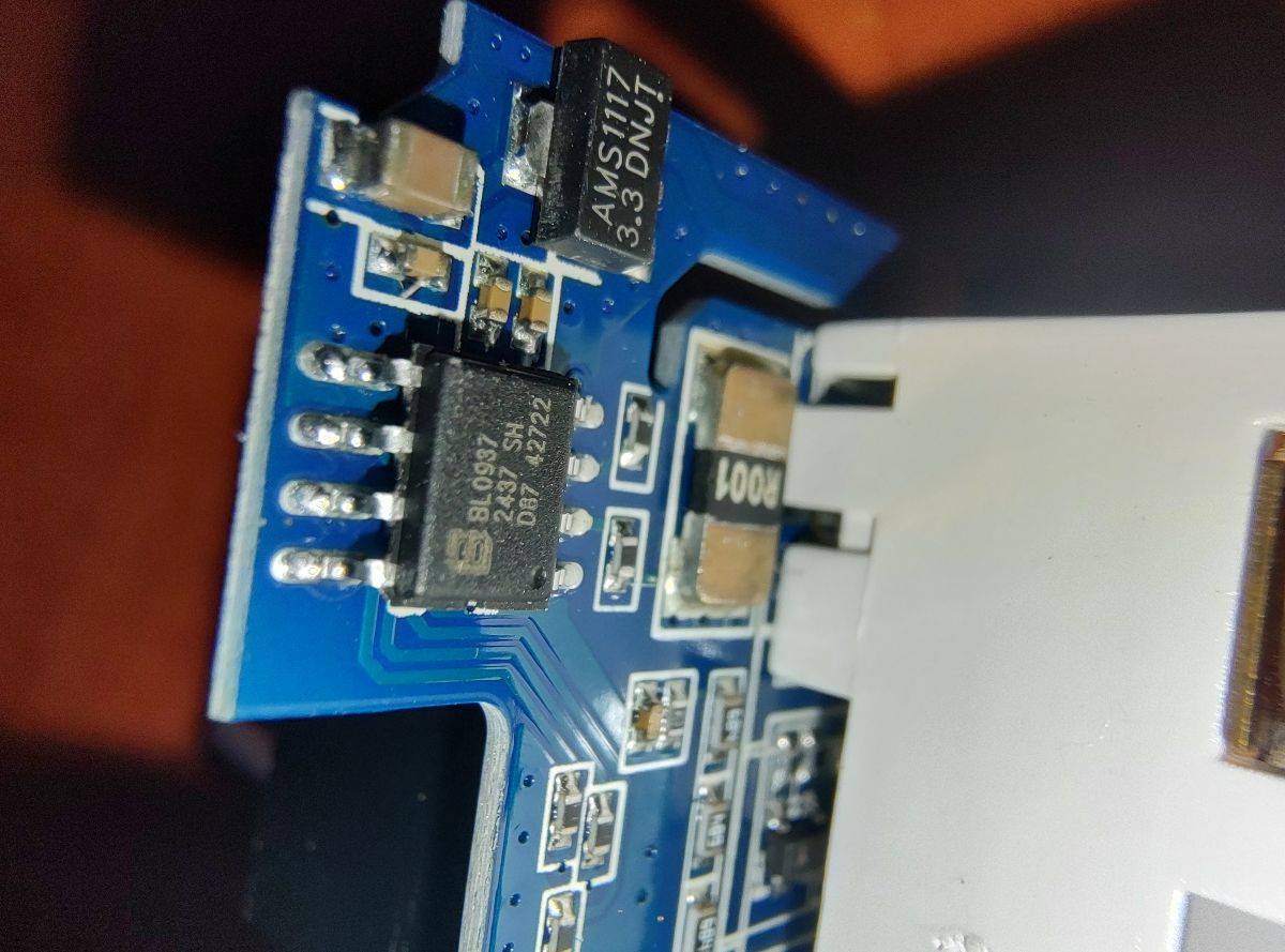

    Usual BP2525, BL0937, and AMS1117 (hardly visible)
    Close-up of the interior of a smart plug showing electronic components such as capacitors and transistors.
    Close-up of a circuit board showing electronic components, including a BL0937 chip.

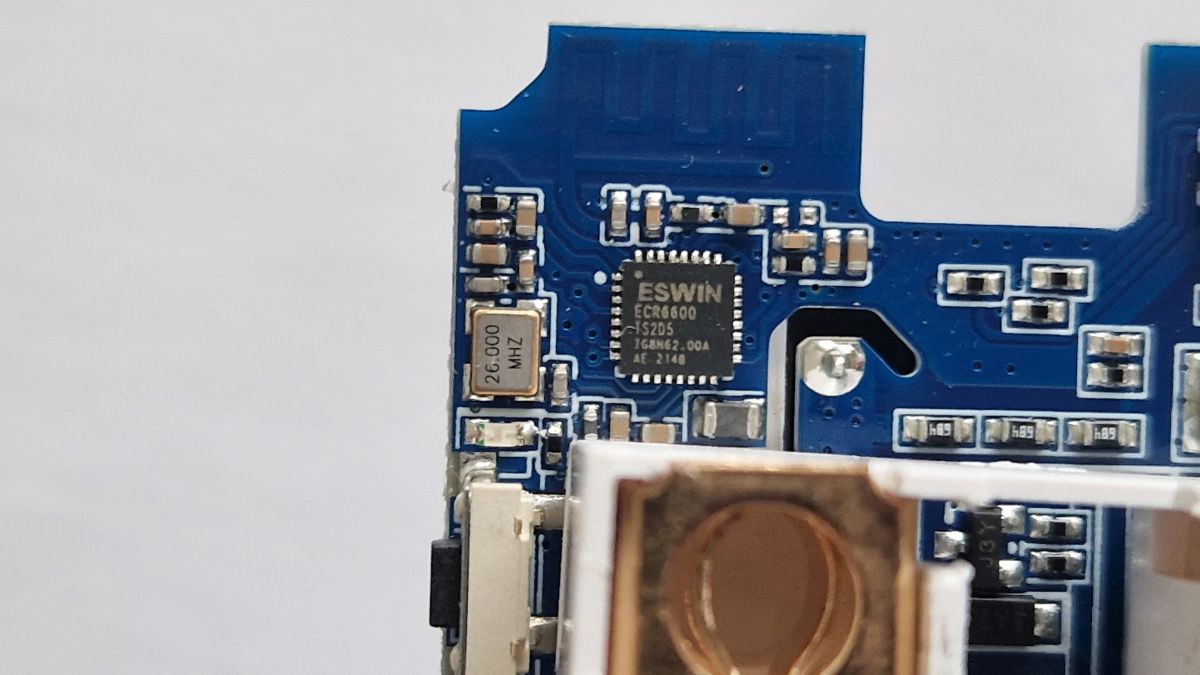

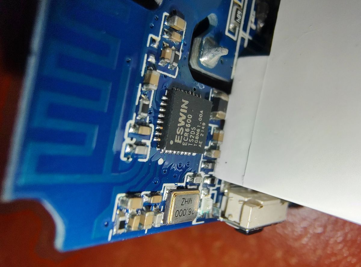

    New ECR6600 chip, not supported, but already reported in this forum:
    Close-up of a circuit board with ECR6600 ESWIN chip.
    Might be easy to flash, 5 pads, could be VCC, GND, TX, RX, BOOT

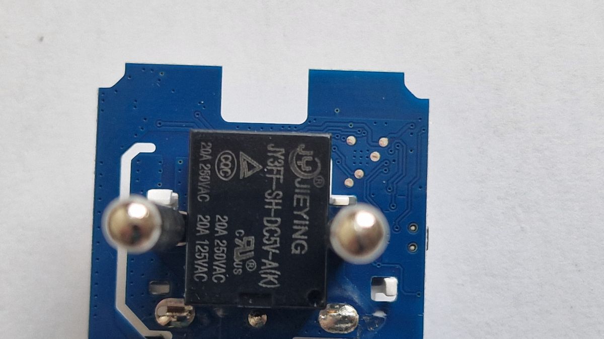

    Smart plug PCB with JIEYING relay.

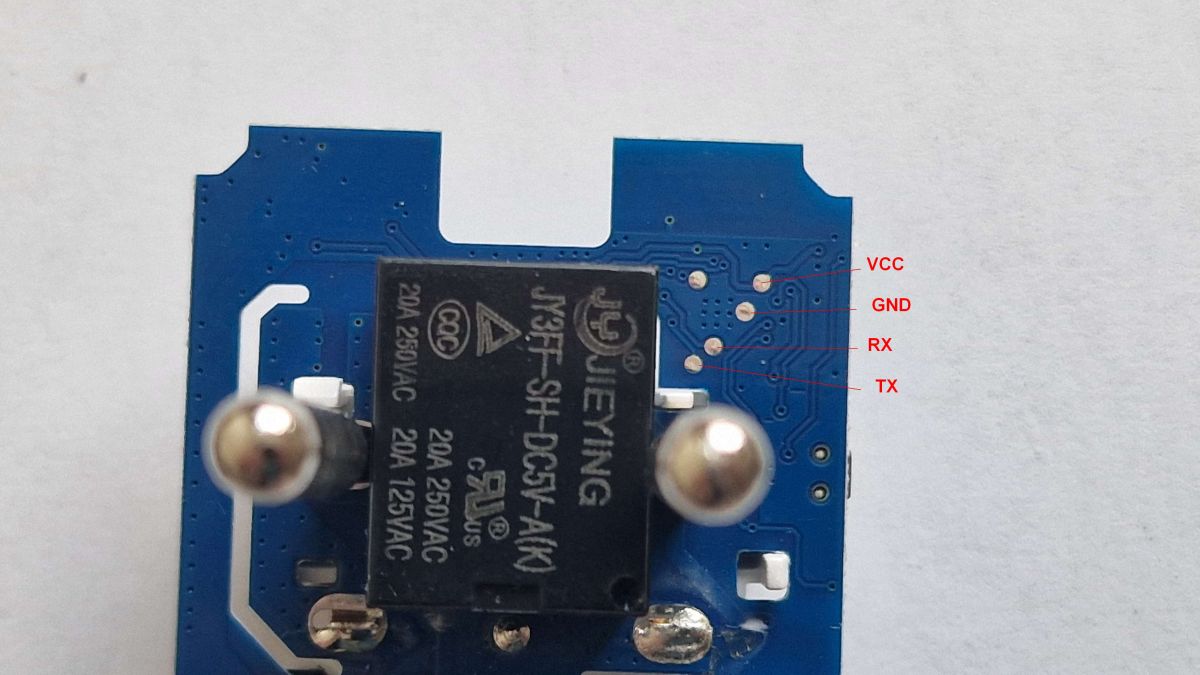

    You don't have to wait until spring, here is some information from me about this plug
    Close-up of a PCB with marked VCC, GND, RX, and TX pins.
    • original_flash.bin (2 MB) You must be logged in to download this attachment.

    How did you take flash backup? Can you share boot log?

    No flashback was attempted, there is no boot log. The power supply to the module had to be established separately, the voltage from the serial converter was not sufficient.
    Boot log confirms backup firmware runs on ECR6600

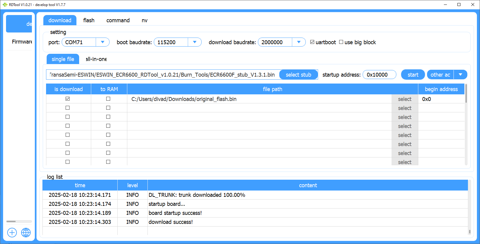

    boot log from IO13 on WG236 after burning your backup
    Screenshot of RDTool V1.0.21 showing download settings and logs.
    not getting to pairing mode I guess because I don't have BL0937 present. IO24 appears to be reset/btn

    I didn't investigate anything further, for me the most important thing was to preserve the Flash content.
    At the moment there is no ready-made alternative firmware for these plugs

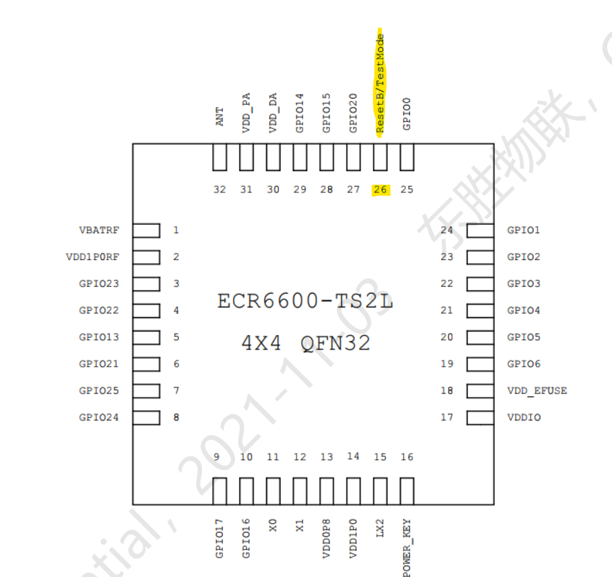

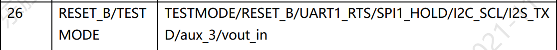

  • Fifth pad identified as pin 26 boot pad
    #22 21515988
    Posts: 5209
    Help: 446
    Rate: 914
    May I ask you is that fifth pad put aside of row of others really boot pad?
    I can trace it shortly, but it is not needed to backup and program the flash.
    If yes, could you please advise how to use it to upload firmware to the chip?
    backup and flash procedure https://www.elektroda.com/rtvforum/topic4111822.html
    Added after 18 [minutes]:
    it's pin 26
    Fragment of a table with technical information related to number 26 and assigned PIN functions.
    Package diagram of ECR6600-TS2L integrated circuit with pins.
  • Programming pad shorted to chip pin 26 for flash access

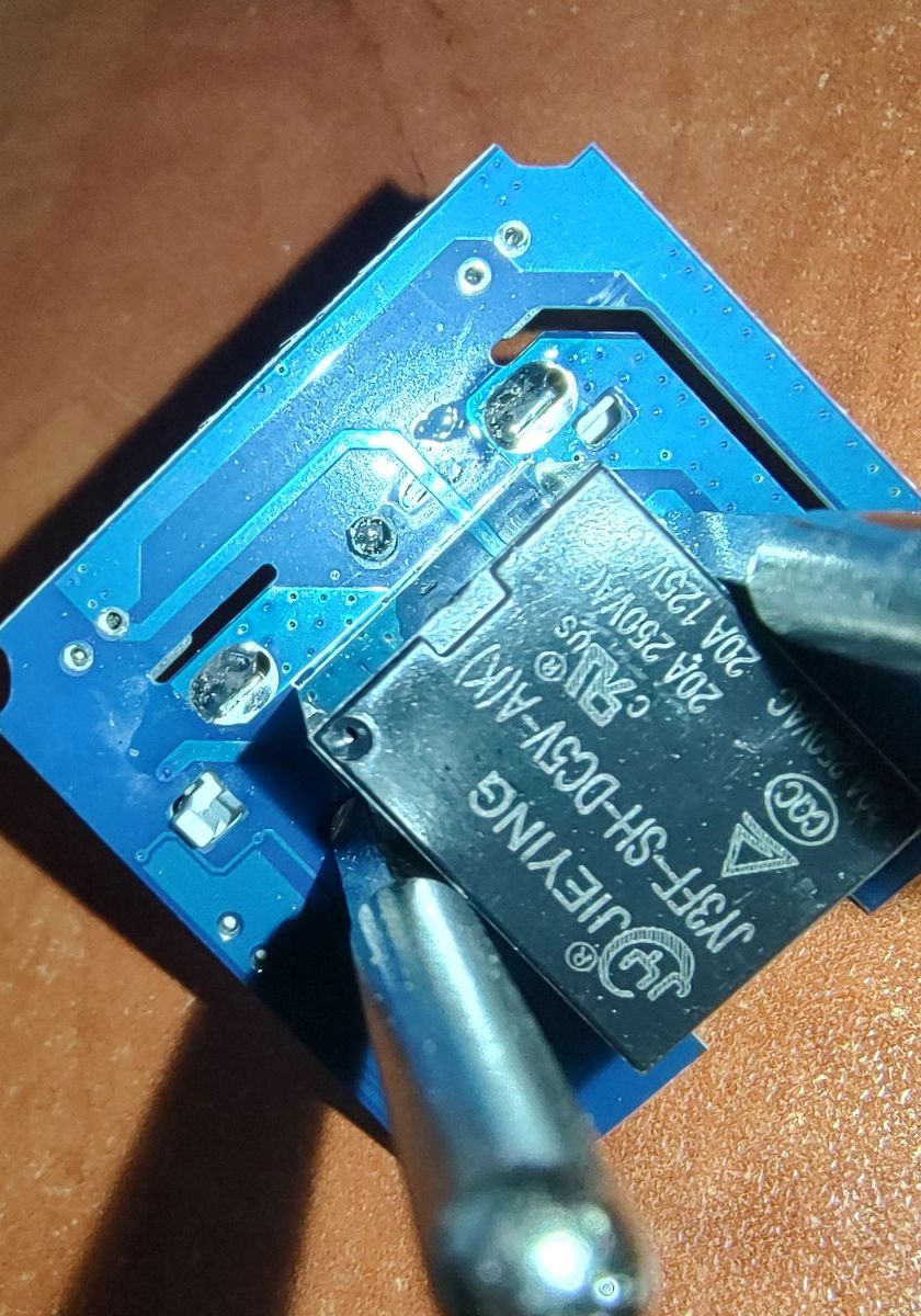

    #24 21521544
    epolet
    Posts: 12
    >>21517031
    No advice. So I moved forward alone and reached success.
    Two secrets helped me in this.
    1) I just clicked button "Start" of RDTool again and again
    2) After click wait 1 second, connect RST to GND and disconnect immediately. When you will lucky download (as for me it is more upload than download but ok, let it be called download, what confused a lot nevertheless) file OpenECR6600_1.18.76.bin will start and finish successfully.

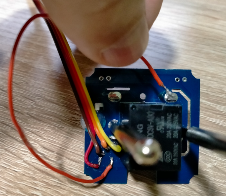

    Btw. I found much more convenient location to touch RST to GND See picture below.
    Close-up of a printed circuit board with a relay and colored wires soldered to it.
    Hope all is clear.
    Going that way I successfully reprogrammed the socket, connected to it via WiFi, configured its WiFi connection and accessed to it via my home lan. Thanks to all who helped me to reach this result.

  • BL0937 date code 2439 indicates the plug was made after week 39 of 2024, even though the PCB had no printed board marking. [#21441371]
  • The exposed programming area has 5 pads, and the isolated fifth pad was later traced to pin 26, used as RST/BOOT access during flashing. [#21515988]
  • A successful OpenECR6600 configuration used 6 functional GPIOs: BL0937 on pins 14, 15, 20, WiFi LED on 22, button on 24, and relay on 25. [#21500105]
  • One user measured approximate standby overhead of 0.03 kWh per 24 h for 2 smart plugs, or about 0.7 W per socket, when comparing TNCE and Aubess plugs against a Silvercrest meter. [#21595107]

The correct template assigns GPIO14=BL0937CF, GPIO15=BL0937SEL, GPIO20=BL0937CF1, GPIO22=WifiLED, GPIO24=Btn, and GPIO25=Rel. Importing that template, or setting those pins manually, is enough on OpenECR6600 versions with BL0937 support. The same config was later confirmed to expose electricity status on the web UI and MQTT. [#21521656]
What steps are needed to flash OpenECR6600 onto this ECR6600 smart plug using RDTool or BurnTool?
You flash it by wiring UART, using the all-in-one image, and briefly resetting the chip at the right moment. 1. Connect the plug to a separate 3.3V-capable supply and UART pads. 2. In RDTool or BurnTool, load the OpenECR6600 all-in-one file and press Start. 3. About 1 second later, momentarily short RST to GND so programming begins. One user reported this exact timing finally produced a complete successful write. [#21521544]
Why does RDTool show "sync failed" or "download failed" when trying to program an ECR6600 plug, and how can that be fixed?
RDTool shows those errors when the chip misses programming sync or the wrong flashing method is selected. The thread fixed it by retrying Start several times, then shorting RST to GND about 1 second later. Another user also fixed repeated failure by lowering the baud rate and using the correct all-in-one workflow instead of selecting the firmware as a stub. Those are the two concrete recovery steps reported. [#21716613]
Where is the BOOT or RST pad on this ECR6600 smart plug, and how do you use it to enter programming mode?
The separate fifth test pad is connected to chip pin 26 and was used as the reset/programming access point. You do not need it for every flash attempt, but it helps when sync is unreliable. To enter programming mode, start the transfer in the tool, then briefly short that pad to GND. A user verified the pad-to-pin-26 continuity with a multimeter before using it successfully. [#21515988]
