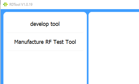

    So, to backup the firmware - start by running the ESWIN RDTool.exe program after downloading and unzipping ESWIN_ECR6600_RDTool_v1.0.21.zip from https://github.com/openshwprojects/FlashTools/tree/main/TransaSemi-ESWIN
    Screenshot showing the contents of a folder with files and subfolders in a file manager.
    When loaded double-click the develop tool plugin.

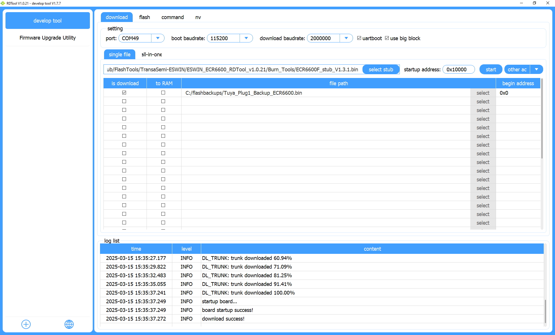

    Screenshot of a firmware upgrade tool.
    Select the single file tab and choose the file ECR6600F_stub_V1.3.1.bin from the unzipped files in the open dialog box after clicking select stub.
    Ensure the startup address is 0x10000 and select the correct COM port
    Screenshot of a firmware upgrade tool program with a list of settings and files.
    At the moment you hit start, reset (ground CEN/RST) or power-on 3.3V to the device. The window of opportunity is very small so timing is crucial.
    Screenshot of a firmware upgrade tool with various configuration options.
    Switch to the flash tab, choose port again and enter start address of 0 and read length of 0x400000 or 0x200000, depending on your chip flash size (4MB or 2MB). If not sure, first try 0x400000, then, in case of "FLASH is not enough!" error, fall back to 0x200000. Select save path and give your backup an informative name eg; Tuya_LSPA9_Backup_ECR6600.bin. Click start next to save path to begin device flash backup to file.
    Screenshot of firmware upgrade software with progress logs.

    >>21479963

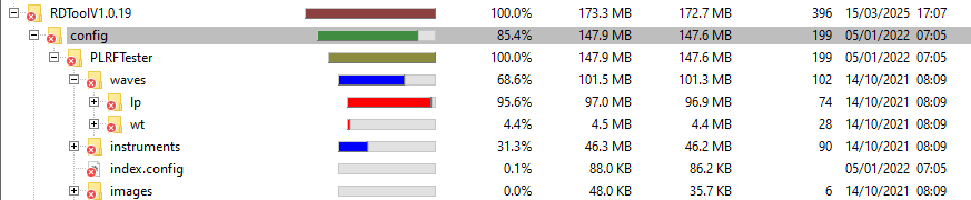

    to add that FlashDumps has version 1.0.19 of RDTool, attached to the main post, but also v1.0.21 which was used in the screenshots. v1.0.19 has a different second plugin, but still has the main develop tool one. The RF tester plugin content is the reason for the file size difference in zipped files
    Screenshot of RDTool V1.0.19 tool screen with two options: develop tool and Manufacture RF Test Tool.
    Screenshot showing the folder structure for RDToolV1.0.19 with information on size and usage of various directories.
    Additionally, to restore a full device backup file:
    -Navigate to the single file tab
    -Set port, stub and startup address as with backup procedure
    -Select your backup file from select in main file path area
    -Set begin address to 0x0
    -Check is download on same line
    -Click start next to startup address and RST/power-on quickly, as before
    Stub and backup will be done in one go.
    RDTool interface for firmware update.

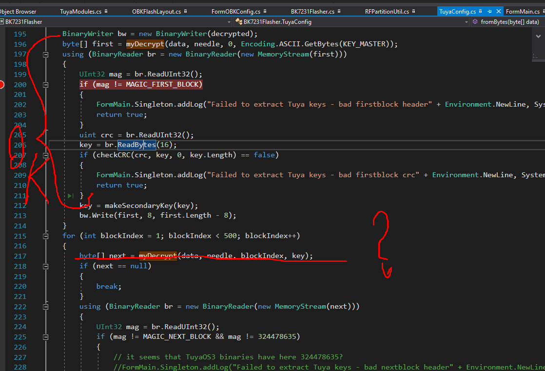

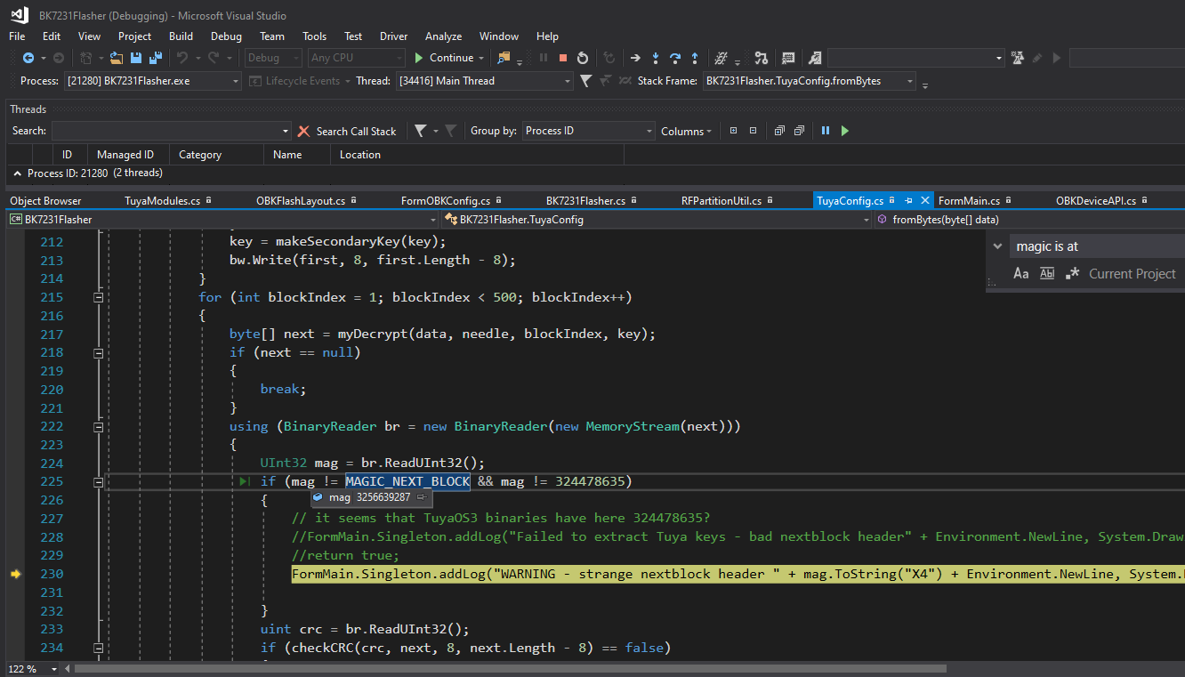

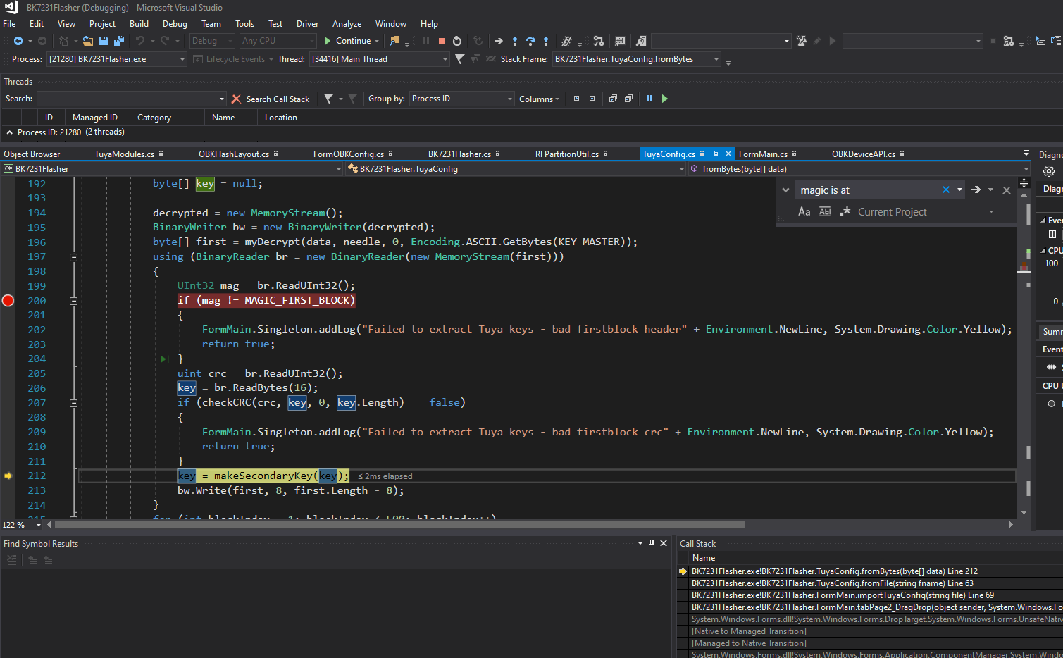

    Interestingly enough, we get only errors on futher blocks, and not on first - "Failed to extract Tuya keys - bad firstblock crc".
    I've double-checked, and it indeed passes first MAGIC and CRC check:
    Screenshot of Visual Studio displaying a code editor with an open programming project.

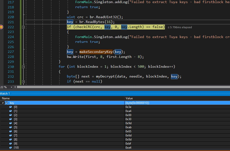

    First problem happens here:
    Screenshot of Visual Studio displaying C# code.
    This is after the call of myDecrypt... but first call of myDecrypt (firstblock) seems to be okay, interestingly enough.
    So what could be going wrong? Maybe makeSecondaryKey?
    Screenshot of C# code with red annotations.

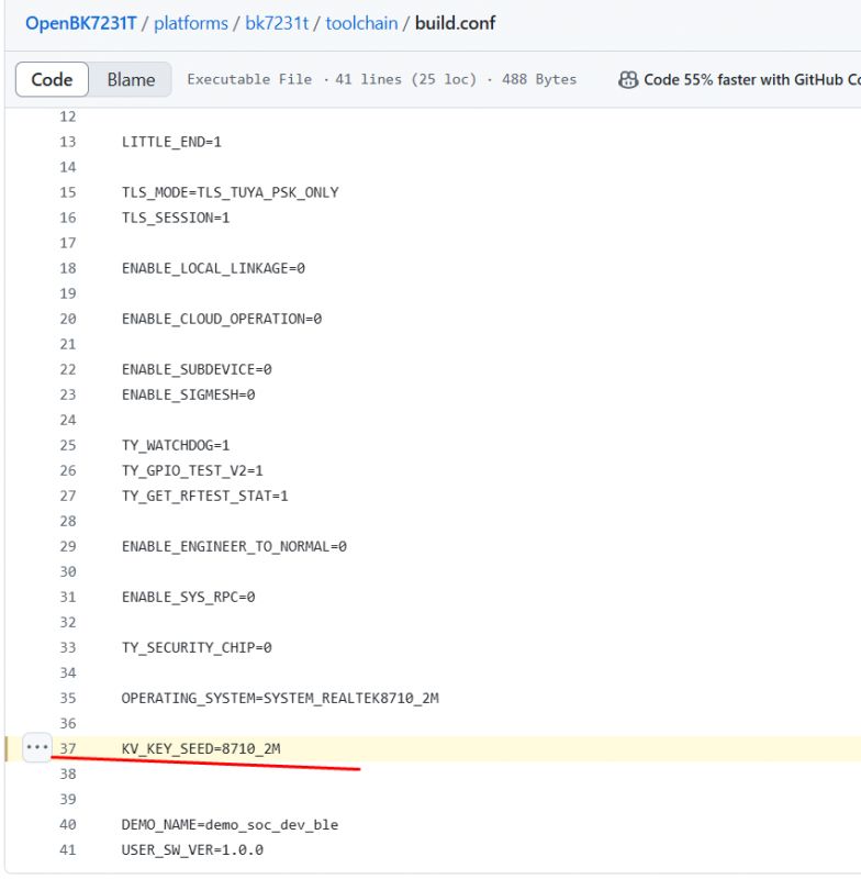

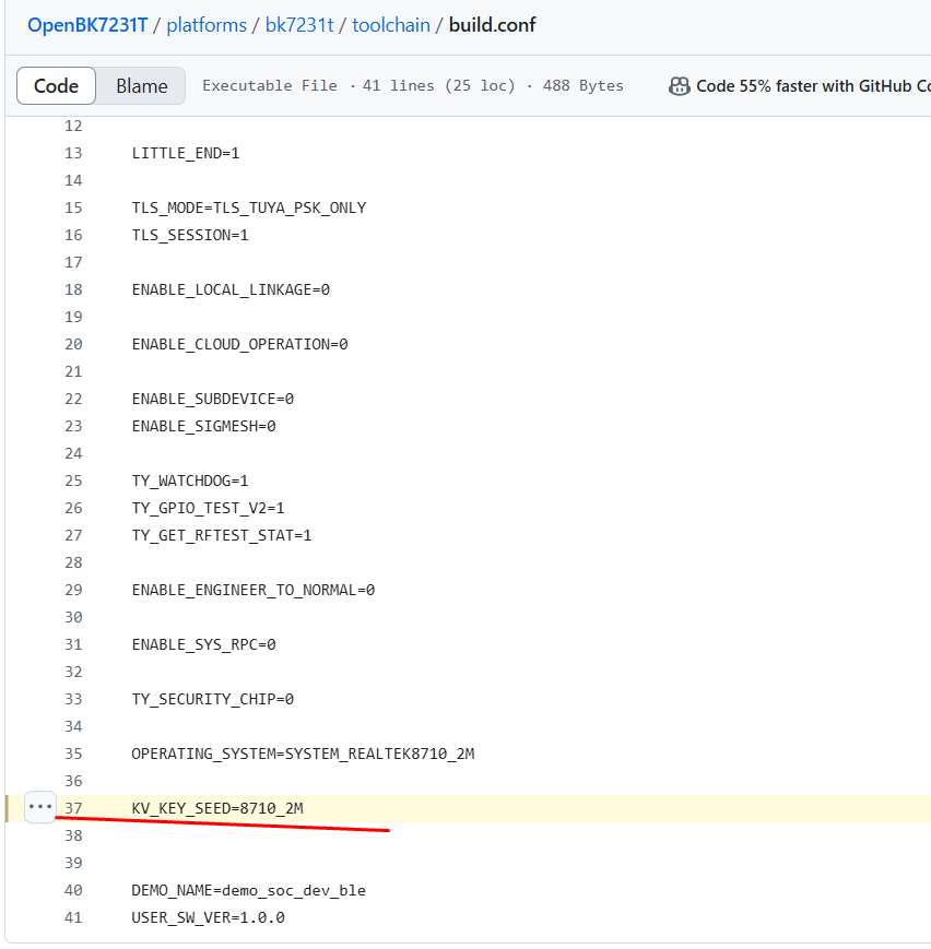

    https://github.com/openshwprojects/BK7231GUIFlashTool/blob/main/BK7231Flasher/TuyaConfig.cs
    Do we know KV KEY SEED of ECR6600?
    A section of the build.conf configuration file related to OpenBK7231T software.
    Added after 11 [minutes]:
    Same?>
    Screenshot showing a hex editor and a fragment of code in the background.
    Added after 4 [minutes]:
    I can also find this key in the binary: qwertyuiopasdfgh
    Only one missing is 8710_2M
    Added after 7 [minutes]:
    I'm trying to find this key in ASCII strings in the file...
    There are some interesting things like: keyge8wsy99n5pr7 ? DIFF2YA0 ? but that's not it

    @divadiow , in our flasher, there are 3 keys:
    Code: C#
    but in the ECR binary, only 2 of them are seen. Does it mean that they changed 8710_2M?
    Futhermore, decrypt fails at second block, only after KEY_PART_1 is used.

    Remember how I said that first block is correctly read?
    These things match:

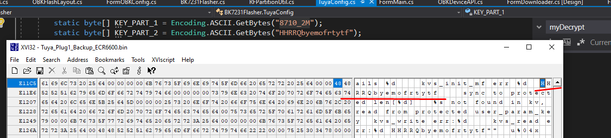

    divadiow wrote:
    Screenshot of a code debugger in Visual Studio showing the Watch panel with byte array values.
    Everything breaks with makeSecondaryKey call I guess...
    Code: C#
    And I can see "HHRRQbyemofrtytf" string in flash, so I still suspect that 8710_2M was changed.

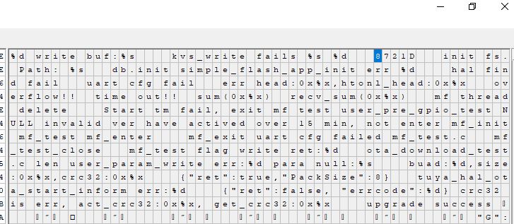

    I managed to get this from WBRG1 backup:
       "dp3":"10",
       "dp5":"2",
       "dp30":"1",
       "dp39":"1",
       "dp40":"1",
       "dp44":"100",
       "dp41":"50",
       "dp46":"0"
    With KEY_PART_1 8721D
    But trying it on WBR1D backup failed.
  • #16 21481367

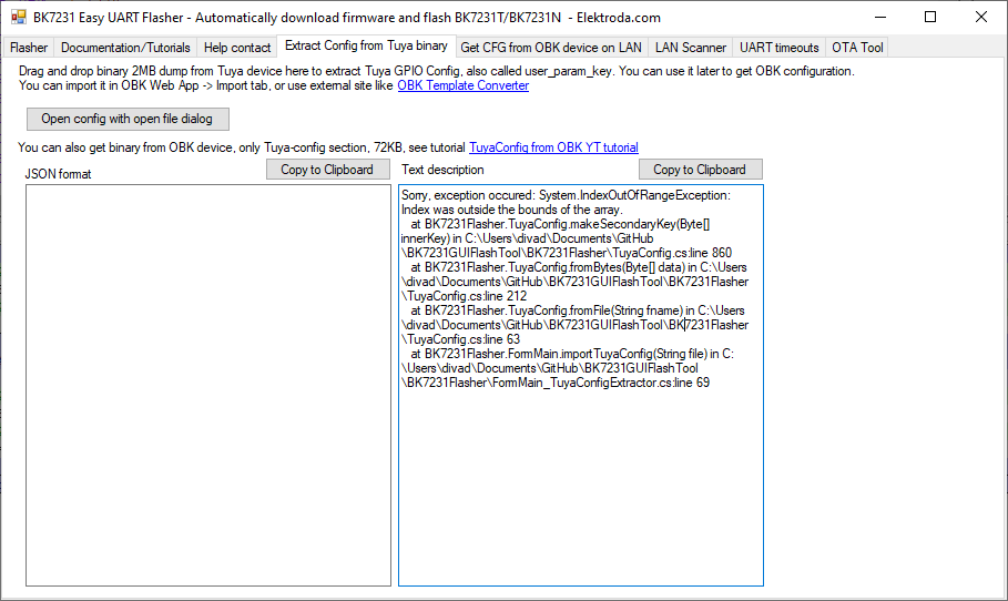

    does it have to have that part specified?
    I did build it without any value but..
    Screenshot of the BK7231 Easy UART Flasher application with an error message.

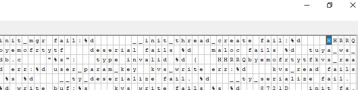

    nice finding @insmod , but now look, if I search for this string in the dump of WBRG1 gateway, I can find it:
    Table with code text and data in an application window.
    The same goes for HHRRQbyemofrtytf:
    Screenshot of code with symbols and text in an editor window.
    Both tested on Tuya-Gateway-20250219-(8721csm_bt_zg_gw)_keym557nqw3p8p7m_WBRG1_1.7.2_p.kaczmarek2.
    So, it should be fair to assume, that the key for ECR6600 can be also found in the dump?
    Well, I've tried to dump all strings and use them as keys in a brute-force method, but it still failed. Maybe i am missing something obvious, but at least you confirmed that my initial idea is correct.

    >>21481371 WBR1D backup contains 8721D too, but it fails to extract anything still.
    That was just luck on my part

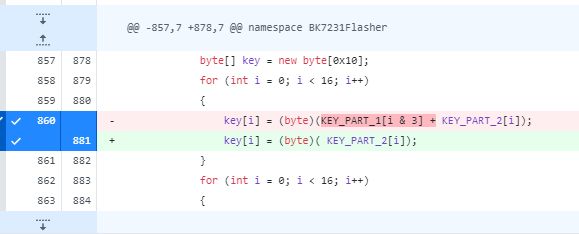

    The array is used by makeSecondaryKey function. I can remove it from calculation:
    Code difference for key in BK7231Flasher
    But it still fails for futher sectors.
    But maybe Tuya does something else then.

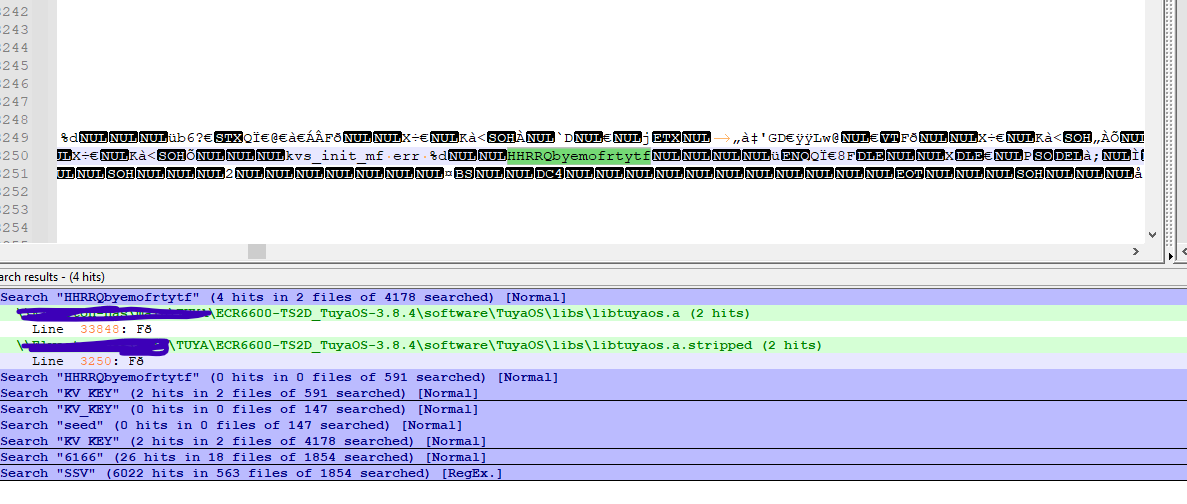

    • libtuyaos.zip (9.46 MB) You must be logged in to download this attachment.
  • #27 21481441
    Posts: 5089
    Help: 441
    Rate: 899

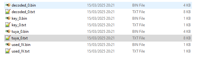

    hmm
    Screenshot showing a search window with results for the string qwertyuiopasdfgh.
    List of files with various extensions such as BIN and TXT, with dates and sizes.
    • DebugAES.zip (1.75 KB) You must be logged in to download this attachment.

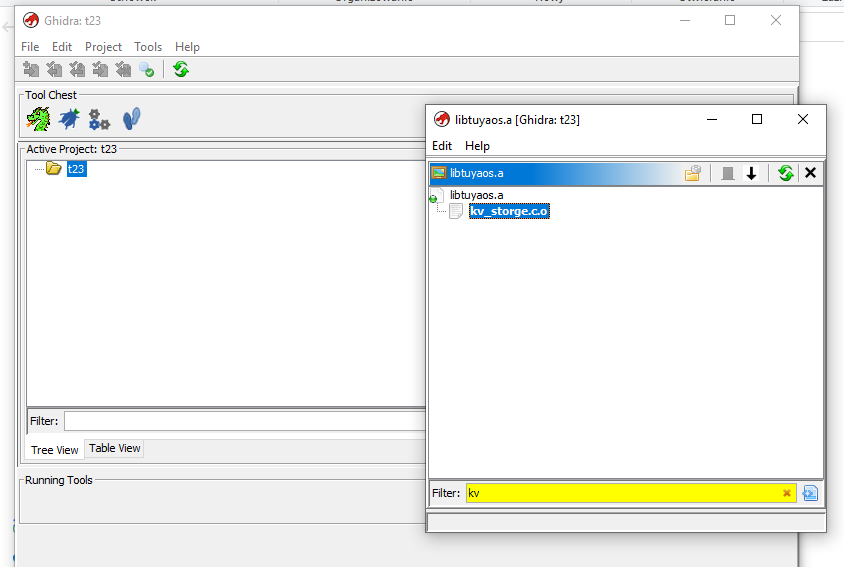

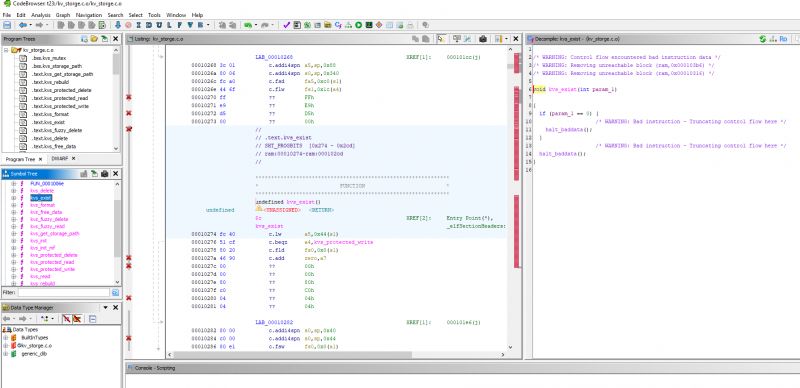

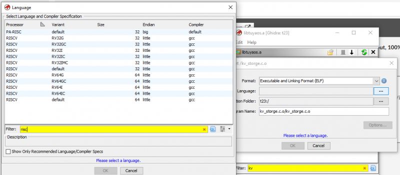

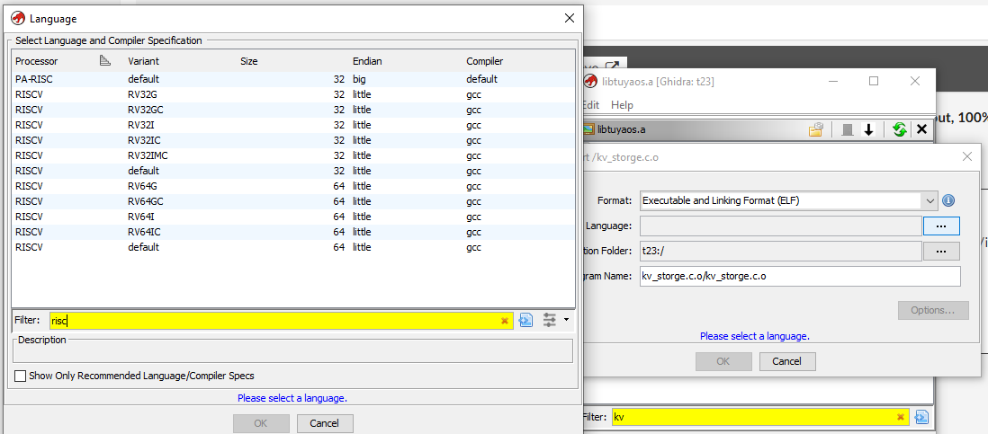

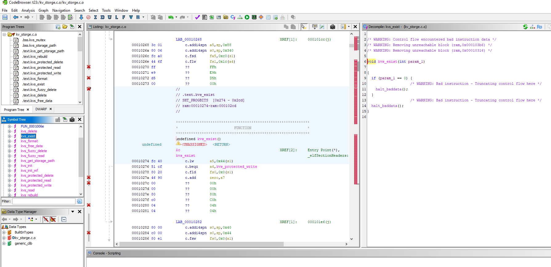

    We could try to open it in Ghidra but I don't know which RISC is it:
    Screenshot of the Ghidra program with an open project named t23 and a file search window displayed.
    Language selection dialog in Ghidra
    Ideas? Or are you interested in getting Ghidra and trying
    Function names are here but they can't be disassembled, probably I've chosen wrong RISC type.

    I see, used SDK is nds32le-elf-mculib-v3s.tar.gz, but now it seems that we would need to compile Ghidra from source...

Why does Tuya config extraction from ECR6600 backups fail after the first block, and what does the thread suggest about changed secondary keys or TuyaOS 3 storage?
It fails because the first block decrypts, but later blocks fail header and CRC checks, which points to a changed secondary key or a different storage scheme. The extractor found the Tuya config magic at offset 1921024, passed the first MAGIC and CRC checks, then produced repeated "strange nextblock header" and "bad nextblock CRC" warnings. The thread’s main hypothesis was that ECR6600 changed KEY_PART_1 used by makeSecondaryKey, while a related idea was that newer TuyaOS 3 firmware stores config differently from older BK-based devices. In short, the parser understands the opening block but not the follow-up encryption logic. [#21481206]
What is KV_KEY_SEED in Tuya firmware, and why does it matter when trying to decrypt or extract configuration from ECR6600 dumps?
KV_KEY_SEED is the short seed string used to derive part of Tuya’s secondary flash-encryption key for stored configuration. "KV_KEY_SEED is a Tuya firmware configuration value that feeds key derivation for encrypted key-value storage, and changing it breaks block decryption even when the first flash header still matches." In the thread, older non-ECR examples used CONFIG_KV_KEY_SEED="8710_2M", but ECR6600 binaries appeared to contain only some known key parts, not that seed. Because decryption failed right after makeSecondaryKey was applied, the maintainers suspected ECR6600 used a different KV seed or a modified derivation path. [#21481270]
How do I restore a full ECR6600 backup in RDTool after saving the original flash image?
Restore the full dump from RDTool’s single file tab using the same stub setup as backup. 1. Open develop tool, choose single file, select the same stub, set the port, and keep startup address at 0x10000. 2. In the main file path area, choose your saved backup file, set begin address to 0x0, and check is download. 3. Click Start next to startup address and immediately reset or power-cycle the device. The thread notes that stub upload and full-flash restore then happen in one go, so you do not need a separate restore stage. [#21480971]
What is NDS32 in relation to the ECR6600 SDK, and how were people in the thread using Ghidra to analyze ECR6600 binaries?
NDS32 is the Andes CPU architecture used by ECR6600, and it is why stock reverse-engineering setups struggled with the binaries. The thread found the SDK used nds32le-elf-mculib-v3s, then built a custom Ghidra version with NDS32 processor support from an external branch. After that, users could at least open binaries and view disassembly. They searched for strings, constants like 0x13579753, and boot-log references such as the key print path to locate simple_flash and key-handling routines. The goal was to trace where ECR6600 derives or loads the Tuya secondary decryption key. [#21481465]
