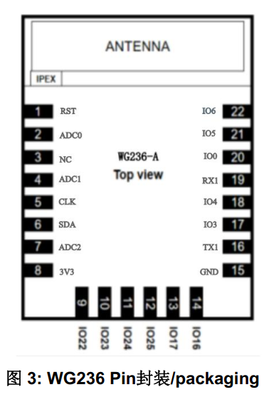

    This is a teardown of the LSC Connect Smart Wall Dimmer (3207304). It is based on the AXY2S module/ESWIN ECR6600 which isn't supported by OpenBK.
    This chip seems to have a SDK available with some flashing/backup tools on GitHub: https://github.com/NonPIayerCharacter/ecr6600. Tools can be found here: https://github.com/NonPIayerCharacter/ecr6600/raw/refs/heads/master/dbg_tools/Burn_Tools.tar, seems it is called RDTool. The chip might be similar to the TR6260, see >>21358543 by @insmod.
    Update: port in progress at https://github.com/jasperro/OpenBK7231T_App and https://github.com/jasperro/OpenECR6600
    I don't have a full datasheet (except a small product brief from ESWIN) for the chip so it's all guesswork. I couldn't find it anywhere.
    On this page: https://www.dusuniot.com/product-specification/dsm-036-wi-fi6-and-ble-dual-cloud-module/ it seems there is a pinout of a module (DSM-036) using ECR6600 and here is the module info (AXY2S): https://developer.tuya.com/en/docs/iot/AXY2S.

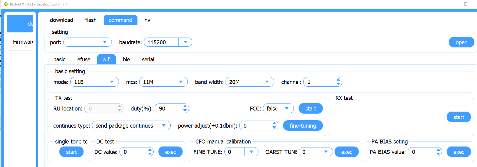

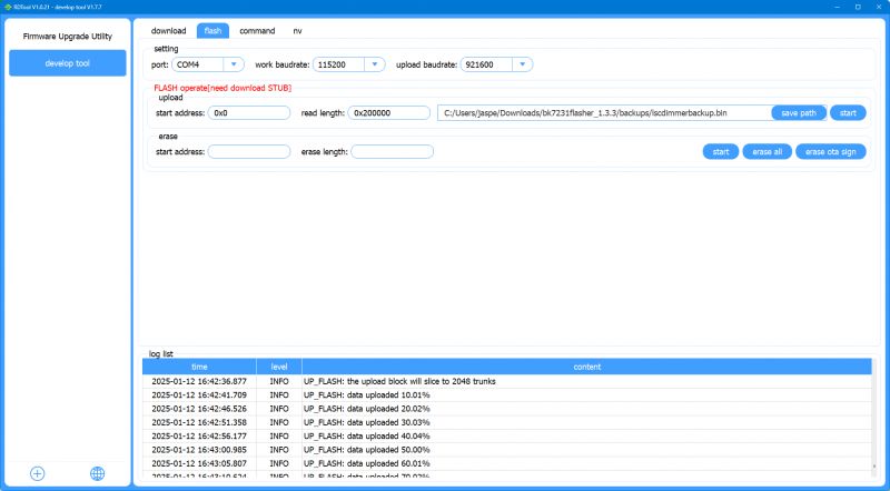

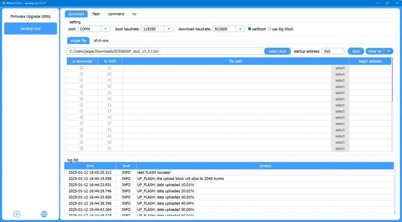

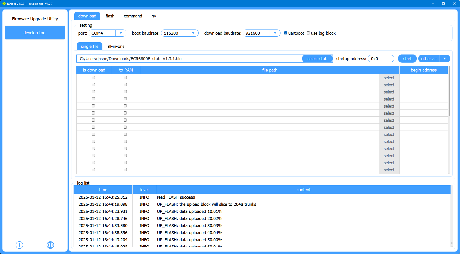

    Update: reading flash has succeeded by using RDTool with the STUB provided in the repository. Firmware backup is attached here:
    lscdimmerb..kup.bin (2 MB)You must be logged in to download this attachment.
    To take a backup of the device, follow two quite easy steps.
    The terms upload and download are switched around. Upload is actually download to the PC, download is actually upload to MCU.

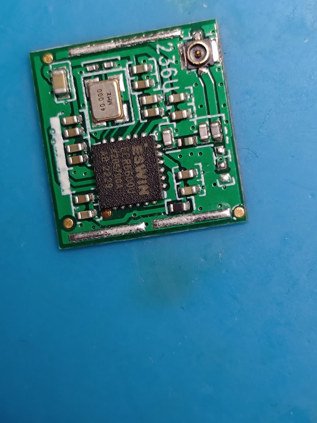

    First, desolder the AXY2S module from the dimmer and connect TX->RX, RX->TX, and GND -> GND with UART. Do solder a wire to VBat on the module, but do not connect this to 3v3 yet.
    First download and extract the Burn Tools mentioned above and the STUB bin from the repository at https://raw.githubusercontent.com/NonPIayerCh...00/common/common_bin/ECR6600F_stub_V1.3.1.bin
    Then, open the RDTool.exe in the extracted Burn Tools folder.

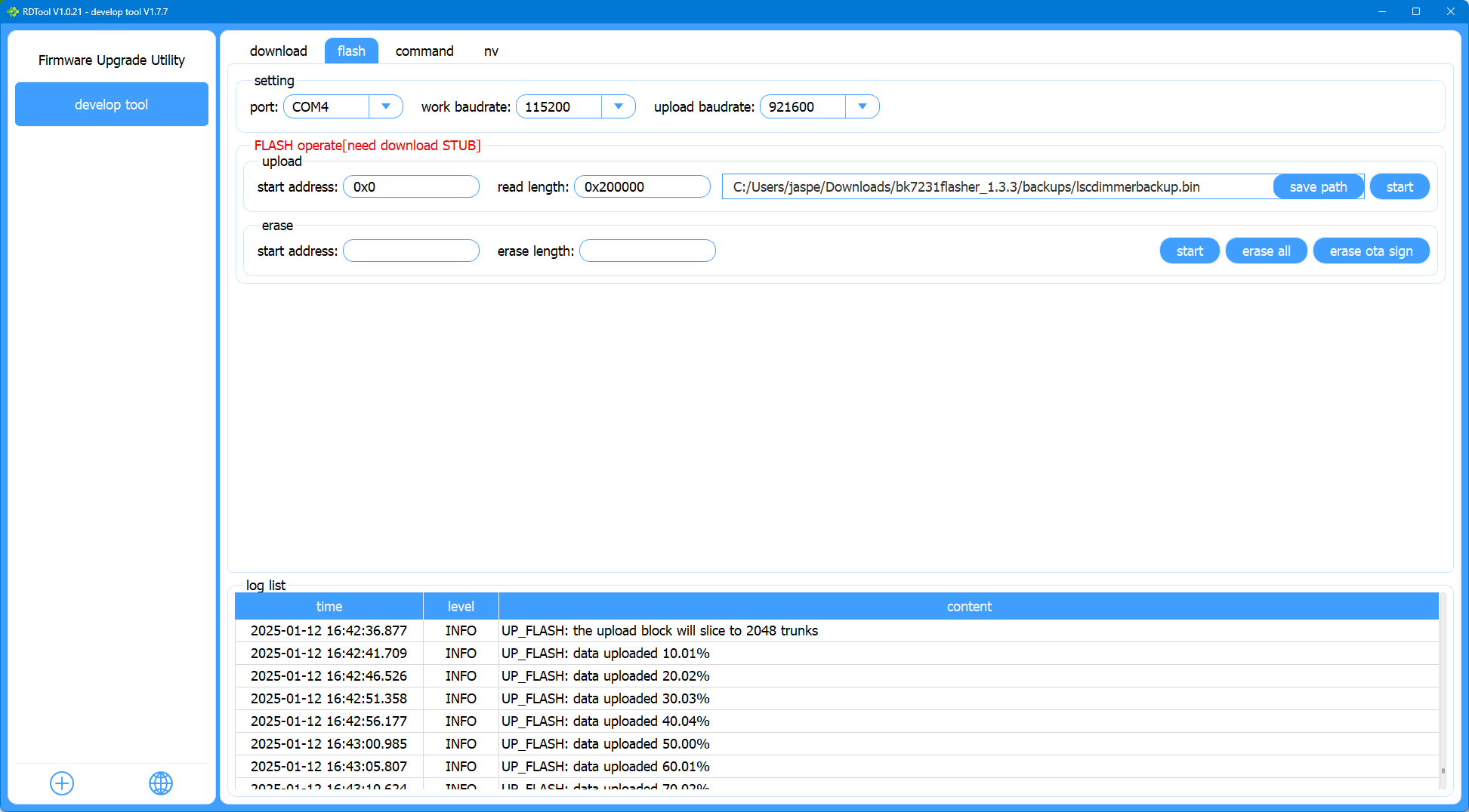

    Open the develop tab and fill in the settings shown:
    RDTool software interface with tabs for firmware upgrade and logs of the flashing process.
    When all data is correct, click the start button. Quicky connect your VBat wire to 3v3. It should say "Begin to download STUB" in the content/log.

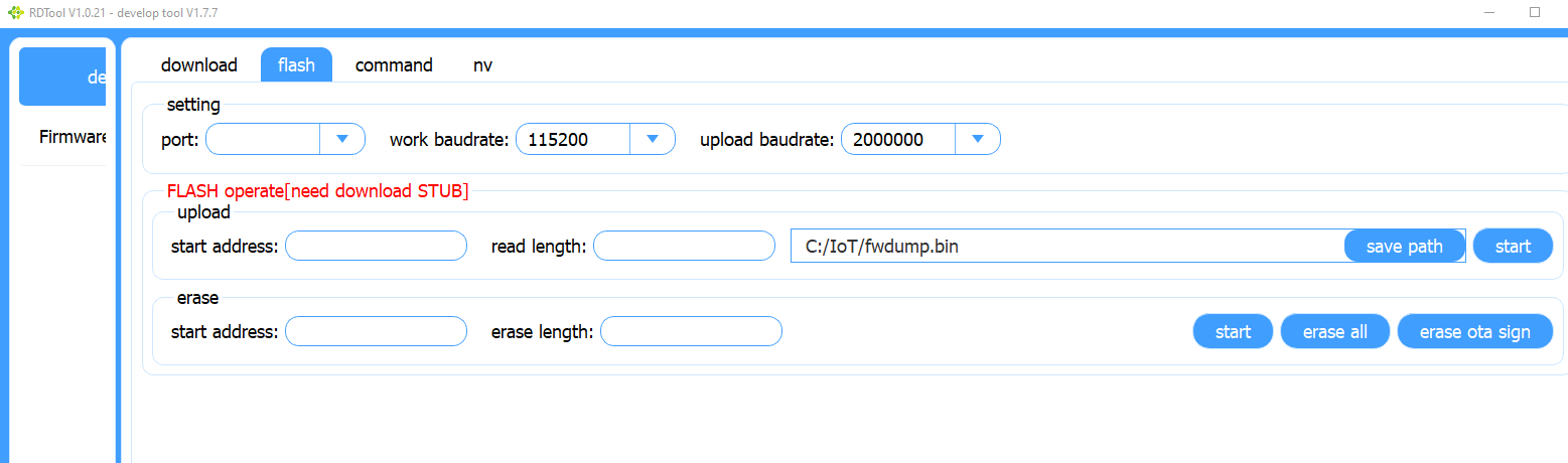

    Then, go to the flash tab and fill in all data as shown here, put the path where you want to save your backup in by selecting save path. Then click start. content/log should now say data uploaded 10%, 20%, ... until "READ Flash Success!"
    RDTool interface displaying the flash tab with transmission settings
    The resulting backup should be 2048KB.

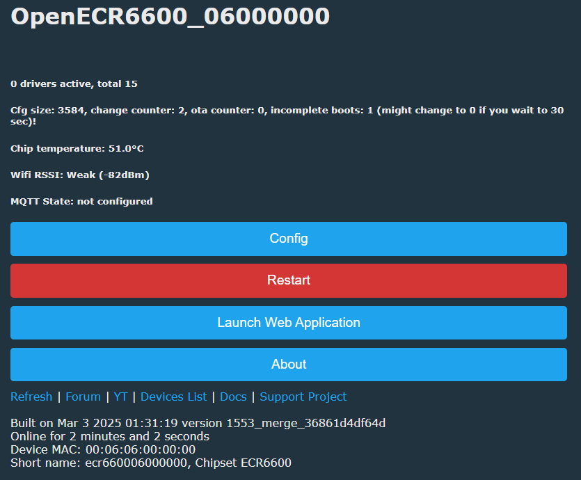

    From now, I will be trying to get development for this device working, e.g. make a OpenECR6600 repository and try to get OpenBeken running. I will post updates here.

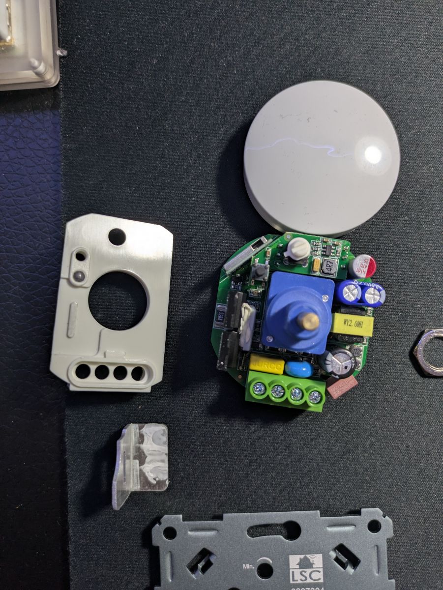

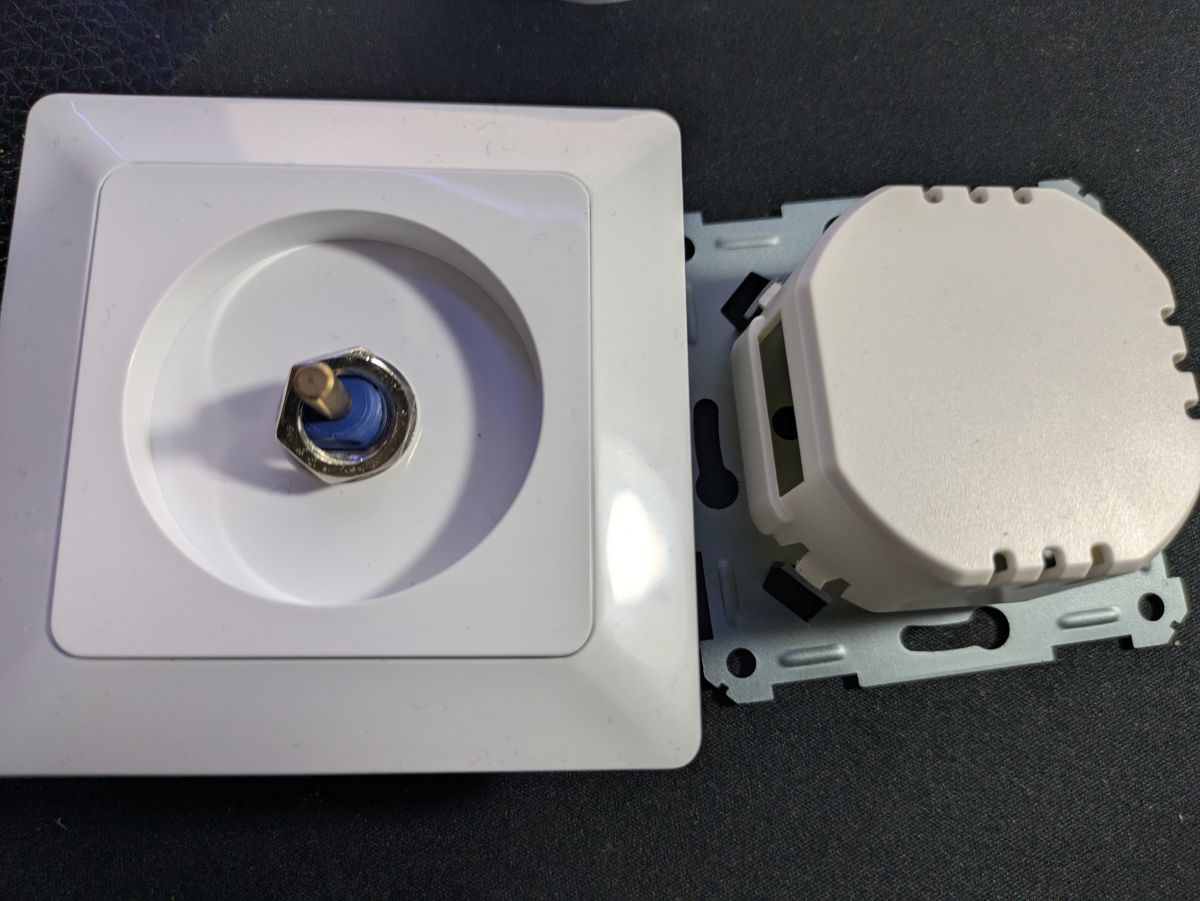

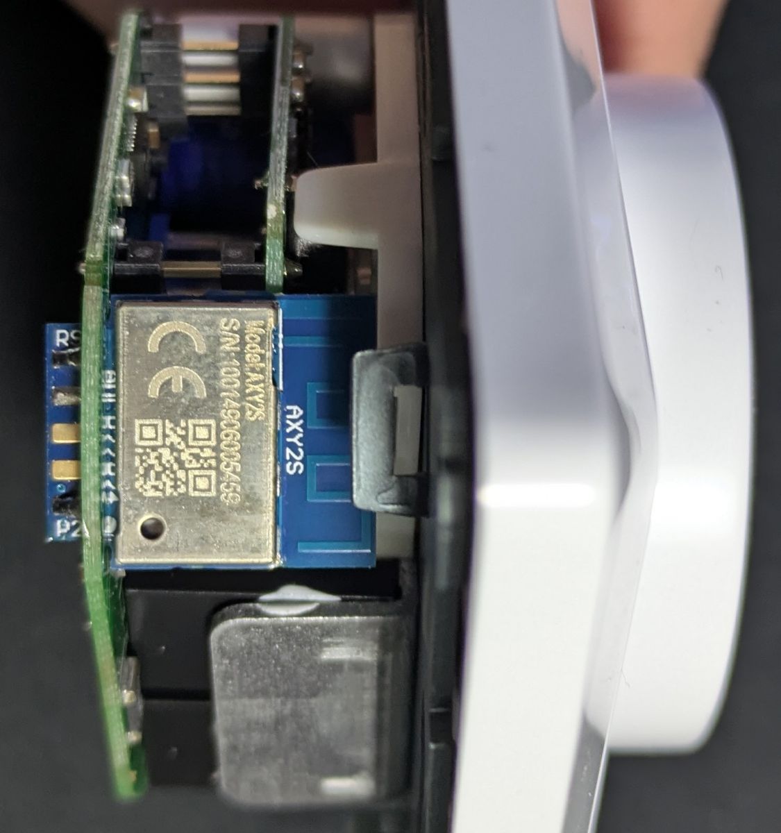

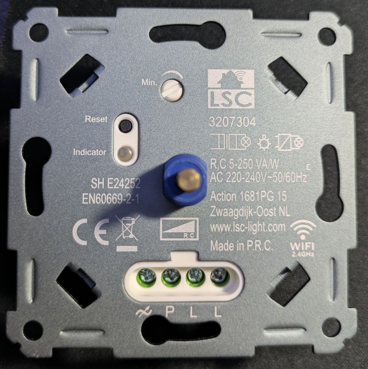

    Taking the device apart is very easy. The front can be taken off by pulling the dial out and turning the nut. Taking the back casing off is done by pushing the clips in.
    Packaging of LSC Connect smart wall dimmer with smartphone app display.
    Packaging of LSC Connect smart wall dimmer with feature descriptions.
    Dismantled LSC Connect smart wall dimmer with visible components.
    Disassembled LSC Connect smart wall dimmer with visible electronics on a dark background.

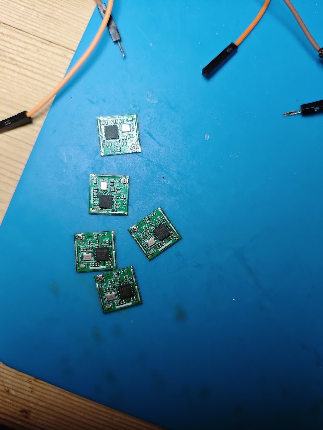

    Back of LSC Connect smart wall dimmer with module markings.
    Close-up of a disassembled LSC Connect smart dimmer module with the AXY2S chip visible.

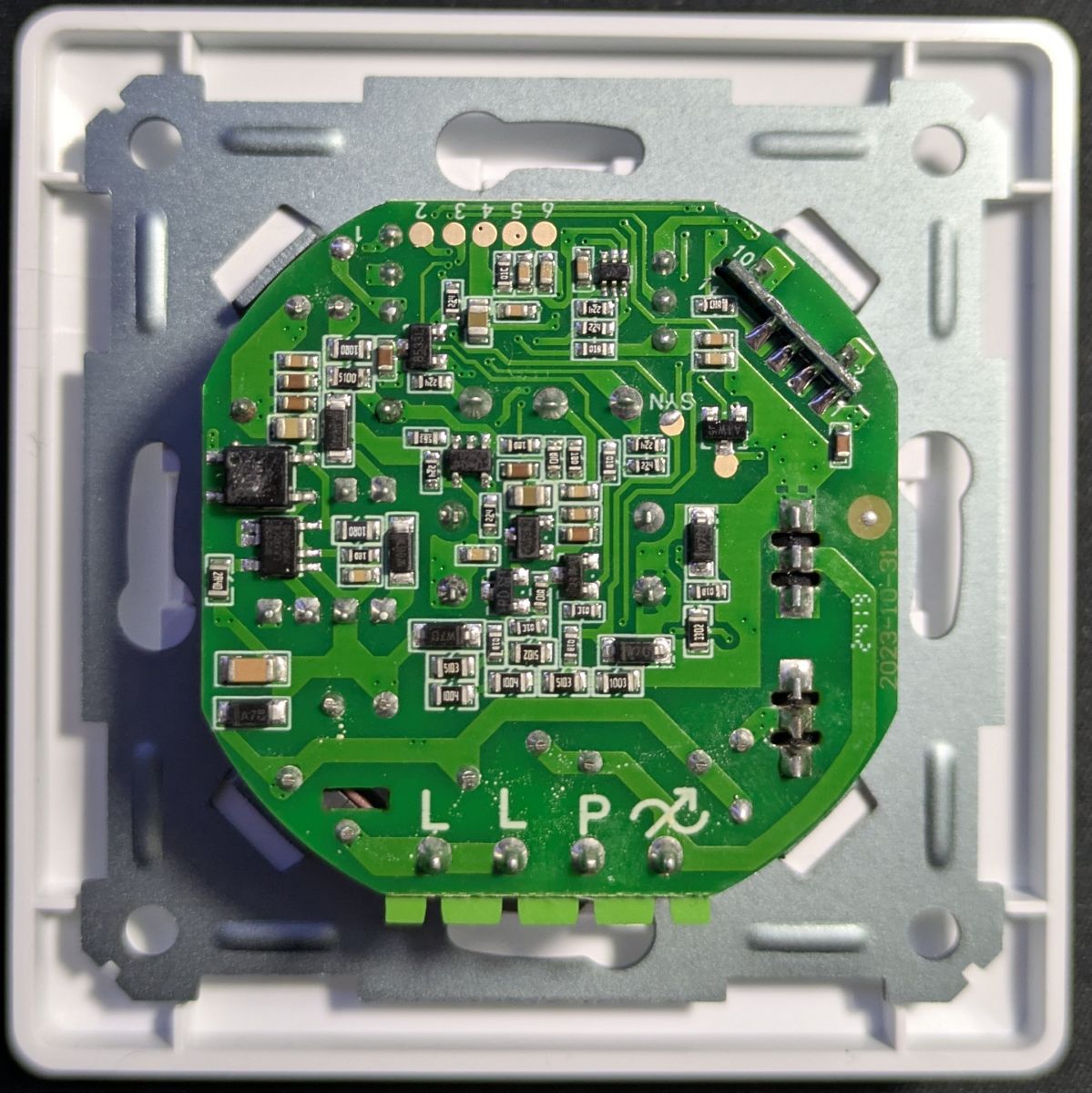

    Circuit board of the LSC Connect smart wall dimmer.

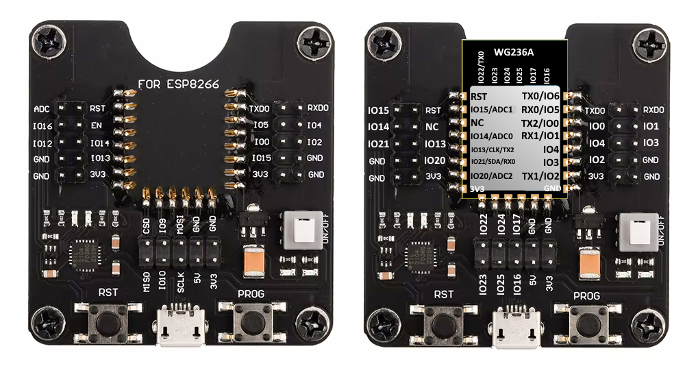

    very interesting. I look forward to seeing a firmware backup if you can make one. The tool looks similar in its options to UTP for TR6260
    User interface of RDTool V1.0.21 showing options for firmware flashing.

    >>21378733 I was successful in getting a backup, I added it to the post along with instructions on how I did it. I don't know what to do with it, maybe open it in Ghidra somehow?
    Anyway, now I can try to start development and test things. I will keep you up to date.

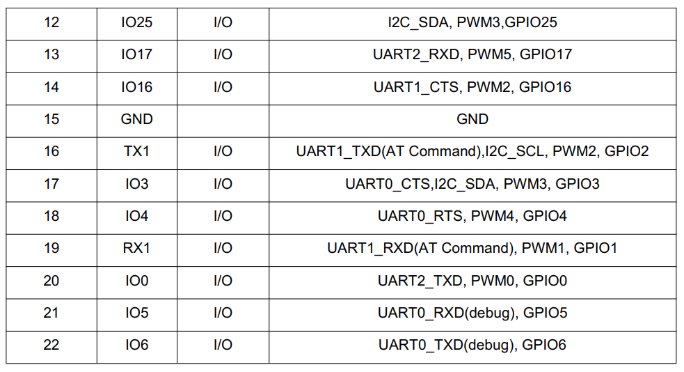

    >>21389968 The boot log from UART0 (TX/RX) is very weird. It shows this:
    ty heap base: 1f000 size: 196352
    U��
    U��
    U��
    repeating into infinity.

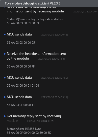

    UART1 (L_TX/L_RX) shows this:
    [00:00:00.004]tuya APP main()!!! reason:0
    [00:00:00.006]SDK version ECR6600F_V2.0.0B06P02, Release version 1.0.0
    [00:00:00.030]mac in amt
    [00:00:00.049]psm event handle!
    [00:00:00.051]psm lib build time: Dec 19 2023-22:43:01
    [00:00:00.056]start TUYA application
    [00:00:00.069]tuya_wpa_supp_evt_init:1665 wpa supplicant init event cb
    [00:00:00.077][01-01 00:00:00 TUYA D][tal_thread.c:202] Thread:tuya_auth Exec Start. Set to Running Stat
    [00:00:00.087][01-01 00:00:00 TUYA I][tal_thread.c:183] thread_create name:tuya_auth,stackDepth:4608,totalstackDepth:4608,priority:5
    [00:00:00.103][01-01 00:00:00 TUYA I][mqc_app.c:325] mqc app init ...
    [00:00:00.111][01-01 00:00:00 TUYA D][tal_thread.c:202] Thread:sys_timer Exec Start. Set to Running Stat
    [00:00:00.119][01-01 00:00:00 TUYA I][tal_thread.c:183] thread_create name:sys_timer,stackDepth:4096,totalstackDepth:8704,priority:5
    [00:00:00.133][01-01 00:00:00 TUYA I][tal_thread.c:183] thread_create name:wq_system,stackDepth:5120,totalstackDepth:13824,priority:3
    [00:00:00.144][01-01 00:00:00 TUYA I][tal_thread.c:183] thread_create name:wq_highpri,stackDepth:4096,totalstackDepth:17920,priority:4
    [00:00:00.155][01-01 00:00:00 TUYA D][mqc_app.c:134] mq_pro:5 cnt:1
    [00:00:00.160][01-01 00:00:00 TUYA D][mqc_app.c:134] mq_pro:31 cnt:2
    [00:00:00.166][01-01 00:00:00 TUYA D][tal_thread.c:202] Thread:wq_highpri Exec Start. Set to Running Stat
    [00:00:00.176][01-01 00:00:00 TUYA D][tuya_svc_online_log.c:223] svc online log init success
    [00:00:00.187][01-01 00:00:00 TUYA D][log_seq.c:895] read m:0 f:0 l:0
    [00:00:00.192][01-01 00:00:00 TUYA D][tuya_device.c:79] < TuyaOS V:3.3.105 BS:40.00_PT:2.3_LAN:3.5_CAD:1.0.5_CD:1.0.0 >
    < BUILD AT:2024_01_10_08_49_07 BY ci_manage FOR tuyaos-iot AT eswin_ecr6600 >
    IOT DEFS < WIFI_GW:1 DEBUG:1 KV_FILE:0 LITTLE_END:1 TLS_MODE:2 OPERATING_SYSTEM:98 RELIABLE_TRANSFER:RELIABLE_TRANSFER >
    [00:00:00.219][01-01 00:00:00 TUYA D][tuya_device.c:80] ecr6600_common_singlefire_dimmer_user_config_ty:0.0.20
    [00:00:00.229]###tkl_cpu_sleep_mode_set 1 0

    insmod wrote:
    I ordered a wg236, an ecr6600 module myself.
    😭 Skylab sent me WG236-U (ECR6600U (USB)) by mistake. refunded/ordered again.
    Electronic circuit boards on a blue mat.Close-up of a printed circuit board with a microchip and electronic components.
    • SkyLab_WG236-U_V1.04_规格书_SL-23080345.pdf (388.22 KB) You must be logged in to download this attachment.
  • Boot log from ECR6600 smart dimmer startup
    #10 21403198
    insmod
    Posts: 1432
    Help: 168
    Rate: 455

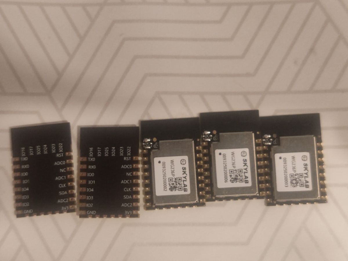

    Mine arrived
    Skylab modules laying on a surface with a geometric pattern.
    But. i'm taking a short break from iot, and trying to build a custom rom for my android phone.
    Boot log:

  • TuyaMCU identified; product key still needed
    #18 21417683
    Posts: 5232
    Help: 449
    Rate: 918
    And on the UART INIT/DEINIT you see, I have that too so it is probably working fine.
    yes, silly me. Just looked at your boot log again
    it's TuyaMCU. I just need to find the product key.
    Screenshot of Tuya module debugging assistant V2.2.3.5 interface showing debugging messages related to the TuyaMCU module.
    @jasperro did you happen to capture the boot log with the module in place? What is the MCU in your device - I don't think I see it in the pics
    Maybe you or someone else would like to take a look?
    :( I will not be of much use with this
    Added after 47 [minutes]:
    >>21403198
    my obligatory ESP adaptor mapping pic for the WG236
    Two black ESP adapters for WG236A chip with visible connectors and RST and PROG buttons.

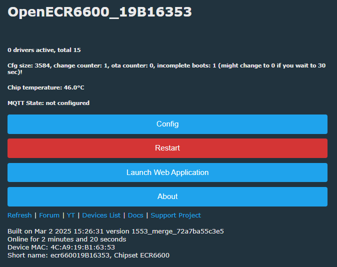

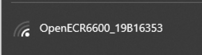

    Since i ported RTL8720D, and i did say that i would port ECR6600 next:
    I started port, and managed to boot compiled binary.
    SDK version is reported as ECR6600F_v2.1.0b02p03t01, Release version 1.0.0
    So it is newer than one used in ECR6600-TS2D_TuyaOS-3.5.7 (ECR6600F_v2.0.0B06P02), but older that skylab one.
  • Generic HAL boot log on ECR6600

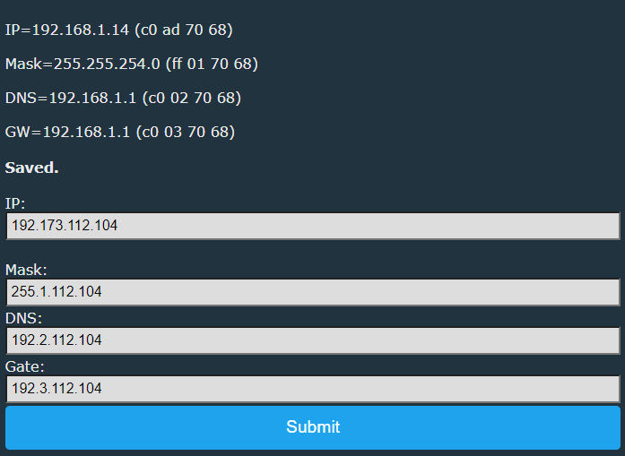

    If without define in str_to_ip, setting static ip crashed. If defined, test error is still there but result is this:
    A screenshot of a network settings form displaying saved IP addresses, mask, DNS, and gateway with suspicious values.
    TestIPtoStr still passes.

    yes. wifi seems bad. module is ~60cm away from my Intel Wi-Fi 6 AX200 160MHz - 69/29 (Mbps)
    Wi-Fi signal icon with the caption OpenECR6600_19B16353.
    User interface for the OpenECR6600 device with buttons for configuration, restart, and launching a web application.
    maybe something in here needs tweaking.
    RDTool V1.7.7 software interface with Wi-Fi settings.

    insmod wrote:

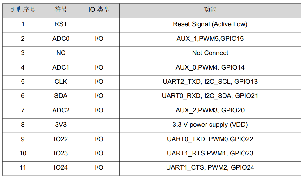

    Btw, you adapter mapping is a little wrong: IO13 is TX2, and ADC1 is IO15, ADC0 is IO14, at least in code.
    I'm trying to reconcile the ADCs with the WG236 datasheet. TX2/IO13 changed in previous pic
    Diagram showing pin layout of the WG236 module.
    Table showing pin functions of an electronic interface.
    Table showing pin mapping with functions to GPIO on a microcontroller.
    why are there seemingly two UART2_TXD - GPIO0 and GPIO13?

    >>21462915 The only uart port without extra pins is UART1 (and even it has 2 variants for rts/cts). All uart/adc/pwm variants, from what i understood looking at the code is here https://github.com/openshwprojects/OpenBK7231...e303682c7c/src/hal/ecr6600/hal_pins_ecr6600.c

    OK. odd. Using LED I have confirmed IO14 and IO15 on the module map correctly as in pic with P14/P15 in OBK.
    Fragment of a circuit board with IO, RST, NC, GND, and 3V3 pins with function descriptions.

    >>21463019 Then skylab labelled them incorrectly, because IO15 should be ADC1 and IO14 ADC0

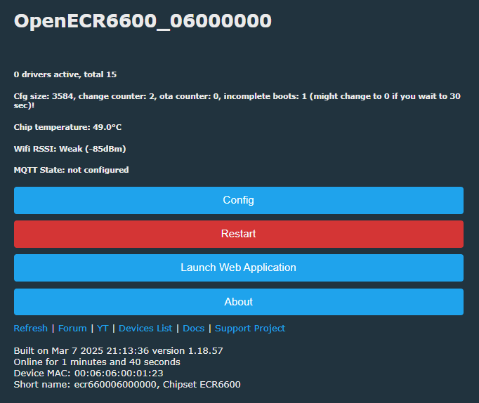

    OTA 1553_merge_36861d4df64d -> 1.18.57
    Screenshot of the OpenECR6600 interface with technical information and configuration buttons.
    from TX0/IO6:
  • OTA update blocked by unsupported version and bootloader mismatch

    -85dbm, and main page is accessible. A miracle, i always have problems if rssi is lower than -80. As far as i understood, both TR6260 and ECR6600 tx power is more or less alright, but reception is worse.
